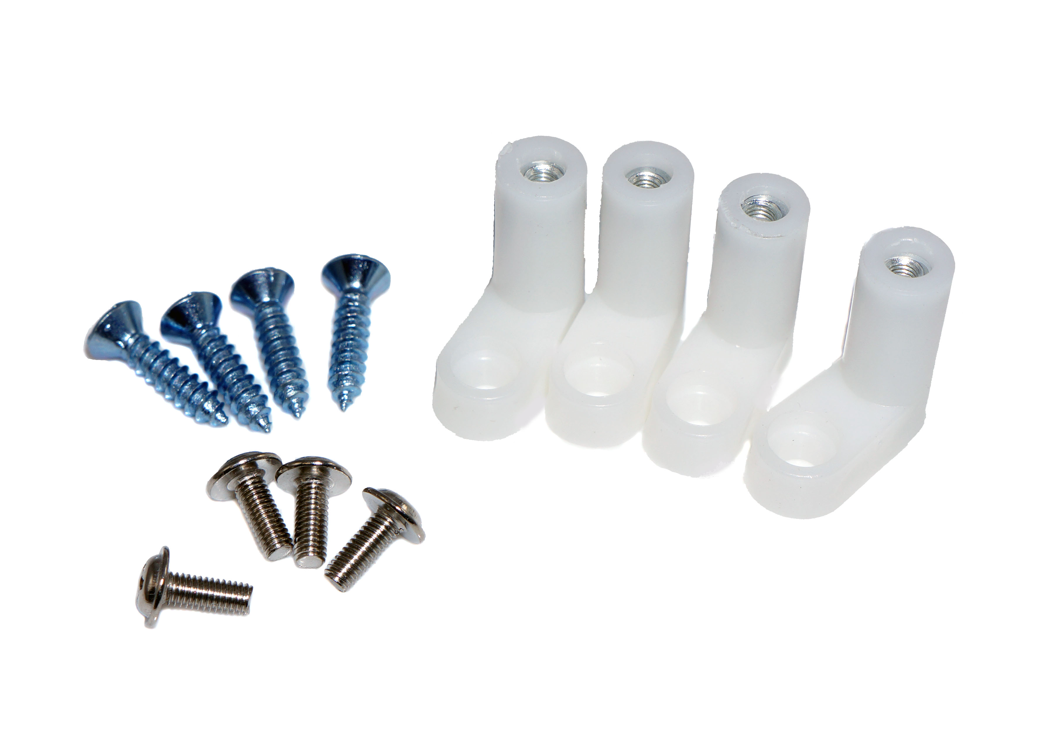

1. where do i buy rubber feet for this thing?
2. if i make the bottom see-through, where do i get some plastic?
3. how big do i make the interior? A lot of the ones on slagcoin are ~1.5" or less inside which strikes me as tight given the trackball dimensions are ~2.3" depth and the Stick 2.1". Even if i route the top board and the controls are recessed somewhat it seems like going any less then 2" is crazy at least where the controls rest.
4. at some point i'll want to make my wiring neat and tidy. i need to research various ways of doing this. of the CP's i've seen the ones that look like they're ziptied or something are tidy but i don't know how they route the bundle of wires so neatly. something to look into..
Arroyo
  • Posts: 1558
  • Last login:November 26, 2025, 09:34:25 pm
  • Budgets are boring
Re: Test Control Panel Design
« Reply #18 on: February 26, 2020, 09:43:20 pm »
I bought some off Amazon.  Specifically these:
https://www.amazon.com/dp/B003B0YDRM/ref=cm_sw_r_sms_apip_QgXwNrbZQh1xP
Just search for it on the web or Amazon.  AliExpress is great for this kind of stuff as well, although it takes awhile to get here.

Next step is to fill those exterior pocket holes somehow. Whats the best way to do that and end up with a decent painted finish result? I'll probably repair my drilling blowouts too while i'm in there before i sand everything. Since I plan to make the bottom see-through and removable I should keep the inside clean I figure.
I'll add some support in the corners and a ledge for the plastic to screw to on the bottom.
Also I want to paint the lower half. Will probably just use some enamel spray paint and primer with sanding.
Any reason not to laminate the entire thing, looks small enough to be able to get the laminate for cheap enough.
Alternatively Bondo will be your friend for the hole filling, There are a few tutorials about if you've never used it before.  (Using the right amount of hardener is key).

so i'm looking at some of the components that i need to put inside this thing and some questions come to mind..
how do folks mount their IPAC ultimate I/O boards to the inside of their CP? Any suggestions on suitable products for that? I found some short wood screws and rubber washers that might do the trick which i purchased from ACE hardware.
for the servostick (joystick), i was planning on simply mounting it underneath per the previous profile drawing i posted in this thread. It looks like the distance between the top plate of the joystick and the bottom of the ball is 1 3/8". By mounting it underneath on my 1/2" plywood + laminate i figure the distance between the top of the CP and the bottom of the ball on the joystick will be more like 1 3/8" - 1/2" or ~7/8". In other words i'm losing about 1/2" of the space between the CP deck and bottom of the ball. Space that presumably my fingers might need as i work the joystick. Does that seem ok? i.e. losing some of the height of the joystick by mounting it underneath?

Nice progress, that's a solid looking first attempt.
Most folks use PCB feet:
You can buy them lots of places but here's one.
]In other words i'm losing about 1/2" of the space between the CP deck and bottom of the ball.

awesome thank-you guys. I ordered the PCB feet. Thanks for the link! beats the heck out of my rubber washers and screws  :cheers:
I looked over slagcoin but it doesn't list the servostik explicitly. Nor does ultimarc's website talk about this question. I vaguely recall it is similar to a Sanwa JLF? which slagcoin mentions is generally mounted with 23-24mm which is darn close to my 7/8" inch. If that's comparable that is. The guy in this video mounted it underneath as well so perhaps mounting underneath is fine.
I emailed ultimarc to see what they say. Just trying to make sure I do whats correct and don't want to change shafts.
