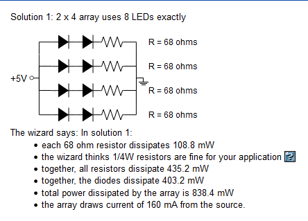

I will use 8 LEDS. 2 for each point.
If i fill according to specs https://www.everlight.com/file/ProductFile/IR333-A.pdf
5
1.5
50
8
« Last Edit: June 30, 2020, 04:43:47 am by cybermat »

If i would like to buy these https://pdf1.alldatasheet.com/datasheet-pdf/view/89554/KINGBRIGHT/L-53F3C.html
Is it correct entering the following ?
 Source voltage 5
diode forward voltage 1.5
diode forward current (mA) 50
number of LEDs in your array 8
  • Posts: 9752
  • Last login:Yesterday at 02:45:09 pm
Re: JayBee DIY 4 IR Led Lightgun System (no calibration needed)
« Reply #562 on: June 29, 2020, 05:12:33 pm »
That datasheet covers eight different LEDs with different ratings.   :dunno
 Source voltage 5
Looking at the L-53F3C datasheet at https://datasheet.octopart.com/L-53F3C-Kingbright-datasheet-13425907.pdf
Page 2, Absolute Maximum Ratings table -- DC Forward Current -- IF -- 50mA.
It's usually not a good idea to run LEDs at the max rating.
- They will burn out faster.
If you want the calculator to return the resistor value for 2 LEDs and a resistor per row x 4 rows:
- Enter #LEDs = 2
- The calculator will return 2 LEDs and a resistor in one row.
- Four rows like that wired in parallel will draw four times the current of a single row.
or
If the calculator returns 4 LEDs and a resistor per row, you can add a long wire between the 2nd and 3rd LED to break it into 2 groups. i.e. mount 1st and 2nd LEDs at the first point then run a wire to the 3rd and 4th LEDs and resistor mounted at the second point.

I cannot find any link where i can purchase easily these leds SID1K10CM , so i'm looking for leds with the same specs but SID1K10CM are high powerful leds as per what i understood.
So for this model https://pdf1.alldatasheet.com/datasheet-pdf/view/89554/KINGBRIGHT/L-53F3C.html according to the specs and your suggestions i will put these data
Source voltage 5
diode forward current (mA) 20
Are they powerful enough for 1/1.5 meter distance ?
Once again, that datasheet is for a series of eight different LEDs with four different sets of specs.   :banghead:
Specify EXACTLY which P/N of the eight on page 1 you are asking about or find a datasheet that covers just the one P/N you want.   :bat
Look at the four "Forward Current vs. Forward Voltage" charts on pages 3-5.
None of those charts show the curve passing through the point at the intersection of 1.5v on the X-axis and 20mA on the Y-axis.
- The values you plug into the calculator must describe a point on the curve or you'll get worthless, incorrect info -- garbage in, garbage out.
- The current draw depends on the voltage drop across that specific LED P/N.
- The curve describes the relationship between those values for that specific LED P/N.
- If you want a specific current draw, trace that value horizontally until it meets the curve, then go straight down to find the associated voltage.
-- Chart on page 3, start at 20 mA on the Y-axis, go right until you reach the curve then go straight down to 1.2v or
-- Chart on page 3, start at 40 mA on the Y-axis, go right until you reach the curve then go straight down to about 1.26v.
- If you want a specific voltage, trace that value vertically until it meets the curve, then go straight left to find the associated current draw.
I'll let JayBee answer this question since he has hands-on experience designing/building these and should be able to compare the datasheet for his LEDs to the datasheet for your LEDs once you clarify exactly which LED P/N you are asking about.

PART number is L-53F3C , according to your suggestions and datasheet
Source voltage 5
diode forward voltage 1.26
diode forward current (mA) 40
Source voltage 5
Thanks for the clarification on the P/N.   :)
I know you won't be using these LEDs, but here's how to check the LED calculator results:
1. Solve for resistor voltage drop (single resistor)
W = V * A (wattage formula)
W/A = V
108.8mW/40mA = 2.72v
2. Solve for current draw through the resistor. (ensures voltage in step 1 is right)
E = I * R (ohm's law)
E/R = I
2.72v/68 ohms = 40mA
3. Solve for voltage drop across each LED
(Source voltage - resistor voltage)/2 = voltage drop across each LED
(5v-2.72v)/2 = 1.14v per LED
4. Run that 1.14v LED voltage drop through the chart on pg 3 of the datasheet and you get about 8mA.   :(
The calculator provided a VERY safe current limiting resistor value that will make your LEDs VERY dim.
https://ledcalculator.net/#p=5&v=1.26&c=40&n=2&o=w
Using the same values as above, this calculator returns a resistor value of 62 ohms, 5% or better tolerance, 1/8W (min.) or 1/4W (better heat dissipation) for 2 LEDs and one resistor per row.
W/A = V
99.2mW/40mA = 2.48v
E/R = I
2.48v/62 ohms = 40mA
(5v-2.48v)/2 = 1.26v per LED
4. Run that 1.26v LED voltage drop through the chart on pg 3 of the datasheet and you get about 40mA.
You're working on a very steep part of the curve so even a small change in resistor value results in a very large change in current.
- Might be worth the effort and expense to use a variable resistor.   :dunno
Another good LED calculator site: http://ledcalc.com/
Good luck finding suitable LEDs.   :cheers:
