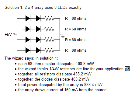

I will use 8 LEDS. 2 for each point.
If i fill according to specs https://www.everlight.com/file/ProductFile/IR333-A.pdf
5
1.5
50
8

If i would like to buy these https://pdf1.alldatasheet.com/datasheet-pdf/view/89554/KINGBRIGHT/L-53F3C.html
Is it correct entering the following ?
 Source voltage 5
diode forward voltage 1.5
diode forward current (mA) 50
number of LEDs in your array 8

Looking at the L-53F3C datasheet at https://datasheet.octopart.com/L-53F3C-Kingbright-datasheet-13425907.pdf
Page 2, Absolute Maximum Ratings table -- DC Forward Current -- IF -- 50mA.
It's usually not a good idea to run LEDs at the max rating.
- They will burn out faster.
If you want the calculator to return the resistor value for 2 LEDs and a resistor per row x 4 rows:
- Enter #LEDs = 2
- The calculator will return 2 LEDs and a resistor in one row.
- Four rows like that wired in parallel will draw four times the current of a single row.

I cannot find any link where i can purchase easily these leds SID1K10CM , so i'm looking for leds with the same specs but SID1K10CM are high powerful leds as per what i understood.
So for this model https://pdf1.alldatasheet.com/datasheet-pdf/view/89554/KINGBRIGHT/L-53F3C.html according to the specs and your suggestions i will put these data
Source voltage 5
diode forward current (mA) 20
Are they powerful enough for 1/1.5 meter distance ?
Once again, that datasheet is for a series of eight different LEDs with four different sets of specs.   :banghead:
Specify EXACTLY which P/N of the eight on page 1 you are asking about or find a datasheet that covers just the one P/N you want.   :bat
Look at the four "Forward Current vs. Forward Voltage" charts on pages 3-5.
None of those charts show the curve passing through the point at the intersection of 1.5v on the X-axis and 20mA on the Y-axis.
- The values you plug into the calculator must describe a point on the curve or you'll get worthless, incorrect info -- garbage in, garbage out.
- The current draw depends on the voltage drop across that specific LED P/N.
- The curve describes the relationship between those values for that specific LED P/N.
- If you want a specific current draw, trace that value horizontally until it meets the curve, then go straight down to find the associated voltage.
-- Chart on page 3, start at 20 mA on the Y-axis, go right until you reach the curve then go straight down to 1.2v or
-- Chart on page 3, start at 40 mA on the Y-axis, go right until you reach the curve then go straight down to about 1.26v.
- If you want a specific voltage, trace that value vertically until it meets the curve, then go straight left to find the associated current draw.

The link of L-53F3C was right...but the site has a kind of protection
https://pdf1.alldatasheet.com/datasheet-pdf/view/89554/KINGBRIGHT/L-53F3C/+5JW55UhGLGwyKIlZfSHEDP.O+/datasheet.pdf
PART number is L-53F3C , according to your suggestions and datasheet
Source voltage 5
diode forward voltage 1.26
diode forward current (mA) 40

But from the ref the leds aren't bright enough (Radiant Intensity (Ie): 30mW/Sr).
So you might want something brighter, and if possible with a bit higher angle (50~100mW/sr minimum with 30degrees).
From my experience IR leds are sadly a bit trial and error, as the real performance might vary a lot from the datasheets specs.
Anyway if you go this route, I'd recommend you to use 3 leds for each point instead, 2 isn't always enough and cause misdetections.
Source voltage 5
Thanks for the clarification on the P/N.   :)
I know you won't be using these LEDs, but here's how to check the LED calculator results:
1. Solve for resistor voltage drop (single resistor)
W = V * A (wattage formula)
W/A = V
108.8mW/40mA = 2.72v
2. Solve for current draw through the resistor. (ensures voltage in step 1 is right)
E = I * R (ohm's law)
E/R = I
2.72v/68 ohms = 40mA
3. Solve for voltage drop across each LED
(Source voltage - resistor voltage)/2 = voltage drop across each LED
(5v-2.72v)/2 = 1.14v per LED
4. Run that 1.14v LED voltage drop through the chart on pg 3 of the datasheet and you get about 8mA.   :(
The calculator provided a VERY safe current limiting resistor value that will make your LEDs VERY dim.
https://ledcalculator.net/#p=5&v=1.26&c=40&n=2&o=w
Using the same values as above, this calculator returns a resistor value of 62 ohms, 5% or better tolerance, 1/8W (min.) or 1/4W (better heat dissipation) for 2 LEDs and one resistor per row.
W/A = V
99.2mW/40mA = 2.48v
E/R = I
2.48v/62 ohms = 40mA
(5v-2.48v)/2 = 1.26v per LED
4. Run that 1.26v LED voltage drop through the chart on pg 3 of the datasheet and you get about 40mA.
You're working on a very steep part of the curve so even a small change in resistor value results in a very large change in current.
- Might be worth the effort and expense to use a variable resistor.   :dunno
