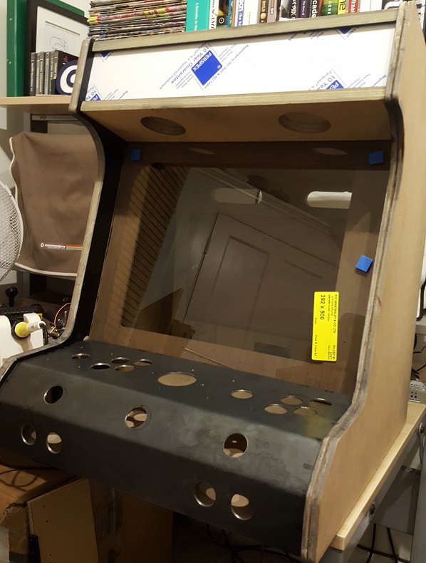

More buildstuff today.  Nothing too exciting, just dowelled up the floor and the monitor frame, and fit it all together.  That's the last bit of dowelling done.  I'm pretty much ready to start prepping the panels now for painting/artwork.
So more of the same for the floor, used the 3d printed guides to make dowel holes in the edges: -
Aaaand same on the side panels where the floor will attach...
The floor fits nice...
And underneath where the control panel meets the floor, it was nicely aligned, phew!...
Next, on to the monitor frame (with the glass overlay).  I made a jig out of wood with 2 dowel holes in each end to use for this.  It worked out nicely.  The top of the monitor glass fits into the small routed recess in the speaker panel, so I used this as an alignment guide, then I measured equal distance away from the front of the side panel on the other (bottom) end, clamped on my jig and drilled the holes into the side panel.  Then used the same jig to drill the holes on the actual monitor frame and pushed in the dowels.  Repeat for the other side and all done...
At the bottom end where the monitor frame meets the control panel, I had to rout away a bit of the CP's rear support block so that I could get the monitor glass in and out.  Basically to take the monitor glass out if I need to replace it, I would take off the CP top, unscrew the hex bolts under the glass retainer panel (see previous post), then the glass can drop down out of the routed recess at the top, and I can tilt it forward to take it out.
Obligatory money shot with it all put together.  The control panel fits snug up to the glass, about 0.5mm away, which is a relief!

I also lined the storage box with 4mm neoprene rubber/foam sheets.  Looks and feels nice I think :)  It's already full up with stuff!
Also tonight, enlisting a friend to help, we just about managed to get the CP wired up... man that took a while and was fiddly.  Opted to solder the controls instead of using the female spade connectors I'd bought, and I used boot lace ferrules on the ipac end.  Not the neatest, but I'm pretty happy...
Today I also got the speakers and amp connected, the marquee installed with LED strip, wired the IEC power socket, and test-ran booting the pi.  All worked nicely :)
Still to do....
 - Apply side art!
 - Apply t-molding on side panels.
 - Mount powerstrip, pi, usb hub, tidy and connect up cables etc.
Cutting it fine, lol... the kids had better appreciate this... ;)

Woo!  I did it in time....  well, got the side art applied anyway, and it's playable... she chooches like a good'un :)
Not fully configured yet, but the kids love it!  Mission accomplished! :)  I still have some tidying up to do, paint touch ups, t-molding to install and software configuration of emulators and controls, but it's usable :)
Side art came out lovely... the missus helped me apply it last night and I trimmed the edges with a craft knife...
CP looks great - I'm well chuffed with this! :)
Marquee and top box internals: I used a broom handle to hold the LED strip, and hot glued the audio amp. Cable access through each side of the marquee floor/back panel...
And top view... t-molding a bit dirty - might replace that soon...
Back panel/door: -
Merry Christmas everyone!  :cheers:
