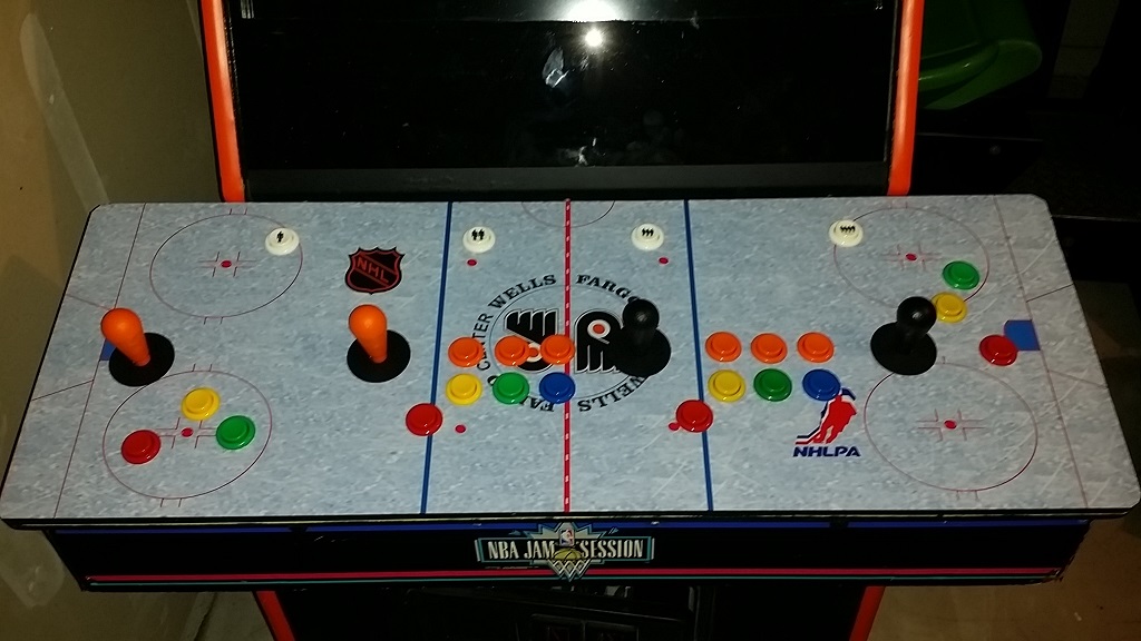

Change the angle of the CP to 5 degrees.  Generally the back panel is 1" taller than the front but your CP is so big that you may have to go to 1-1/4" or more.  10 degrees is way too steep, IMO.  You may also have trouble with the trackball not rolling as smooth as it should because of gravity.
For structural support, build a u-shaped column underneath it in the center that sticks out from the bottom front panel - there are lots of ways to make this look nice.  Something like this (not perfect but you get the idea):
Very interesting.
Any idea what angle the display is on this example?

I hope some little kid doesnt jump up and hang from the center 2 sticks or else you you'll have to use their college fund for funeral expenses.
I was never a fan of the cab you based this design on, and you somehow found a way to make it worse by making it thin profiled.  Have you considered a more NBA Jam shaped control panel? Hope you have great medical insurance too, so you can get carpal tunnel surgery from that CP angle after you're done burying children.
Besides the much appreciated well-wishes for my health and finances, which part of the NBA Jam CP are you referring to?  That it's rectangular or there is "more" space in your opinion for your hands/arms than mine has to properly rest on?
I can from images the NBA Jam CP is taller so it would only result in forearm surgery or taller kids hanging from the center sticks, so is that what you mean?  Or is there a single shotgun blast that fires when someone does that on the NBA Jam cabinet I have forgotten?
I think Malenko is referring to the shape of the CP.  He's not a fan of the aircraft carrier design.
His carpal tunnel comment is due to the extreme downward slant of the CP.  You might want to straighten it up a little.
You got it! But the kid grabbing the joysticks comment is more about the center mass of the cab. I don't think they'll be much unsprung weight to the cab so it will be very prone to tipping unless hes going to fill the bottom with sandbags or weights. The angle of the CP just adds to the problem. Here's my CP for my old 4 player MAME cab, exact same dimensions as NBA Jam/Open Ice/ NFL Blitz (ya know, actual 4 player games)
Changes made:
aligned the sticks so that smash TV, Karate Champ, Robotron, etc could be played on each set of sticks
adjusted the button positions for player 4 a little bit
added more buttons to the center players
had a button UNDER the CP, wired to ESC

Back to more interesting endeavors... of mocking out my control panel...
Since FedEx had problems.. I printed out the .pdf on my fancy Epson XP-440 and measured the CP length-wise and it appears to be what I expected.  It's just over 53 1/4 freedom units (inches) or roughly the 1358mm that Sketchup is telling me.  So that means I'm in business.
She's a big girl, well suited for her state's love of cheese, beer, and brats.  Maybe I'll use that as my theme.

That is 20 inches wider than a Konami 4p control panel. It is way too big. I am the only one giving you the right advice right now. Don't build this. Your design is terrible from top to bottom.
Yup it’s a big girl.  It’s actually smaller than a few people wanted me to make it based on the input I’ve recieved believe it or not.
But that’s why we mock it up huh?

Nobody who knows what they are doing would ever suggest a larger control panel than you are proposing. You don't have to mock it up to realize it is way too big. I am not entirely sure you are for real.

**Observations... I like the big look of it, but keep in mind moving it and doorways, at best keep the width around 34" after the C/p is removed, The tilt of the c/p is a bit much, not only will it be uncomfortable to play for extended periods but your going to get spilled drinks all over it. 2 players is all you need, lots of elbow room for fighter games....And that 4slot coin door is hands down the dumbest thing Jenn has ever seen put to steel.
I would also agree the tilt will come up. Someone told me 5-10, I started at 10.
I haven’t concluded I don’t want to do 4-players, but without the CP this would be 2’ 7 1/2” wide or 31 1/2”
I’m still middle-ground on a coin door, but it would be 4 or nothing.
So you think this is 10 degrees?As long as this picture is a true orthographic angle, it isn't. Great to see that you'll follow someones advice, even if its terrible.
:laugh2:  Man you guys are a trip.  “Listen to advice!”  “You listen to terrible advice!”
I’ve also already said that the angle is coming down... but just because it’s funny to me...
You can clearly see that the picture is not parallel with an X or Y axis, but that didn’t stop you from drawing an arbitrary line to “measure” my angle and prove me wrong.  :lol
But PLEASE continue to try to make fun me trying to create something that I haven’t done before and act like you are holier than though, because it’s really damn funny when someone overshoots their shot like this and ends up looking like a jerk and a fool.   :afro:
You are obviously going to do what you are going to do and I'm actually looking forward to watching how this all turns out but 53-1/4" is absolutely gigantic.  4 and a half feet!!!  It is ridiculously big and there is no scenario where this is the correct solution.
OP, I’m just going to give you food for thought...
Your control panel is 5 1/4 inches wider than this one...

Yeah that’s pretty messed up, they didn’t even add room for a trackball. Talk about bending the knee...
I’m already cutting out sections on mine now that I have it in front of me and I have sticks in place so I’m able to “feel” what it’s like standing next to someone to figure out how much space I really need between P3 and P1, and p2 and p4.
What I struggle with is how much space I need between P1 > trackball > p2
