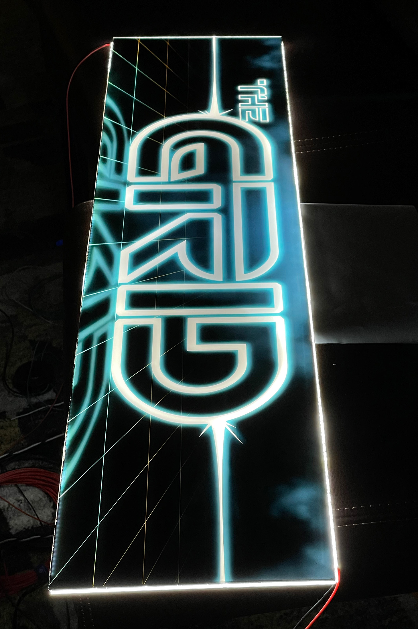

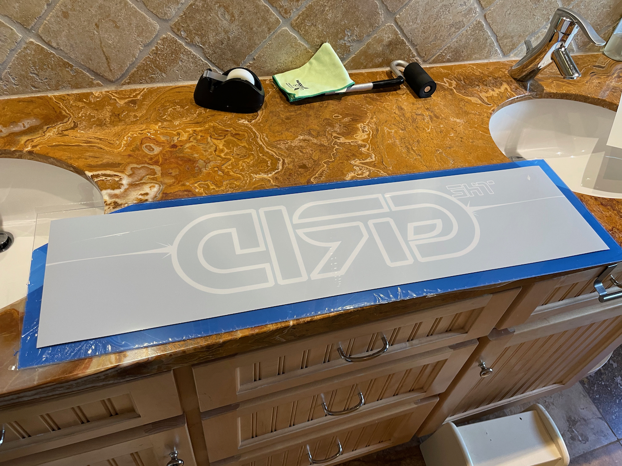

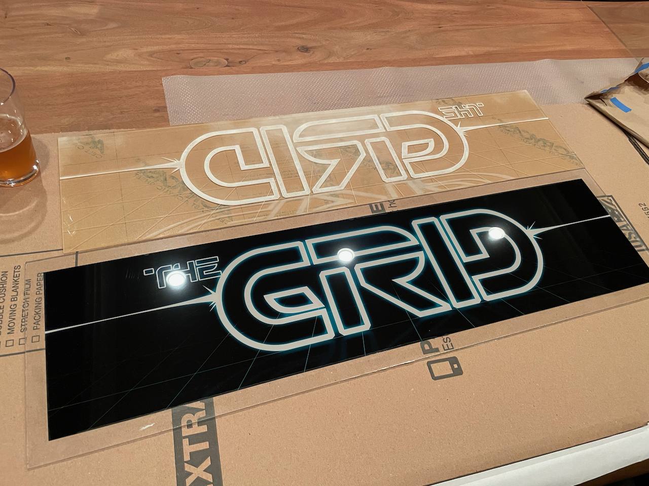

Been so long since I did I write up I had to think about it  :whap.
Got the etchings back and threw them up on the machine:
You can really see the etching when there is a black background behind it.
Next I had a print of the graphics done to scale and aligned the etched panel to the wood with the print as well.
This actually took a little fiddling as the laser etched panel was actually cut slightly smaller than the wood to accommodate for the side firing LED’s:
Here you can see the LED’s ligned up:

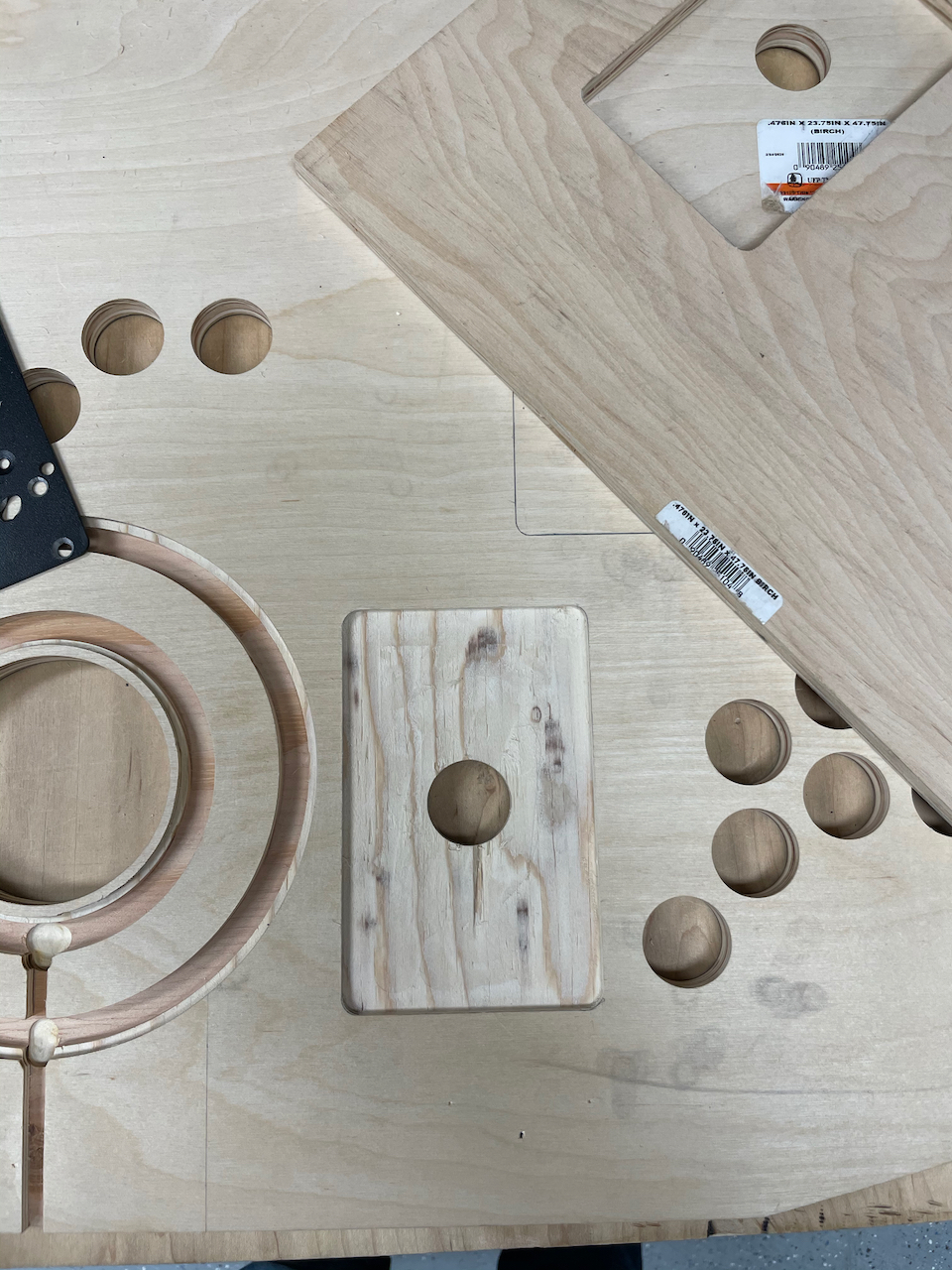

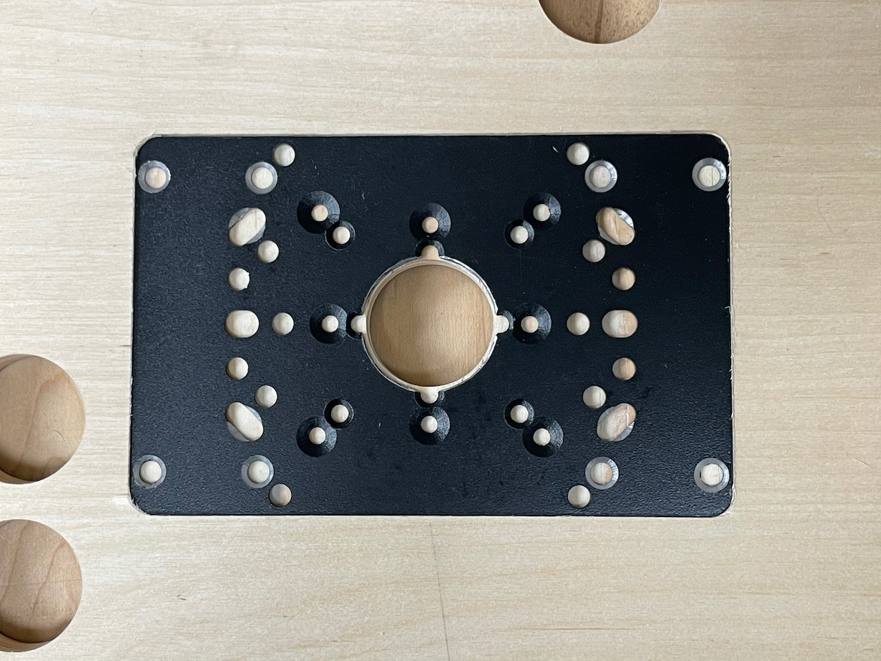

With all the alignment out of the way moved on to cutting holes.  Built a template for the router so that I wouldn’t make mistakes on the actual piece.  This was the same scrap I used to cut the large diameter curves on the panel exterior.. Also made use of the space buy cutting a U-Trak template when I get to installing that:
Drilled the middle with Forster bit using the same technique I did on the lock for the back door:
Then flipped the piece over and used a bottom bearing flush trim bit too follow the template:
Here’s where I’m at:
Side art and front art are supposed to arrive Monday.  I believe I have everything I need now to get this thing finished.  I am determined to get this done (well playable) in the next two months for some guests I have arriving in early April.  ;)

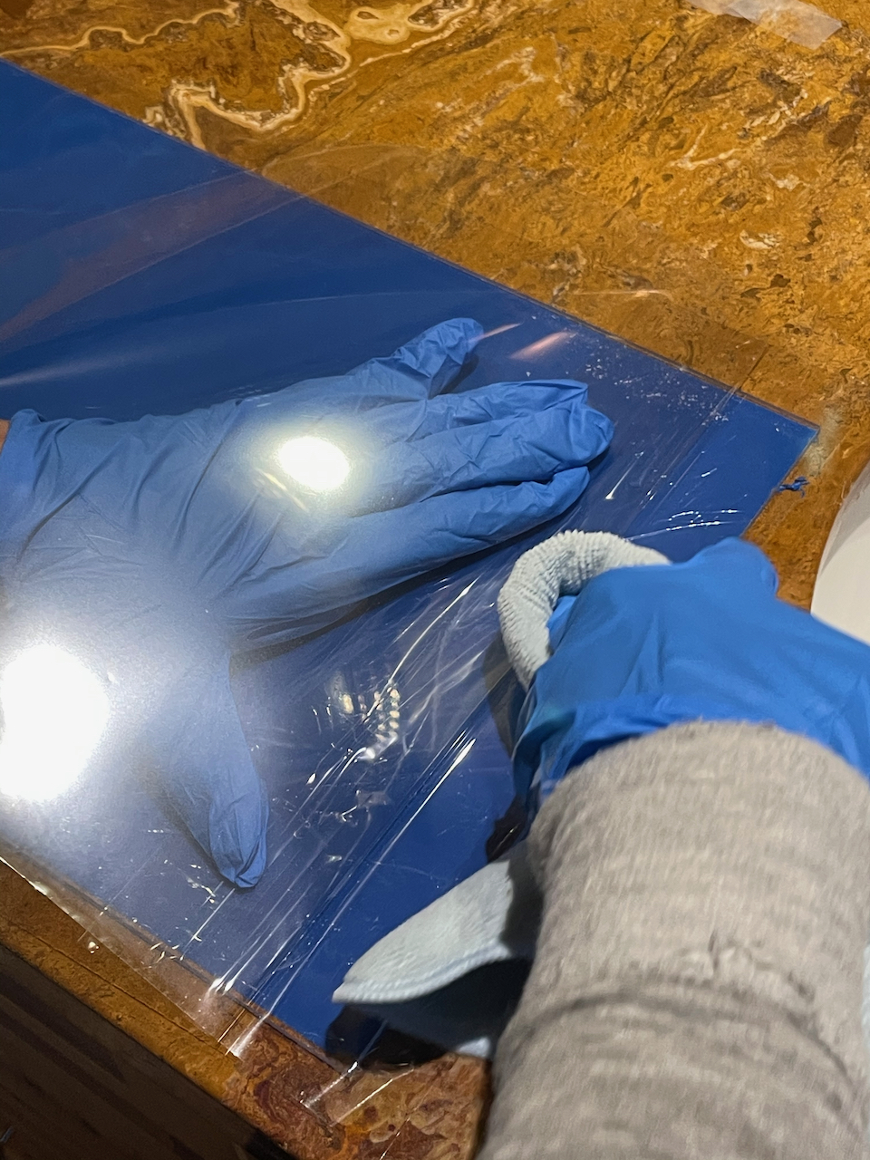

This is the way.  I finally replaced the side art on my DK today after 7 years (it peeled off while in a storage container during a renovation in 2013) and it took me less than 10 minutes per side with that thing.  Went on super easy.

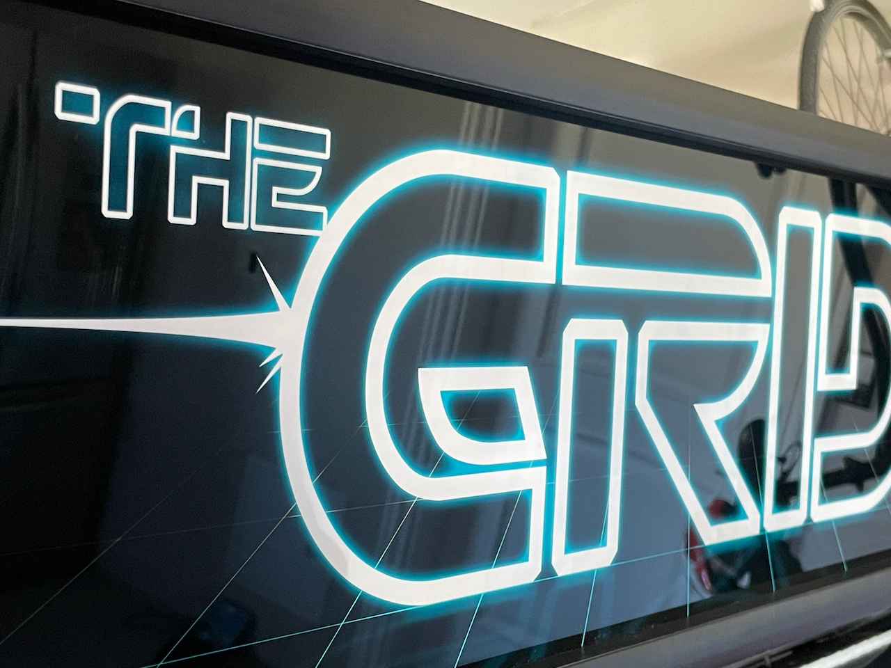

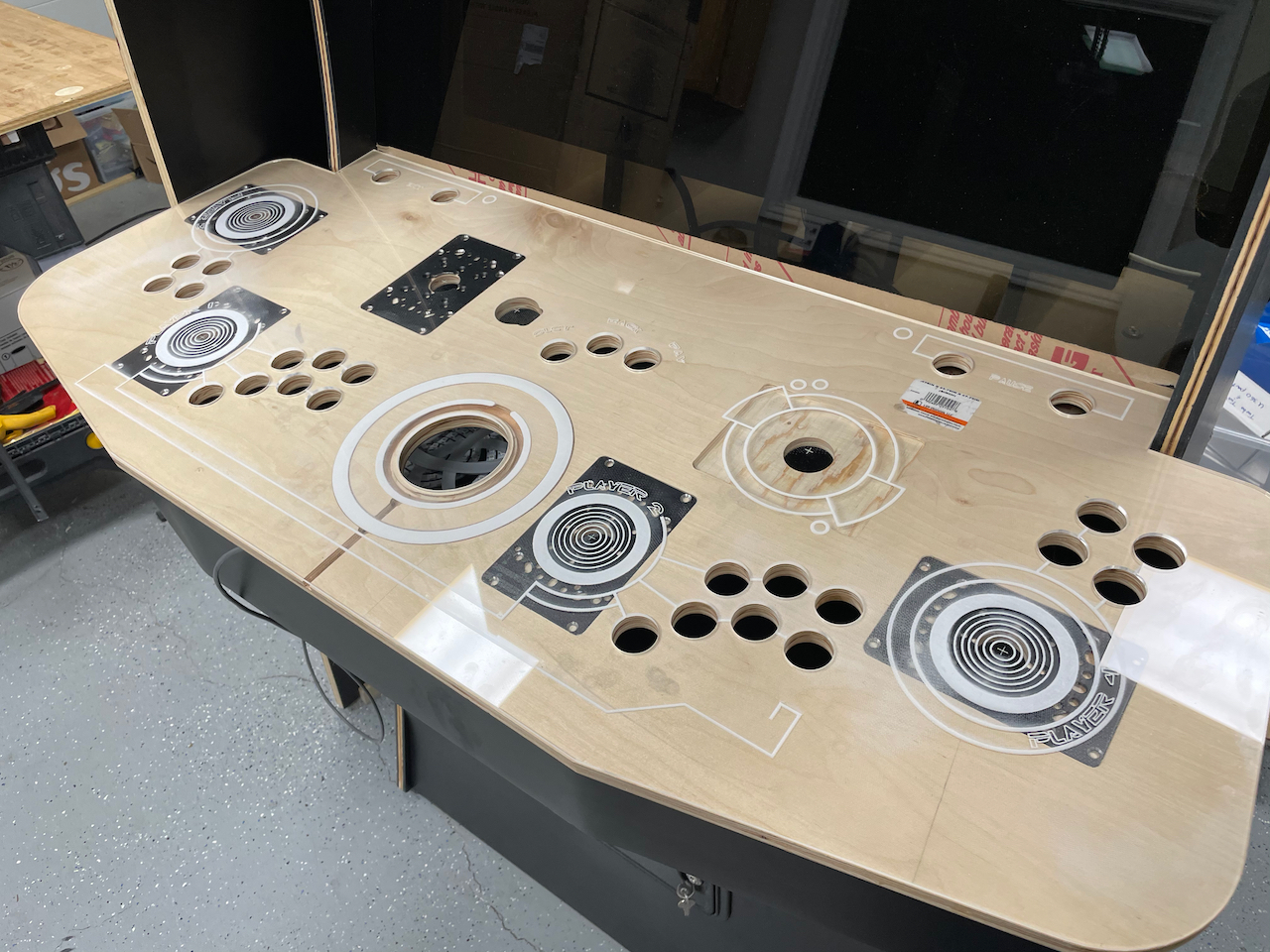

« Reply #704 on: February 26, 2021, 11:27:05 am »
I thought I replied to these.  Cheers for the suggestions fellas.
Going to do a write up, but figured I’d throw out the progress:

So I left off with the CP needing a lot of work.
1st step was getting the Ms. Pac-Man universal mounting plates installed.  I did this on my little CP and liked it a lot.  This allows me to swap joysticks by embedding these plates into the wood:
Rout out the exact dimensions with a template and make it snug in the wood (details posted previously):
Then mount wood:
And repeat
These will get some #6 screws epoxied to the countersunk holes and allow swapping sticks to be easy.  I didn’t take a lot of pics of the flight stick routing out, but same idea different dimensions although I went a little deeper to allow a dust washer to sit under the Acrylic layers.  I also cut a hole for the TurboTwist High/Low spinner which requires an odd shape.  I just did a circle and then cut out a lip for the microswitches that stick out so they would fit.
Next was the graphics for the marquee.  I hadn’t been totally happy with the little CP I built.  The problem was that because the graphic wasn’t adhered to the acrylic above it there were tiny particles that could get in-between the graphic layer and the acrylic on top.  In addition there was occasional rainbow effect from the light bouncing off the surface of the graphic print and hitting the acrylic:
To solve this I learned about “Facemounting” (there’s a joke in there somewhere), which is a technique I tried on the dust washer of the little CP but hadn’t tried on a large scale.  Basically it is a double sided adhesive applied to an ultra thin layer of plastic.  It’s called “Optically Clear Adhesive” and it’s made by Dry-Tac.  This permanently adheres the graphic directly to the acrylic and looks the same as if the graphic was printed directly to the acrylic.
Getting it on though isn’t so easy.  Here is the recommended way to do it in a series of videos:
There’s actually a ton of good information in that including ways to cut acrylic and their properties.  I would watch all 6 videos if you are interested in the technique.
It does recommend some heavy duty equipment, and I didn’t have any of that, but a guy online did it by hand () so I figured why not:
First applied to the acrylic going VERY slowly and making sure no bubbles.  I was really concerned about dust, but bubbles ended being a bigger deal.  One guy suggested online steaming a bathroom, then wait a few minutes then boom, clean room.
Doesn’t look like much but that’s the clear adhesive being applied by the hand technique to the acrylic which has a blue mask on the other side.
Once that went on was onto the graphics.  Same technique but graphic facing down:
I should mention that I used J rollers and laminate rollers to press as hard as I could after it was applied to get any remaining bubbles out.  When I took it off there will still some.  I worked on it for awhile and got most out but still some remained:
What’s really weird is that I left it there for a couple of days and those somehow magically disappeared:
Cut the acrylic to match the laser etched piece (with tracksaw).
Then it was routing out the grooves where the two pieces of acrylic would sit:
Took careful measuring to make sure all 4 sides lined up perfect.
Then fit it in:

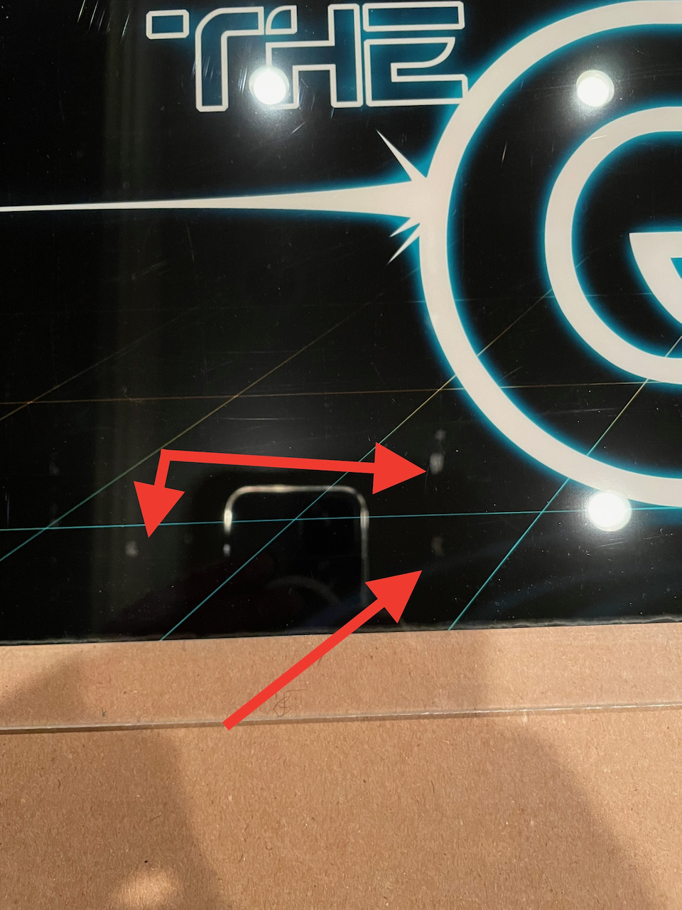

I was ready to do the same to the CP graphics but knew I needed a machine so I ordered the cheapest laminator Dry-Tac has…..didn’t go well, or at least shipping didn’t:
Hopefully they will send me a new one quickly.
In the mean time I figured I would get the lighting for the Marquee finished up while I am waiting.  Same as before, the little cool white 5mm LED strips taped to the etched Acrylic:
And lit:
And I am chuffed:

Dude!  That marquee came out amazing!  Curious if there's any depth effect based on the viewing angle since it's layered? (ie does it feel more dimensional or still feel flat?)  Your work continues to inspire.... I better get back to it!   :cheers:
Do you mean like the lenticular marquee found on Discs of Tron?  If so then no, but for a 2D image it does have a 3D feel just by its design.  The lighting helps by keeping the contrast between the blacks and lighting high.
