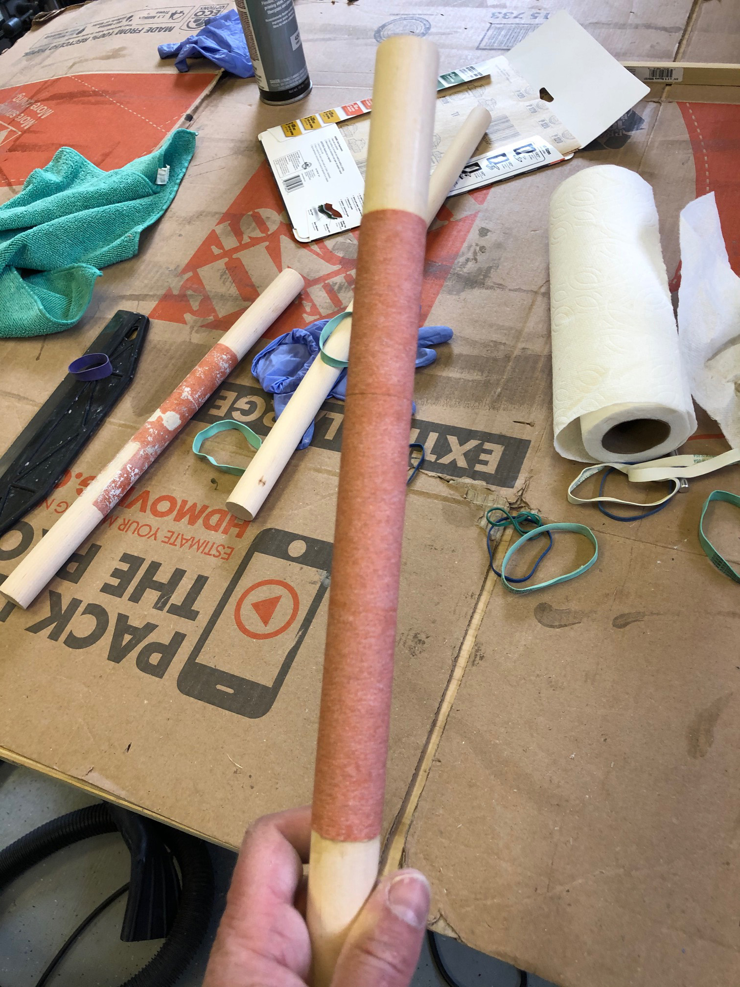

This time instead of using the PVC pipes and pressing the laminate down from on top, I just laid the wood down on the laminate using the hinge method and applied pressure with my hands on the wood:

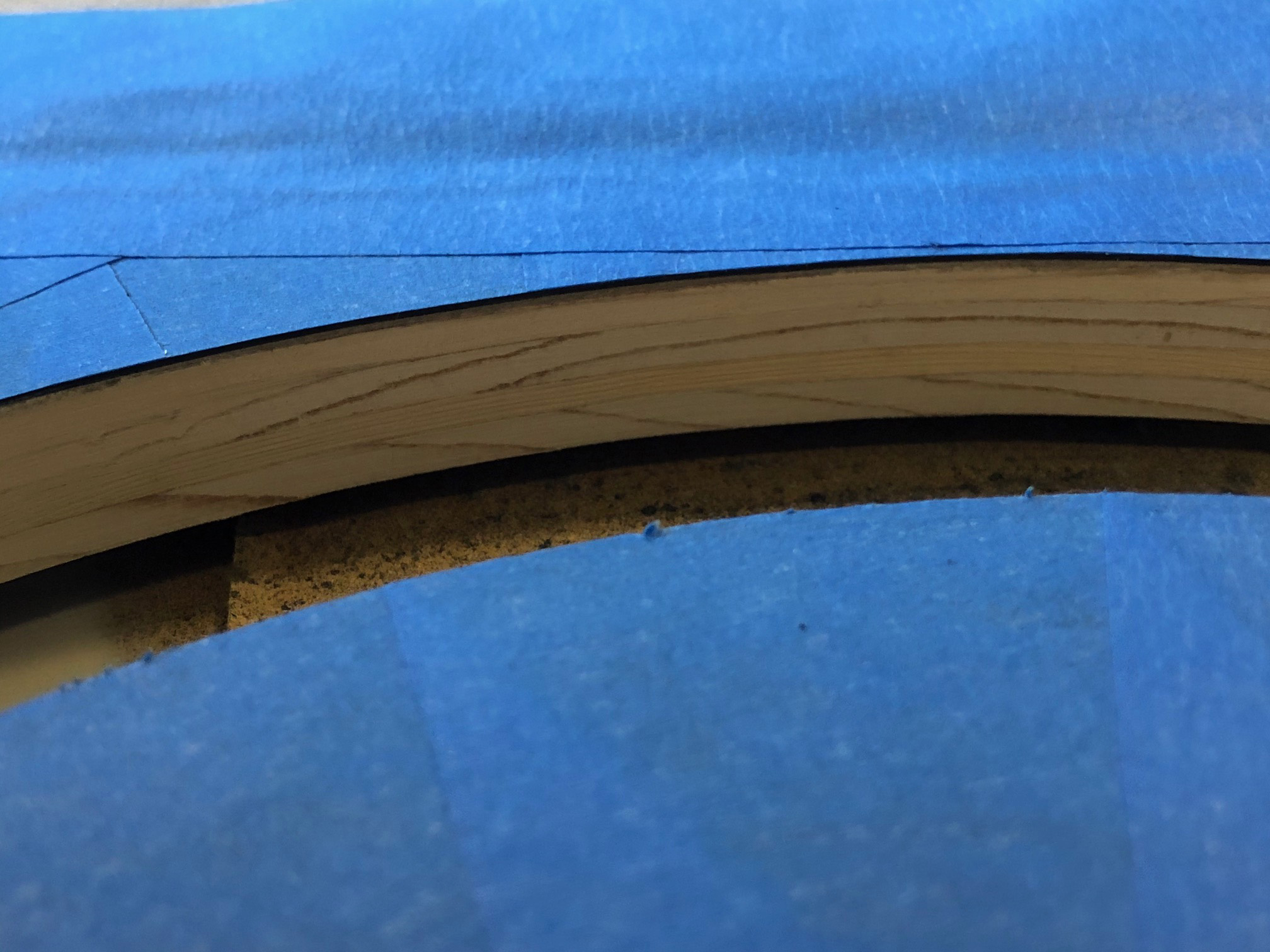

When trimming the angled sides I decided to try to match the angle of the cut with the angle base of the router I got:
Worked well, but it DOES create a hell of a sharp edge.  The plastic on the laminate surface turns into a virtual razor blade (got the blood stains to prove it).

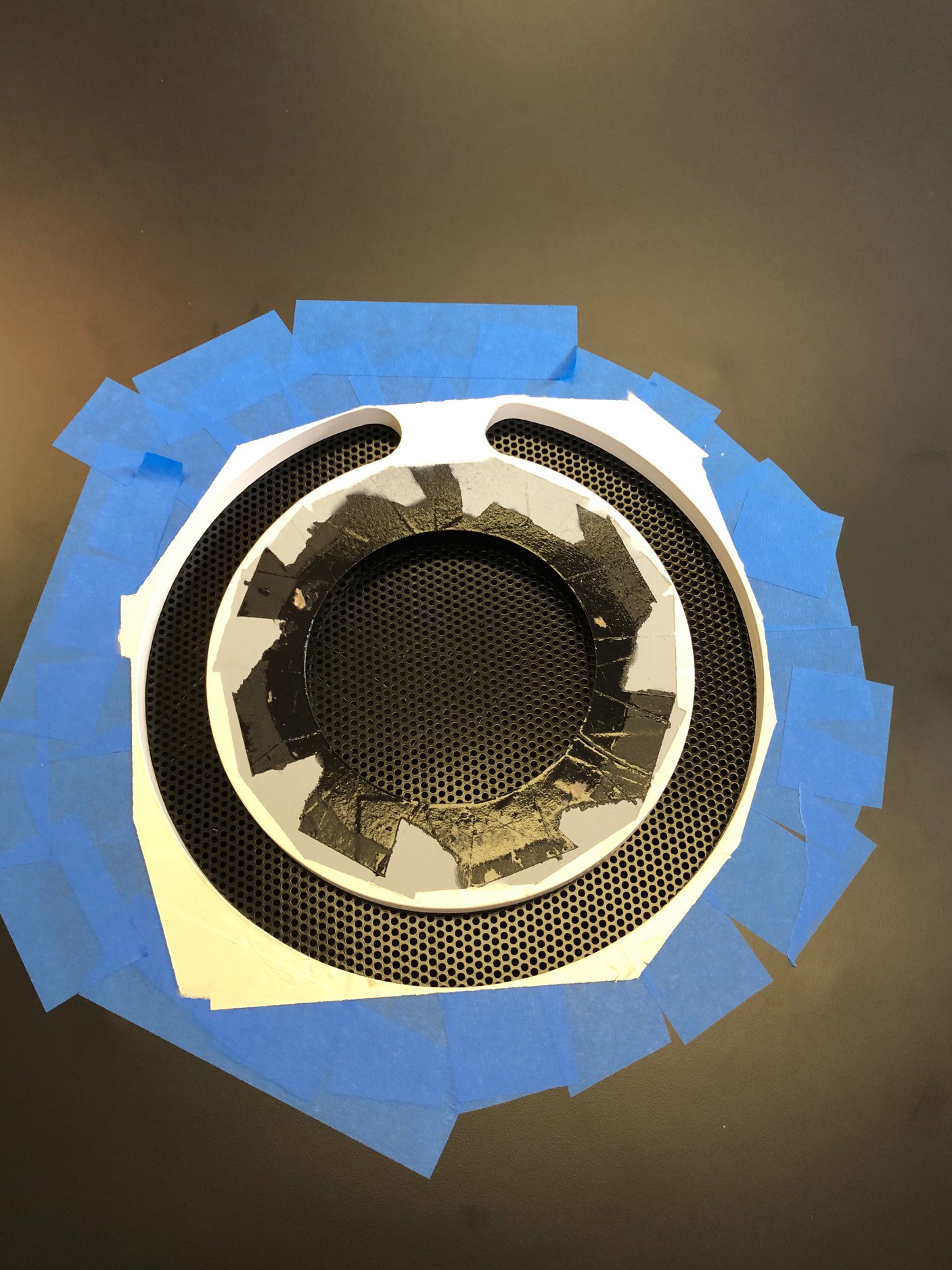

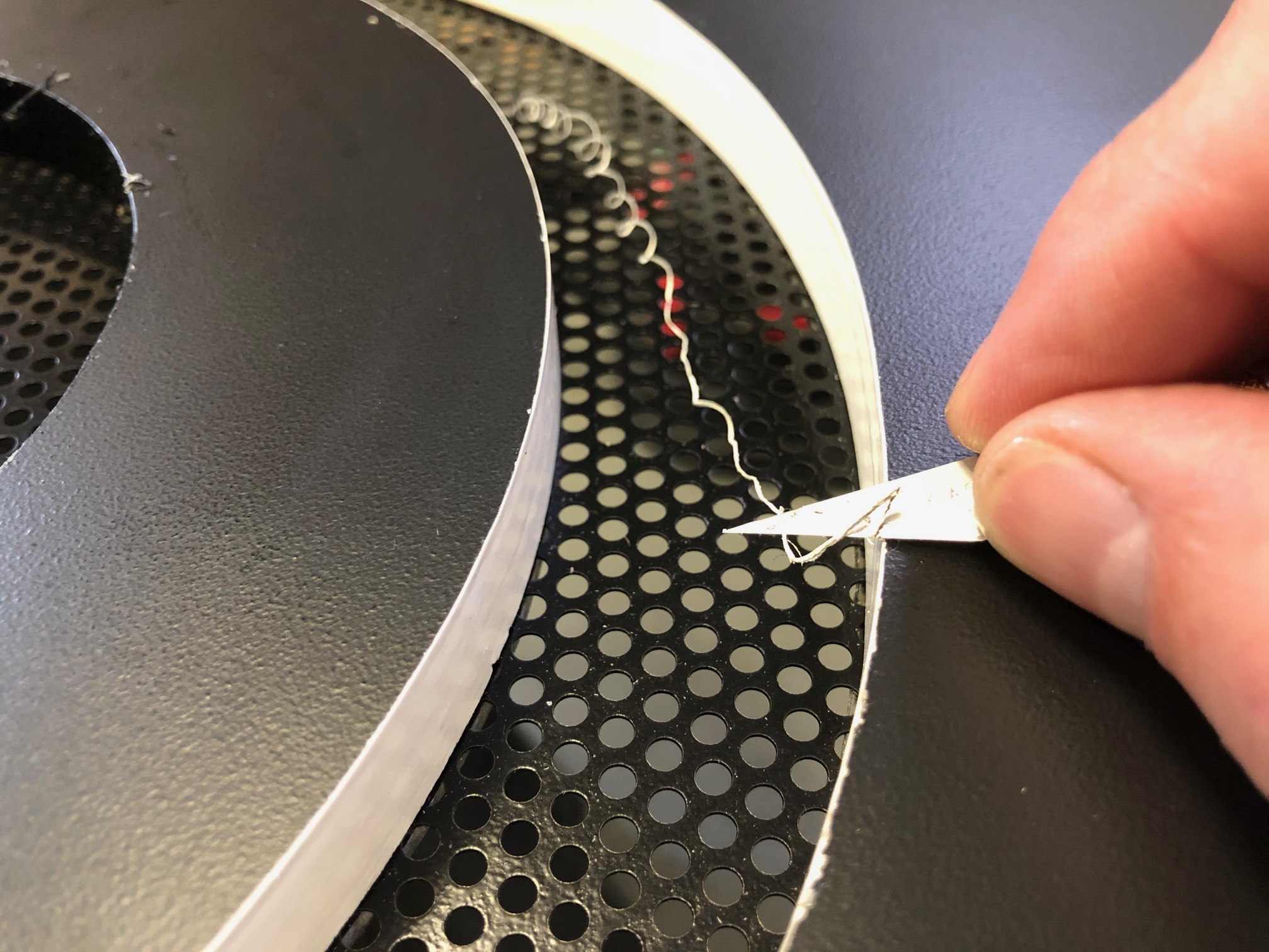

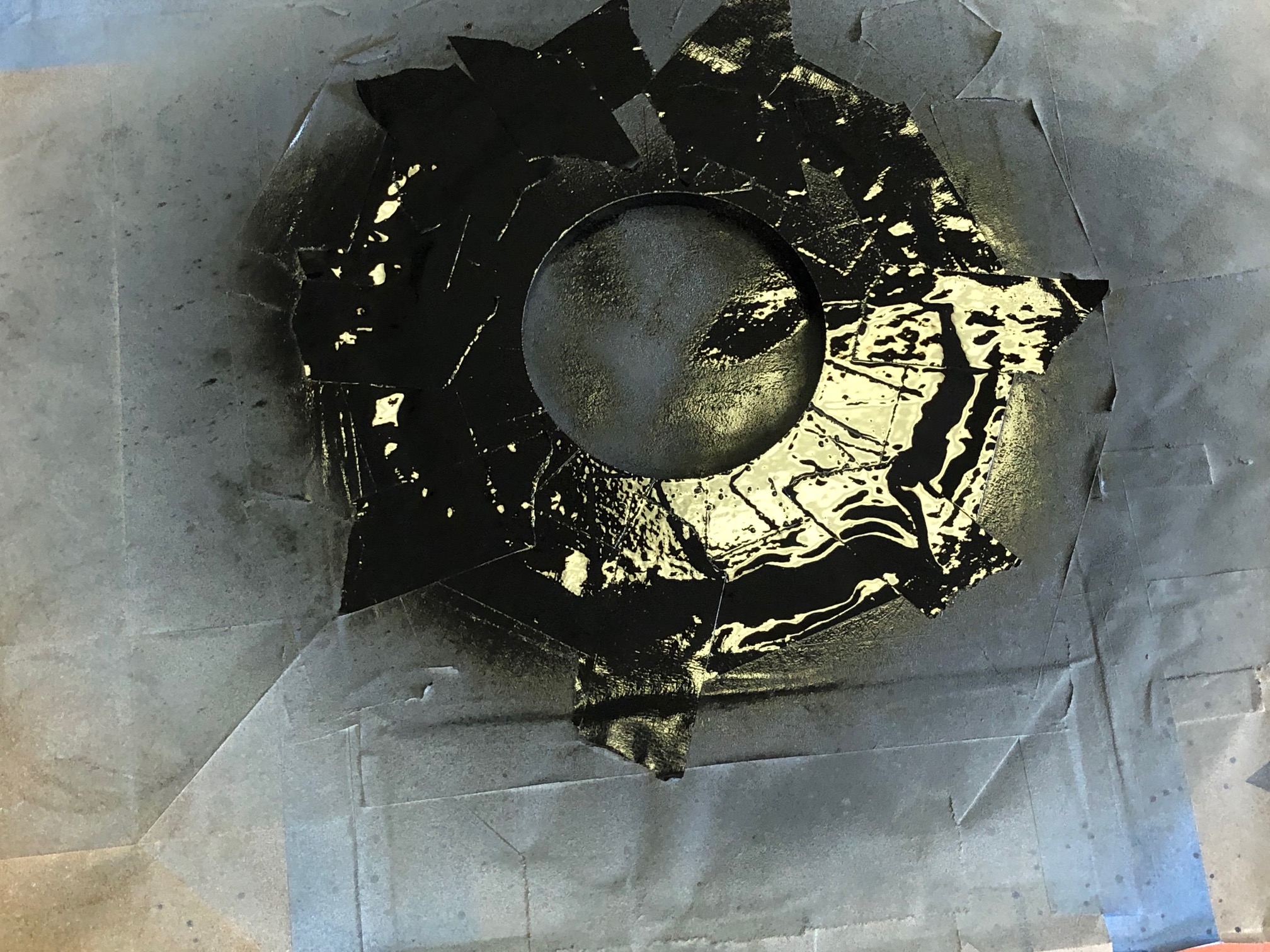

Taped off everything for painting the T-Molding face in case the T-molding isn’t perfectly aligned or gets nicked in the future so that the bare wood doesn’t show underneath:
As most of you already know the thin piece of tape in the middle is to block the slot for the T-molding from getting paint.  I have painted all the sides now, so glad to have that behind me:

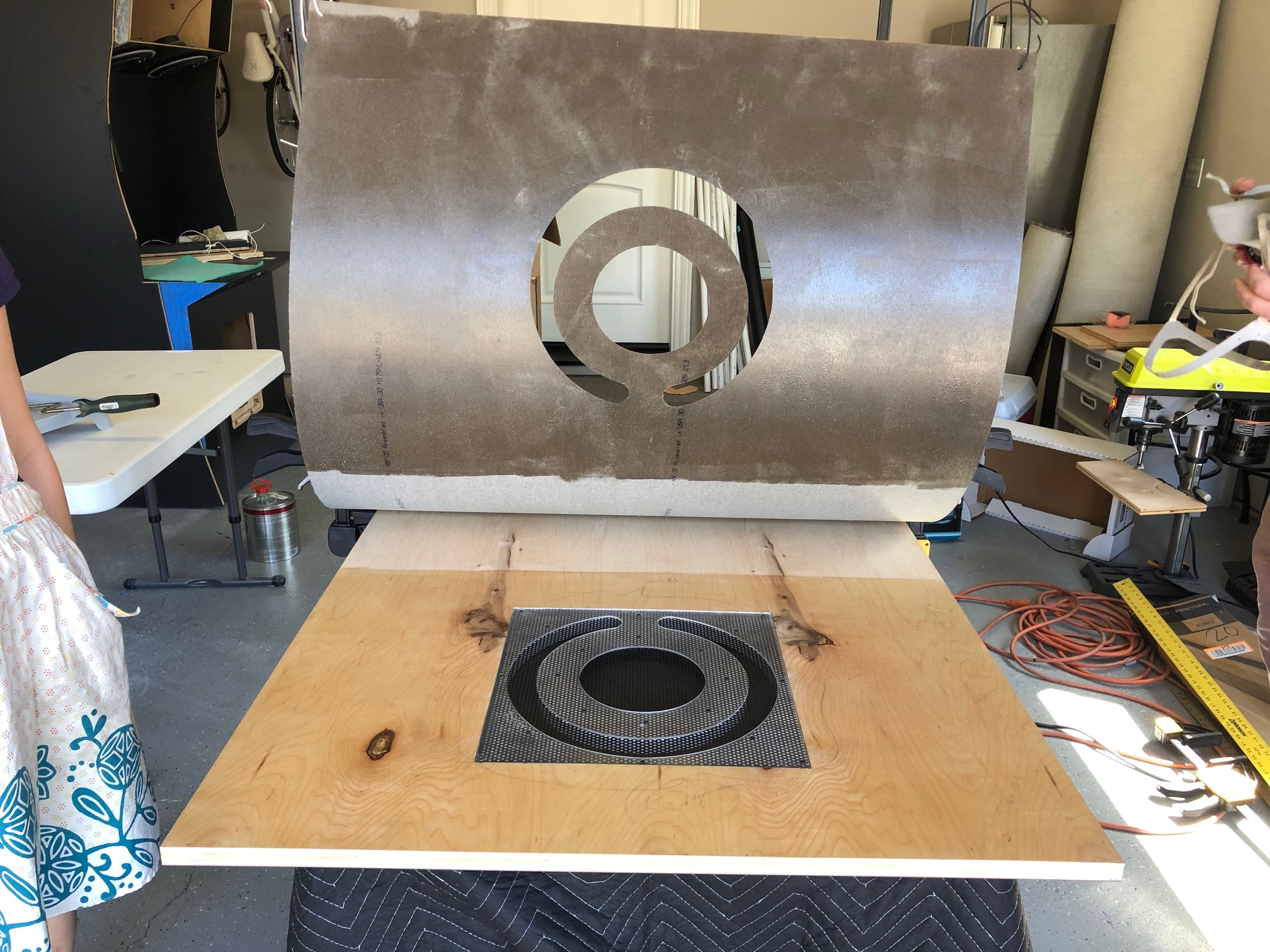

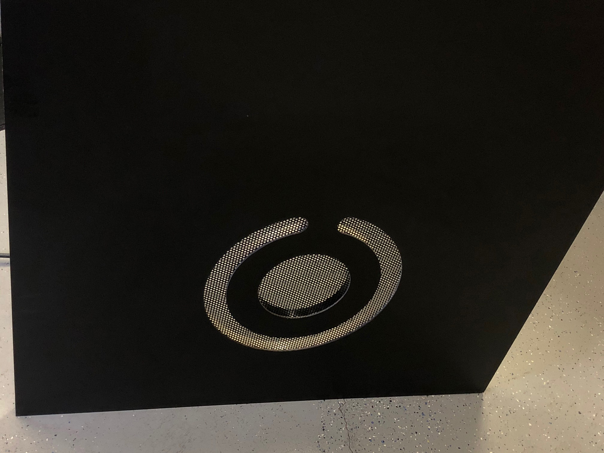

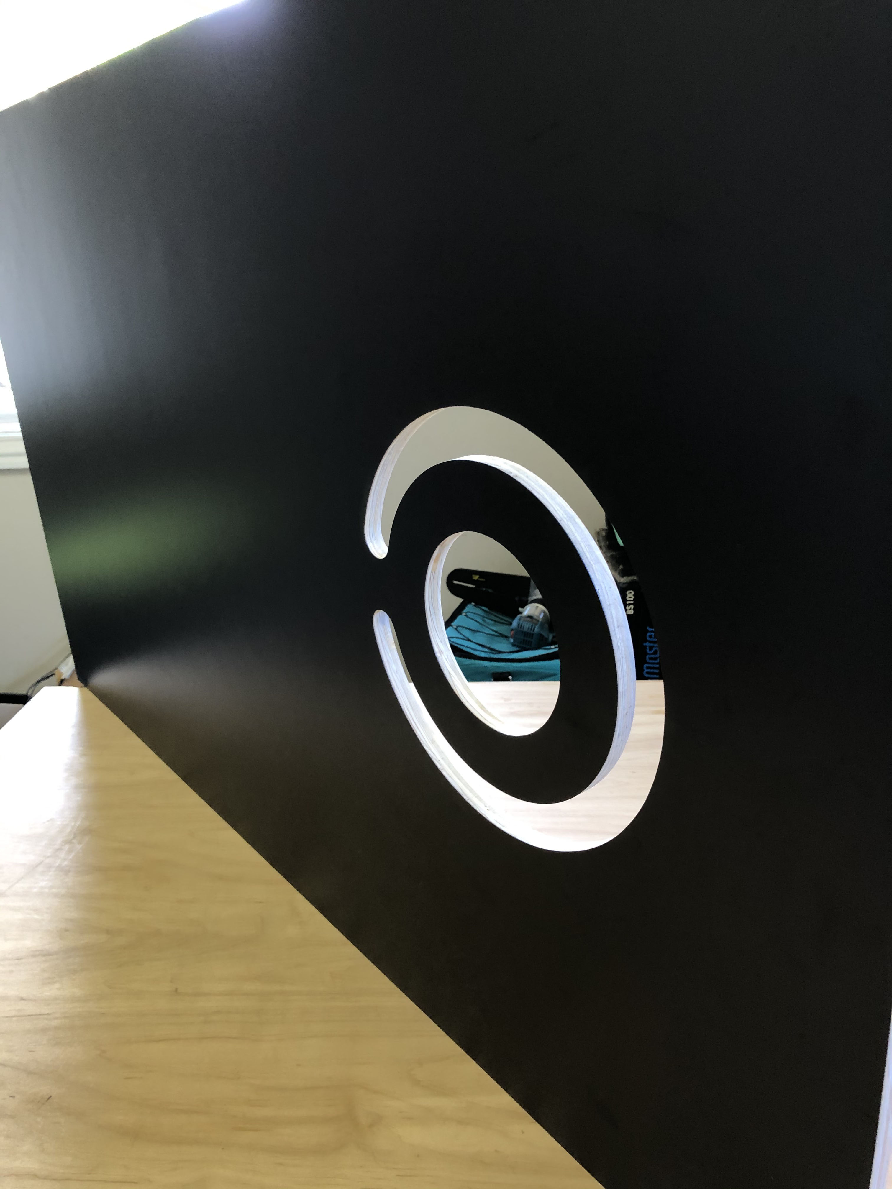

Cut out the bottom portion of the back that will go below the door.  Cut out the wheel wells and laminated it and the interior of the marquee sides that will be exposed when the marquee graphics are installed (will make more sense later).

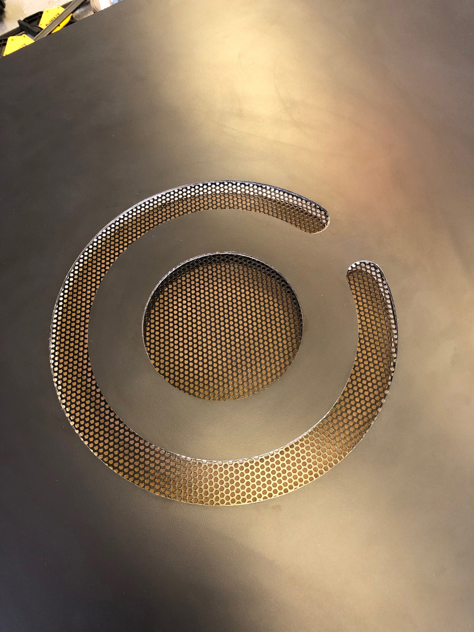

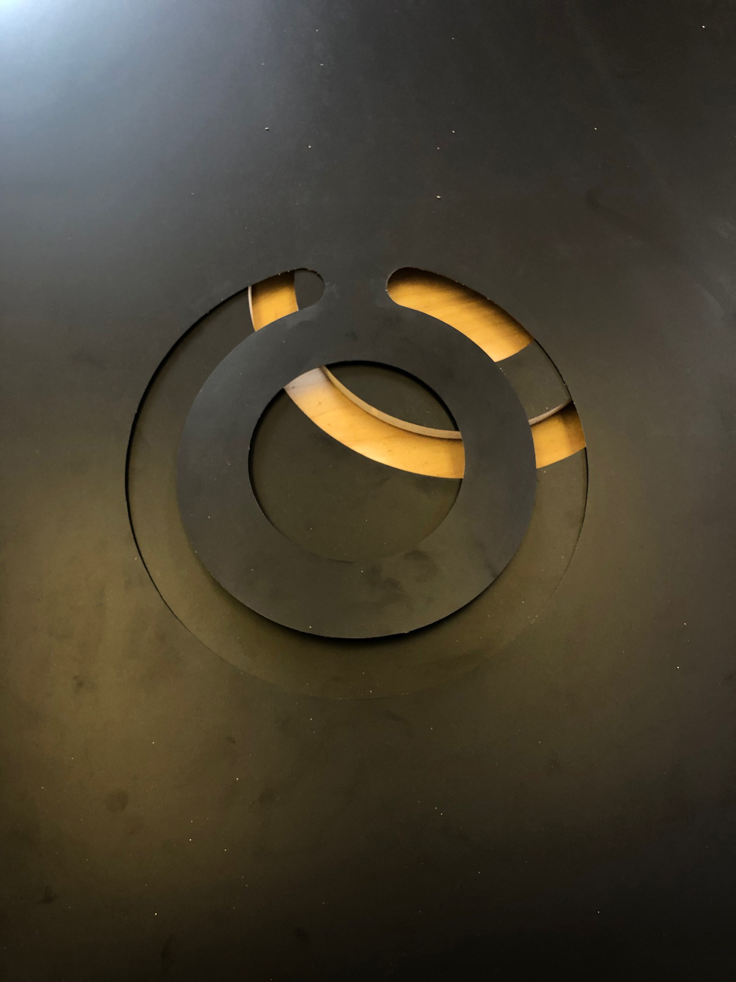

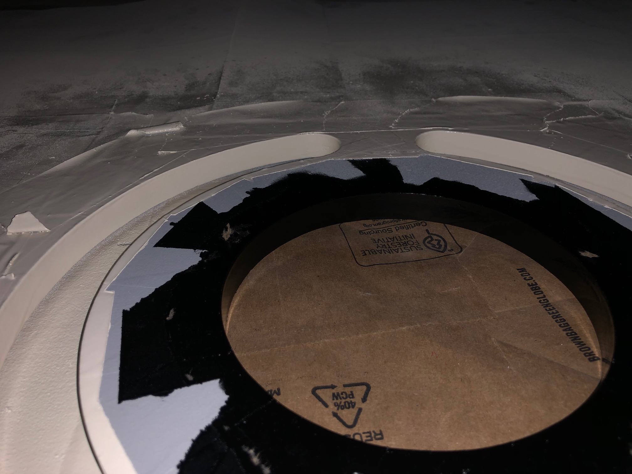

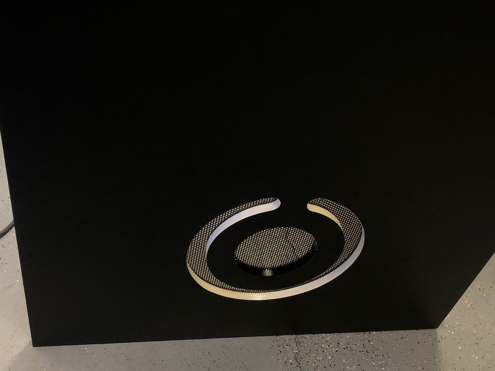

Now for the real effort.  I wanted to do something different for the ventilation.  My thought was, instead of cutting out some holes why not make a design.  The intention was to keep the disc thing going.  Busted out the circle jig from before:
Then used a forstner bit to finish off the ending curve (thanks for the tip Javery).  Came out pretty clean:

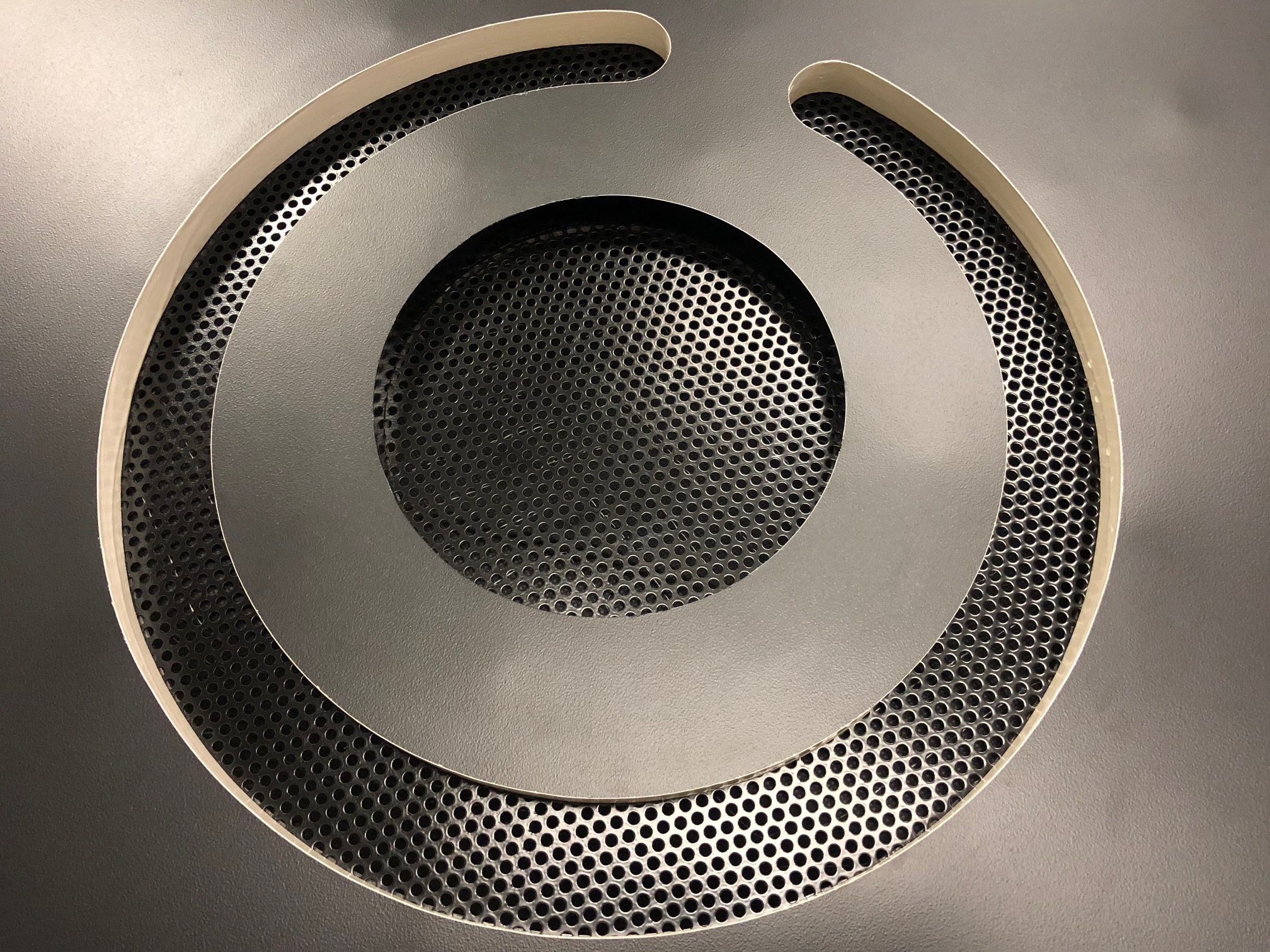

However I wanted a speaker grill installed to keep too much dust from coming in and I wanted to reinforce it as it’s a bit fragile.  So I got to routing out the wood:

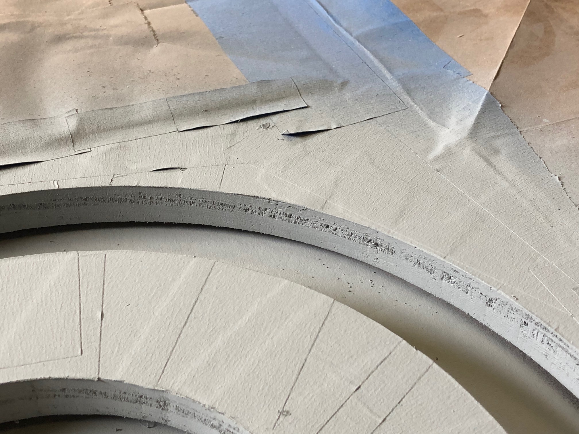

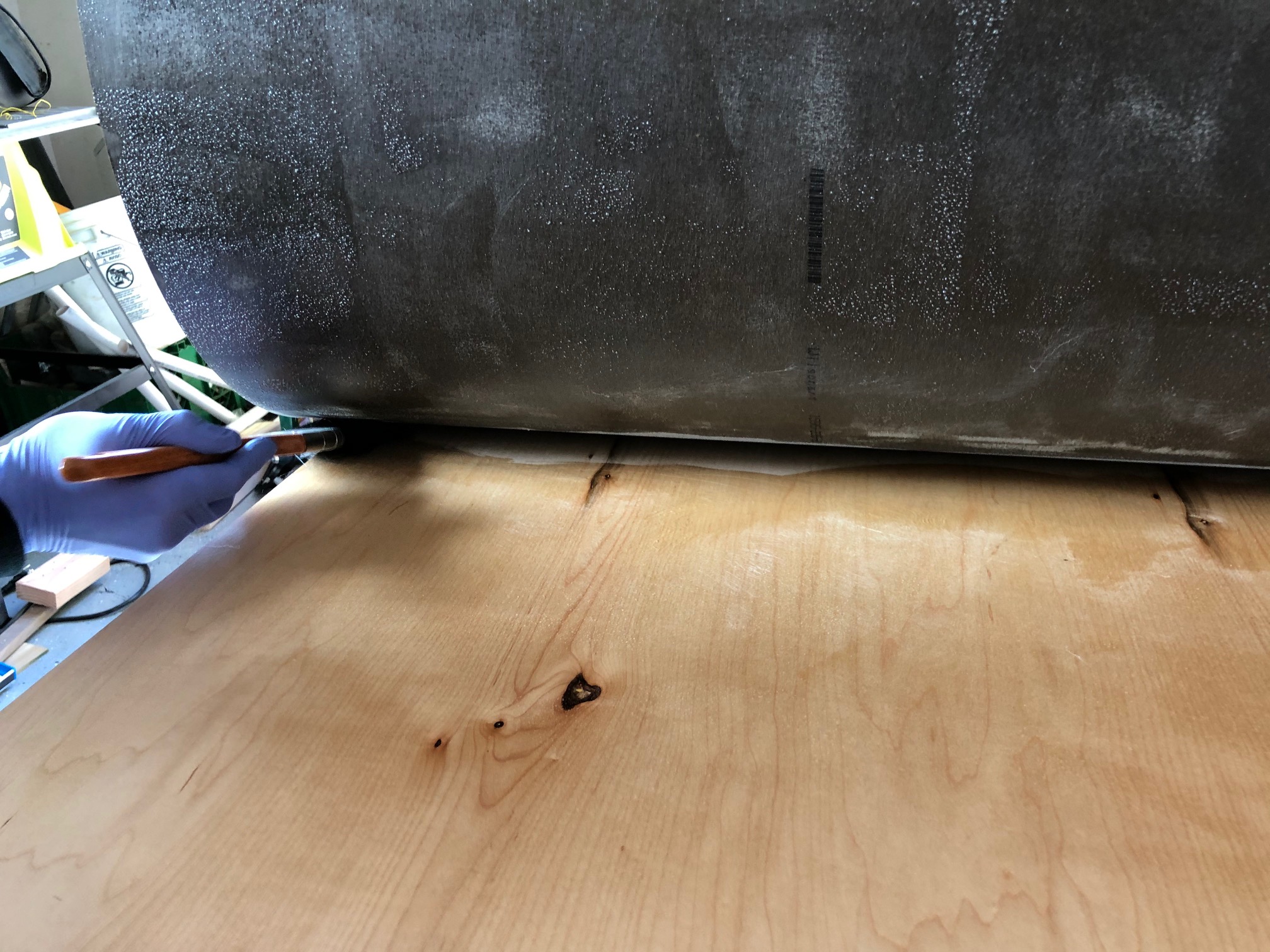

As I wanted to laminate over this it was going to be a bit of a process as I didn’t want the laminate sticking directly onto the speaker grill.  I wanted a smooth surface, so picked up 3/16” of Acrylic.
May not be totally obvious from the picture, but the acrylic was pattern cut to the design.  All the screws hold the acrylic and speaker grill in place, and I wanted to make sure my depth was accurate.  The plan is to take out the speaker grill, lay down some laminate (before using contact cement), and pattern cut the laminate.  I was al set to do this and then flipped over the piece to see this:
I had originally thought I liked the idea of the mesh being close to the surface, but after seeing this I think I like the depth better.  Maybe it’s because of the contrasting colors :dunno.  With cut wood interior being exposed though it means I have to paint it.  In general I don’t like painting.  But I’ve already masked it off so we’ll see where this goes.

Wanted to paint the interior and stupidly started priming:
Got what I deserved.
Reached out to OND as he is my paint hero (among other things).  Got a good chuckle out of him when I sent the above pick.  So yeah, lots of sanding and filling was in my future.  But how to sand this thing hmmm…..
120 grit glued to 1inch dowel held in place by rubber bands until it dried.  After many hours of using this and bondo, and wood filler I got this:
Getting a smooth surface on all of those surfaces means many a sore shoulder.  Ideally I would have had the dowel screwed down onto another piece of wood so I could ensure it would stay at a right angle to the piece at all times, but I didn’t have the patience. Took a lot of focus to keep myself from wobbling the dowel while sanding. :stupid:
Anyway applied the laminate to the side that I didn’t cut the inlay on:
Then I wanted to pre-cut the other side as I didn’t trust the flush trim bit to not take off some paint if I waited to do it later:
Masked off the area for painting (black):
then white:

Lined up the precut disc laminate with the embedded acrylic and grill:
Purposely only did this half first so that we (need two people on this one) could keep clamps on the rest of the piece to maintain the alignment of the discs.  Marked off where to put contact cement on both sides, and drilled holes in the corners and tied them to the top of the clamps to keep the pieces separate while drying. I had the acrylic and speaker grill off to the side to prevent the contact cement from getting on it, and applied to the acrylic face only.  Then put back in place and screwed everything down.
When doing the other side had to use a paint brush to get into the corners while it was tied up:
Came out good on this side (hadn’t cleaned the laminate yet):
And for the paint side which had been drying for 24 hours:
Pulled off tape and used Exacto blade to flush trim excess build up:
And final:
I think both actually look nice, still trying to decide which one should face outwards.  Opinions?
No paint side:
Paint side:
