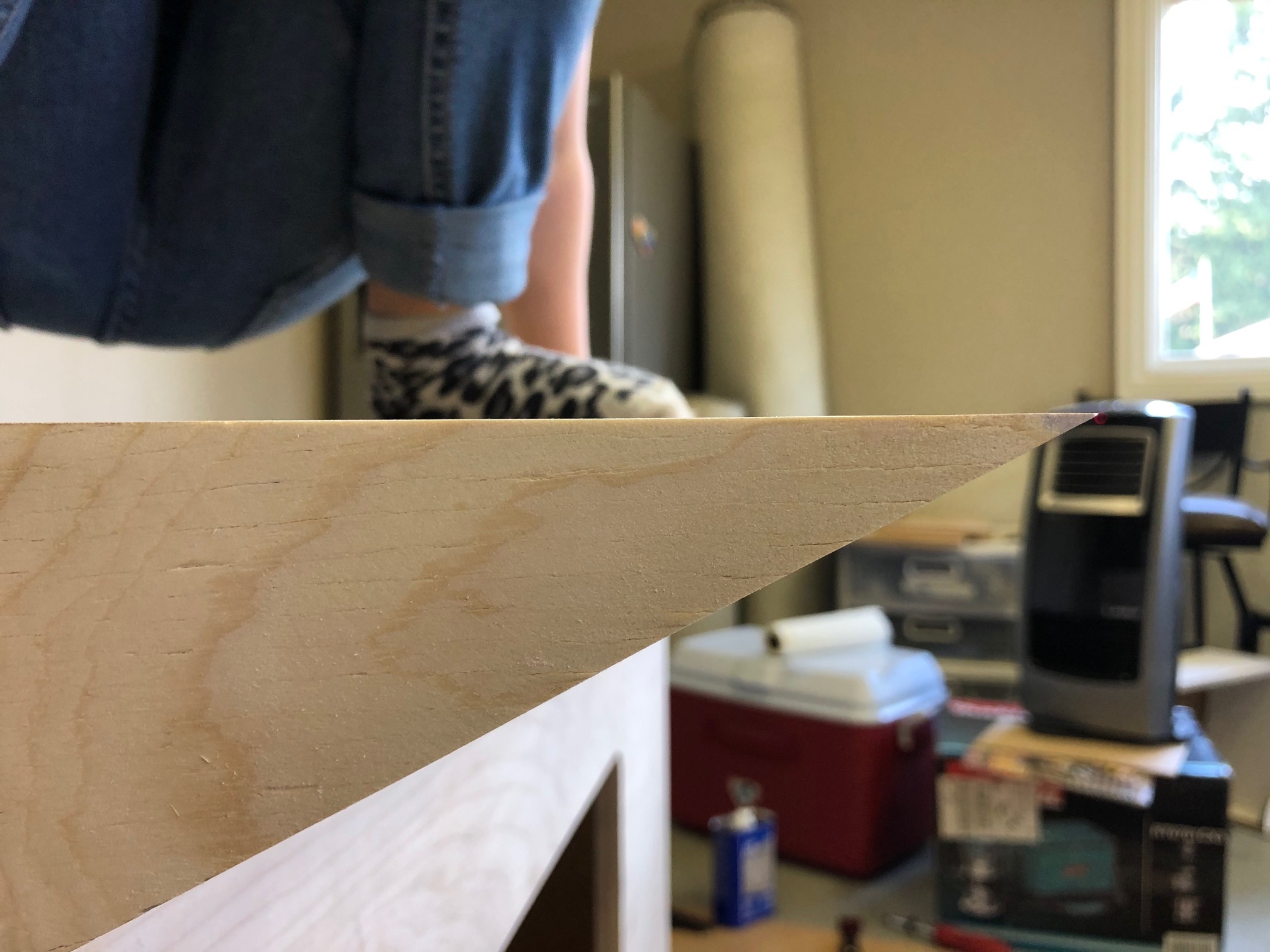

« Reply #488 on: February 13, 2020, 01:04:39 pm »
Paper shredder - :)
Alright, alright I’ll put up the damn backboards. :)
Some more gratuitous shots:
Probably will paint the speaker tweeter cover black so it doesn’t show, but that’s a problem for future me.

I don't envy future me. He has a lot of ---steaming pile of meadow muffin--- he is going to have to deal with.

« Reply #491 on: February 13, 2020, 03:54:13 pm »
I smile every time I see a new picture in this thread.
Seriously.  Just look at those cut lines.  SO FREAKING CLEAN.
Re: The Grid....
« Reply #492 on: February 13, 2020, 04:01:36 pm »
He is a human CNC.
Arroyo
  • Posts: 1558
  • Budgets are boring
Re: The Grid....
« Reply #493 on: February 13, 2020, 05:08:43 pm »
Ha, you guys are funny, I’m blushing.  Routers are the best though, they make you look like you are more skilled then you really are
« Last Edit: February 14, 2020, 06:56:52 am by Arroyo »

Got the Acrylic flush cut and screwed down in the back:
Close up of the layers:
That’s wood, Black vertical grade laminate, and 1/4” Acrylic (which is really 0.236”)
Straight edge with a clamp and router to make it nice and straight.
Protected the Acrylic with some painters tape for the laminate treatment.
Laid down the laminate.  First precut the side that meets at the joint at the top with a straight edge.  Used the same technique as before with my brother-in-law’s assistance.  This time used another sheet of laminate as a buffer between this piece and the wood.  Got the corner lined up perfectly and pressed it down, then slowly removed the buffer laminate and glued it down.  Flush trim cut with the router everywhere EXCEPT where the two pieces meet.  As you can see the problem is the router base bumps into the other corner preventing it from cutting all the way.
To get around this I created a bridge:
Cut the angles on the piece of wood so that it could sit flush with the two sides, and used double sided adhesive to keep it in place.  Used this as a platform for the small router to flush trim the rest.
Didn’t quite get it all so I used wire cutters to cut away as much as I could of the laminate, and then sanded down the rest.  Thank God for the painters tape, it really kept me from ruining the Acrylic:
Time to cut out the holes:
Flush trimmed with the three sides, then used the straight edge as a guide for the front laminate.  Turned out good:
Lastly a little bling to keep it going (this was done before the laminate treatment):
And NO, it won’t look like this in the final build, just a lazy demo real of what could be done.
