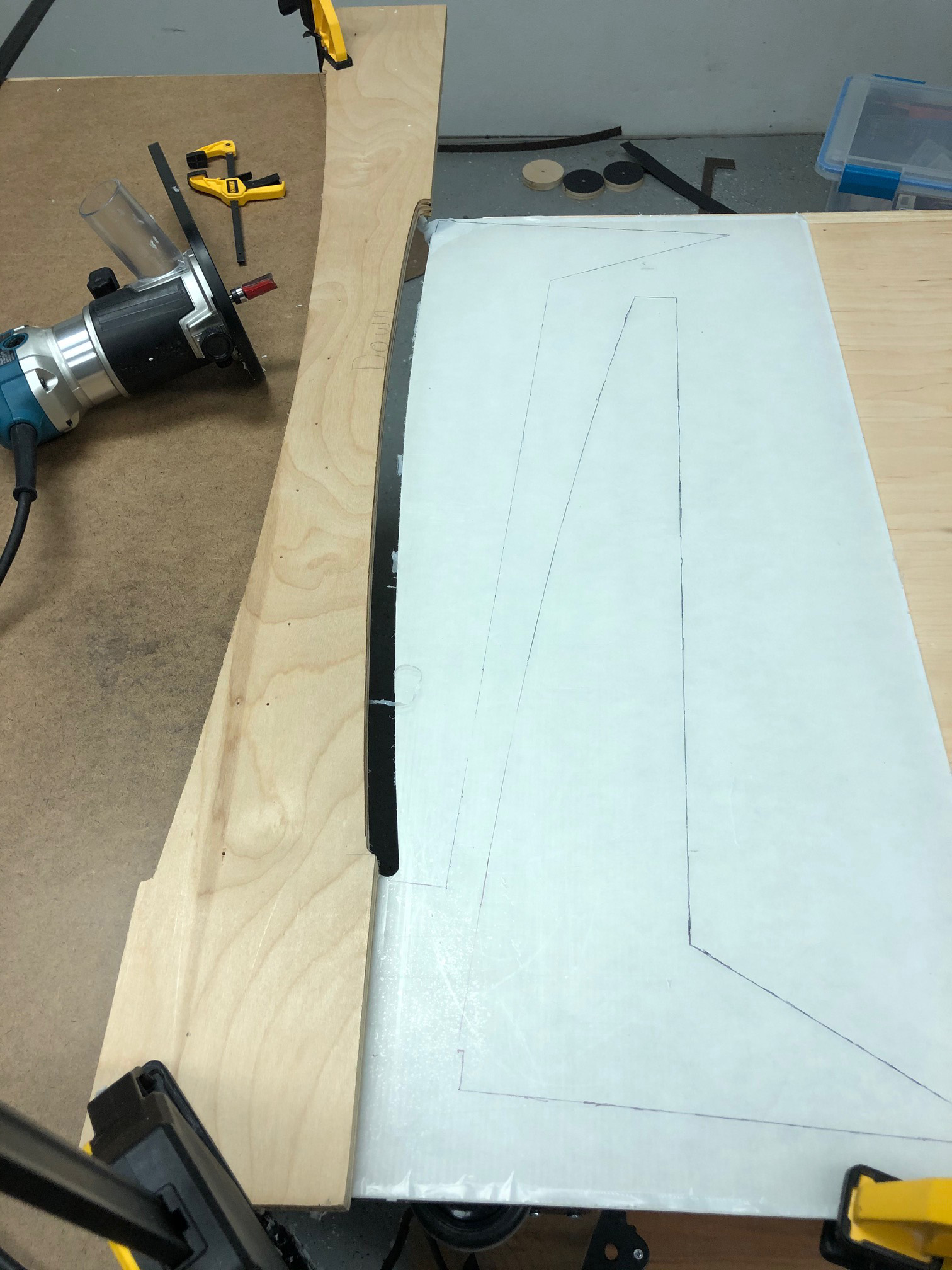

So how has the laminating process been going?  I know it is easy to do but do you find it tough to then lay out lines and stuff for assembly?
I had a lot of apprehension about the laminate.  I think it was the whole instant bond thing that I was worried about.  After doing it a few times it’s not that bad.  The two pieces of advice I would give to myself again starting over would be:
1.). Make sure that after you cut the PVC pipes (or whatever you are using to separate the wood and laminate before application) that you sand the ends/edges.  The one thing that you do have to be somewhat paranoid about is making sure you have a clean area.  Any debris that gets on the contact cement will be hard to spot but you will be able to feel it under the laminate after application.  This happened to me on the lower half of one of my sides.  Luckily that is buried between that lower half box so you’d never know it.
2.) Don’t be stingy on giving yourself some play room on the cut.  As Szabo’s advice in the video I linked above says, I’d give close to 2 inches all around, especially on big pieces like the sides ( I did 1.5 inches in the small pieces FWIW).  The last thing you want is to get off alignment and then have bare wood poking through.
2.). As for the lines of assembly.  I’m largely avoiding that problem by not laminating the interior.  Saves money and headaches.  I may still have to do it on the marquee area in which case yeah it will be an issue.  If I do I will be sure to post what I did.
Yours looks much more impressive both lit and unlit.  My outer ring has an almost yellow tinge to it in the daylight.
As I’m sure you know the photograph isn’t quite the same as IRL.  The outer ring is white un lit, however when lit the LED’s he sent have almost a blue tint (doesn’t show in the pics).  The inner ring is exactly like the pic, nice neutral white.  I’m going to replace the outer ring LED’s anyway with addressable LED’s and match the color temperature so that it looks like it does in the pic.

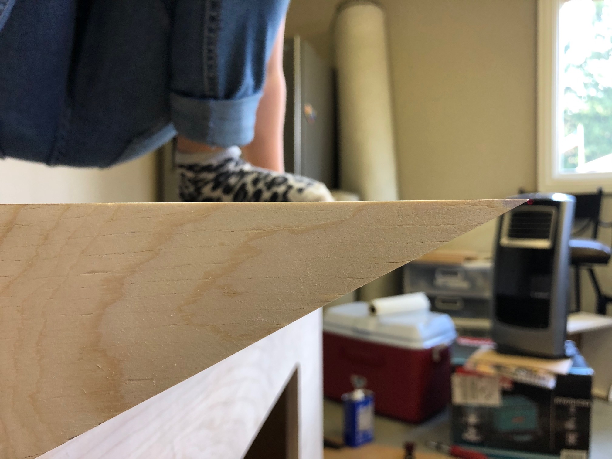

« Reply #483 on: February 13, 2020, 08:58:37 am »
« Last Edit: February 13, 2020, 09:19:17 am by Arroyo »
  • Posts: 5913
  • Last login:February 03, 2026, 02:03:18 pm
Re: The Grid....
« Reply #484 on: February 13, 2020, 09:02:49 am »
You are making my neck hurt.
When the pic is oriented correctly it looks like a monster.
Big pointy teeth and glowing eyes.
Arroyo managed to pick just about the only theme that I think justifies a bunch of glowing lights.

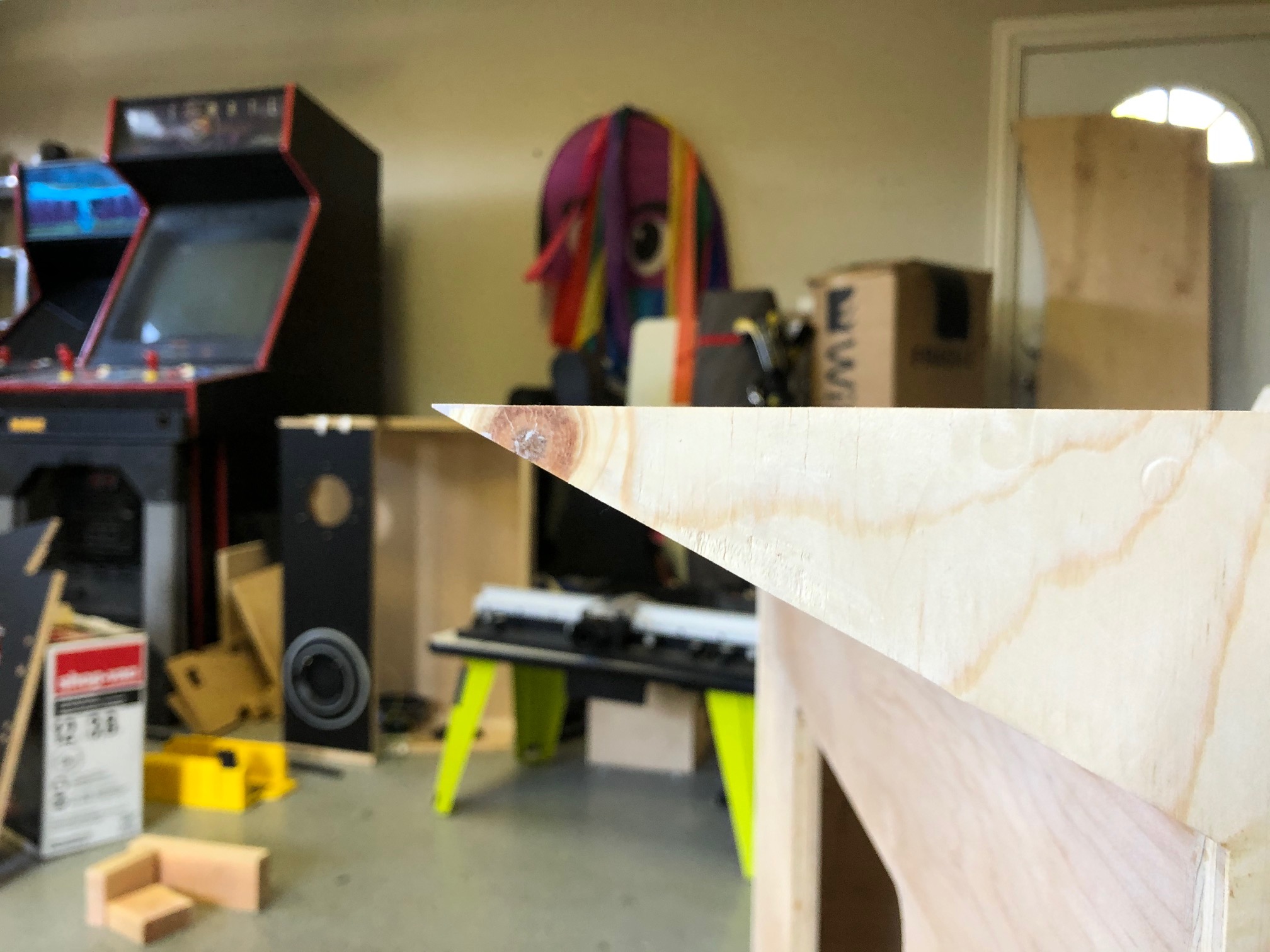

« Reply #488 on: February 13, 2020, 01:04:39 pm »
Paper shredder - :)
Alright, alright I’ll put up the damn backboards. :)
Some more gratuitous shots:
Probably will paint the speaker tweeter cover black so it doesn’t show, but that’s a problem for future me.

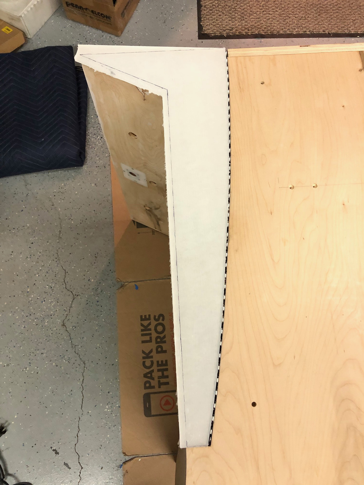

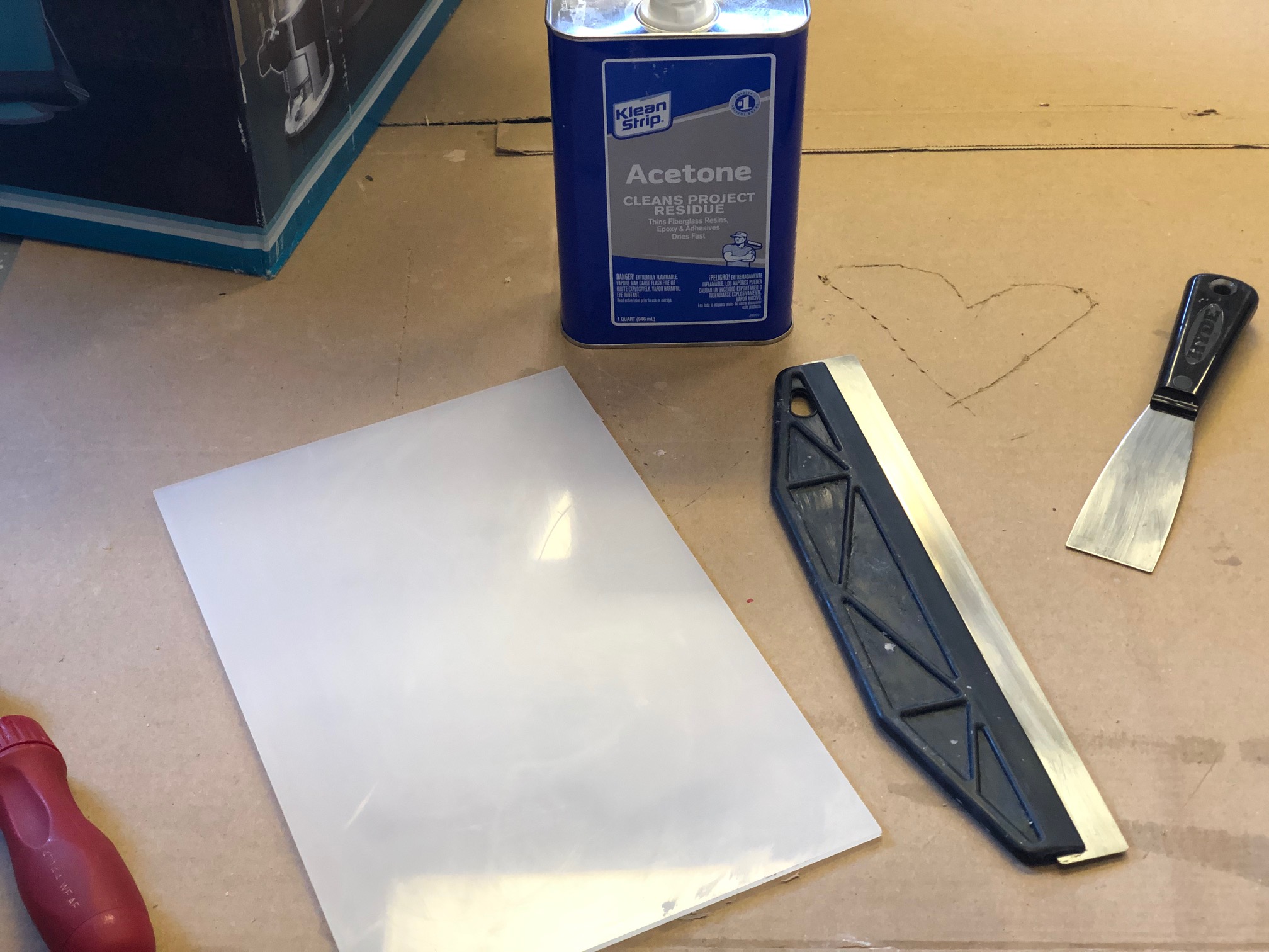

I’d been avoiding this part for a long time.  My three previous attempts at using Bondo were less then stellar.  I would go through 2 or more sanding pads as they would gum up every time I used them on the Bondo.
I finally figured it out.  The reason everything was gumming up was that the Bondo wasn't fully cured despite my waiting more than the recommended time.  This was because I wasn’t putting enough hardner in it.  The amount you use always seemed like guys were just eye ballin it when watching them on Youtube.  Turns out it’s ok if you don’t use enough hardening agent, all you need to do is bust out the heat gun and hit the stuff for awhile till it’s nice and hot.  Apparently that’s all that the hardening agent really does anyway.
Before the Bondo would always have a bit of stickiness to it and seem a bit brittle like I could break off pieces.  After getting it right there is no stickiness, and the stuff is rock hard.
My tools (keeping Acetone on hand is critical for cleanup):
First go at smoothing out the surfaces and crevasses:
Took about 3-4 rounds in various places but I finally told myself it was as good as it was going to get:

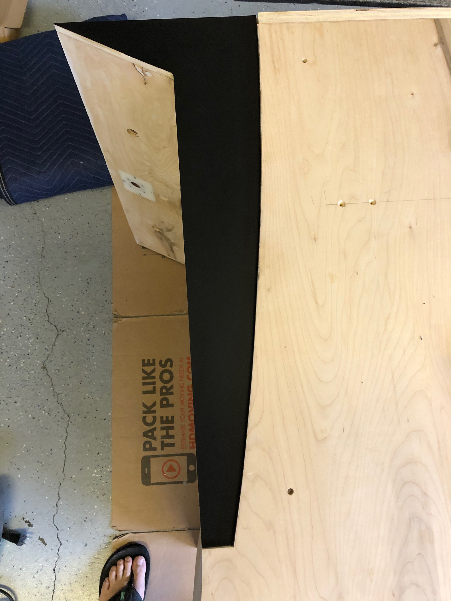

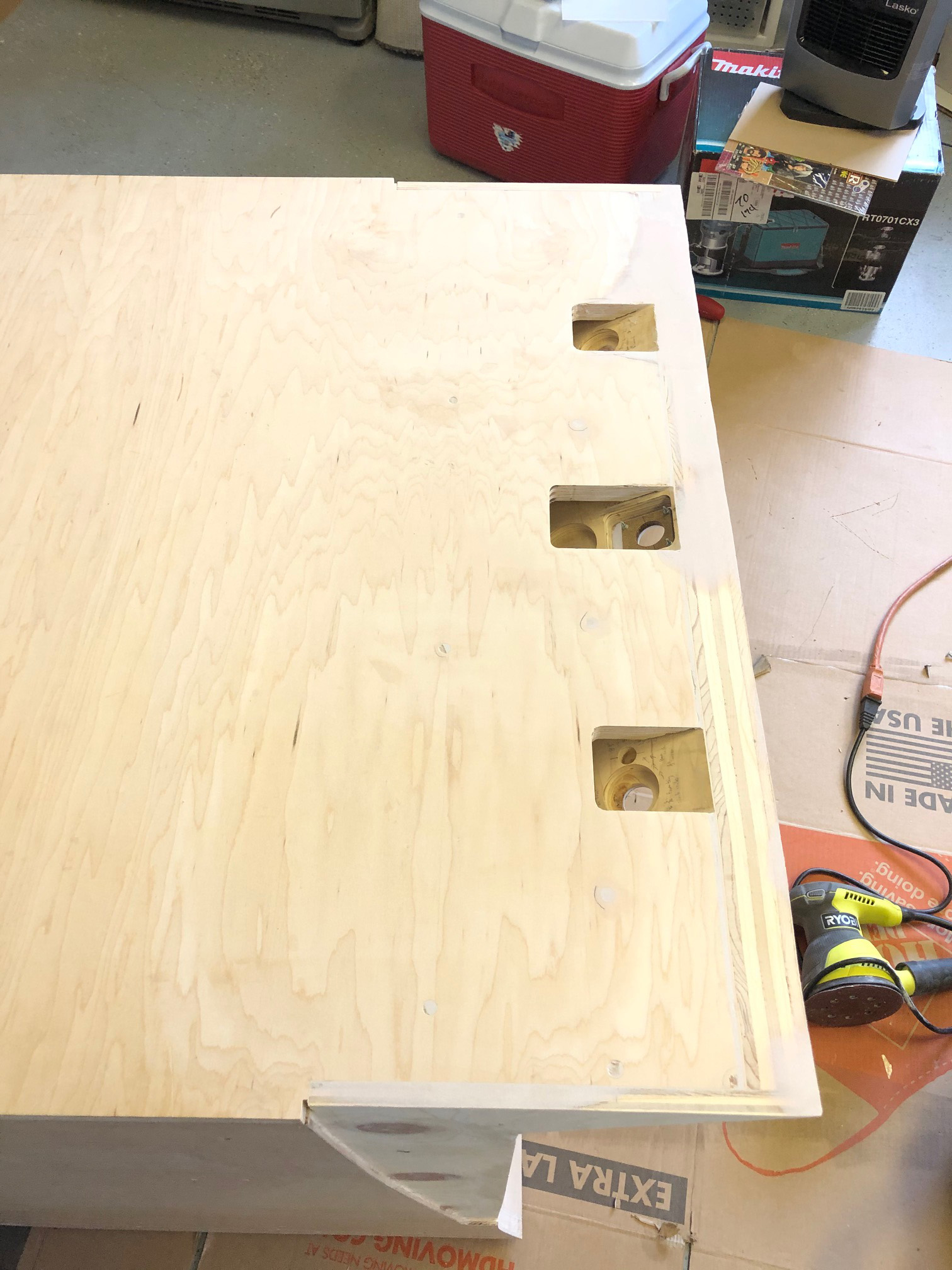

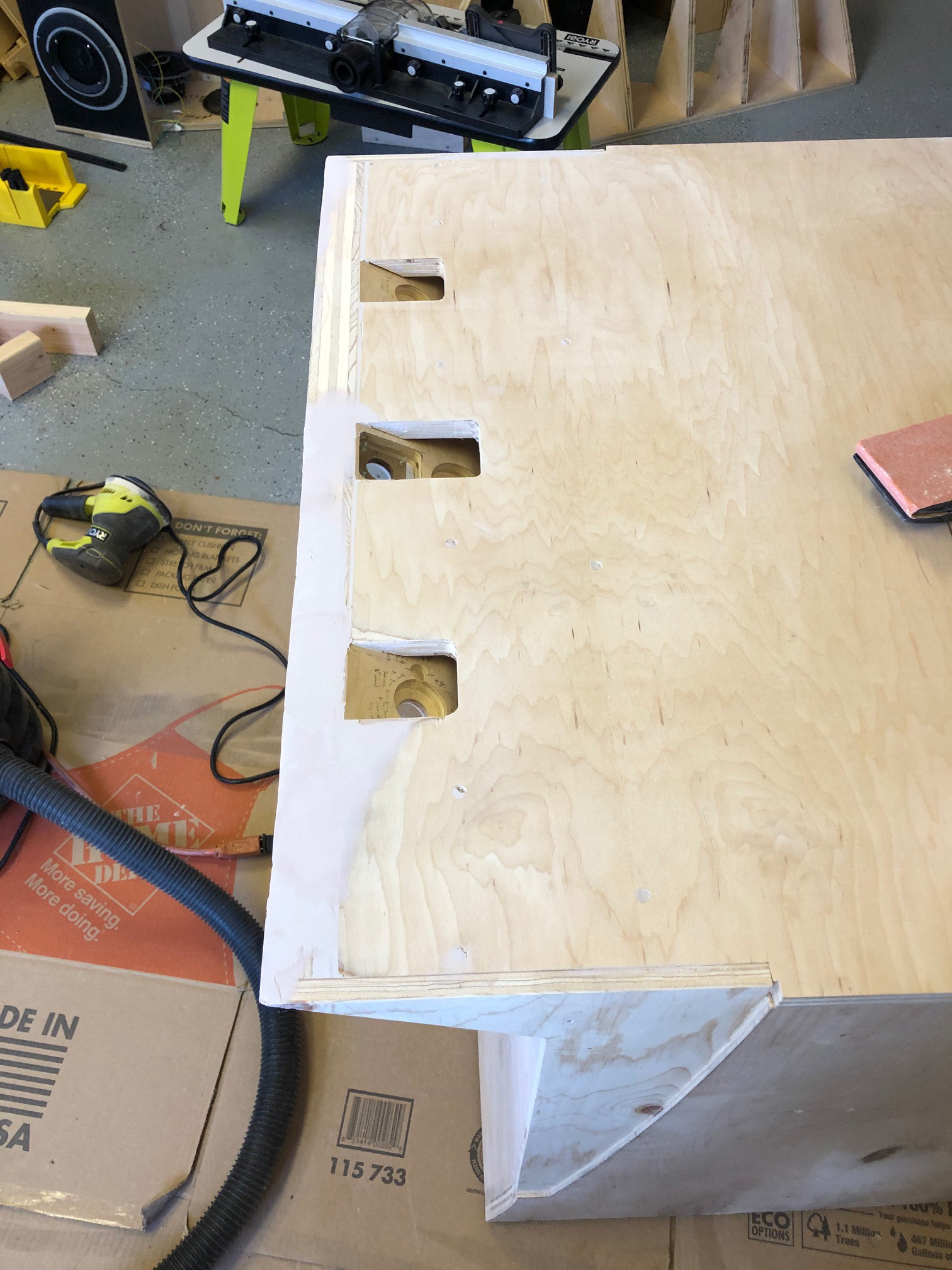

Time to cut out the Acrylic insert (used the same guide as I had made before):
I always hate cutting this stuff, the cut flakes are statically charged so they fly everywhere and stick to everything.  I always wear a mask, but with this stuff I make double sure, the smell is awful.
Used the Acrylic as a guide to cut out the laminate:
Had my brother-in-law help me by holding a piece of thin cardboard between the laminate and the wood (in lieu of PVC pipes to keep the two surfaces separate).  I was able to get my alignment down and then press at the most important part at the bottom and then he slowly pulled up the cardboard while I rolled the laminate on.

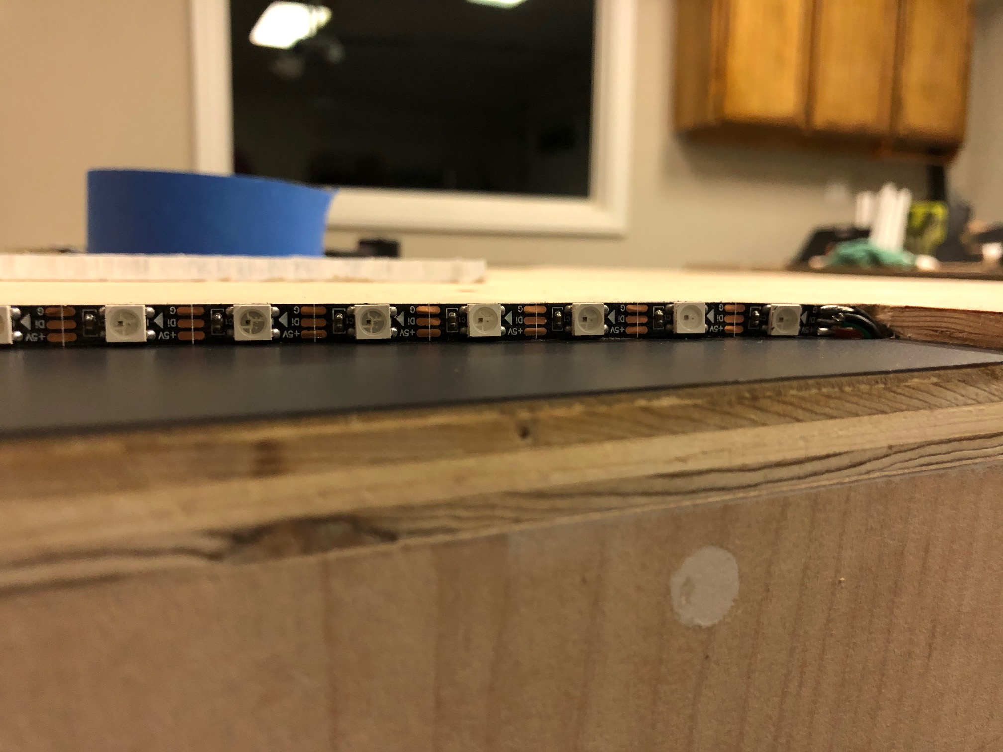

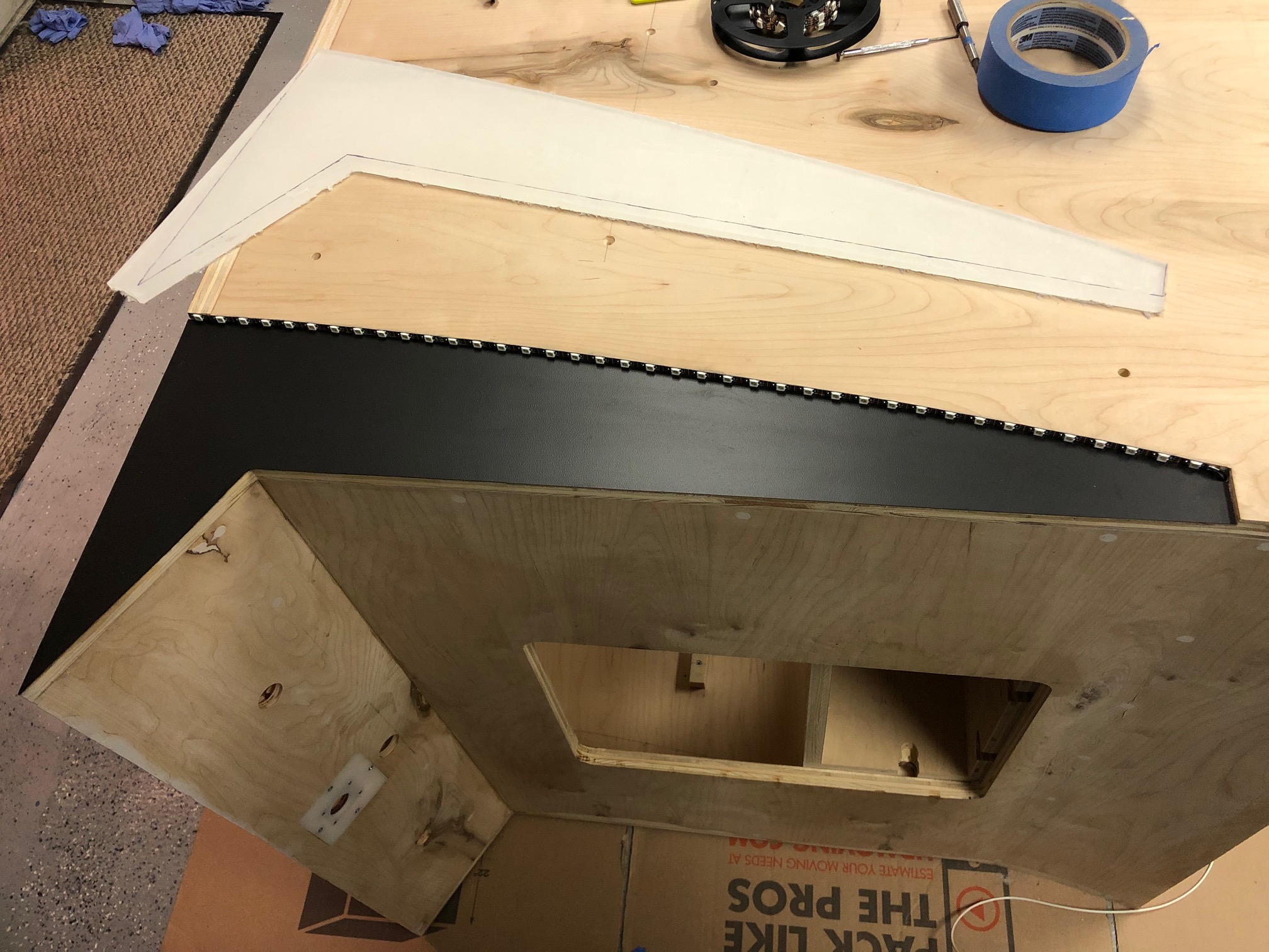

Used the router to flush trim the laminate:
Installed the thin 5mm wide addressable LED strip from Aliexpress:
Drilled a hole in the very corner to get the wiring through.  Tested my soldering work on the Arduino before installing:
Ran out of time to do any more.  Might be able to get something done during the week, but this coming weekend we are out of town so this will just sit in the garage for a bit.  I hate waiting for free weekends.
An auto body friend of mine gave me some solid advice about bondo hardener: ‘make your mix pink like p :censored: y, and it’ll be “hard” enough’ :lol

Got the Acrylic flush cut and screwed down in the back:
Close up of the layers:
That’s wood, Black vertical grade laminate, and 1/4” Acrylic (which is really 0.236”)
Straight edge with a clamp and router to make it nice and straight.
Protected the Acrylic with some painters tape for the laminate treatment.
Laid down the laminate.  First precut the side that meets at the joint at the top with a straight edge.  Used the same technique as before with my brother-in-law’s assistance.  This time used another sheet of laminate as a buffer between this piece and the wood.  Got the corner lined up perfectly and pressed it down, then slowly removed the buffer laminate and glued it down.  Flush trim cut with the router everywhere EXCEPT where the two pieces meet.  As you can see the problem is the router base bumps into the other corner preventing it from cutting all the way.
To get around this I created a bridge:
Cut the angles on the piece of wood so that it could sit flush with the two sides, and used double sided adhesive to keep it in place.  Used this as a platform for the small router to flush trim the rest.
Didn’t quite get it all so I used wire cutters to cut away as much as I could of the laminate, and then sanded down the rest.  Thank God for the painters tape, it really kept me from ruining the Acrylic:
Time to cut out the holes:
Flush trimmed with the three sides, then used the straight edge as a guide for the front laminate.  Turned out good:
Lastly a little bling to keep it going (this was done before the laminate treatment):
And NO, it won’t look like this in the final build, just a lazy demo real of what could be done.
