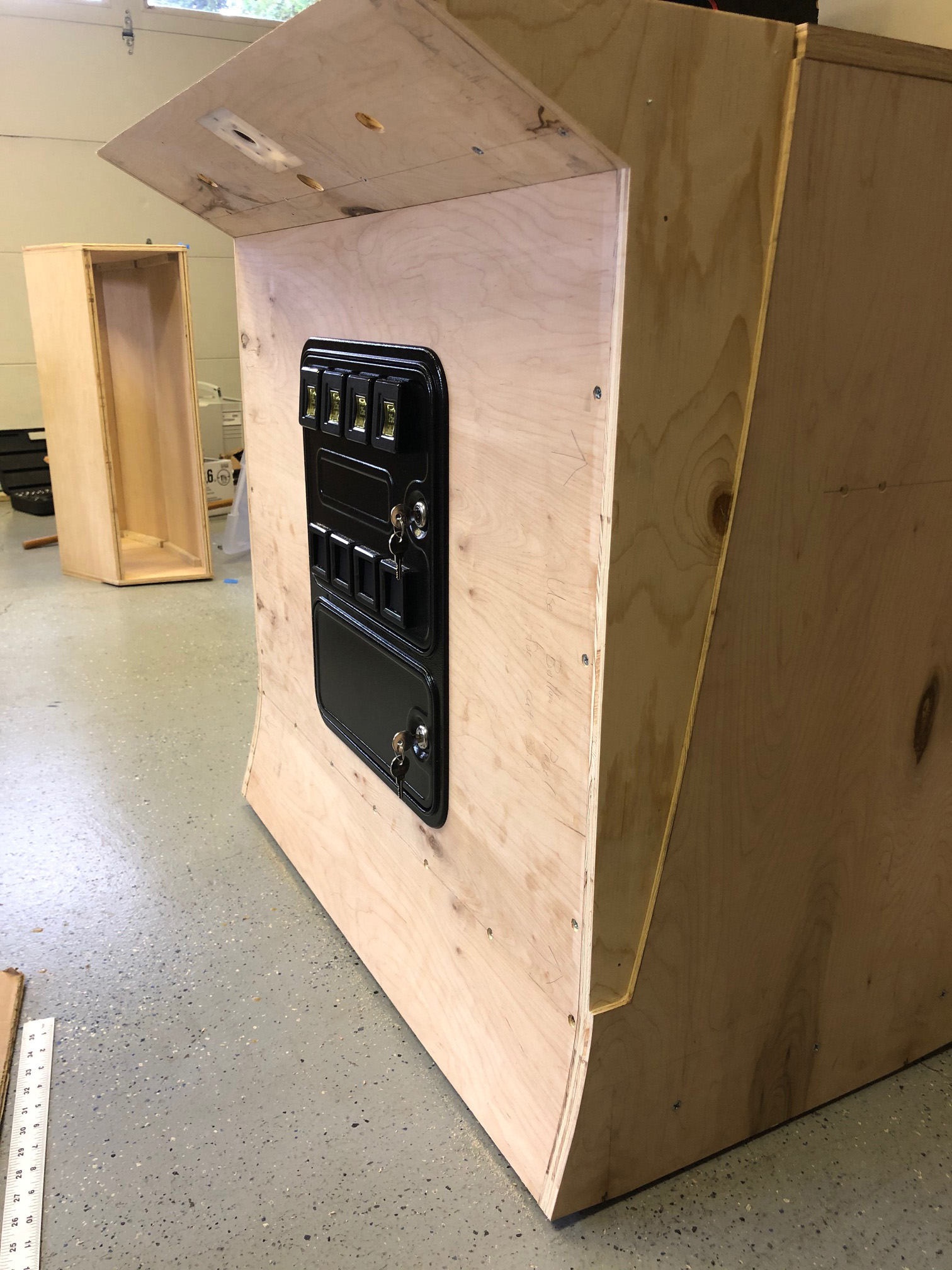

Anyway, I got to spend the better part of this weekend working and knocked out a bunch of stuff.
First was routing out the sides to get ready for the P95 clear Acrylic inlay that will light up the sides for “glow corners” wp34 had given me that idea awhile back, and for a little while I was thinking of getting the acrylic etched to extend the side art, but it was expensive and I think just too much, so instead it will be an even glow.
Did the usual bender board to cut out the sides and make them even:
That's a lot of passes with the double flute straight router bit, both sides probably took 2 hours.

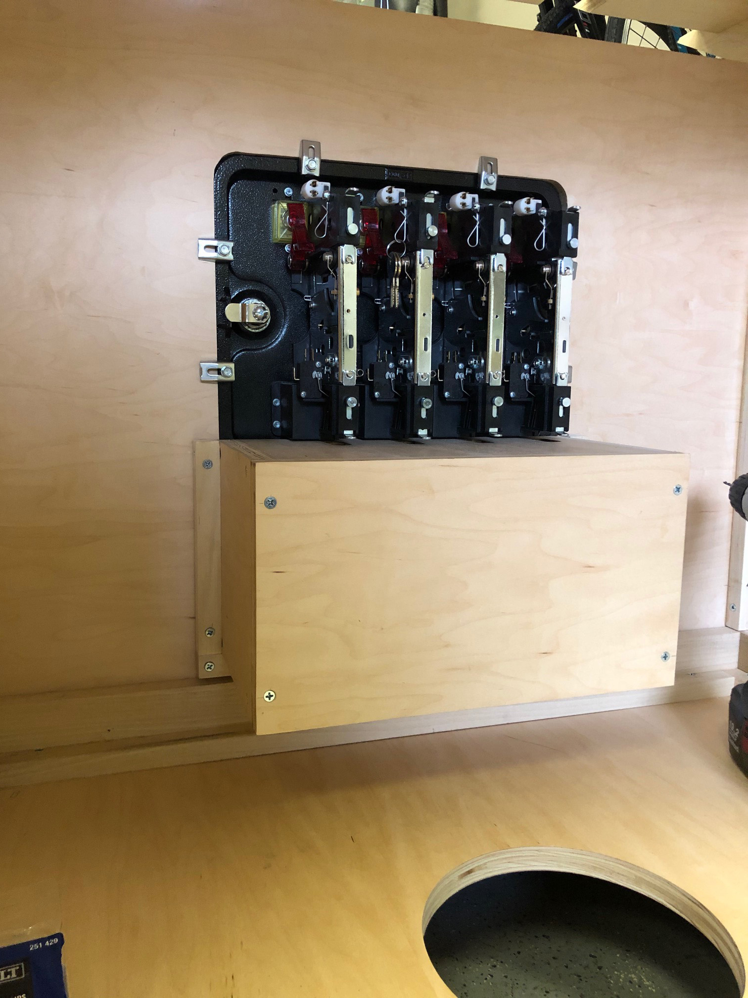

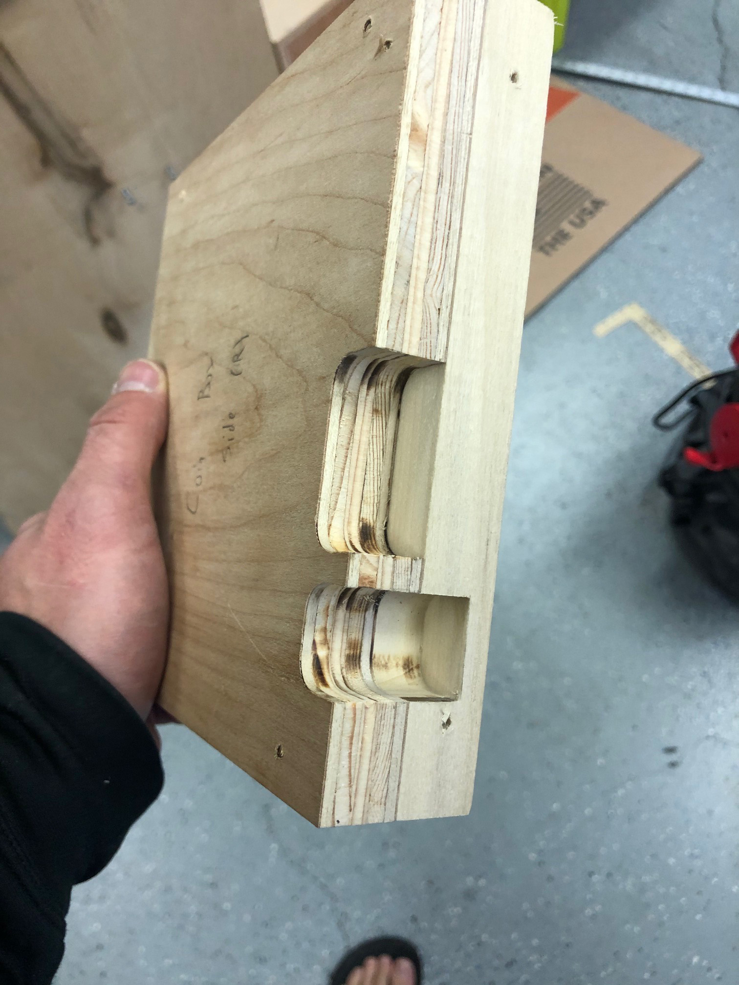

Then moved on to tackling the coin box problem.  I had been avoiding this for a long time as I couldn’t figure out what I wanted to do.  I spent quite a while this weekend in Sketchup designing what I thought would be a good design.  I was heavily influenced by the Nintendo coin boxes and wanted to design soothing in that vein.  Problem was getting around the support clips of the coin door and getting it close enough to catch the coins.  Here’s what I came up with:
Another hilarious setup to make some cuts.
Here it is against the coin door, you can see the cuts for the support clips, and door cam lock.
I also worked on the coin box that will go inside, and just clear the coin door bottom.  I actually already built it but hadn’t properly accounted for the depth of the cam lock, so I’ve got roughly 3/32 to shave off.

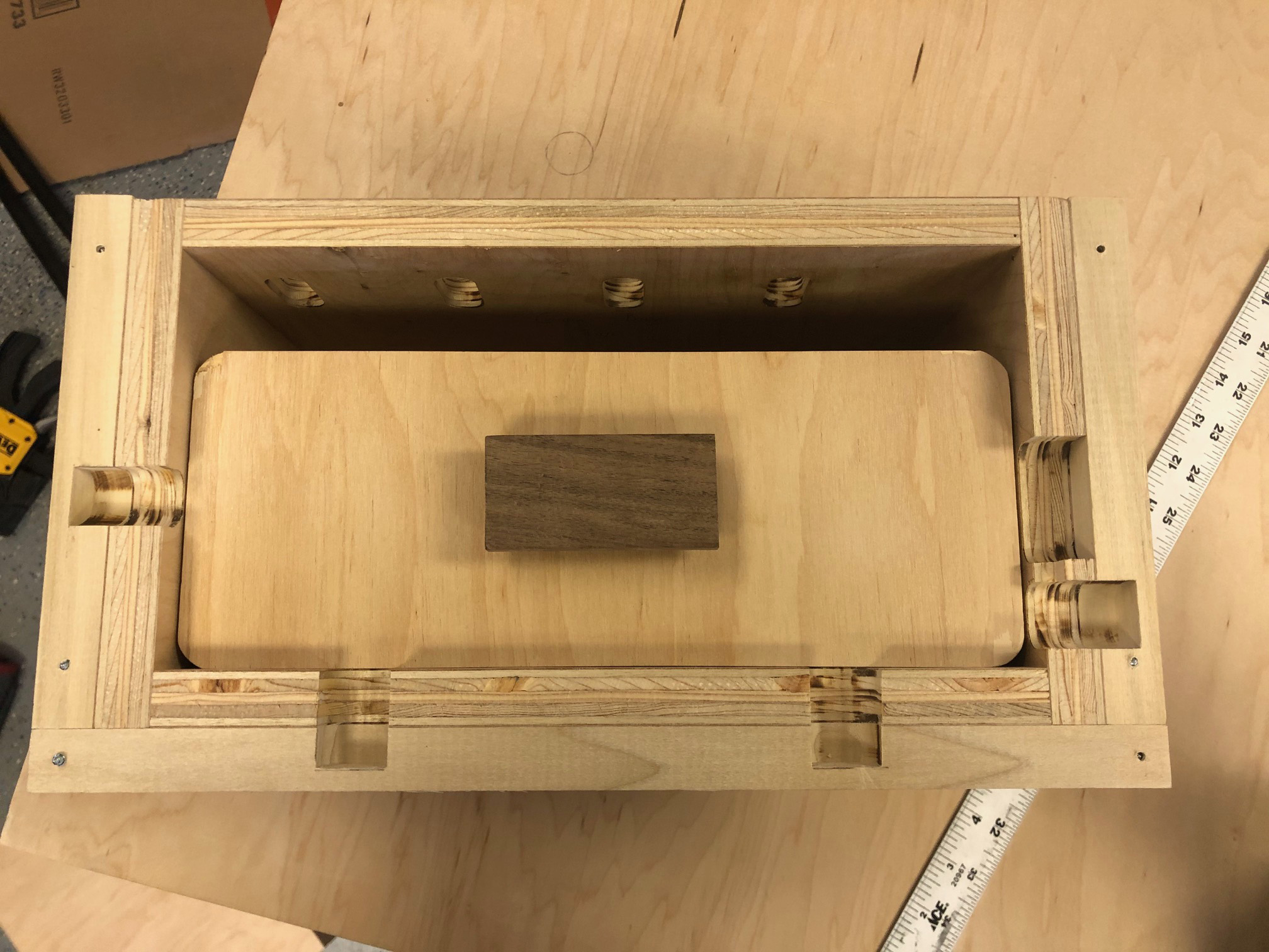

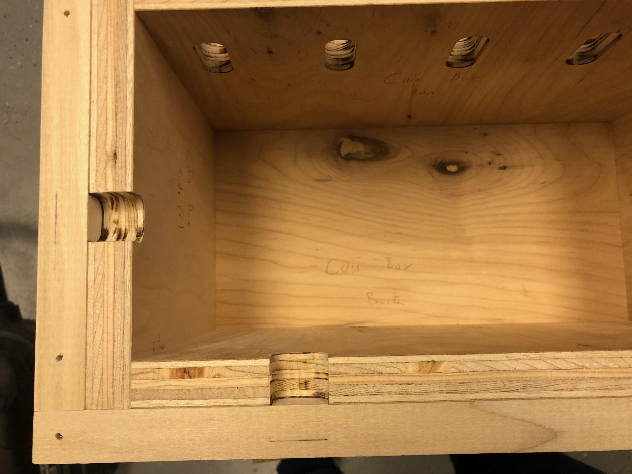

I had built the coin box over the weekend but it had height and depth issues for things I hadn’t accounted for (note to self, always draw EVERYTHING for a part in Sketchup, no short cuts!).  As mentioned I wanted to go for a Nintendo Style coin box, so I grabbed some 1/2” birch and 1.5” x 3/4” solid walnut.
Used the ½” 45 degree chamfer router bit and ran the walnut through the router table:
Cut off the last side and ran it through using push blocks.  Mounted it to the ½” coin drawer box and voila!
Only problem was I needed to route those corners so that it would fit through the coin door opening.  Here I made a couple of boo boos.  First off I should have pulled up my big boy pants and tackled using dowels as it would have been nice to avoid the pocket holes left from the Kreg jig.  Second was I should have used my ½” round over bit on the individual pieces rather than trying to use it on the completed box.  Got some blow out which I should have known better, but nothing a little wood filler can’t solve.  Live and learn:
Fit nicely once I made all the changes, and I’m pretty chuffed.

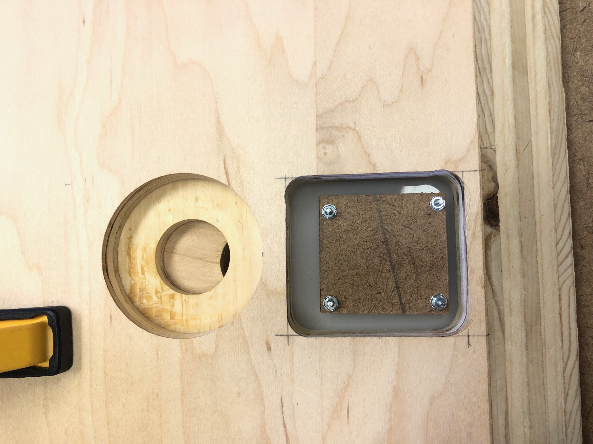

This little guy is going to play a very important role in the build:
But getting it mounted and exposed was a challenge.  I had to think quite awhile before coming up with a solution.  I needed something strong but thin, considered metal, but didn’t have a good way yet to cut some of the dimensions, so opted for plastic instead.
Here you get the idea:
The three holes are for USB ports and a power switch (Forstner bit cut into scrap, then used as a jig for the pattern bit on the router).  The hole in the top part is here the device will sit.  To mount the plastic I need to inlay the material and as it was only about 3mm thickness I couldn’t use my usually pattern bit so I bought this tracer bit:
It worked really well.  Getting an inlay to line up for both dimension and depth can be a challenge.  It took my three attempts at getting the depth just right, as I was paranoid about removing too much material.  To do it I just traced the plastic piece onto some scrap 1/2” wood and then cut it out to make a jig.  It worked pretty well, but because I had to make 3 attempts at getting the depth it meant three times realigning the jig and as you can probably tell in the picture I got one of the times miss aligned a little on the top…not a big deal as this will all be covered by laminate, but the depth was crucial and thankfully with the countersunk holes and screws it is smooth to the touch all over.
I had to use tiny M2 screws in the middle to get the device setup but it was worth it as it all came together.  Any guesses on what it is going to be used for?
Last gratuitous pic.  Lot of time in that one piece.  Damn I love this hobby.

Went to finish off the electronics insert in the USB panel.  The challenge here was that the plastic is too thin to use as a guide, and because I am going to cover the outside with laminate I needed to thicken the guide.  Because the alignment needed to be precise I had to first drill the hole as I won’t be able to see anything once the laminate is covering it.  So I drilled the 23mm hole in a piece of wood, then used it to shine a light underneath so that I could align the hole (this would have been a lot easier if I had used clear acrylic  :banghead:):
You can see the circle outline and how I needed to align it with the edges of the plastic support piece.  The circle needed to fall exactly within those lines otherwise it would be difficult for future me to get it to align.
Used 2 pieces of 1/8” hardboard and used the existing screws to keep it in place:
Then cut it out with the template that was on the other side screwed in from my light alignment, thankfully it came out good:

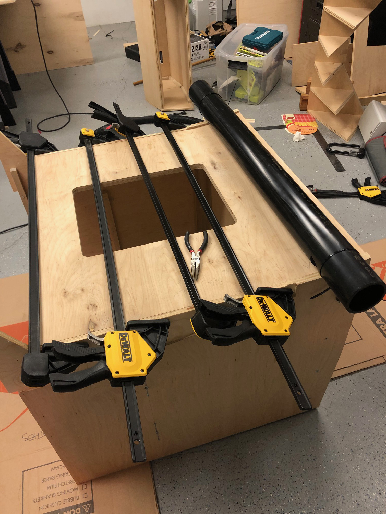

Front side:
Repurposed the piece of plywood I used to practice kerfing as a support board for the middle which will hold the computer, amplifier, Arduino, and other electronics (slot cuts are on the underneath side).  Also cut the hole for and inserted the speaker terminals.
Decided I was tired of looking at that coin door in the corner and got to gluing and screwing.  Spent a lot of time mulling this one over and a big shout out goes to my man Bobby P (bperkins) for holding my hand and replying to all of my incessant e-mails.  He gave me the idea for the pipe and zip ties to clampdown the wood against the curve pieces:
So much clamping and gluing but it came out good:
I had to put in 6 screws at the top of the curve to make sure the coin door plywood mated with the curves.

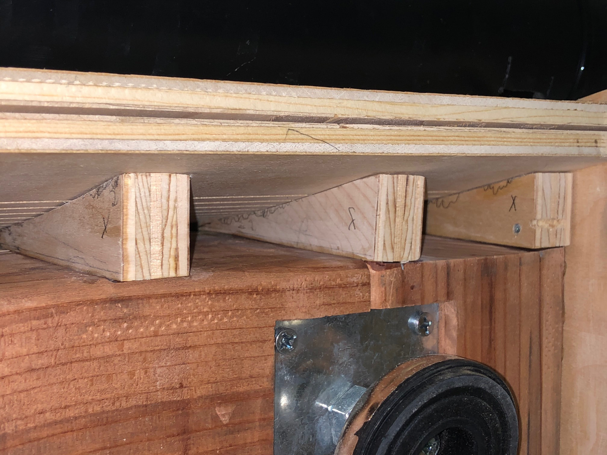

Got to finally install the coin box and drawer, with one little hiccup:
The 3/4” battons were blocking the clamps.  Good thing I hadn’t glued the coin box, and could use the existing cuts as a guide:
That’s better:
And installed:
Here it is in action:
