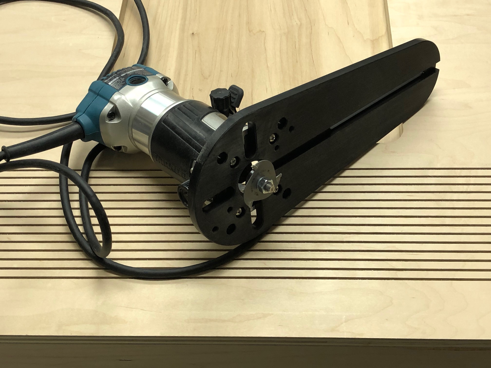

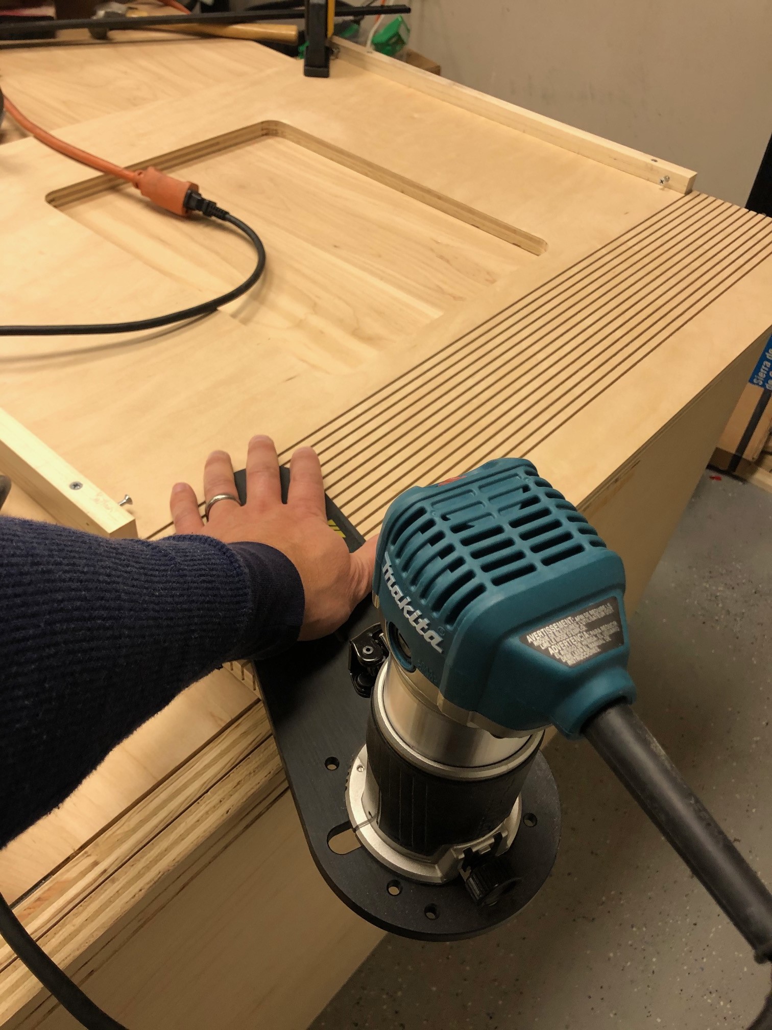

Wasn’t able to get a whole lot done this weekend.  I prioritized picking up an Asteroids cabinet yesterday and am pretty chuffed about it.  There really is no comparison to seeing it on a vector monitor vs. a raster in Mame.  The bullet shots are stupid bright, almost like a firework.
Anyway I did manage to practice with the new circle jig that I bought for the Makita Palm router.  Here’s a shot of the underside:
The metal cylinder sticking out (silver next to the red bit) acts as a pivot point.  You measure from the outside of the blade to the middle of the metal cylinder and you can get your perfect circles.
First one came out OK, biggest challenge was lowering the bit down steady.   You can see the challenge I has on the left side:
You may be able to tell from the picture, but there is a separate metal cylinder, that you place below so that the pivot point doesn’t move once you get close to completing the circle.  Works surprisingly well once you get the lowering part down:
I also managed to shop for the 3inch PVC pipe I will use to secure to coin door curve against the 11 curvey things and get it glued down with screws and zip ties (thanks bperkins!).  Hopefully I can get to it on Sunday.

« Reply #367 on: October 07, 2019, 12:42:53 pm »
Gonna have to get myself one of those circle jigs - I'm forever hacking stuff together to make proper circles - lids, tin cans etc.
One question - is it awkward to move around with the cable hanging from the router? I've recently picked up a little router that's a great little tool when you don't want the weight of a full size one but I'm assuming that using this the whole router is doing a 360 when you cut a circle?

Nice circle cutter..  WAY better than hole saws..

I prefer a hole saw for circles up to 5 inches. There is no setup time and it cuts fast and clean. I can see its usefulness for larger circles or cutting arcs.
Would have never guessed it based on the quality of your work. :cheers:
The most awkward part was the vacuum hose attachment.  As it is much stiffer and larger it likes to catch on edges, but it really didn't end up being a big deal.  The electrical cord I hardly noticed.
Yup, you spin it around that pivot point, and because the pivot point is secured to a sacrificial piece of wood below it is very stable.  A bit of a setup, but gives you a lot of confidence in making the cut.  BTW this cost me $15 on Aliexpress (well $30 once you count shipping).  I just looked up my model and they have the holes pre-drilled for mounting, but also highlighted that you can drill your own with a blank version.
Good work  :applaud:
I'm a fan, but then I'm kinda anal about clean edges.  Mike is right though it does require a lot more setup time.  This hole was 8 inches so kinda necessary.  I also have large holes to do for the speaker cut outs so this tool should pay for itself in spades down the line.

Secure the pivot point below the table?
really?
Mine (may be) a little different..
I just drill a hole in the center of my circle to match the pivot - then plunge the router into the work and cut..  I will often plunge for 1/2 the thickness, cut once, then plunge again and finish..
Still a fan of the circle cutters  ;)

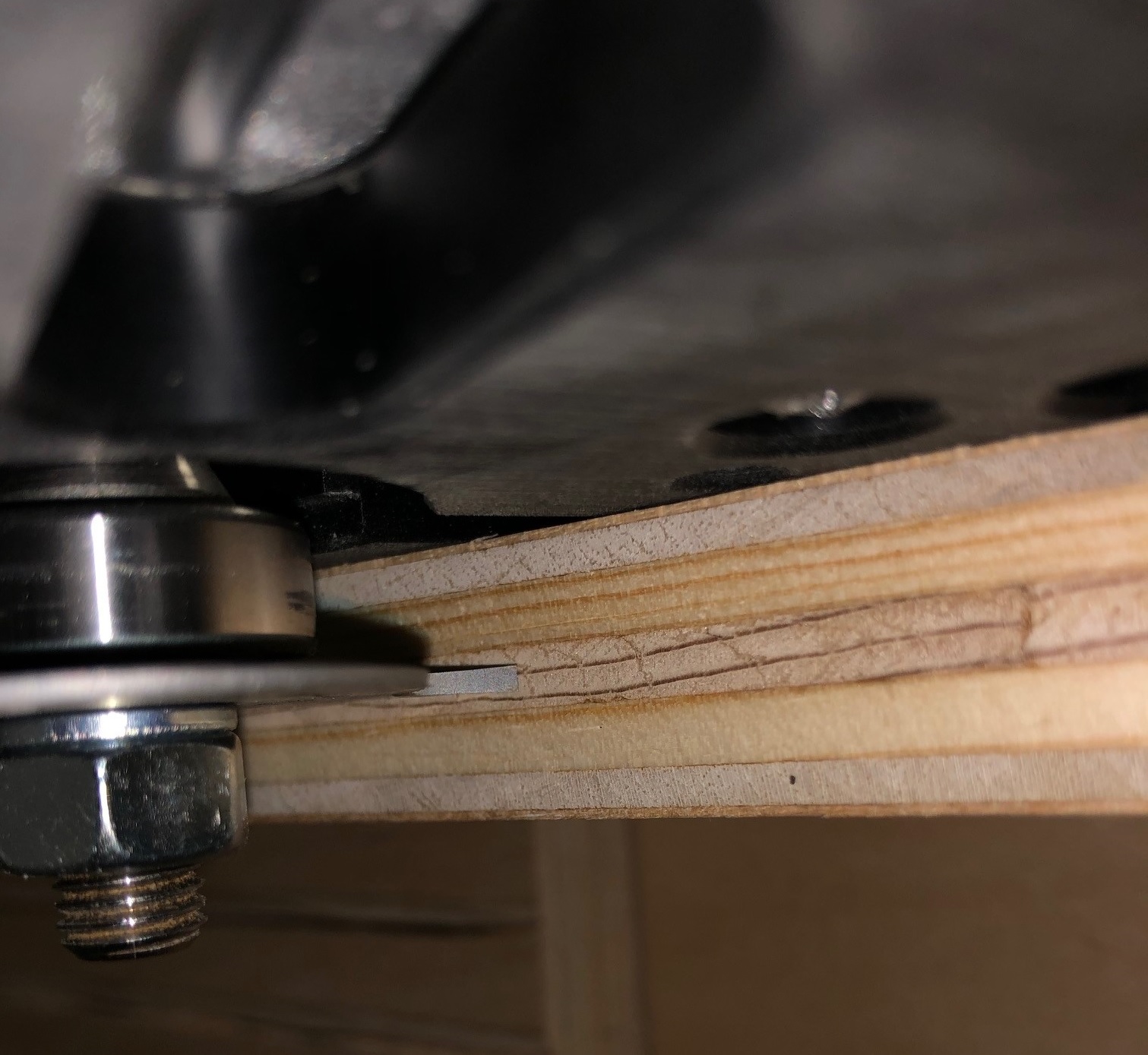

« Reply #373 on: October 07, 2019, 01:17:43 pm »
really?
The video online seemed to suggest it wasn't needed:
but when I didn't secure it my router drifted away (only at the very end) and screwed up the circle cause the pivot point wood was no longer attached to anything  :dunno (didn't take pic)
I suppose if you move fast at the end you might be able to whip through the last bit of wood before the pivot point loosens, but I didn't want to chance it.  Granted this was on that very small circle (3 inch), so on a larger circle it may not be an issue, as you could hold the pivot point wood down with your hand.
EDIT: BTW - what I like about this Jig style is not only can it cut holes about as small as possible (considering the width of the bit of course), but it isn't in fixed positions, so there's no limit on getting a specific size.  A lot of circle jigs have fixed mounting point positions, and while this makes it quicker to setup on a predetermined width, it is limiting, especially if something calls for a metric size.

oh.. I see..
You can drill right through the part and into the backer board..  and the pivot stays still...
Now I understand..
I did have to do a hole once where I couldn't drill through (boat transom)
This is what I did:
There are 2 small tabs..  I finished cutting them with a small saw by hand..
Arroyo
Now I understand..
It may look confusing from my pictures cause the pivot point isn't long enough to go through the wood and into the sacrificial board.  There is a second piece (you can see it in the beginning of the video I linked to), that I used to secure the wood to the sacrificial wood below.  I don't even know if it's designed to do that, but it worked well (the thing doesn't come with instructions).
Nice solution on your boat hole, I'd have scratched my head for awhile on that one.

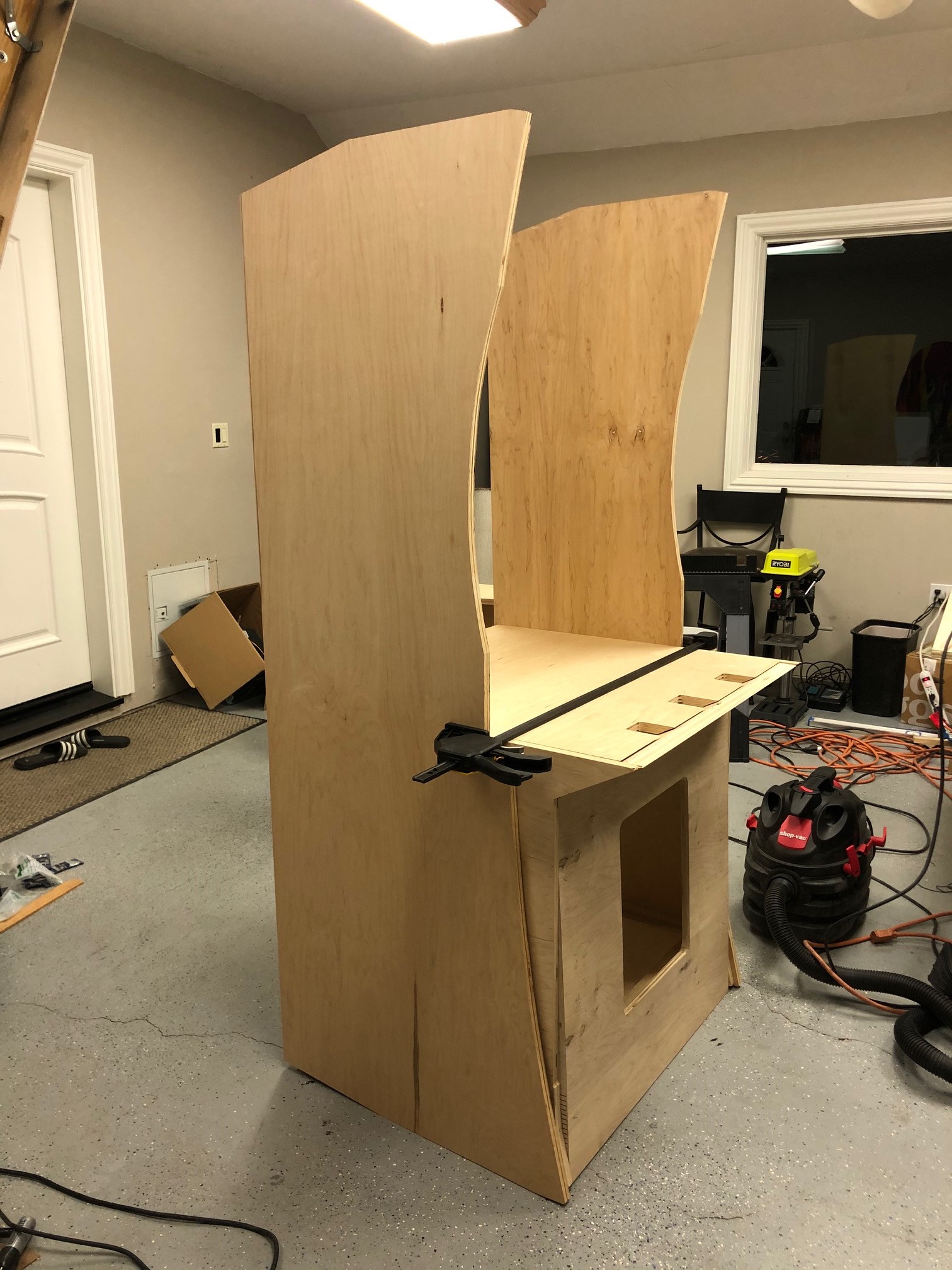

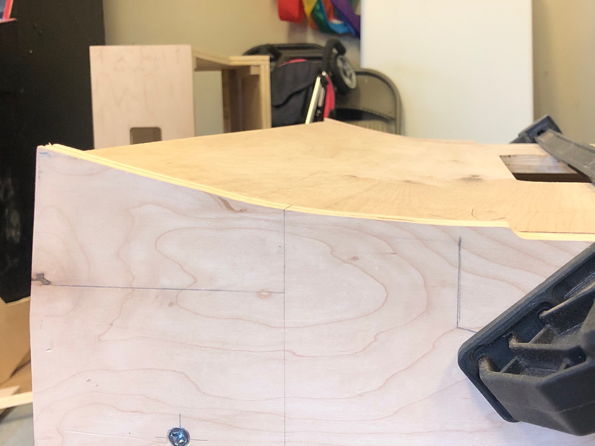

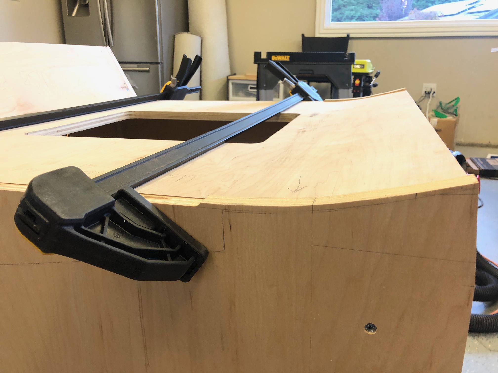

Last couple of weekends I’ve been out of town, so I’ve been shifting to trying to get things done during the week.  Bperkins said it best on a couple of other posts….. just getting in the garage and pulling off one thing per night is the way to go, even if it’s only 10 min.
The little progress starts to feel bigger once you can put things together.  I managed to get the rest of my blocking down on the base:
AND…..because of that I was able to finally test the bend on my coin door:
When I clamped that and stood up to see it holding in place without any cracking I was like:

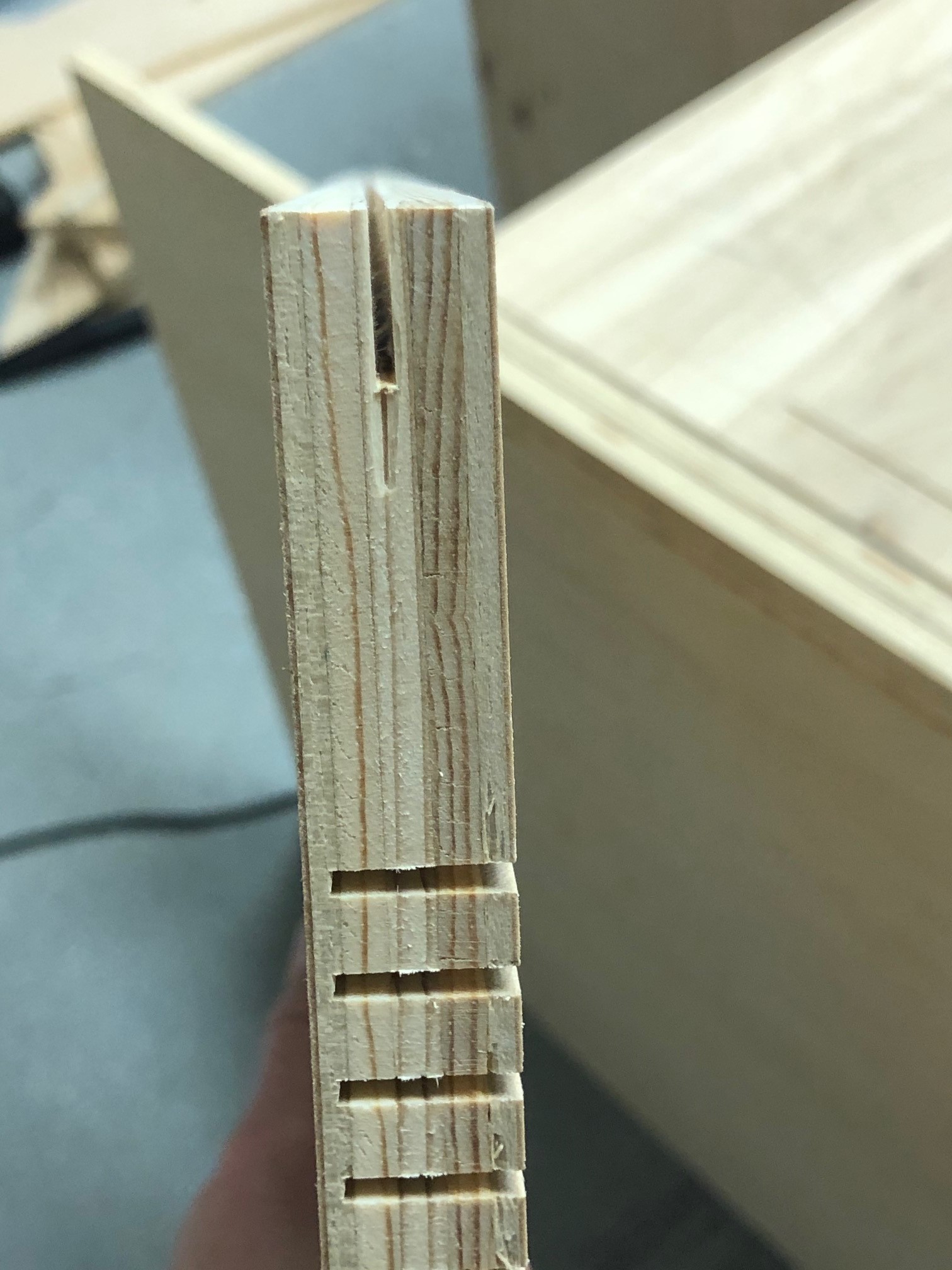

Before I had put the door on I knew I needed to finally do some slot cutting.  I have been dreading this for a long time, as I had issues with drifting when I cut my little control panel box.  On the small box I had used the router table and moved the piece.  The table doesn’t have a perfectly level surface because it has an insert that is adjustable that I have never been able to level.
Initially I tried the Whiteside 3 wing Arbour that I bought from t-molding.com in my Ryobi, but noticed that the package mentioned the maximum RPM of 16,000, my Ryobi is fixed speed at 24,000, and it felt SCARY.  Decided it would be better to use the new Makita as it has variable speed settings.  Only problem was the standard base it comes with makes it easy to tilt and not stay level with a big bit like that.  So I had the idea to use the same circle jig I bought and it worked great:
This allowed me to confidentially bring the router to the edge with no vertical movement.
To get the correct depth, I used my digital calipers to measure the thickness of the wood (side note this piece actually varied from 18.4mm on one end to 17.7mm on the other).  For this piece I had to take an average.  But I would take the thickness, subtract the bit size (1/16” in this case), and then divide by 2.  I’ve noticed that for Plywood the thickness of each piece can vary and it’s important to measure and adjust your depth if necessary.  Also quick side note I learned the hard way that t-molding can have different spline width’s, and the slot cutter you need to buy is NOT the width of the spline, it’s usually 1/32” less (website you order from usually tells you, I bought form t-molding.com).
Anyway, taking pictures just to confirm before cutting helps:
Always good to see it line up visually.  And after it’s cut:
Lastly had to slap the sides on for a little motivation just to see how it looks:
More to come……..

Here is the lazy mans way of cutting that slot:
Grab a piece of scrap wood
Put the router up to it and manually adjust the bit until it looks like it is in the middle
Cut a test slot
Flip the board over, move the router over to the slot and see if the bit slides in easily
  - if it does - you are centered - cut away
  - if not - move the bit 50% of the difference and repeat.
No math or calipers.
Loving the work!

MikeA suggested I get the strongest Shop Vac I could find, ironically the smaller one they had at Lowe's was the most powerful at 6HP.  It holds 5 gallons, but yeah the long term plan is to buy a much larger Dust extractor/separator like a Cyclone or something.
Your idea to use the circle jig to support the router is brilliant.  I will be stealing that.
It works surprisingly well, I have always worried about the router tilting on me when making cuts (it really hasn't been a big deal), but with this attached it feels rock solid approaching a cut.

My daughter's room is almost finished.  One more coat of paint. :cry:
Better post some pics on the Jack Attack thread so Jack can remember why he didn't get his machine on time  >:D
Kids had soccer games all weekend so I only got a window of time to work on the hinges that are for a flap on the Marquee.  Used the same SOSS hinges that I did on the small control panel.  This time though I used different techniques for cutting them so I figured I’d post as they came out much better.
Cut those using the same circle jig that I recently picked up.  It has two metal circular stubs that you screw in and use to keep the router in center line on a flat surface (see the video I linked to above to see it in action):
Couldn’t use the same tool for the piece that it connects to because it has an angled cut.  So I used the tilting base of the router and some wood blocking as a guide:
Came out good, but not quite as good as the other:
Here it is closed:
And opened:
Also picked up this flexible drill extension.  I was getting tired of having to screw the blocking in and out by hand with a ratchet and extension.  I didn’t have much hopes that this would work well but it actually worked surprisingly well.  You need two hands, but it works for unscrewing and re-screwing, probably not so great for the initial screw.

Mike
A guy at Rockler turned me on to them.  They scale all the way up to a standard door size (in fact I believe that’s where they made their mark).  The company has been around a long time and has a lot of street credit, again according to Rockler.
Here’s the company’s website:
https://www.soss.com
And here’s a link to the ones I bought:
https://www.amazon.com/dp/B008C7BMP0/ref=cm_sw_r_sms_c_api_i_UezVDbJ9EX0EE
Okay that is cool.  Did that base come with your router?
Yup it's part of the "package" for Makita's palm router if you buy the multi base set.  Here's a link:  Makita Palm Router
In retrospect I would probably just buy the "kit with one base" which comes with the plunge base as well and then buy the titling base separately....although you don't get the cool carrying bag  ::)
That's damn slick. Is that for the top of the cabinet, not sure which part you are hinging?
It's the very front of the Marquee.  I'm installing to allow access for cleaning as the marquee image will be recessed from the front glass.  It will be a 3d angled image with a gap to the front.....will probably make more sense when I get to that stage and can post pics.
