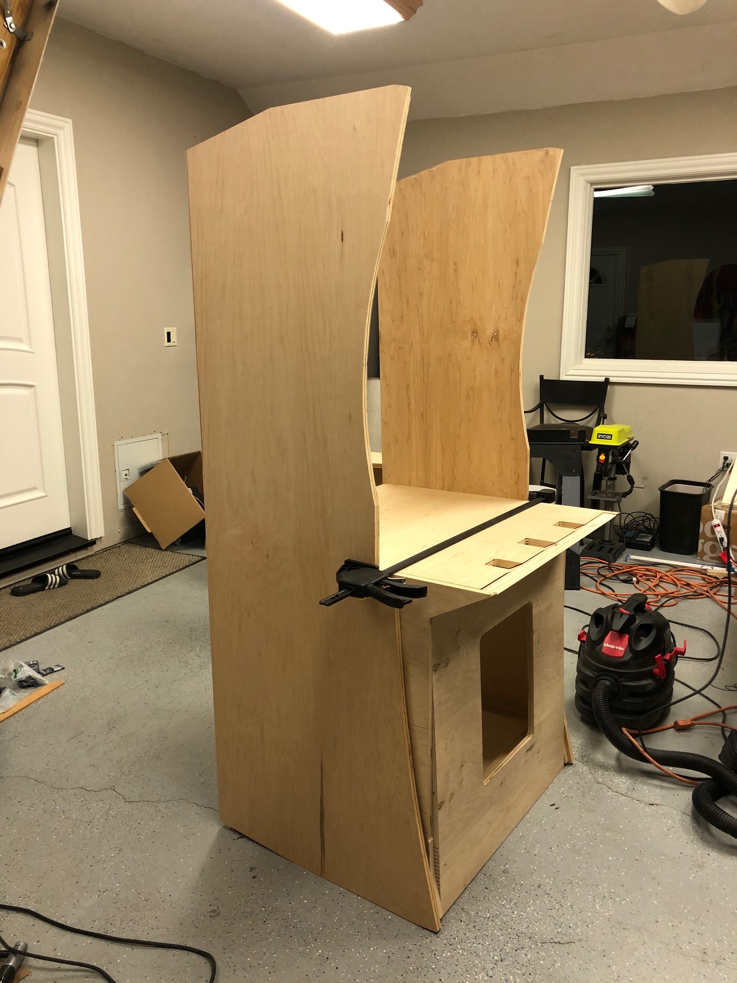

« Reply #380 on: October 23, 2019, 05:46:45 pm »
Last couple of weekends I’ve been out of town, so I’ve been shifting to trying to get things done during the week.  Bperkins said it best on a couple of other posts….. just getting in the garage and pulling off one thing per night is the way to go, even if it’s only 10 min.
The little progress starts to feel bigger once you can put things together.  I managed to get the rest of my blocking down on the base:
AND…..because of that I was able to finally test the bend on my coin door:
When I clamped that and stood up to see it holding in place without any cracking I was like:
Before I had put the door on I knew I needed to finally do some slot cutting.  I have been dreading this for a long time, as I had issues with drifting when I cut my little control panel box.  On the small box I had used the router table and moved the piece.  The table doesn’t have a perfectly level surface because it has an insert that is adjustable that I have never been able to level.
Initially I tried the Whiteside 3 wing Arbour that I bought from t-molding.com in my Ryobi, but noticed that the package mentioned the maximum RPM of 16,000, my Ryobi is fixed speed at 24,000, and it felt SCARY.  Decided it would be better to use the new Makita as it has variable speed settings.  Only problem was the standard base it comes with makes it easy to tilt and not stay level with a big bit like that.  So I had the idea to use the same circle jig I bought and it worked great:
This allowed me to confidentially bring the router to the edge with no vertical movement.
To get the correct depth, I used my digital calipers to measure the thickness of the wood (side note this piece actually varied from 18.4mm on one end to 17.7mm on the other).  For this piece I had to take an average.  But I would take the thickness, subtract the bit size (1/16” in this case), and then divide by 2.  I’ve noticed that for Plywood the thickness of each piece can vary and it’s important to measure and adjust your depth if necessary.  Also quick side note I learned the hard way that t-molding can have different spline width’s, and the slot cutter you need to buy is NOT the width of the spline, it’s usually 1/32” less (website you order from usually tells you, I bought form t-molding.com).
Anyway, taking pictures just to confirm before cutting helps:
Always good to see it line up visually.  And after it’s cut:
Lastly had to slap the sides on for a little motivation just to see how it looks:
More to come……..

« Reply #381 on: October 23, 2019, 06:21:59 pm »
Looking great!
How's that little Shop Vac?! Looks so tiny! But must be nice for hauling around.
Re: The Grid....
« Reply #382 on: October 23, 2019, 06:43:25 pm »
Great work Arroyo.  That bend in the front turned out great.   :cheers:
Your idea to use the circle jig to support the router is brilliant.  I will be stealing that.

« Reply #383 on: October 23, 2019, 07:14:55 pm »
Looking good sir!
Here is the lazy mans way of cutting that slot:
Grab a piece of scrap wood
Put the router up to it and manually adjust the bit until it looks like it is in the middle
Cut a test slot
Flip the board over, move the router over to the slot and see if the bit slides in easily
  - if it does - you are centered - cut away
  - if not - move the bit 50% of the difference and repeat.
No math or calipers.
Loving the work!

Cheers fellas  :cheers:
MikeA suggested I get the strongest Shop Vac I could find, ironically the smaller one they had at Lowe's was the most powerful at 6HP.  It holds 5 gallons, but yeah the long term plan is to buy a much larger Dust extractor/separator like a Cyclone or something.
It works surprisingly well, I have always worried about the router tilting on me when making cuts (it really hasn't been a big deal), but with this attached it feels rock solid approaching a cut.

Kids had soccer games all weekend so I only got a window of time to work on the hinges that are for a flap on the Marquee.  Used the same SOSS hinges that I did on the small control panel.  This time though I used different techniques for cutting them so I figured I’d post as they came out much better.
Cut those using the same circle jig that I recently picked up.  It has two metal circular stubs that you screw in and use to keep the router in center line on a flat surface (see the video I linked to above to see it in action):
Couldn’t use the same tool for the piece that it connects to because it has an angled cut.  So I used the tilting base of the router and some wood blocking as a guide:
Came out good, but not quite as good as the other:
Here it is closed:
And opened:

Love those hinges.  Where did you come across those?
Mike
Arroyo
  • Posts: 1558
  • Budgets are boring
Re: The Grid....
« Reply #396 on: November 02, 2019, 10:30:07 am »
Mike
A guy at Rockler turned me on to them.  They scale all the way up to a standard door size (in fact I believe that’s where they made their mark).  The company has been around a long time and has a lot of street credit, again according to Rockler.
Here’s the company’s website:
https://www.soss.com
And here’s a link to the ones I bought:
https://www.amazon.com/dp/B008C7BMP0/ref=cm_sw_r_sms_c_api_i_UezVDbJ9EX0EE
Okay that is cool.  Did that base come with your router?

That's damn slick. Is that for the top of the cabinet, not sure which part you are hinging?
The hinges on my control panel are not so complex,  but I was pretty happy with how they lie pretty close to flat.
You also reminded me that I *NEED* to buy one of those bendy screwdriver attachments. Where'd you get yours?
Yup it's part of the "package" for Makita's palm router if you buy the multi base set.  Here's a link:  Makita Palm Router
In retrospect I would probably just buy the "kit with one base" which comes with the plunge base as well and then buy the titling base separately....although you don't get the cool carrying bag  ::)
It's the very front of the Marquee.  I'm installing to allow access for cleaning as the marquee image will be recessed from the front glass.  It will be a 3d angled image with a gap to the front.....will probably make more sense when I get to that stage and can post pics.
Yeah they work surprisingly well, definitely a little lighter on overall torque, but with the distance I suppose that's to be expected.  I got them here
