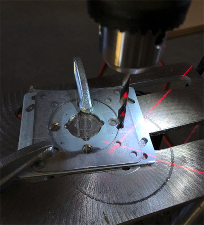

Ok, so I need to outline the project timeline.  I recently sold our home and am renting so the bulk of the project up front will be focused on the electronics as I can't really get wood at the moment (insert joke).  So I am focusing on the electronics for now.
I figured the most difficult part will be figuring out the rotating monitor, so I thought I would start there.  I actually started a little while ago, and got some additional parts this last week that let me make some real head way:
First off, why do a rotating screen?  I found out early on in my searching that playing vertical games (Donkey Kong, 1942, Dig Dug, etc.) looked really weird on a horizontal screen:
Huge black bars on the sides and generally a squished image.
I originally started with this:
A Hitec 755MG with the Servo Block from Servo City.  Solid stuff, but ultimately I found was underpowered for my application.
I am trying to rotate a HP z30i monitor (30" 16:10 LED LCD), which weighs about 17lb, and while I could turn the monitor it never really worked right:
So I got working on a new servo that came in this last week.

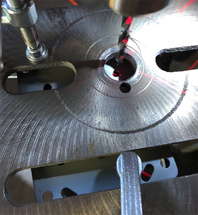

Most people when choosing to do a rotating monitor use a big circle to hide the area behind the screen.  I am choosing to do the opposite and instead highlight the area behind the screen with lit artwork:
So to highlight the artwork behind the screen I am choosing to place the monitor on a stand:
Married to a mounting plate:
Which will attach to a VESA mounting plate that will connect to the monitor:
Drilled for the attachments:
Drilled a hole for the shaft (1"):
End result:
Bought a new motor:
A Channel Mount Servo Gearbox from Servo City with 900oz/inch of torque vs. the previous 180oz/inch.
Side view:
Mounted to a channel carriage:
With an assortment of 1" (diameter) 8 spoke hub shafts of various lengths.
Here it is mounted together:
Side view:
Apply the shaft:
And mount it to the mounting plate after drilling some holes:
(upside down)
Attached:

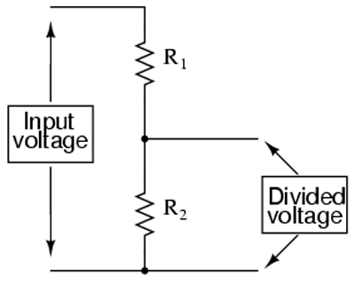

Check voltage before applying:
Bring 12V down to 7.5V:
Hookup Polulu Micro Maestro to power source and Servo Gearbox for control of the servo:
Mount 3 Neodymium magnets to mounting plate head each side lower half of hub shaft (Servo City):
Side view:
Back angle view:
And use the Micro Maestro Control Center to set some target positions.  Here's a fast example:
And slightly slower with a look at the back:
Still waiting on a 1" bearing to support the hub shaft.  Don't know that it really needs it, but perhaps it will help to relieve some strain on the Servo Gearbox.  More to come....
« Last Edit: March 19, 2019, 03:39:46 pm by Arroyo »

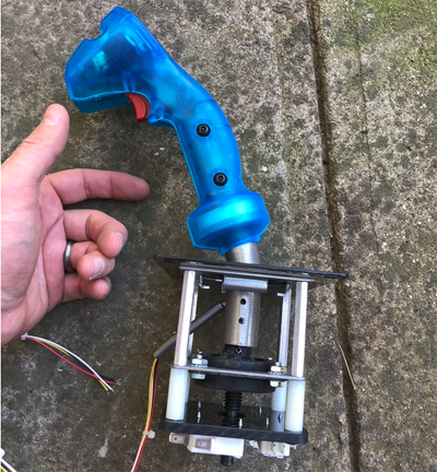

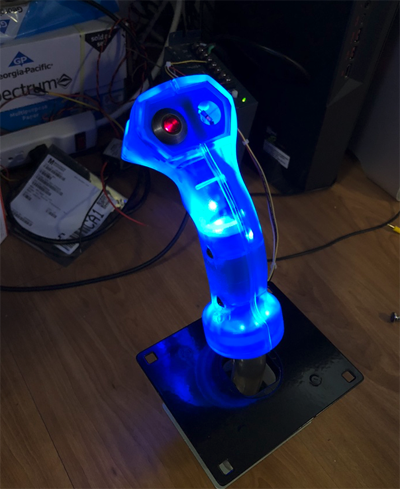

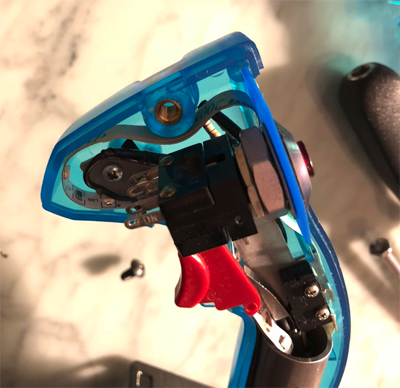

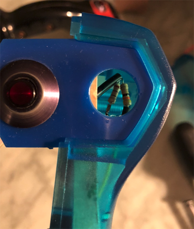

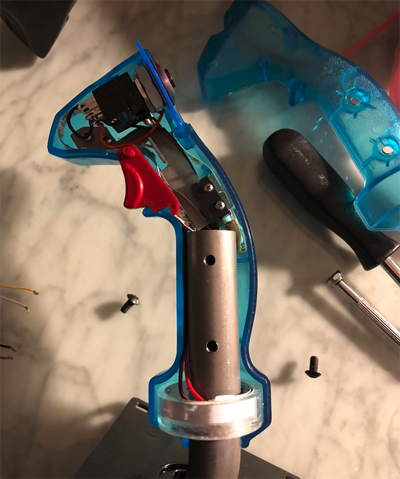

Package came in the mail today:
Tron Deluxe Identity discs.  These are the discs that I will use to surround the speaker panels.  I am going to gut the internals and put in a modified LED system so that it will glow white all around.  The plan is to control the 12V LED's inside the discs from the same Ultimarc I-Pac Ultimate I/O board that I will use with the button LED's.  In order to get the 12V LED's to be controlled by the 5V I-Pac I am going to use a Bi-Polar Transistor to act as a switch:
It's kind of hard to see in the pic (sorry about that), but you can see the three wires running to the three legs of the little black rounded flat backed head.
Here it is with the lights turned on by applying the 5V to the Base of the Transistor:
The way that it works, as you may be able to tell form the picture, is to put the 12V LED in series to the "Collector" of the Transistor (represented as C in the picture below).  You put the positive side of you 5V source to the "Base"(represented as B in the picture below), and the 5V negative on the "Emitter" (represented as E in the picture below), then you connect the Emitter to Ground.  One very important step you may notice in the picture and the diagram is to place an appropriate resistor between your 5V power source and the Base.  The Base to Emitter current is intended to be very low.  In my case I am using a 2.4k ohm 1/4 watt resistor.  This particular transistor is able to handle up to 20V from the Collector to the Emitter (or the thing you are turning on), with a maximum current of 3A.  The Base to Emitter voltage (VEBO) is of course 5V as needed for the application.
Link for the Transistor:
https://www.mouser.com/ProductDetail/Diodes-Incorporated/ZTX689B?qs=sGAEpiMZZMshyDBzk1%2fWizF0eVyYE44Zq%252bpCANXbH08%3d
I also got this earlier this week:

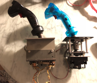

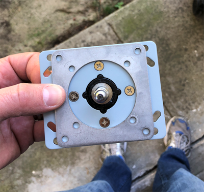

As I mentioned earlier in the thread I will be using this Ultimarc U360 to attach to the Tron stick that will be on the control panel.  The reason for doing this is that Happ Heavy Duty 8-way stick will get you the digital directions you need just fine, however for a game like Tron, or any other 4Way game, you have the difficult decision of choosing to limit the stick to 4 way games (via restrictor), or going with 8 way and getting the "stair stepper" problem in the light cycles in Tron.  Also, by using the U360 you can get analog going, and I thought it would be really cool to play something like Star Wars with this stick, it's the best alternative I could think of to a full fledge Atari Yolk (some day I hope).
Here's a picture of the two lined up so you get a sense of what I'm going for:
Hopefully I can work on the discs and stick this weekend.

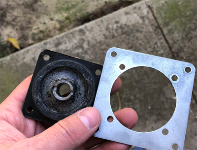

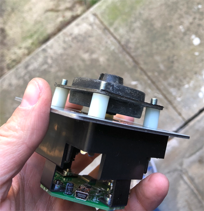

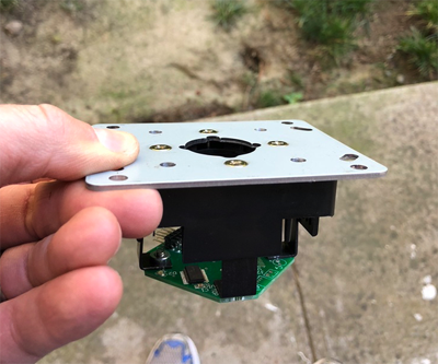

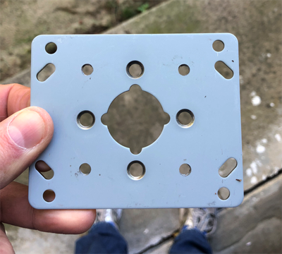

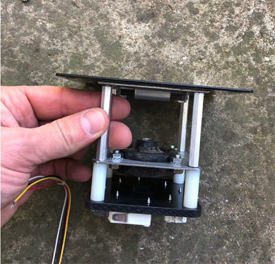

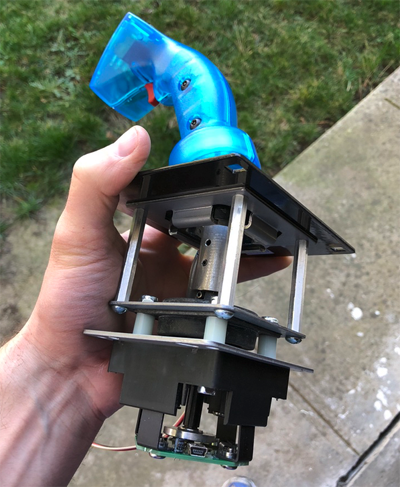

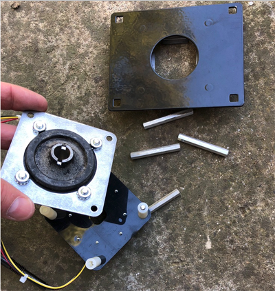

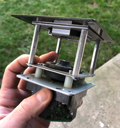

Got some time this weekend to work on the flight stick.  The goal as stated above was to recreate as close as possible an original Tron/Discs of Tron/Gorf/Xenophobe (I am sure there are others) stick.  As the original sticks used leafs switches I knew I wanted to do away with the microswitches, but I also thought it would be cool to use the stick for more than 4 games.  The idea of using it for flight games (After burner, Star Wars, Hydra, Space Harrier, etc.) was very appealing as well as being able to play both Tron games without sacraficing it to one with a restrictor (4 way vs. 8way).
The U360 is perfect for this so just need to put them together:
Step 1: remove stick from chassis
You need to remove with a wrench the nut at the bottom or the stick after removing the e-ring and actuator (not pictured)

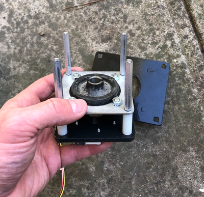

Step 2: loosen screws at the bottom and then use a wrench to unscrew the hex posts
Step 3: remove grommet and plate

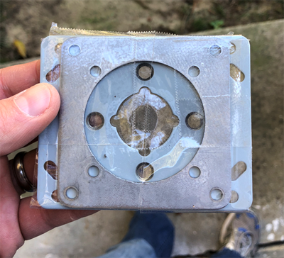

Step 4: put the grommet plate over the U360 mounting plate
Step 5: take careful measurements (I remember 11.5/32" on each long side and 1/16 on each side short side) and tape down carefully
Step 6: remove U360 mounting plate (4 screws) and drill.
Step 7: reattach U360 base to mounting plate but remove the joystick shaft and drill holes using new ones as guides:
This was probably one of the most awkward parts, it needs a straight drill otherwise you can misalign the two.  I managed to clamp the U360 mounting plate below my drill press, but you could probably use a hand drill with a bubble level with a steady hand.

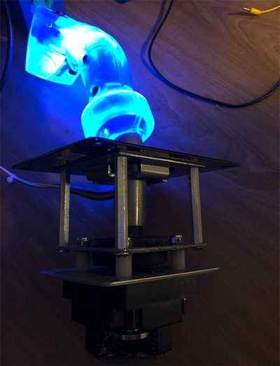

Step 8:  Assemble
and done:
Full credit for this goes to whynotpizza and genesis who pioneered this technique:
http://forum.arcadecontrols.com/index.php?topic=86734.0
Still need to modify the top restrictor as they have mentioned it can limit the throw in some angles.  I plan on cutting a piece of acrylic in a square slightly larger than the existing restrictor.  Ill post when I can get it done.

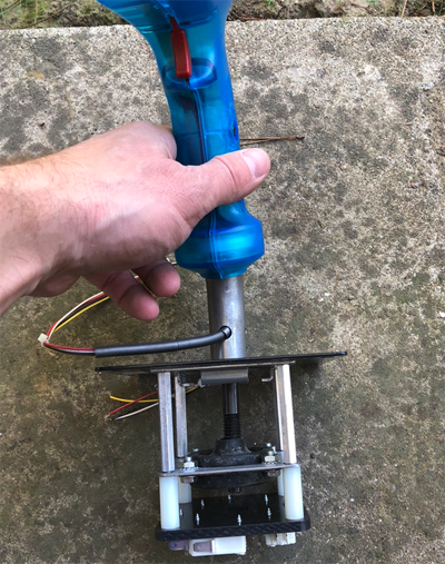

Also as some have inquired about the other mods to the stick:
The original Tron sticks used a blacklight tube near the controller to make the plastic glow.  I thought it would be cool to get a UV LED strip and place it inside.  This works but the only problem is it runs on 12V.  In the last post I mentioned how I will be using the Bi-polar transistor to control the on/off of the lights using the i-Pac Ultimate I/O.
To get the LED strip in I wanted to make sure it was evenly lit, so I went to Tapp plastics and got them to cut 1 3/4" (outside diameter) tubing and a small circular disc using mirrored Plexiglass to fit inside (when drilling the hole be aware that it's not center).
I then cut the appropriate length of LED strip and used the sticky backing to get the bottom LED's working.
The top LED's used the other side of the LED strip and followed the seam of where the two plastic pieces come together.
I had a very hard time figuring out the thumb button.  I was able to track down the button which is a Licon 01-700157, (you can also use a Cherry P163) which you can buy online, although they are becoming rare, however finding the circular disc housing was impossible.  I finally broke down and bought a used Xenophobe stick which has two thankfully.
The only problem you are left with is the LED in the switch runs on 2V.  To solve this problem I used two resistors as a voltage divider circuit:
resource: https://www.allaboutcircuits.com/tools/voltage-divider-calculator/
https://www.allaboutcircuits.com/textbook/direct-current/chpt-6/voltage-divider-circuits/
This brings the voltage down to the 2V from a 5V source by using 2 resistors, the first resistor is 43ohms, and the second is 23ohms.  This gives you 1.92V with a maximum allowed amperage of 116mA, which according to the Cherry markings is sufficient.
Still might add a leaf switch in place of the microswitch and of course will have a black plate around the thumb button with graphics.
For those interested here's some pics of the original Xenophobe stick relative to the new one:
And the final results:
