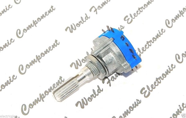

For that reason, this attempt will use a mechanical ALPS 12 position rotary switch:
http://www.ebay.com/itm/1pcs-ALPS-1-Wafer-1-Pole-12-Position-cycling-Rotary-Switch-Made-in-JAPAN-/152296969200?hash=item23759b53f0:g:chgAAOSwxH1UKmMJ
A cheaper rotary switch could be used, but I came across a couple of these, attached them to custom joystick shafts with couplers, and they had a really good feel to them.
Not too much pressure to turn, but still a good snap to the next detent.  Although I have these custom made joystick shafts, they don't really fit with a cheap and easy for everyone solution, so I'll be using the original JLF shafts for this project.  I'm starting with the JLF because it's what's in my cab and I have a spare.  I also have a JLW on the parts pile and it shouldn't be too much trouble to modify the design for that.

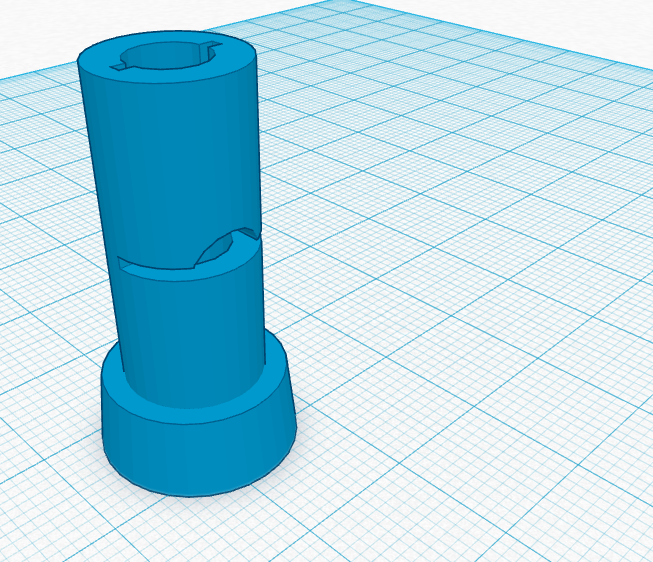

Part 1 is the coupler.  This will join the joystick and potentiometer shafts.  Since there isn't any extra shaft there to work with, my plan is for the coupler to incorporate the actuator and be held in place with the original e-clip.  To do that though, it will need to have a slot cut in the side and enough of an opening to be able to remove the e-clip if needed.  That leaves a weak spot in the setup.  The easiest way for me to tell if it will be strong enough is to build and test it.
The other problem is that the joystick shaft can still spin freely.  As said previously, I am trying to make this an easy mod, so I don't want people to have to drill a hole through the joystick shaft.  Hopefully it won't come to that.  The only keyed thing on the original joystick shaft though is the 1mm notch in the bottom for tightening the balltop.  The rotary switch also has a 1mm slot. I can't imagine a 1mm bump of plastic holding up very long.  I didn't think a metal key that small would either, but then I tried the side of a large picture hanging hook and it felt pretty solid.
I figure these are easy to find and most people have dremels, so people could cut their own key out of them.  I might have to find something larger, but it will still be something readily available.
Here is what I'm currently printing to test (is upside down):
This should tell me if the sizing for the shafts is correct, if the slot is large enough to get the e-clip on there, if the opening on the slot is large enough to get the e-clip off, etc.
If all that works out, I'll also see how much twisting force it takes to break it.  (printing in PLA for now)
When the coupler is done, we'll have the yoke that attaches to the potentiometer and the post that will keep the yoke oriented.
I'm somewhat reluctant to 3D print the post.  A metal one would me much smoother.

Am I understanding correctly that you want the shaft to rotate freely and only the ball top will rotate the directions?
No, I'm just trying to lock the joystick shaft to the coupler.  Then the ball top will be loc-tited on to keep it from unscrewing.
So when you turn the balltop, the shaft turns with it, the coupler turns with it, etc.
The idea is to make this a crazy simple mod without any custom machining.
I'm not having very good luck so far.  The slot for the E-clip needed to be much more than half the diameter.
It ends up only having a small block of material on one side which breaks easily.
I need to find a way other than the E-clip to secure the actuator in place.
I looked at the JLW and it's no better.
Hopefully a thicker wall (wider than the e-clip so you can extend support forward) on the section above the actuator will help.
If that isn't enough, how about adding vertical ribs that slide into slots on an outer sleeve? (ribs above and below the e-clip opening)
The outer sleeve provides strength and the ribs distribute the twisting force over a larger area than the weak area by the e-clip.

The problem is that the diameter is basically limited to the current diameter of the bottom part of the actuator because it doesn't extend hardly any past the restrictor plate.  I guess I could make a new restrictor plate with a wider opening.....

I was able to get a much better defined 1mm internal rings by printing the coupler on its side.
As long as the two halves are held together tightly, I don't think there will be any issue replacing the e-clip with this setup.  Still might have to use a metal tab for the slot in the bottom since it's smaller.
Next draft will have .5mm thinner walls and an actuator section that slides down over it to lock the halves together.
(and it will extend further up the joystick shaft)
« Last Edit: January 02, 2017, 09:50:00 pm by BadMouth »

I decided to take a break from this last night, but the night before I experimented with printing the coupler in various ways and tweaking it for a more precise fit.
On this level (.5-1mm), 3D printing isn't as precise as I thought it would be.  I can print the halves with the opening up and they fit good, but need to be printed with a brim (a thin raft) which would have to be sanded away.  When printed face down the opening comes out smaller, the shaft doesn't fit in it, and the ring that replaces the retention clip isn't nearly as crisp and perfect.  If I print them standing up, the overhangs come out too sloppy despite my printer pulling off a 1"+ straight-as-an-arrow bridge with no support on another project.
So at this point, it's about tweaking the design for the best printing results and least amout of modification needed after printing.
I don't think this is going to be something that will print out perfect and the correct size on other people's printers without them doing some trial and error.
Once I get my own machine and method dialed in though, I have no problem with cranking out a couple dozen to share.   ;)
I plan to tinker with it more this evening.  (I'm doing laundry in the basement, the printer is in the basement, it only takes 10 minutes to print one to test....)
Not much different, but here is a print from the last round.  It feels more solid than expected given the thin walls.
I want it to extend further up the joystick shaft, but the actuator can only slide up about 5mm.  So if the actuator supposed to be put on first and then slide back down over this, then it can only extend up 5mm.  The plan is still a WIP and I may have to come up with a different plan such as installing the actuator from the bottom before installing the rotary switch.

The actuator needs to be shorter to be able to attach it to an already assembled stick.
Since that's not going to allow it to overlap the "halves" section much, I'll add a ring that will be lifted onto the bottom edge as well.
I probably won't have time to work on this again until the weekend.
Once I work out all the kinks, I'll switch over to ABS and have to resize everything again to allow for shrinkage!  :lol  :'(

After being sidetracked by some home improvement projects, I was able to mess with this a bit more today.
Having a 3D printed actuator that slides back down over the coupler was too much of a PITA to install.  Now I've switched to just using the stock actuator and having the top of the coupler be where the e-clip would normally be.
Originally didn't want to do it this way because I didn't think it would be durable enough, but it seems solid.  Now I just have to go back to a thinner version with a collar that slides up farther from the bottom.
Currently having tolerance issues after my last round of revisions.  Hoping I have an old draft to go back to....
EDIT:  Instead of having collars, I could just put a bolt through the middle, but that would require making it taller, which I'm trying to avoid.  It actually might fit in my cab with some modifications at this point.
« Last Edit: February 04, 2017, 06:16:00 pm by BadMouth »

Here is the final (for now) design:
For the post that keeps the yoke from turning, a 75mm Hex cap bolt that is only threaded on the very end will screw into one of the extra plastic mounting tabs on the side of the joystick body.
Those might not get here until the beginning of next week.
In the meantime, I guess I will start tinkering with a coupler for the JLW (rotary & 4/8 way switching in one!).
Will probably use an AVR with the KADE rotary firmware for testing (next week), but will do a "current keyboard encoder compatible" device by the end.
« Last Edit: February 06, 2017, 08:58:48 pm by BadMouth »

The M5 bolts came in, so I was able to get the yoke sized to fit and wrap this revision up.  I added a slot on the other end to zip tie the wires from the switch.
It feels great except for one thing which someone may or may not notice or get used to.  Moving left or right, you can't the difference between this joystick and one without the rotary stuff attached.
Moving up or down though, the yoke causes the joystick shaft to rotate maybe 5 degrees and you can feel the balltop move slightly.  I didn't have this issue with optical rotary hacks because they just spun freely rather than having solid detents like this switch.
I guess this is why original designs had the yoke bend upward so it intersects the post closer to the pivot point of the joystick.  This is going to be harder to print, but I guess I should at least try it and see if it makes much difference.

Not as nice looking IMO, but the rotation experienced when pushing up or down is barely noticeable now.  Gonna add some gussets to the next revision.  We can go down to a 45-50mm M5 bolt for the post now.  These might actually fit in my cab if I switch to top mount.

Never finished this, but for anyone else that wants to mess with this approach:
bracket for Alps switch   https://www.tinkercad.com/things/77OzLAC8Q1L
coupler: https://www.tinkercad.com/things/fVXXvPPj2ju
sleeve to hold coupler halves together: https://www.tinkercad.com/things/jzYmrPW284t
possibly useful "tolerance test: : https://www.tinkercad.com/things/6sh9aQ2vu2M
DISCLAIMER: IT HAS BEEN YEARS SINCE I MESSED WITH THIS AND YOUR PRINTER COULD HAVE DIFFERENT TOLERANCES.
DOUBLE EDIT: OMG, blocky faces on those rounded parts!  I've improved, but am still limited to Tinkercad.  :lol
