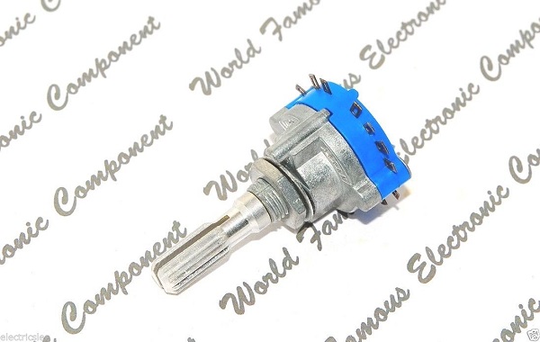

For that reason, this attempt will use a mechanical ALPS 12 position rotary switch:
http://www.ebay.com/itm/1pcs-ALPS-1-Wafer-1-Pole-12-Position-cycling-Rotary-Switch-Made-in-JAPAN-/152296969200?hash=item23759b53f0:g:chgAAOSwxH1UKmMJ
A cheaper rotary switch could be used, but I came across a couple of these, attached them to custom joystick shafts with couplers, and they had a really good feel to them.
Not too much pressure to turn, but still a good snap to the next detent.  Although I have these custom made joystick shafts, they don't really fit with a cheap and easy for everyone solution, so I'll be using the original JLF shafts for this project.  I'm starting with the JLF because it's what's in my cab and I have a spare.  I also have a JLW on the parts pile and it shouldn't be too much trouble to modify the design for that.

The M5 bolts came in, so I was able to get the yoke sized to fit and wrap this revision up.  I added a slot on the other end to zip tie the wires from the switch.
It feels great except for one thing which someone may or may not notice or get used to.  Moving left or right, you can't the difference between this joystick and one without the rotary stuff attached.
Moving up or down though, the yoke causes the joystick shaft to rotate maybe 5 degrees and you can feel the balltop move slightly.  I didn't have this issue with optical rotary hacks because they just spun freely rather than having solid detents like this switch.
I guess this is why original designs had the yoke bend upward so it intersects the post closer to the pivot point of the joystick.  This is going to be harder to print, but I guess I should at least try it and see if it makes much difference.

Not as nice looking IMO, but the rotation experienced when pushing up or down is barely noticeable now.  Gonna add some gussets to the next revision.  We can go down to a 45-50mm M5 bolt for the post now.  These might actually fit in my cab if I switch to top mount.
