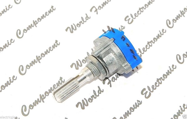

The goal is to come up with a rotary joystick option that's fairly cheap and easy to add, but still has a good feel to it.
I've done a rotary joystick mockup with an optical encoder, but the lack of detents took a lot away from the games IMO.
For that reason, this attempt will use a mechanical ALPS 12 position rotary switch:
http://www.ebay.com/itm/1pcs-ALPS-1-Wafer-1-Pole-12-Position-cycling-Rotary-Switch-Made-in-JAPAN-/152296969200?hash=item23759b53f0:g:chgAAOSwxH1UKmMJ
A cheaper rotary switch could be used, but I came across a couple of these, attached them to custom joystick shafts with couplers, and they had a really good feel to them.
Not too much pressure to turn, but still a good snap to the next detent.  Although I have these custom made joystick shafts, they don't really fit with a cheap and easy for everyone solution, so I'll be using the original JLF shafts for this project.  I'm starting with the JLF because it's what's in my cab and I have a spare.  I also have a JLW on the parts pile and it shouldn't be too much trouble to modify the design for that.

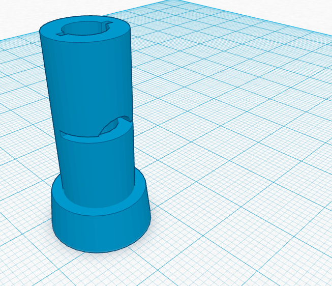

Part 1 is the coupler.  This will join the joystick and potentiometer shafts.  Since there isn't any extra shaft there to work with, my plan is for the coupler to incorporate the actuator and be held in place with the original e-clip.  To do that though, it will need to have a slot cut in the side and enough of an opening to be able to remove the e-clip if needed.  That leaves a weak spot in the setup.  The easiest way for me to tell if it will be strong enough is to build and test it.
The other problem is that the joystick shaft can still spin freely.  As said previously, I am trying to make this an easy mod, so I don't want people to have to drill a hole through the joystick shaft.  Hopefully it won't come to that.  The only keyed thing on the original joystick shaft though is the 1mm notch in the bottom for tightening the balltop.  The rotary switch also has a 1mm slot. I can't imagine a 1mm bump of plastic holding up very long.  I didn't think a metal key that small would either, but then I tried the side of a large picture hanging hook and it felt pretty solid.
I figure these are easy to find and most people have dremels, so people could cut their own key out of them.  I might have to find something larger, but it will still be something readily available.
Here is what I'm currently printing to test (is upside down):
This should tell me if the sizing for the shafts is correct, if the slot is large enough to get the e-clip on there, if the opening on the slot is large enough to get the e-clip off, etc.
If all that works out, I'll also see how much twisting force it takes to break it.  (printing in PLA for now)
When the coupler is done, we'll have the yoke that attaches to the potentiometer and the post that will keep the yoke oriented.

Am I understanding correctly that you want the shaft to rotate freely and only the ball top will rotate the directions?
No, I'm just trying to lock the joystick shaft to the coupler.  Then the ball top will be loc-tited on to keep it from unscrewing.
So when you turn the balltop, the shaft turns with it, the coupler turns with it, etc.
The idea is to make this a crazy simple mod without any custom machining.
I'm not having very good luck so far.  The slot for the E-clip needed to be much more than half the diameter.
It ends up only having a small block of material on one side which breaks easily.
I need to find a way other than the E-clip to secure the actuator in place.
I looked at the JLW and it's no better.
Hopefully a thicker wall (wider than the e-clip so you can extend support forward) on the section above the actuator will help.
If that isn't enough, how about adding vertical ribs that slide into slots on an outer sleeve? (ribs above and below the e-clip opening)
The outer sleeve provides strength and the ribs distribute the twisting force over a larger area than the weak area by the e-clip.

The problem is that the diameter is basically limited to the current diameter of the bottom part of the actuator because it doesn't extend hardly any past the restrictor plate.  I guess I could make a new restrictor plate with a wider opening.....

Never finished this, but for anyone else that wants to mess with this approach:
bracket for Alps switch   https://www.tinkercad.com/things/77OzLAC8Q1L
coupler: https://www.tinkercad.com/things/fVXXvPPj2ju
sleeve to hold coupler halves together: https://www.tinkercad.com/things/jzYmrPW284t
possibly useful "tolerance test: : https://www.tinkercad.com/things/6sh9aQ2vu2M
DISCLAIMER: IT HAS BEEN YEARS SINCE I MESSED WITH THIS AND YOUR PRINTER COULD HAVE DIFFERENT TOLERANCES.
DOUBLE EDIT: OMG, blocky faces on those rounded parts!  I've improved, but am still limited to Tinkercad.  :lol
