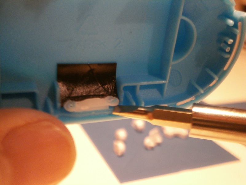

I hardly ever play games on my phone because I hate using touchscreen controls for anything other than puzzle games.
The goal here is to approximate the feel of a gameboy while keeping the package somewhat minimalist.
After doing some research and reading reviews, I settled on using an 8bitdo Zero bluetooth controller.
Although I had measurements beforehand, this thing is smaller than I expected.  The buttons are about 2/3 the size of original gameboy buttons.
Still the width of the controller means that the board and buttons can just be swapped into another housing without having to hack much.
I tested the controller with retroarch, John GBS, & MasterGear.  It worked good with all of them.
The buttons and D-Pad have a good feel to them.  They have a good amount of travel and only take a light touch to activate.
I was hoping the battery was on the bottom so the thickness could be cut in half.

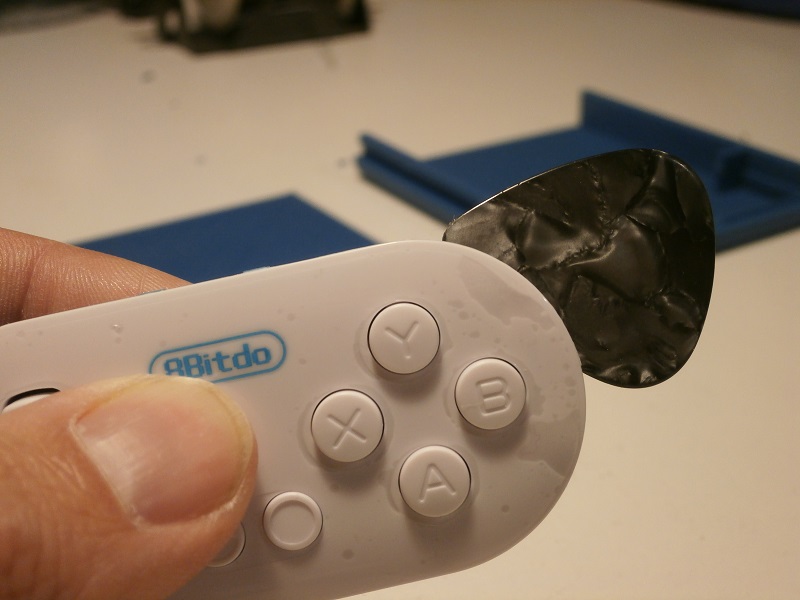

The two halves were held together with a small amount of glue.  There were alignment pegs, but no clips.
The glue broke loose fairly easily by prying them apart with a heavy guitar pick starting on top the shoulder buttons.
The battery was indeed on the bottom and only held in place with some thin double sided tape which easily separated.

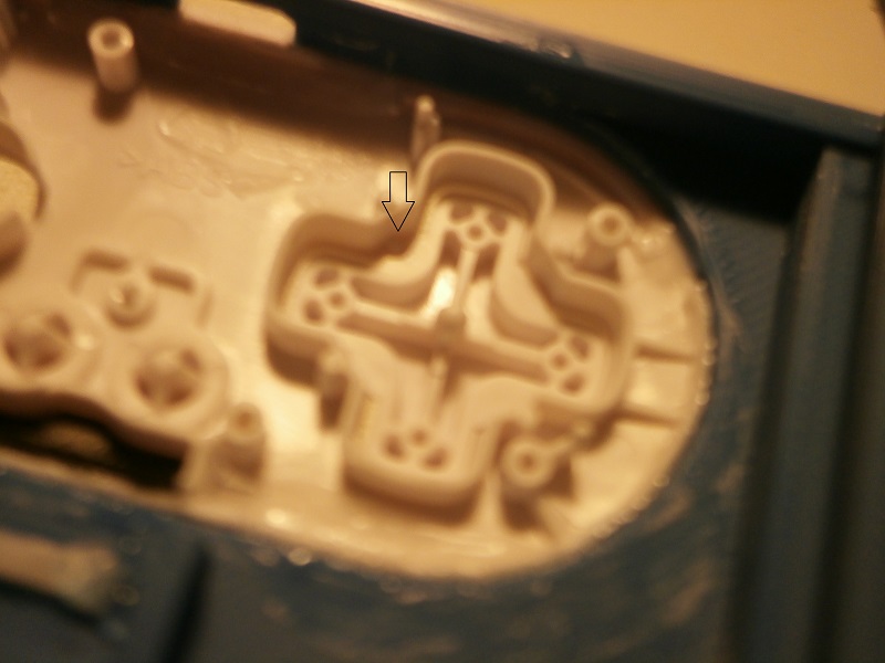

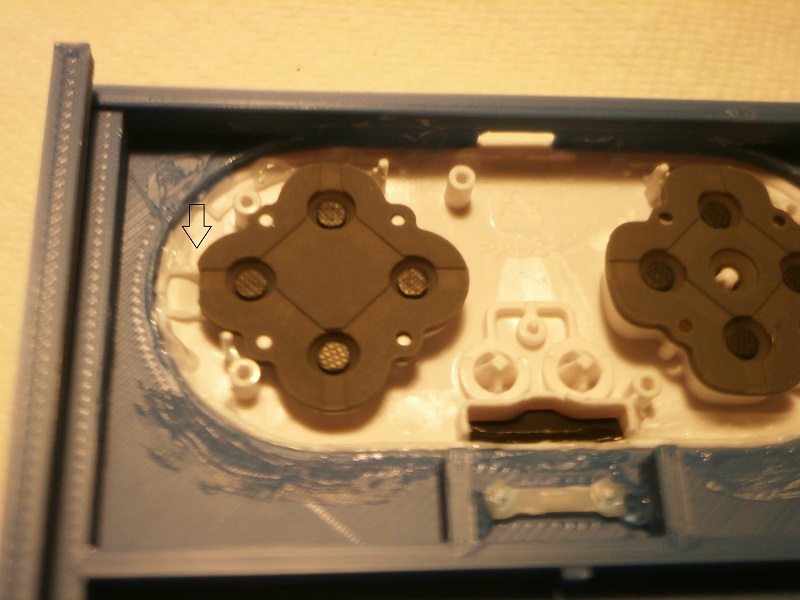

Since the spacing on the D-Pad and buttons are nearly identical, it's tempting just to flip the thing upside down and then remap the emulators so the charging port will be on the bottom.
Having start and select on top would bother me though.
The select and start buttons are made a little differently.
They each have a post in the center that presses a blister button on the pcb.

The shoulder buttons came right off after applying a little pressure to them.
Originally I planned to just ditch them, but after messing around with the emulators, I may add them somewhere else and utilize them for emulator functions like exiting games.
Still might not though, as the emulator menus are displayed in such a way that you'd have to remove the phone from the sleeve to see them anyway.
To have a template, I cut off the alignment posts and scanned in the front of the controller.
Another nice thing about the way this controller is built is that the PCB is screwed down to the front, so I can incorporate the mounting posts into my 3D printed design and the PCB will be aligned correctly with the openings.
I did a quick mockup in a raster program and printed out actual size.
Here is what I'm going for:

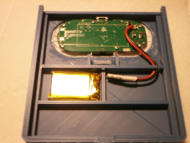

One of the things I've been pondering is how to attach the front and back.
I've decided to just use tiny screws in the sides.  There will be a recess for the screw heads.
The battery leads will still need to be extended and the battery will have it's own compartment.
For the LED, I'm going to rig up something where the one on the current PCB will be reflected to a little window on the front.
A spare clear LED didn't work very well.  I suppose it's only meant to propagate the light it's generating, not light coming in from the sides.
Tired of tinkering with it for now, but think I've got my direction.
My goal is to have a prototype 3D printed this weekend.
The current design can accept phones up to 75mm wide and 10mm thick.
I plan to line the inside with felt tape or microsuede.
It covers up the bottom 65mm of the phone.
EDIT: The entire shell is 85mm wide and around 20-22mm thick.

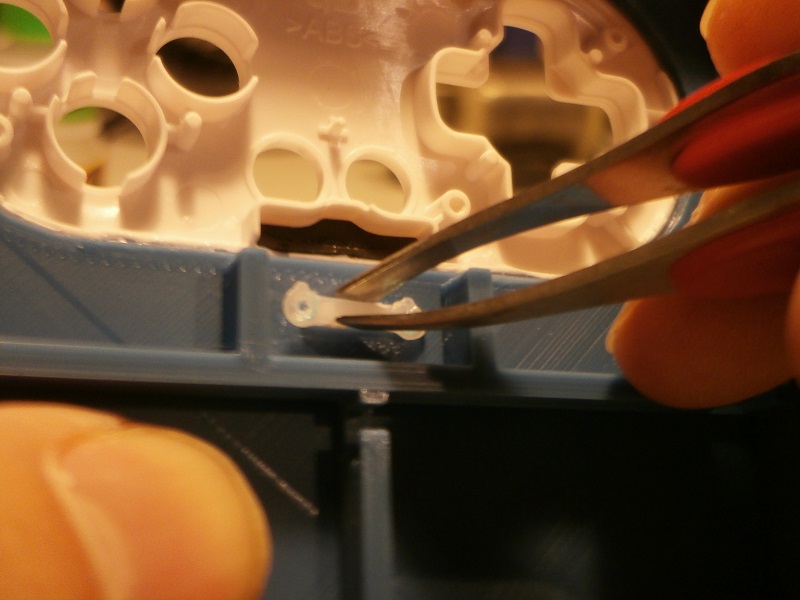

Found some time to tinker with it this morning.
For the LED, I made a slot that the translucent block from the original controller can fit in.
I'm hoping that enough of the light from the LED on the PCB will get to it to be visible.
Still need to make the top end look a bit nicer and put in the recesses for the screws.
There is also an issue to work out with the alignment of the curve of the back edge with the back piece.
I hope to attempt a print tomorrow evening.

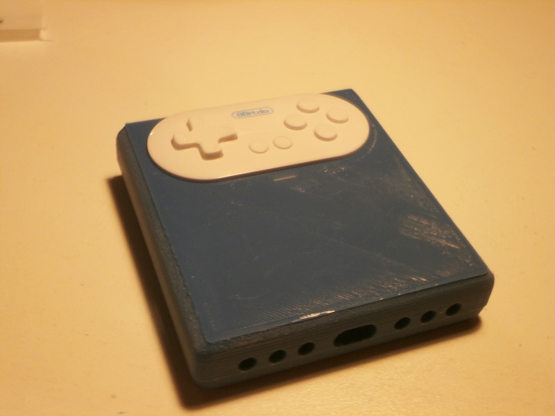

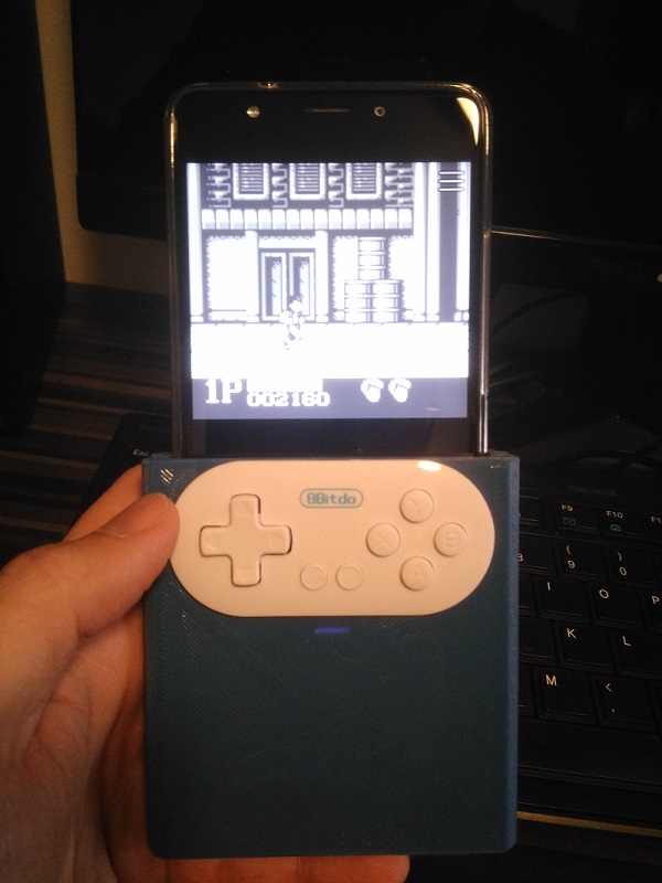

I learn a lot faster from mistakes, so I went ahead and started printing the front piece.
That way I can see what doesn't come out right and then figure out why.
It should be done in a couple hours and then I'll see how stuff fits.
I'm so grateful for Tinkercad at this point.  With basic building blocks and some ingenuity, I was able to create what I wanted in just a few 2 hour sessions. (I did go through the tutorials and some youtube videos about a month ago)
Exported a .stl file from Tinkercad, opened that with Cura, set the infill to 100%, exported in G-code format to a microSD, and now it's being printed.  :applaud:
The most likely thing to go wrong will be the overhangs or the phone charger opening drooping.
If so, I'll just go back and give it sharper edges and some supports.
  • Posts: 9286
  • Last login:December 10, 2025, 07:49:38 am
Re: Bitdo Boy - Gameboy style bluetooth phone controller sleeve
« Reply #12 on: November 05, 2016, 04:47:22 pm »

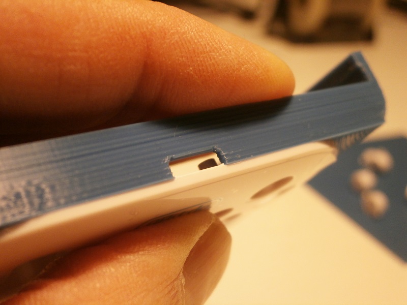

Looks better in person than in the pic, although it does has some artifacts from the way the pieces fit together in tinkercad.
The most pronounced are recessed lines next to the corners.  (I did align everything)
I'm happy with it for a first attempt....at least it was a successful print.
The openings and overhangs I was worried about aren't going to be an issue.
First major screwup: The opening isn't large enough for the controller front to settle down in.
I must have measured wrong.  :-\ (EDIT:  measured correctly, but must have resized the part in Tinkercad at some point)
The height of the LED block opening is good, but it needs widened the tiniest bit.
The biggest thing is that I want my thumbs an inch higher.  It's workable as is, but just doesn't have the right feel.
It needs to be long enough that the bottom can rest on my pinky fingers.  That is what I think would feel right.
I can take it up about a half inch further before the playfield starts getting covered.  The playfield is resizeable, but I don't want to shrink it.

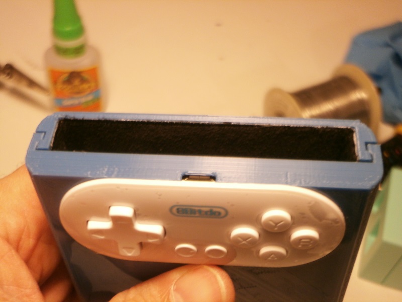

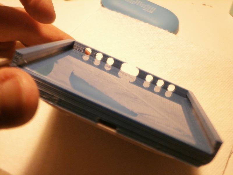

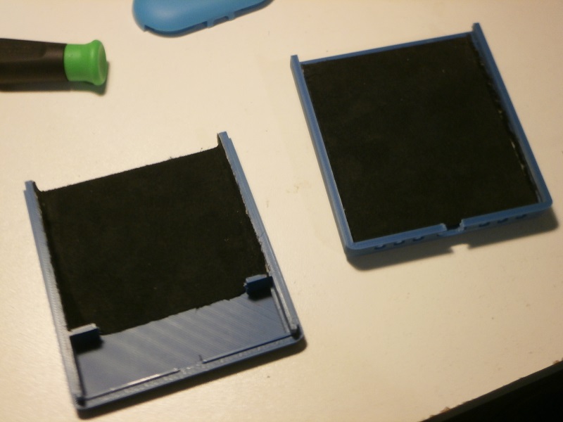

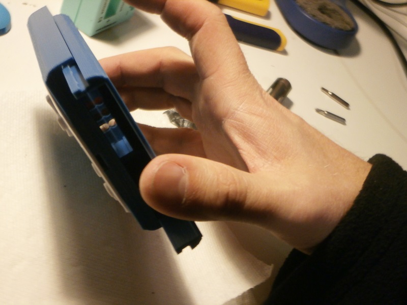

Longer version of the front piece is being printed.
I have the middle divider and back ready to print, but will wait and see how the front fits first.
This is how far the phone will extend into it.  I didn't want to add anything too permanent to keep the phone propped up.
I'm leaning toward putting tabs on the back part, since that part would be easier/cheaper to print and swap out.
I still may do something adjustable or cut to fit.

Here's the front, which came out better than the last one.
Artifacts much better this round, but still there on the right corner.  I'm assuming that I'll have to learn how to use another program to eliminate them completely.  I redid the build surface with a self adhesive PEI sheet rather than masking tape used in the last round.
Bottom layer is much smoother, although you can see where every bubble in the PEI was.  (I could not see them when installing it...maybe blisters from the heated bed?)
The opening for the controller still isn't 100% right.  I think I'm trying to make the tolerances too tight.
I will add more wiggle room to the next revision.  Same goes for the cutout for the translucent block for the LED.  It fit, but was way more trouble to get in than it should have been.
MAIN THING WHEN GLUING IN THE CONTROLLER IS TO TAKE IT APART SO YOU DON'T GET GLUE ON THE BUTTONS!
The glue will run straight into the B button hole...which it did.  I had to take it apart, sand, work a little with an exacto, etc.
Now I know for next time.

The divider is just a plain plate.
Just added tabs to prop the phone up to a proper height.
The idea is that someone else will be able to move them to the proper spot for their own phone before printing.
This is how it fits together.  I don't like that I can see light through a gap in the bottom.  The next revision will have some type of overlap there.
It just fits my phone with the case on.  The phone case keeps the front from contacting the screen.
Future revisions will have some extra room for felt tape or something similar.
....pretty much exactly what I had in mind.  ;D

HOW TO ASSEMBLE:
Use a heavy guitar pick to pry apart an 8-bitdo Zero starting at the shoulder buttons.

Remove the battery from the back of the PCB and extend the battery leads 3 inches.  Keep the doubles sided tape side of the battery facing up.
We're going to rely on reusing it.  You could get away with leaving the battery in place if you made the front face a few mm thicker.
Disassemble the rest of the 8-bitdo Zero so that glue does not get into the parts when the faceplate is glued on.
Place the faceplate of the 8bitdo zero on the front panel and align it using the USB opening at the top for reference.
There are a couple flat edges there that should fit fairly precisely.  The rest of the opening allows for some wiggle room.
Glue the faceplate in place using a couple dabs of superglue (I used gel).
The top of the faceplate should be flush with the top of the 3D printed housing.
After the top has set, add a couple dabs of superglue at the bottom.  I used a bottle to keep it pressed down while the superglue set.
When the dabs of superglue are dry, go all the way around the edge.
Using a small screwdriver or exacto knife, pry up on the tabs on each side of the translucent white LED window in the 8bitdo zero back.
It should pop off easily.
Using tweezers, place it into the printed front panel.  Be careful, it will go flying if you squeeze the tweezers too hard.
Use tweezers to get it started, then press it in with something solid.  It should come out flush with the front.  Ad a dab of glue on each side.
After the glue dries, reassemble the 8bitdo zero into the front panel.
It helps to keep it elevated off the surface you're working on so the buttons don't press against the stuff behind them and lift them out of position.
(prop the bottom part of the 8bitdoboy up on something)
All the parts are keyed so there is only one correct way for them to go back in.
The D-pad is keyed on this corner:
The rubber contact pad for the buttons is flat on this side:
Route the battery wiring and stick the battery to a lower compartment using the original double sided tape.
If you want to add a layer of microsuede to line the interior, now is the time.  Be careful not to extend it into the channels the back will slide into.
(I went back and added it after taking the following pic.  I also messed up and didn't allow enough room on the edges for the sides to slide together)
Put the divider in place, shiny side toward the phone.

Peel off the protective layer, pair it with your phone and you're done!
This was printed in PLA on my monoprice mini and fits together real snug.  It feels like it snaps into place at the bottom even though I didn't incorporate any latches.
I printed this blue one in much thinner layers and higher heat.  I don't really think it made it any better.  The ridges on the sides from the print just feel like a part of the design.
