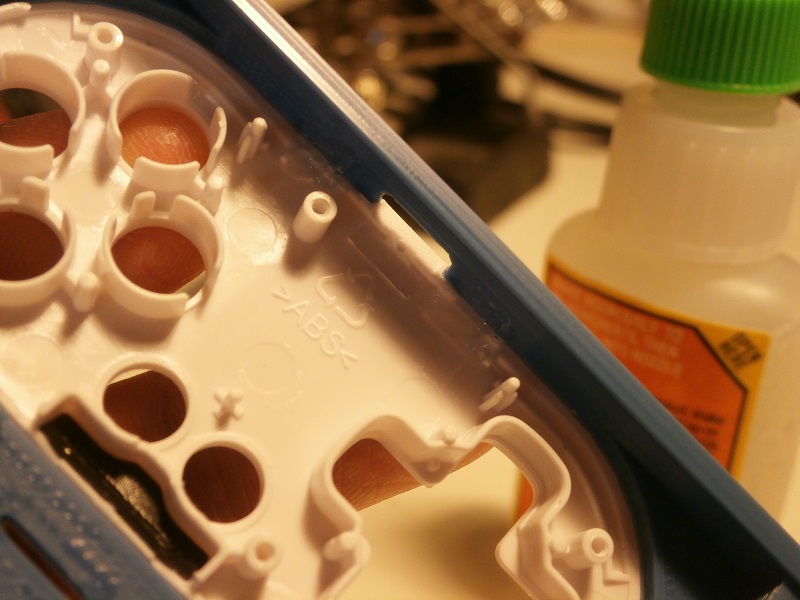

I hardly ever play games on my phone because I hate using touchscreen controls for anything other than puzzle games.
The goal here is to approximate the feel of a gameboy while keeping the package somewhat minimalist.
After doing some research and reading reviews, I settled on using an 8bitdo Zero bluetooth controller.
Although I had measurements beforehand, this thing is smaller than I expected.  The buttons are about 2/3 the size of original gameboy buttons.
Still the width of the controller means that the board and buttons can just be swapped into another housing without having to hack much.
I tested the controller with retroarch, John GBS, & MasterGear.  It worked good with all of them.
The buttons and D-Pad have a good feel to them.  They have a good amount of travel and only take a light touch to activate.

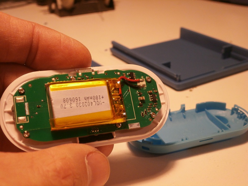

I was hoping the battery was on the bottom so the thickness could be cut in half.

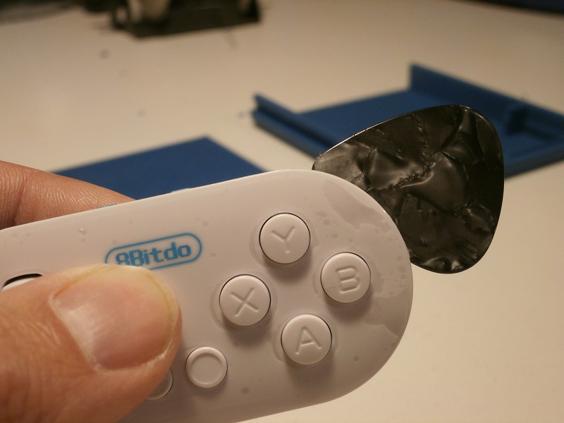

The two halves were held together with a small amount of glue.  There were alignment pegs, but no clips.
The glue broke loose fairly easily by prying them apart with a heavy guitar pick starting on top the shoulder buttons.
The battery was indeed on the bottom and only held in place with some thin double sided tape which easily separated.
Since the spacing on the D-Pad and buttons are nearly identical, it's tempting just to flip the thing upside down and then remap the emulators so the charging port will be on the bottom.
Having start and select on top would bother me though.

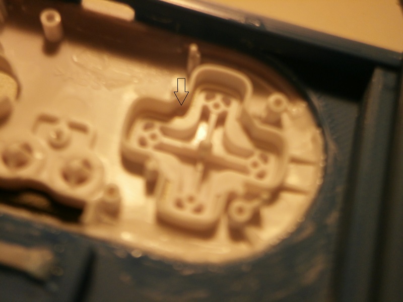

The select and start buttons are made a little differently.
They each have a post in the center that presses a blister button on the pcb.

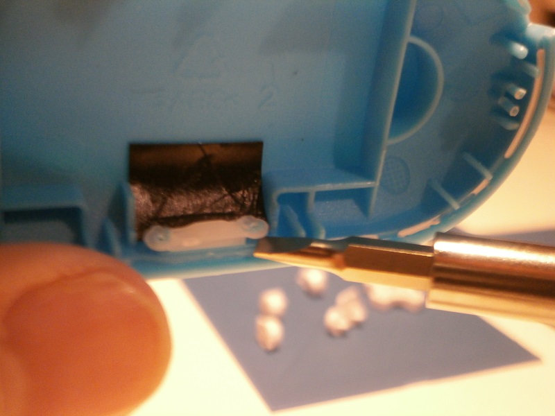

I made a bit of a mess of the PCB removing the micro usb port.  Too impatient to change iron tips or go buy stuff to rig up a hot air system.
I'll know if I really messed it up or not when the micro usb breakout board comes in sometime this week.
So the USB port is definitely getting relocated to the bottom now.
I'm still deciding on how to handle the indicator LED.  The easy way would be to just mount a clear LED above the surface mounted one on the PCB.
It wouldn't be hooked up, but just act as a window for the light to shine through.
The light would be facing you though, which kinda sucks.

Trying to extend the microUSB port has gotten the better of me.
I tried my smallest soldering tip and used wire from a patch cable, but just couldn't get the job done working at that small of a scale.
I've lifted and broken half the traces.  I took some pics, but had trouble transferring them from my new phone.
The controller still works, but I'm not sure if the battery can be charged directly.
Because of that and wanting to get a useable prototype printed faster, I'm going to cop out on quite a lot.

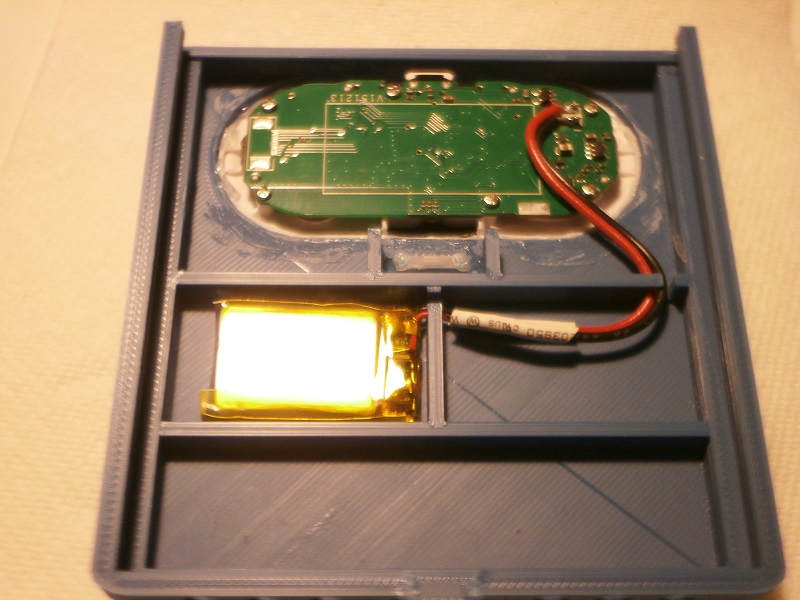

One of the things I've been pondering is how to attach the front and back.
I've decided to just use tiny screws in the sides.  There will be a recess for the screw heads.
The battery leads will still need to be extended and the battery will have it's own compartment.
For the LED, I'm going to rig up something where the one on the current PCB will be reflected to a little window on the front.
A spare clear LED didn't work very well.  I suppose it's only meant to propagate the light it's generating, not light coming in from the sides.
Tired of tinkering with it for now, but think I've got my direction.
My goal is to have a prototype 3D printed this weekend.
The current design can accept phones up to 75mm wide and 10mm thick.
I plan to line the inside with felt tape or microsuede.
It covers up the bottom 65mm of the phone.
EDIT: The entire shell is 85mm wide and around 20-22mm thick.

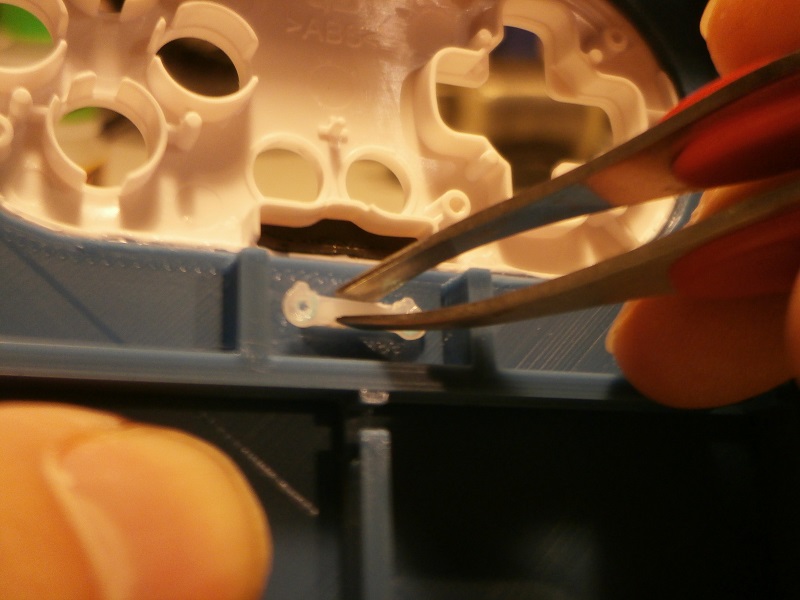

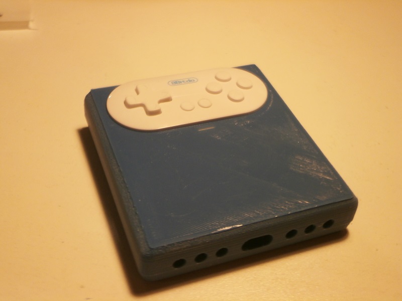

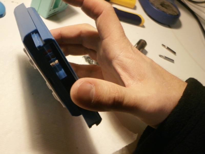

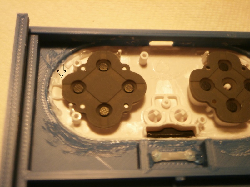

I learn a lot faster from mistakes, so I went ahead and started printing the front piece.
That way I can see what doesn't come out right and then figure out why.
It should be done in a couple hours and then I'll see how stuff fits.
I'm so grateful for Tinkercad at this point.  With basic building blocks and some ingenuity, I was able to create what I wanted in just a few 2 hour sessions. (I did go through the tutorials and some youtube videos about a month ago)
Exported a .stl file from Tinkercad, opened that with Cura, set the infill to 100%, exported in G-code format to a microSD, and now it's being printed.  :applaud:
The most likely thing to go wrong will be the overhangs or the phone charger opening drooping.
If so, I'll just go back and give it sharper edges and some supports.
  • Posts: 9289
Re: Bitdo Boy - Gameboy style bluetooth phone controller sleeve
« Reply #12 on: November 05, 2016, 04:47:22 pm »

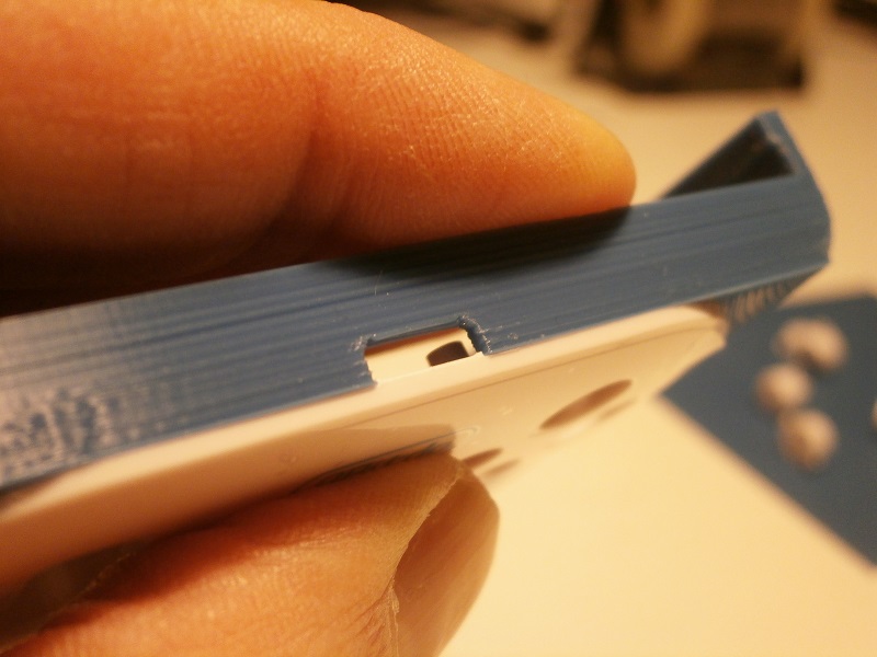

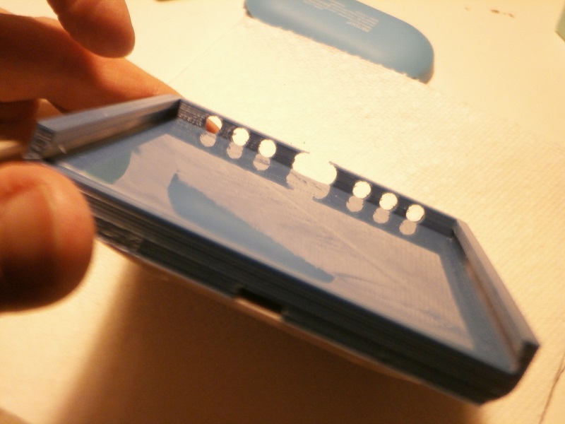

Looks better in person than in the pic, although it does has some artifacts from the way the pieces fit together in tinkercad.
The most pronounced are recessed lines next to the corners.  (I did align everything)
I'm happy with it for a first attempt....at least it was a successful print.
The openings and overhangs I was worried about aren't going to be an issue.
First major screwup: The opening isn't large enough for the controller front to settle down in.
I must have measured wrong.  :-\ (EDIT:  measured correctly, but must have resized the part in Tinkercad at some point)
The height of the LED block opening is good, but it needs widened the tiniest bit.
The biggest thing is that I want my thumbs an inch higher.  It's workable as is, but just doesn't have the right feel.
It needs to be long enough that the bottom can rest on my pinky fingers.  That is what I think would feel right.
I can take it up about a half inch further before the playfield starts getting covered.  The playfield is resizeable, but I don't want to shrink it.

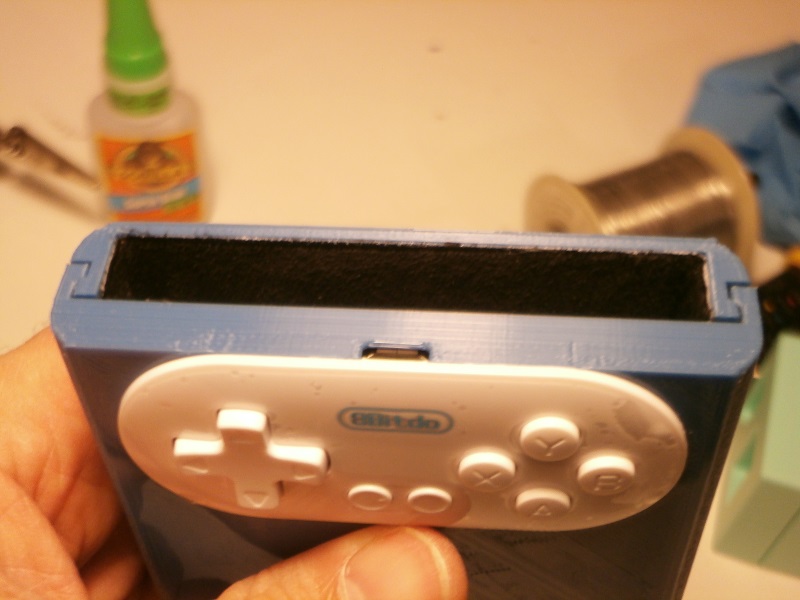

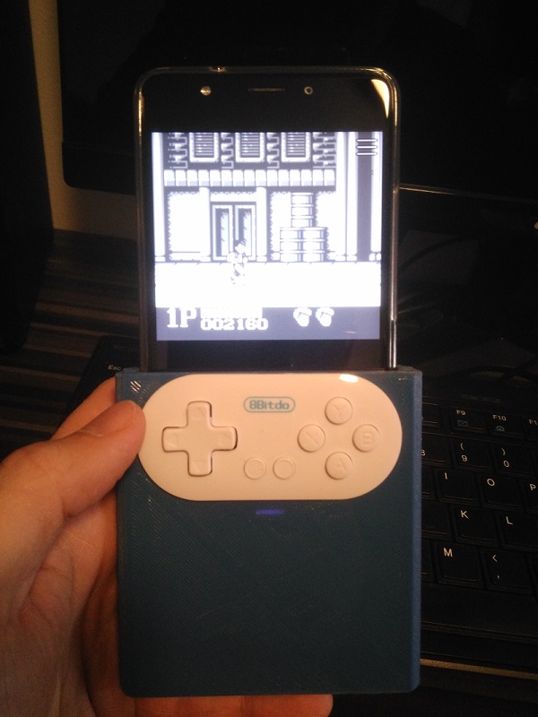

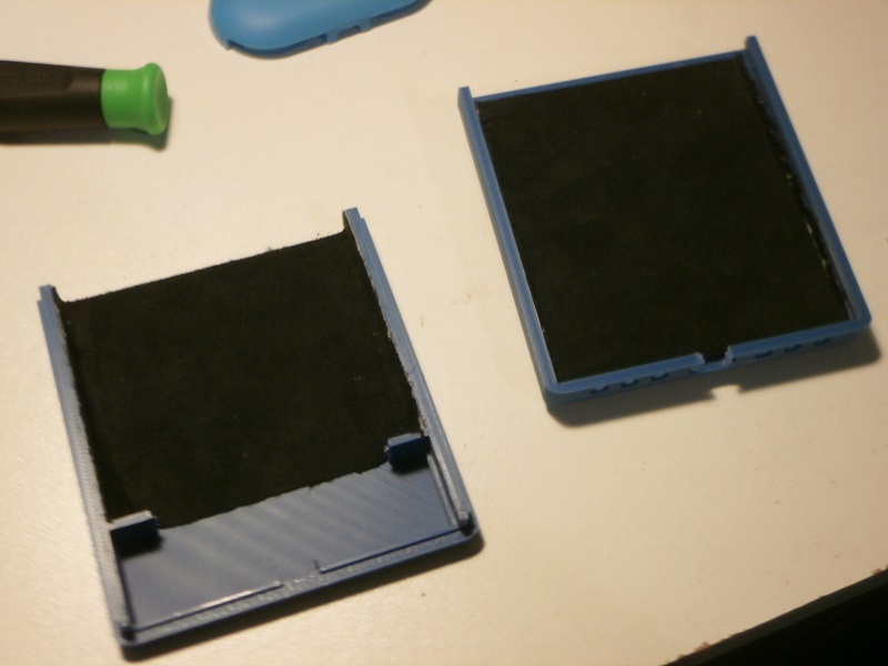

Longer version of the front piece is being printed.
I have the middle divider and back ready to print, but will wait and see how the front fits first.
This is how far the phone will extend into it.  I didn't want to add anything too permanent to keep the phone propped up.
I'm leaning toward putting tabs on the back part, since that part would be easier/cheaper to print and swap out.
I still may do something adjustable or cut to fit.
I couldn't locally find tiny 3 or 4 mm screws like I'd planned to put into the sides.
Ebay from China is an option, but it would be a bag of 1,000 and take too long to get here.
So, I'm still not sure how the front and back will be attached in the final design.

Here's the front, which came out better than the last one.
Artifacts much better this round, but still there on the right corner.  I'm assuming that I'll have to learn how to use another program to eliminate them completely.  I redid the build surface with a self adhesive PEI sheet rather than masking tape used in the last round.
Bottom layer is much smoother, although you can see where every bubble in the PEI was.  (I could not see them when installing it...maybe blisters from the heated bed?)
The opening for the controller still isn't 100% right.  I think I'm trying to make the tolerances too tight.
I will add more wiggle room to the next revision.  Same goes for the cutout for the translucent block for the LED.  It fit, but was way more trouble to get in than it should have been.
MAIN THING WHEN GLUING IN THE CONTROLLER IS TO TAKE IT APART SO YOU DON'T GET GLUE ON THE BUTTONS!
The glue will run straight into the B button hole...which it did.  I had to take it apart, sand, work a little with an exacto, etc.
Now I know for next time.

EDIT: The controller itself works great!  It just feels right.  No noticeable lag, buttons only require a light touch.
DOUBLE EDIT:  I must still have some muscle memory kicking around because I had to reverse the A and B buttons for it to feel right.

This is how it fits together.  I don't like that I can see light through a gap in the bottom.  The next revision will have some type of overlap there.
It just fits my phone with the case on.  The phone case keeps the front from contacting the screen.
Future revisions will have some extra room for felt tape or something similar.
....pretty much exactly what I had in mind.  ;D
The next revision won't be much different than this one.  Mostly making it prettier and finding a better way to attach the front and back.

Use a heavy guitar pick to pry apart an 8-bitdo Zero starting at the shoulder buttons.
(Leave the protective film on the controller face until the end)
Remove the battery from the back of the PCB and extend the battery leads 3 inches.  Keep the doubles sided tape side of the battery facing up.
We're going to rely on reusing it.  You could get away with leaving the battery in place if you made the front face a few mm thicker.
Disassemble the rest of the 8-bitdo Zero so that glue does not get into the parts when the faceplate is glued on.

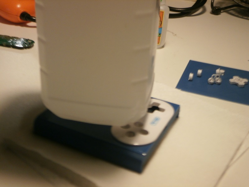

Glue the faceplate in place using a couple dabs of superglue (I used gel).
The top of the faceplate should be flush with the top of the 3D printed housing.
After the top has set, add a couple dabs of superglue at the bottom.  I used a bottle to keep it pressed down while the superglue set.
When the dabs of superglue are dry, go all the way around the edge.
Using a small screwdriver or exacto knife, pry up on the tabs on each side of the translucent white LED window in the 8bitdo zero back.
It should pop off easily.
Using tweezers, place it into the printed front panel.  Be careful, it will go flying if you squeeze the tweezers too hard.
Use tweezers to get it started, then press it in with something solid.  It should come out flush with the front.  Ad a dab of glue on each side.
After the glue dries, reassemble the 8bitdo zero into the front panel.
It helps to keep it elevated off the surface you're working on so the buttons don't press against the stuff behind them and lift them out of position.
(prop the bottom part of the 8bitdoboy up on something)
All the parts are keyed so there is only one correct way for them to go back in.
The D-pad is keyed on this corner:
The rubber contact pad for the buttons is flat on this side:
Route the battery wiring and stick the battery to a lower compartment using the original double sided tape.
If you want to add a layer of microsuede to line the interior, now is the time.  Be careful not to extend it into the channels the back will slide into.
(I went back and added it after taking the following pic.  I also messed up and didn't allow enough room on the edges for the sides to slide together)
Put the divider in place, shiny side toward the phone.
Slide the back into place.  If it doesn't slide down all the way, check the bottom of the channels for imperfections that may need cut away.
Peel off the protective layer, pair it with your phone and you're done!
This was printed in PLA on my monoprice mini and fits together real snug.  It feels like it snaps into place at the bottom even though I didn't incorporate any latches.
I printed this blue one in much thinner layers and higher heat.  I don't really think it made it any better.  The ridges on the sides from the print just feel like a part of the design.
