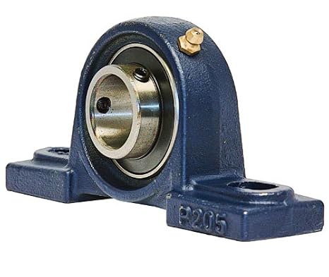

These may be part of the solution (bearings in a mount):
https://www.amazon.com/UCP205-16-Pillow-Mounted-Bearing-Diameter/dp/B002BBQAK0/ref=sr_1_1?s=industrial&ie=UTF8&qid=1467339916&sr=1-1&keywords=bearings+mounted
I thought about seating bearings in a pipe instead, but my accomplishing that seems less likely than using these mounts. It will be bulkier, but way easier for me to make.
More renders (plans)
Below is my first version. This is utilizing the bearing/mounts in the Amazon link above. They're not mounted to anything in this image, just floating in space.
So, left to right:
- the vertical box on the left is the arm that the handlebars attach to. They are above the view of the picture.
- the red spring centers the wheel. Now this is probably going to suck - I can imagine the wheel bouncing back and forth if someone lets go of it! I'll need a better plan I think.
- a rod goes through the 2 bearings and twists the pot (small dark colored thing on the right).
Idea #2
Here the bearings are seated inside a pipe (partially transparent). Nice and compact, but I don't know if I can build that.
The first design will probably be closer to what I will do. I can put this stuff into a box, and I can have the throttle linkage and pot in there as well. However, if I could figure out idea #2 I could use the same idea for the throttle and have it all in the handlebar itself. Ya good luck with that!

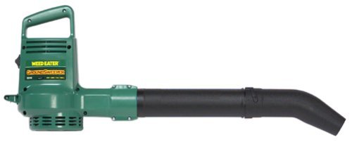

*** Random ***
I have what may be a unique way of cleaning my computers out.
I open it up, take it outside, grab my electric leaf blower, and I blast the sucker. You betcha!
I start at a distance and work closer to be safe. It isn't as strong as a gas powered one but it packs a punch. I can get in the nooks behind the case faceplate, under the motherboard.
That CPU fan is spotless after that. I spin that thing like it's never been spun, I guarantee it. I've never had a problem, I've been doing it for 3 or 4 years. Not often at all though. Maybe I'll fry a fan. Screw it, it's fun too!
With this cabinet computer I was getting really high CPU temps and it was shutting down. I saw the CPU fan packed with dust. After blasting it my temps fell 50% and are well below normal. I think it started around 90 celsius and ended up in the forties. IIRC.
Just thought I'd share haha.

Yes! I could make it work in a lot of ways but I want it to look slick and match the theme.
Using an existing stick would be cool if I can find one strong enough to support the bars. Having a return spring and enough tension is another challenge, due to the height and weight of the thing.
I just need to set my mind on it and start. First stop - a motorcycle shop, or junkyard if I can find one. I used to work at a MC shop. I need bars, throttle assembly, maybe levers too. Grips. Clamps/risers.
Then the clamps need to attach to a mount that I will most likely need to make. How, you ask?  :dunno
From that point and onward, it's a joystick. If I used one of the bearing assemblies pictured up the page then I'd be halfway there. I need to seat the bearings into a pipe though and I don't know if I can do that. What pipe is bearing-ready? ;)
If I use the mountable bearings I will have a bigger unit. but then, depending on the return spring system I use, I may need the extra space for that anyways. Actually the throttle pot and linkage should go in there too, so maybe I CAN use the mountable (easier) bearings.
Please stop me if anyone more knowledgeable in these things knows that I am on the wrong track. I'm totally making this up as I go, and I'm not real experienced in this area.
I wonder if I should make a PVC mockup or if I should just go for it. I'm gonna think on it all.
