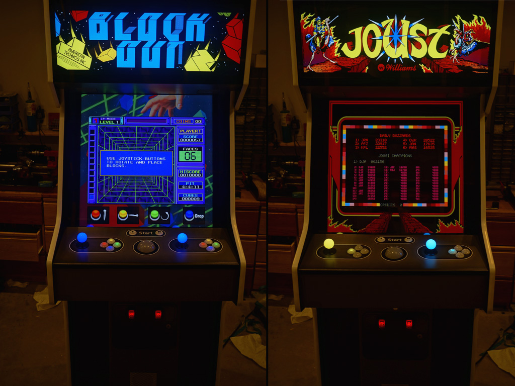

I got the control panel populated.  Ultimarc Servosticks for P1 and P2, with Paradise transparent balltops and roll-my-own RGB leds in them.  Electric Ice 2 buttons with RGB Drive IIs from GGG, going through an Ultimarc I-PAC Ultimate I/O...  I think I ordered parts from most of the vendors who hang out here.
Things are tightly packed under my panel.  The neatness of my wiring won't be winning me any awards.  Considering that it's mostly prefab harnesses, it probably could have been worse.
Probably.
But hey, it looks better from the top.
This was the stage where I did a bunch of the software development, and committed the classic error of realizing the thing was playable.
(That panel may have sat on those stacked 2x4s for a few weeks as a result.)
Here's the cabinet, as assembled and freestanding for the first time, with the control panel in place.
The T-molding for the top box needed to be extensively modified - the center barb is shaved flush for the entire span it runs over the aluminum flashing.  At this point the insides of the verticals still need to be primed and painted black.  The wall mounting panel is visible in the back, above the power strip.
Looking from the CPU shelf towards the front of the machine:
you can see the tops of the four silver nut inserts that the L panel screws into.  There's a lot of room down there, for a reason I'll be explaining in the next post.
After painting the insides of the verticals, here's a player's-eye-view of the control panel, as installed.
(I know RGB controls get a mixed reaction here, but I wanted to be able to color-highlight the active control set for the current game, in the appropriate game colors.  Having anything be RGB, to me suggested that everything ought to be RGB.  If the trackball is going to light up when it's active, then the buttons should do the same, and if the buttons do, then I think the sticks should, too - consistency of meaning, and it seems to help people trying out a new game to see it.)
+1
This makes a MAME cab much more guest friendly.

Your panel is tastefully done and your cab is a unique design, you won't hear RGB hate from me.
Re: My first build: "Mimic"
« Reply #17 on: January 18, 2016, 12:46:43 pm »
Excellent panel. And you're doing RGB the **right** way.

Token - Thanks.  It does seem to work.  Between that, and making whatever buttons I see guests try to push to operate the frontend work how they wanted wherever possible, the result does seem to be something that people can just walk up to and use, and that's neat.  I think that low investment, just walk up and play feeling is something that all the arcade machines had, and I wanted to try to keep that.
Alejo I - Thank you.  I kept the design very stark and simple, because all the color is going to be coming from elsewhere.  I respect that slim is not to everyone's taste; here, it fit the space I had to mount it in, which is an alcove where you can't get much of a side view on it because of the surrounding walls anyway.

The resulting chameleon effect, with a few games:
vwalbridge - THAT is why the name, Mimic.   ;D
