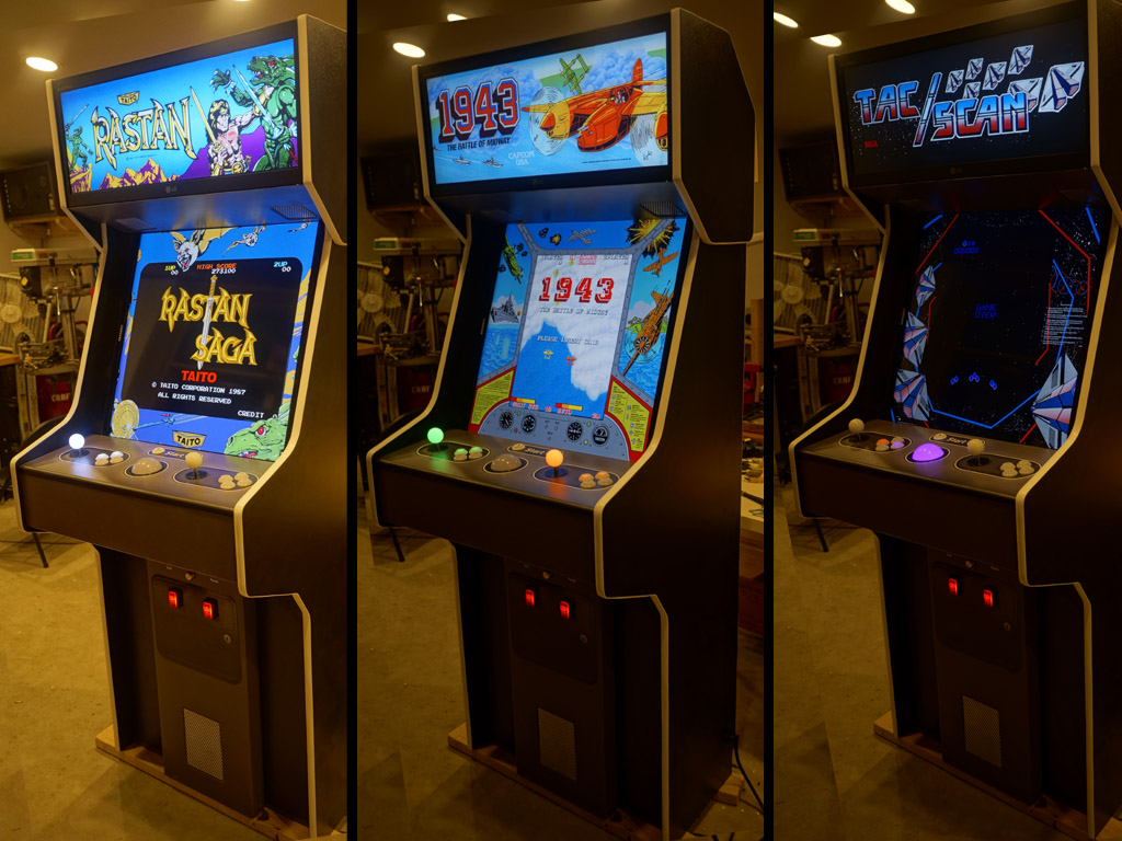

Mimic:
A slim, dual LCD, dynamic bezel, dynamic marquee, fully illuminated control panel chameleon, with custom frontend software.
Original build thread follows.
I've spent quite a while lurking here, reading about other projects, gathering the details that I liked - and noting the things I wanted to avoid.  Decided to give my own project a shot.
Note that this is a retrospective, past tense build thread - I didn't want to post anything until I was at least 95% finished, because that was the only way I could be absolutely certain I wasn't going to peter out and leave you hanging halfway through.  (I know, some folks here prefer the chance to chime in before it's too late to fix something they see - sorry about that.)  You can of course still speak your mind - I just can't retroactively take your advice.
I figure, I learned a lot from seeing what you all had built, so, I'll post pictures of what I did, in case that is of similar use to anyone else.  I documented my progress as I went, so this will be a bit more than a drive-by photo of a finished project.
This'll also serve as an introduction, of sorts, since I've kept quiet till now.   Hi.   :)

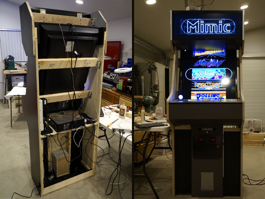

Internally, my plans are somewhat like a bartop, in that almost all of the actual running gear is in the upper half - aside from the subwoofer, the whole bottom half is empty.  I've got a CPU shelf dividing the space at the height of the bottom of the control panel swell, which has 4x 120mm fans, the CPU sitting between them, and a couple cable passthroughs.
The fans are set up above the ceiling of the storage bay, which keeps them out of the way.
As seen from the top, with my crudely breadboarded proof-of-concept fan power setup, and the PC in the center:
The number and size of fans may be overkill, but the 120s are nice and quiet.

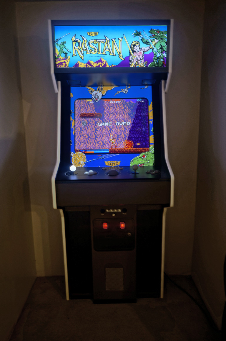

Assembling everything onto the center column, and adding some small white vinyl lettering to explain the function of the buttons, produces this:
Thanks for the CDRs and the coin door art, Randy.  At knee height, in a dimly lit room, with the buttons lit - it's a surprisingly effective illusion.

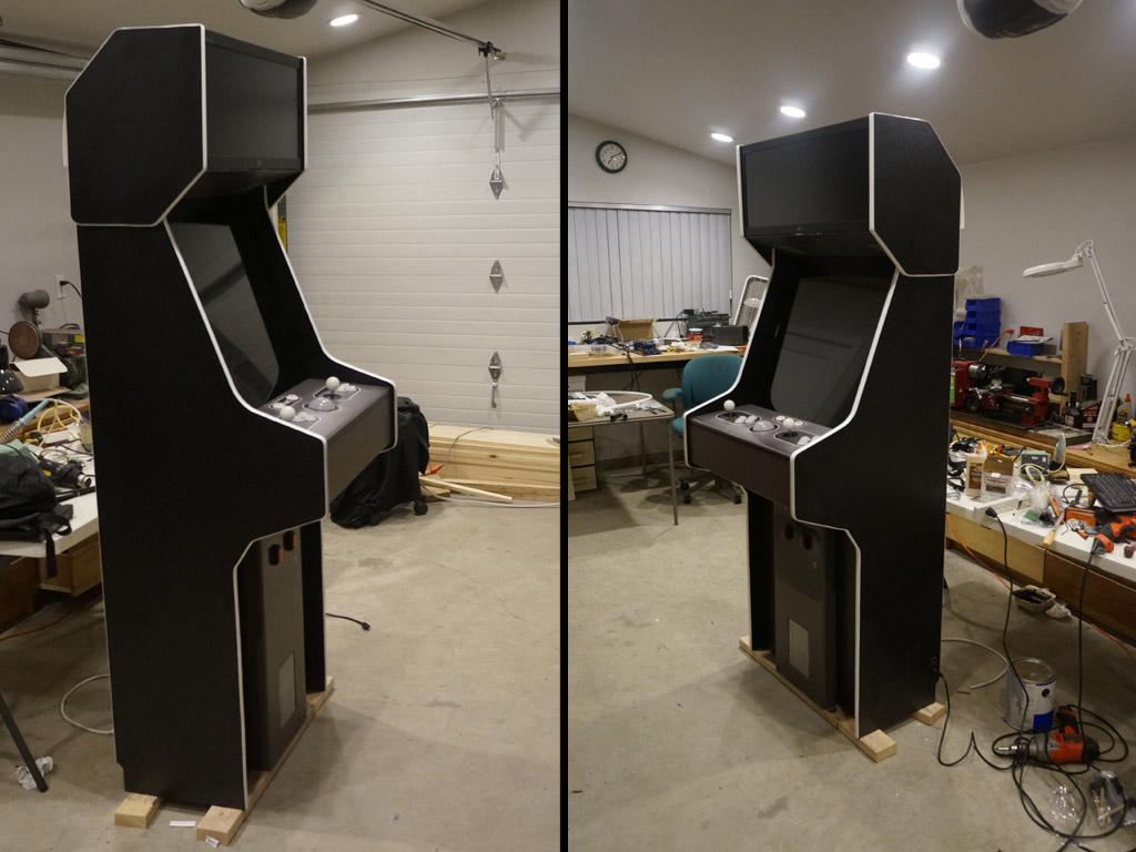

Here's the cabinet, as assembled and freestanding for the first time, with the control panel in place.
The T-molding for the top box needed to be extensively modified - the center barb is shaved flush for the entire span it runs over the aluminum flashing.  At this point the insides of the verticals still need to be primed and painted black.  The wall mounting panel is visible in the back, above the power strip.
Looking from the CPU shelf towards the front of the machine:
you can see the tops of the four silver nut inserts that the L panel screws into.  There's a lot of room down there, for a reason I'll be explaining in the next post.

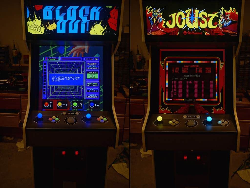

(I know RGB controls get a mixed reaction here, but I wanted to be able to color-highlight the active control set for the current game, in the appropriate game colors.  Having anything be RGB, to me suggested that everything ought to be RGB.  If the trackball is going to light up when it's active, then the buttons should do the same, and if the buttons do, then I think the sticks should, too - consistency of meaning, and it seems to help people trying out a new game to see it.)

Your panel is tastefully done and your cab is a unique design, you won't hear RGB hate from me.
Re: My first build: "Mimic"
« Reply #17 on: January 18, 2016, 12:46:43 pm »
Excellent panel. And you're doing RGB the **right** way.

So, with both screens in, from front and back:
(Pardon the right-side storage door sitting on the floor instead of in it's frame in this shot - it does actually fit correctly.)
You can see the degree to which the thing is designed around the TV.  The deep control panel helps match the tall marquee box and gives me the space I need to hide the inert ends of the television that I am not using.   The TV is set for a 20 degree lean back, and the top edge of it almost touches the wall, leaving a half inch slot for warm exhaust air to blow out the top of the machine.  That set the overall depth limit on how slim the machine could be.
Here's how the machine looks, when turned off, with the screens installed and the T-molding in place.  (This picture is from prior to glass installation - there are still to be glass panels over both the TV and the marquee monitor, with black paint on the back of them everywhere but the display areas, to prevent you seeing past the sides of the main screen, and to hide the badges on the display cases.)

The resulting chameleon effect, with a few games:
vwalbridge - THAT is why the name, Mimic.   ;D

And, finally, as wall-mounted in the alcove in my house:

I wrote my own front end software for it from scratch.  My custom front end talks to the Ultimarc servostiks to switch 4-way or 8-way as appropriate, and talks to the Ipac Ultimate I/O that controls the RGB LEDs per game.  It either displays my Mimic logo (when in the menus), or the appropriate game marquee, on the upper panel.   Then either fires up MAME, Nebula or AAE, depending on the game.  I'm running a game list of about a hundred.
I'm using the marquee art, as the menu selection art, which I think works well.  Up and down on the P1 stick scrolls through the list; left and right jump one letter at a time through it.  The list is shown as the marquee art, and when you select a game (via just about any button) that jumps up to the marquee.
