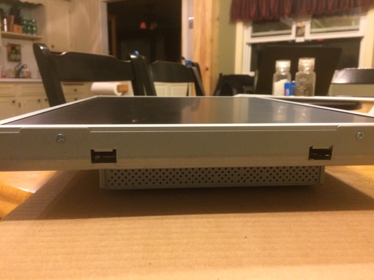

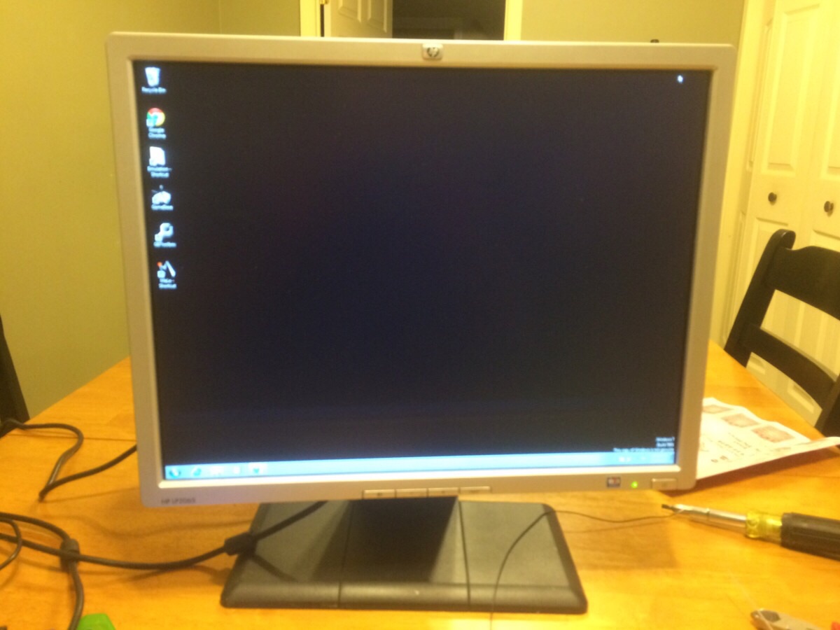

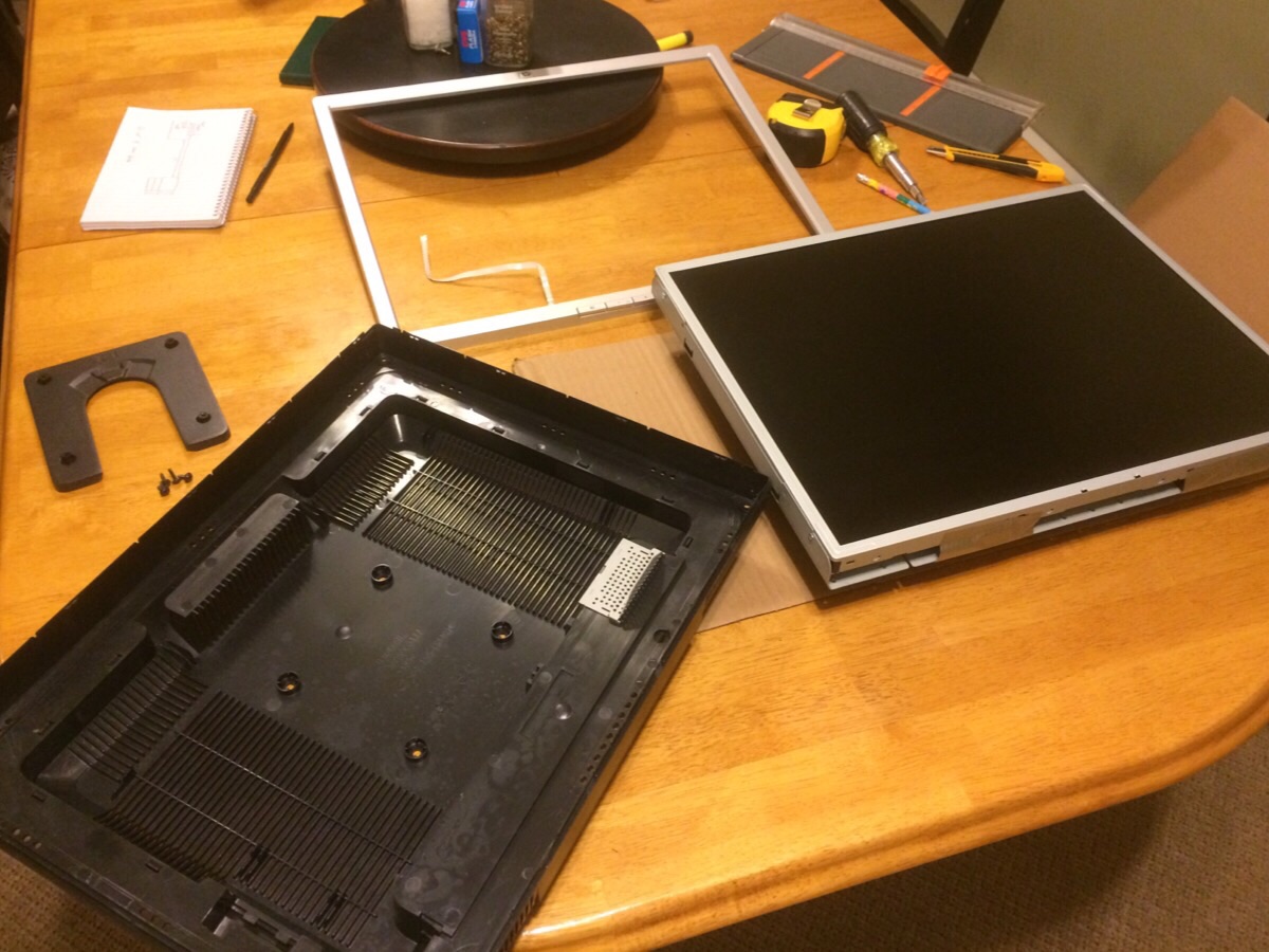

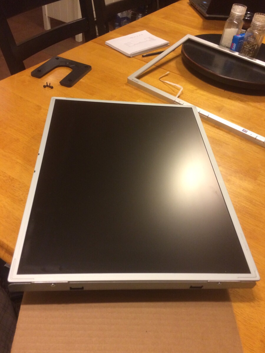

The monitor I'm using is an HP LP2065.
It's a 20" 4:3 IPS display.
I stripped it out of its casing to save as much room as I possibly can

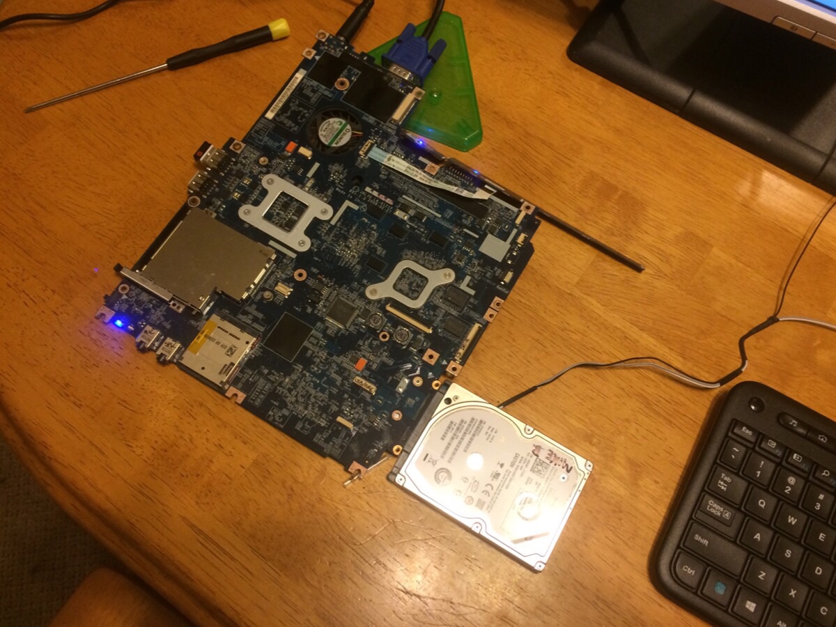

For the brains I will be using a Dell Duo Core Laptop I had around.
I stripped the mobo out and will be adding a SSD with Windows 7.
My plans are to keep it as light as possible.
Are you sure that's an IPS? That model had two different screens.
From a review:
Check the revision number on your box or on the back of your monitor. If it starts with "GSM" followed by 3 numbers then you have an S-IPS panel and won the "HP Lottery". Otherwise, you got the MVA panel which, while good, is not as color accurate as the IPS.

Thanks for that because I had read that there were two different displays so I wasn't positive but I checked and sure enough it has the Gsm followed by 000 (I'm not sure why just zeros.)
Only kinda crumby thing is it has 2 dvi inputs and no vga input.
I will be using a vga to dvi plug will the mini slg still work as long as its before the adaptor
I almost jumped on a good deal on the a while back but I have 3 20inch or larger 3:4 monitors waiting for me back in the U.S. If you don't mind me asking how much did you pay for it?

First off, I wouldn't really "secure the plug" like people suggested.  If anything you WANT it to unplug if someone were to trip on the power cord accidentally.  Better to have it power off then to have it sideways on the ground with the cord still attached.  Most consoles today are designed this way (controllers) for that very reason.
The SLG works fine with DVI/VGA adapters on a monitor.  So no worries there.  I've tested them on my Samsung IPS monitor.  Also, you can put the SLG on either end of the VGA cord and it will still work.  So you could have the DVI/VGA adapter, the SLG, the VGA cord and the computer.  Or, the DVI/VGA adapter, the VGA cord, the SLG and the computer.
