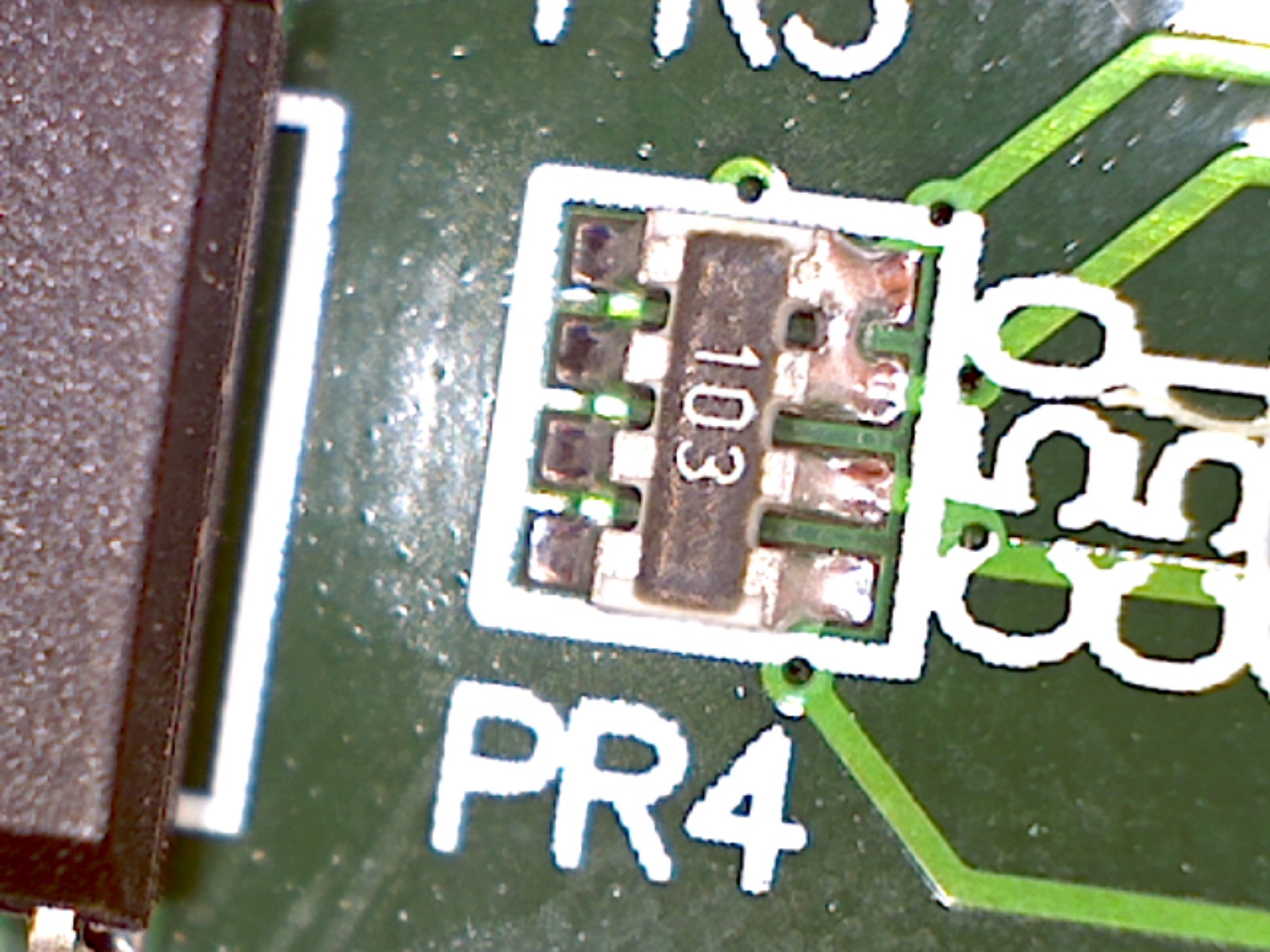

I'm having an issue with a new 60-in-1 PCB board..
I’m testing the board and all the control leads using “I/O test”
All the wire pinouts appear ok, except Player 1:
1)   Red wire #18 (Part side) triggers both “P1-UP” and “P1-Left”,
                  and
2)   Yellow wire #20 (Part side) triggers both “P1-Left” and “P1-UP”.
This isn’t  a harness issue, as I removed the harness from the board, and  tested these two wires with an ohm meter, and they are not shorted.
Unless it’s a programming issue, I wonder if the board is shorting the two some where?
Any ideas?
Thank you!

I found this on the board... which is a short between two pins soldered on PR4 (resistor pack?).
I sort of doubt this would be intentional unless someone screwed up on the board design and this was a quick fix..

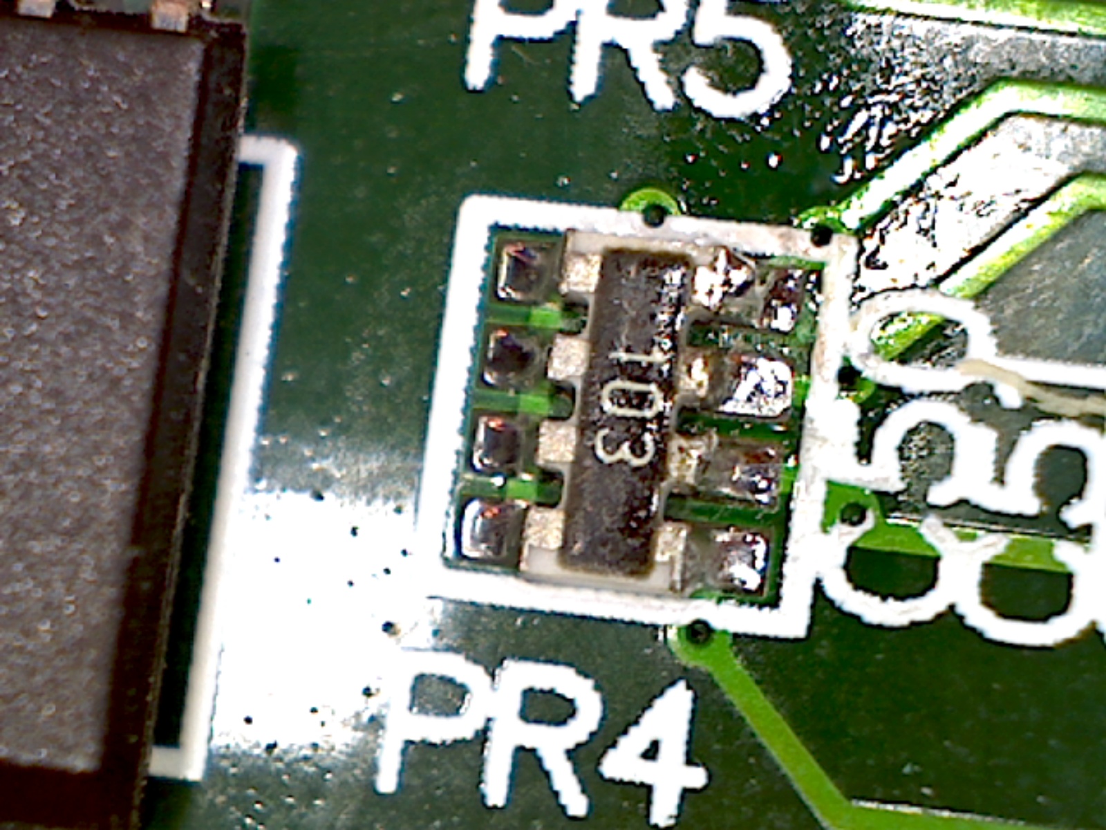

I was lucky.... I found that short on the resistor pack... remove it... everything works now for player 1-UP and player 1-Left
Picture after I removed the short.
It is obvious this board was not tested.. this could never have worked correctly.... anyways.. glad it works now.

Thanks RetroGreg.. I had more boards coming.. but I took a chance (despite it being micro-work), removed the short, and it works correctly now.
I have to say I never thought I'd use my PC microscope before to repair PCB's... but it sure came in handy for this.
Also I didn't want to have to return the board..
