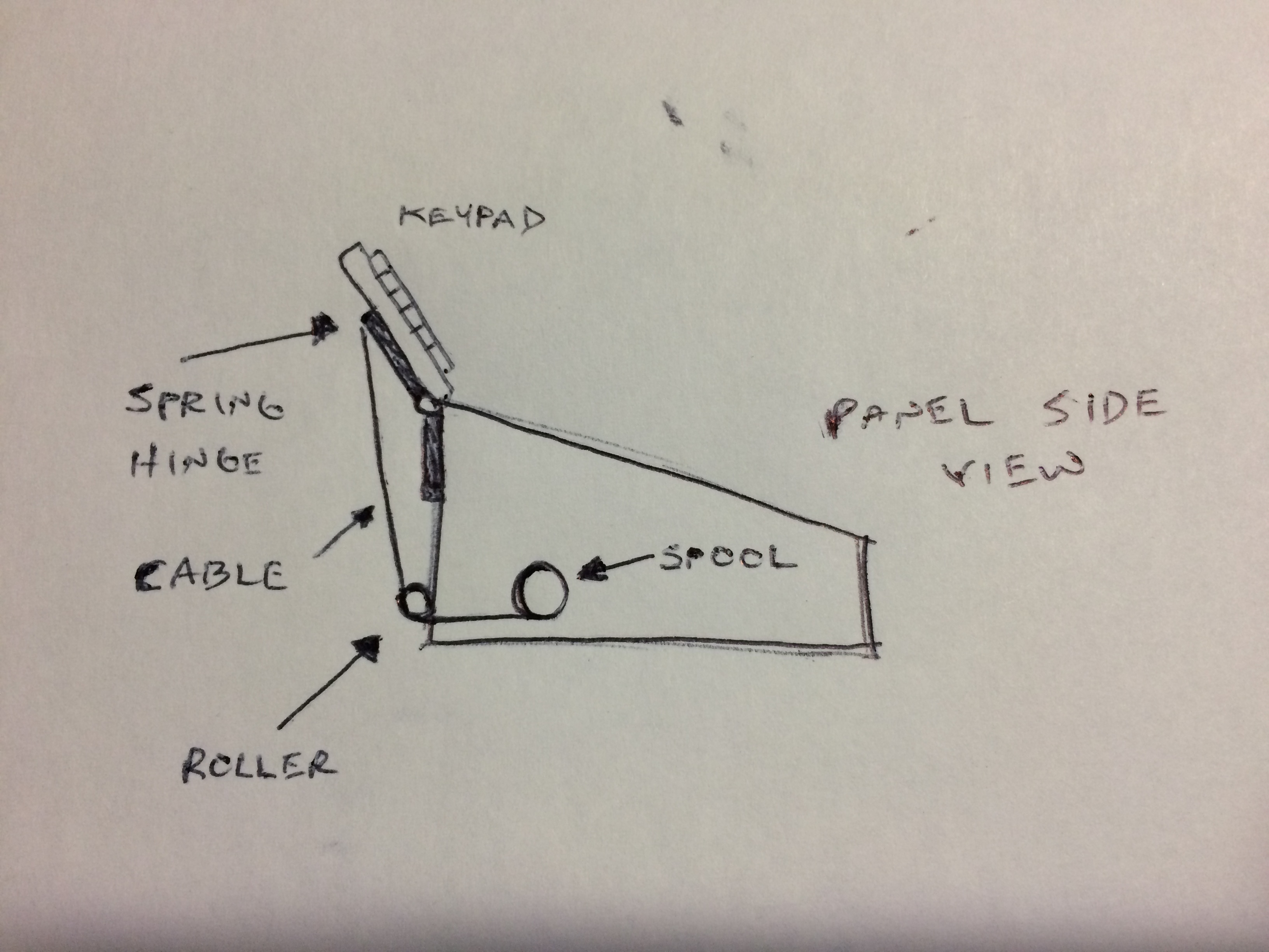

so i'm on again and have some new ideas for my long time coming keypads (i bought an x-key 24 and it looks awesome).  When last i left this idea, i was going to do rotating keypads built into the CP.  but now i have a different idea and need some advice.
on my machine, the CP hangs out from the body of the machine.  i have a hinge with a spring that I will be attaching to the back of the CP that extends from the machine.  i will be attaching the x-key to the sponged hinge so that when it is not being used, it will rotate down and out of sight.  the tension in the spring will rotate it up into place.
my challenge is automating something that will pull the keys down.  below is a quick sketch and i would love some feedback/help to see this realized.
sketch is for the side view of the CP.  on the back is the colored in spring hinge and attached to that is the keypad.  from the top of the extended things is a cable that will feed thru a roller wheel so as not to get caught on the wood.  inside would be a spool that would pull in this cable, closing the hinge and pulling the keypad down.
so i'm just looking for suggestions on how to automate this spool to spin.  i need something that will turn it, and some sort of software/control board to make it al happen.
all thoughts are appreciated

Tony, if you use a small stepper motor it would be pretty easy to set-up.  You could use a micromaestro from pololu to control it with simple scripts.  Just do some testing and figure out how many pulses it takes to wind it up and set your batch for that.  I would recommend a servo but depending on r of the spool you might hit the rotation limit before you're all wound up.  Stuff exactly like that is used in simple robotics kits all the time to actuate movement so there are bound to be tons of guides over on the robotics websites to walk you through it.

If the spring is strong enough to hold the keypad upright and not wobble when keys are pushed, you will need a lot of torque to pull it down.
Perhaps a servo (or motor like you showed) leading to the center of a hinged arm assembly like this where the arms provide support for the keypad.
EDIT: On second thought, don't attach the hinged arms at the top of the keypad.
Attach them 1/3 of the way down (green) and you'll only have to move that green pivot point about 1/2 as far.   :cheers:

thanks for the ideas PL1 but i have an idea on how to support the keypad when it's in the up position.
