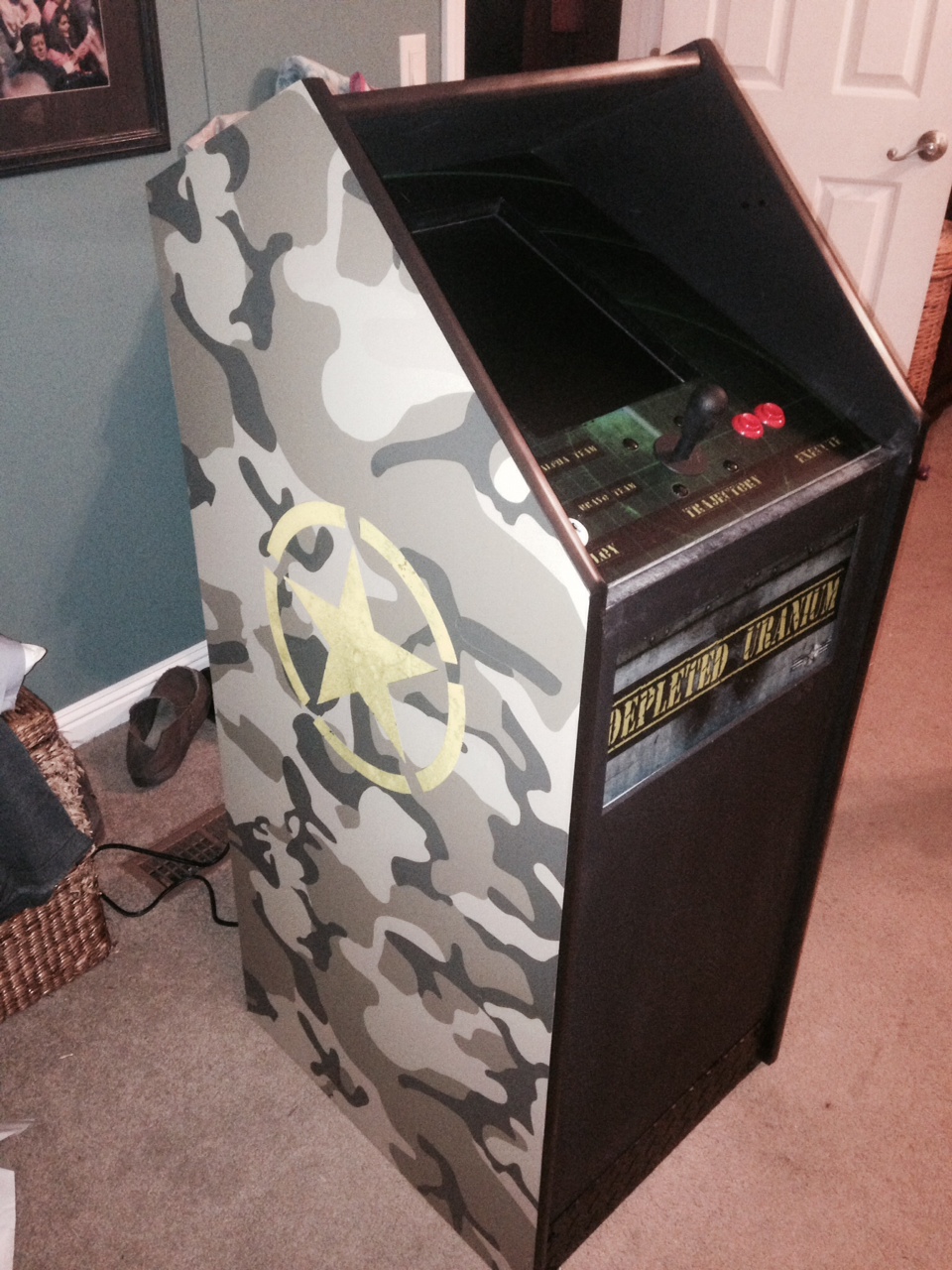

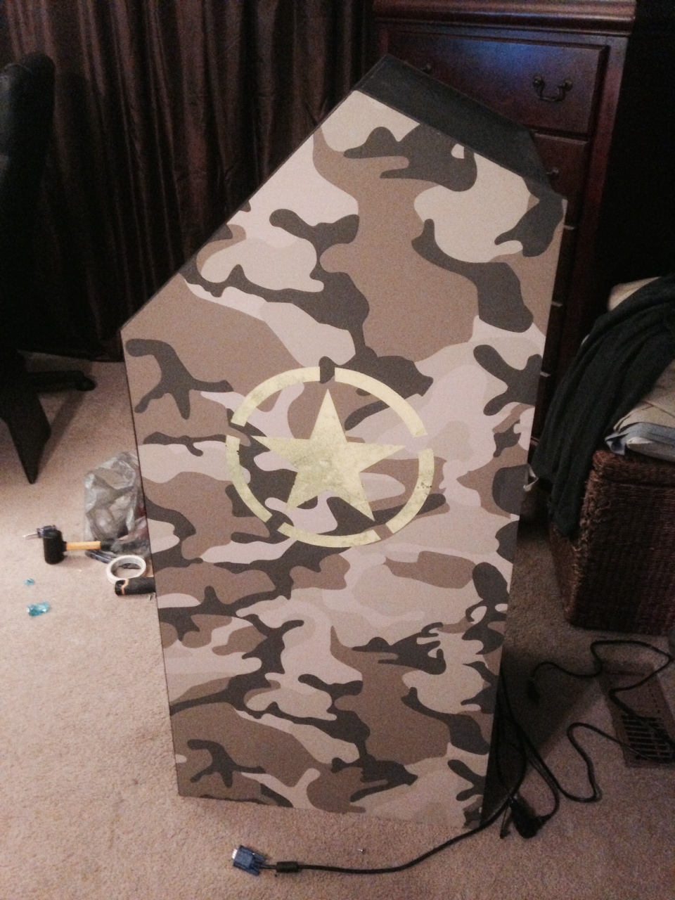

Update: 12/14/14
      I got the camo side art on.The first side was a ---smurfette---.Then, I read on the site that it was not air release vinyl. So on the second side I lightly wet it down and it went on slick.I Also, I printed L.T's art up as PDF template to mark my buttons. I drilled the holes and cut out the recessed area for the joystick. I lost my router wrench, and I couldn't get my slot cutter out,so I cut the area with a forstner bit and chiseled the rest of it out.It didn't turn out too bad for a hack job.This evening I cut the monitor hole out and made braces to hold the monitor in place and I put the diamond plate on the bottom front.

I put the T molding on , Here are some pics. My little girl posed for one.She is a camera hog.

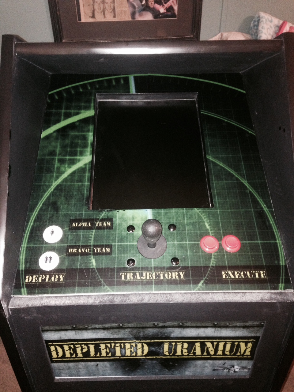

      Hey guys, I got the vinyl on and the control panel basically finished, except for a few minor details.Well I busted my $150 budget. The $150 was a possibility until I messed up the plug n play.My finished dollar amount was between $240 and $250 not counting freebies or extra parts I had laying around. So if a person was trying to build a cabinet without any parts of materials it would be nearly impossible for less than $250.I could however, have probably done it using a computer I already, for probably around $180  I decided on the Jamma because my sister in law's crazy kids would have it screwed up in 15 minutes and I didn't want to have to go over there and fix it.With the Jamma it is basically a bulletproof system.
      To save money I used a cheap remote control Christmas light switch with 3 outlets, instead of a smart strip.Also I'm gonna use a set of cheap amplified computer speakers, and hopefully it will sound halfway decent.
Whats Left:
1.Mount the power supply
2.hook up the jamma harness
3.Put a few pieces of trim on
4.Build a small faux coin door with a coin button.

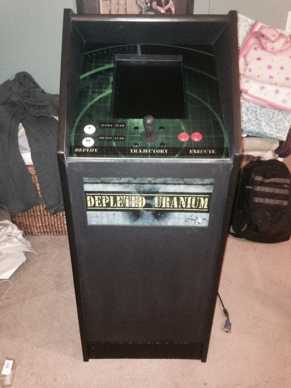

I was down to the wire I got it completely finished. I added Lexan the corner protectors and painted them to look like metal and I added screws to look like rivets.My nephew was excited, I even got a hug out of the deal which made it worth it. He is a good kid.I didn't get a chance to take many final pictures.I was scrambling trying to get it all finished. I wanted to take a picture of the back.I did a pretty neat wiring job.I'll stop by after christmas and take some good pics with my DSLR. So anyway another one done.Here are some pictures
Christmas morning
Picture with faux coin door and faux rivets
« Last Edit: December 25, 2014, 02:57:37 pm by jaharr01 »
