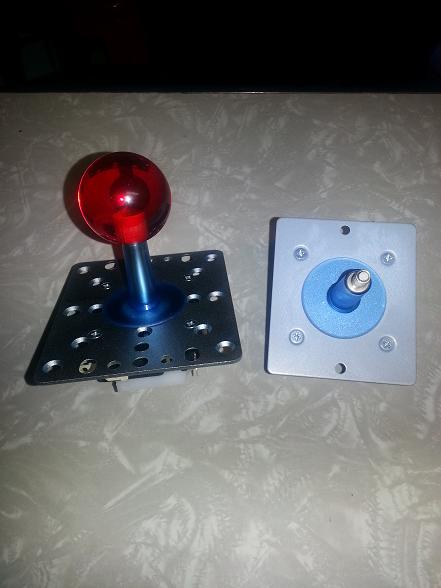

Here are the Seimitsu LS-60's, the adapter plates work brilliantly, and Randy's Hand Candy Ball Tops complete things very nicely.  At first I was going to swap out the blue shaft covers but considering my overall art design plans I actually think the Seimitsu Clear Blue shaft cover/Hand Candy Ruby Gemstone combination looks pretty flipping sweet.
I had a Lowes card from Christmas so I figured I'd buy some Acrylic to cut a new CP cover so that I could test mount the controls.  Seriously.... ---fudgesicle--- Acrylic!  :angry:  I am so pissed that I wasted the money, that ---steaming pile of meadow muffin--- cracks if you fart while drilling it (EVEN WITH A FORSTNER BIT!)  Hell I can hand drill polycarbonate with a spade bit and not crack it!  If you have the $ ALWAYS use Lexan over Acrylic!  I will have to save some $ though because the ---daisies--- at Home Depot only have inexpensive sizes of Lexan 24 inches wide and my panel is 25 and a halfish.  So for that extra inch and a half?  I have to buy a damn 32 x 48 inch piece that is is freaking 70 bucks!
/endrant

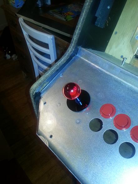

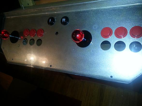

Here are some pictures of the buttons and joys mounted.  I can tell right away that I'm not going to be happy with the buttons in the provided holes.  Definitely want a more Japanese layout, going to head to slagcoin and try to figure out a solution that would require minimal drilling.  I'm thinking I may just drop button 1 down a few millimeters, but who knows?
