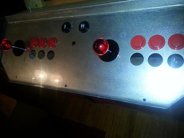

So I bought this from CL for a hundred bucks, it has a big Hantarex and 1945 Strikers installed
I haven't gotten into it yet (just got it home tonight)
It powers on and the screen is all red and has some vertical waves (will post a video later)
As of right now the tentative plan is to do a vertical shooter cab influenced by Opt2Nots Alpha One, though I do not know if it will run boards or a PC with Mame, most likely the latter to accommodate my large game list tendencies.
In the meantime I was hoping some of the tech experts can help me troubleshoot and educate me on what I have, what is good about it and what sucks, general advice etc.
Here are some pics, more information to follow

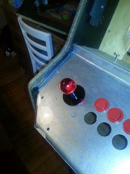

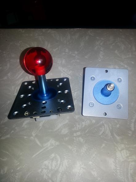

I got some stuff in for the cab so I thought I'd post an update...
Here are the Seimitsu LS-60's, the adapter plates work brilliantly, and Randy's Hand Candy Ball Tops complete things very nicely.  At first I was going to swap out the blue shaft covers but considering my overall art design plans I actually think the Seimitsu Clear Blue shaft cover/Hand Candy Ruby Gemstone combination looks pretty flipping sweet.

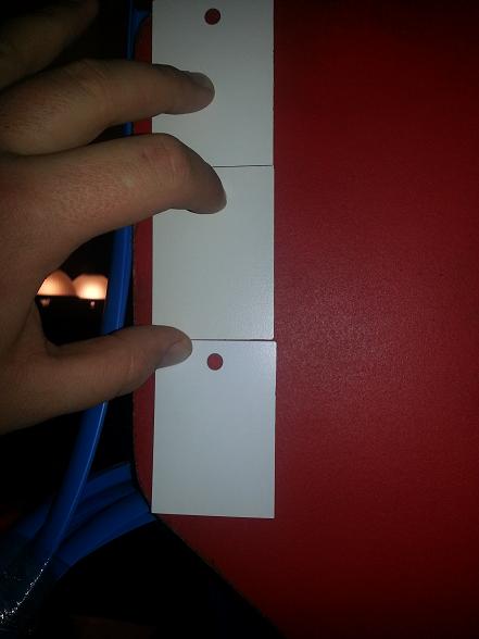

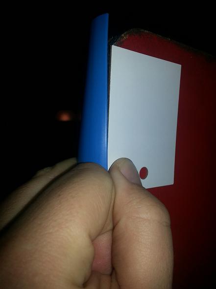

I had a Lowes card from Christmas so I figured I'd buy some Acrylic to cut a new CP cover so that I could test mount the controls.  Seriously.... ---fudgesicle--- Acrylic!  :angry:  I am so pissed that I wasted the money, that ---steaming pile of meadow muffin--- cracks if you fart while drilling it (EVEN WITH A FORSTNER BIT!)  Hell I can hand drill polycarbonate with a spade bit and not crack it!  If you have the $ ALWAYS use Lexan over Acrylic!  I will have to save some $ though because the ---daisies--- at Home Depot only have inexpensive sizes of Lexan 24 inches wide and my panel is 25 and a halfish.  So for that extra inch and a half?  I have to buy a damn 32 x 48 inch piece that is is freaking 70 bucks!
/endrant
Here are some pictures of the buttons and joys mounted.  I can tell right away that I'm not going to be happy with the buttons in the provided holes.  Definitely want a more Japanese layout, going to head to slagcoin and try to figure out a solution that would require minimal drilling.  I'm thinking I may just drop button 1 down a few millimeters, but who knows?
