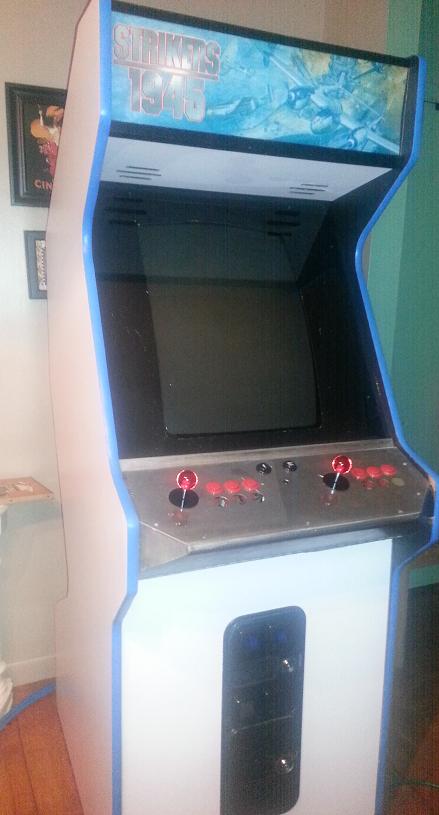

Small Update
I currently have three projects in some stage of planning/execution.  Figured I'd let you in on a couple
Task 1 Refinish the Cab
I've begun to strip the vinyl from the cabinet.  I was unable to deduce a ninja way of doing it, therefore I committed to brute force, determination, and a paint scrapper.  When I got tired of pulling off tiny strips at a time I broke out the heat gun.  I wouldn't say it was faster, but it made things a bit easier.  It also had an unfortunate side effect, leaving adhesive/vinyl remnants but I figured ---fudgesicle--- it, I'll sand that ---steaming pile of meadow muffin--- off later....
Here are some pics of the ol' girl naked...
I haven't bought the laminate yet for her new clothes, because I figure I'll need to refinish it in the shop and you're supposed to do it when the temperature is greater than 70 degrees.
I'm a little nervous about chipping the stuff though, I am pretty sure we have a laminate flush trim bit somewhere in the shop and the youtube videos I've watched make it look pretty simple but the stuff is spendy, and if I screw the pooch that's $ 40 down the drain.  Oh well that's a Spring problem...

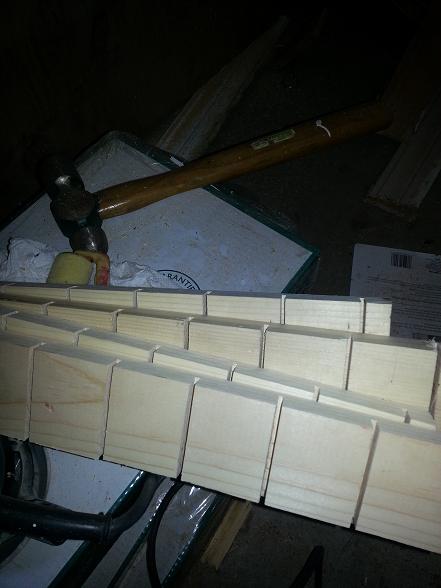

When I was planning this project one of the things I was scared of the most was slot cutting the new work, I've read so many horror stories and seen pictures of blown out work.  But luckily for me my piece was small and was super easy cause I could do it on the router table.  The hardest part of this job was getting the bit at the right level (made several test cuts on scrap wood)
When It came time to actually attach the repair I had grand designs of gluing and doweling it it to place, I even bought a kit that comes with little pokers to help you align the pieces.
Ultimately though (probably because I couldn't get the holes on the existing panel straight because of the bottom getting in the way, the fit just wasn't right with the dowels and I said many cuss words.
So I just butt jointed it to hell, glued and screwed another 1x6 on the inside.

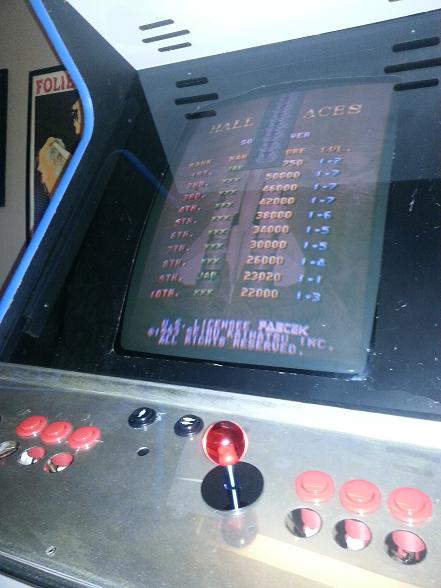

As you may recall if you were following my monitor issue thread, at some point the sync was incorrectly hooked up to this monitor.  I went ahead and set off for my molex crimper and molex connectors and I immediately put them to use.
Before the repair
And after
With any luck I'll have everything back in the cabinet by the weekend....

This isn't really much of an update, but I need to dish out some props and take the opportunity for some feedback given I may have a few issues to work through soon.

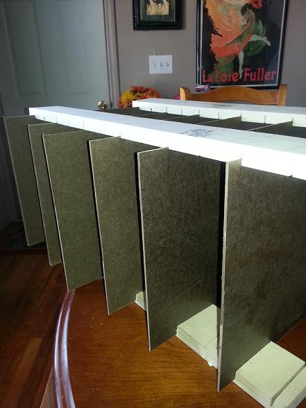

So for board storage (I'm not completely sold that this is the way I'm going) I decided to build my way through the design process.
I'm toying with a sliding panel approach.  Fundamentally I know if I do this, I need to have all my grooves on the supports line up perfectly.  So I decided to cut them all out of the same 1x12 and then rip it down into supports.

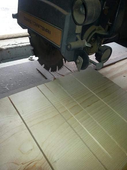

The switch on my table saw went out midway through the project so I had to use something else, it took me a while to gauge the depth and spacing for my cuts as you can see here.
Once I had all the grooves cut on the actual project piece I bypassed the table saw switch and ripped the 1x12 (stupid dangerous, need to get a new switch before I continue using the table saw)  Here are the results.
Ripped down the tempered hardboard to 11 inch high panels.  This is really on the small end and could be the reason I go a different direction.  The board access panel is only a 12 inch opening so if any of my JAMMA boards won't fit on these panels I may have to consider a horizontal mounting option instead.  I'm interested to know opinions on this approach.  What is the widest JAMMA board you have? Do you have many wider than 11 inches?

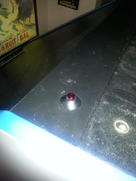

I also did a few house cleaning things, I moved the "add credit" button to the top of the cabinet (ignore the sawdust)

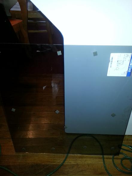

It was ice cold in my garage and I had been storing my monitor out there temporarily while I worked on the Cab.  Once I got the laminate applied I was in a hurry to button things back up and get the components out of the garage and I got in a hurry.
When putting back in the bezel glass I didn't have it set properly, and that coupled with the CP being slightly bent caused an eruption of broken glass.  Thankfully noting was damaged outside of the glass.  I didn't take a picture but it was UGLY and I said many swears.
Thankfully Nep has this same cabinet, and was ever so kind to provide the dimensions of my now devastated bezel glass.  I owe you a beer bro if you're watching.  :cheers:
I was able to source some replacement glass locally for about 27 bucks.
Mounted in the cabinet:
I debated on weather or not to show this, because I still have a lot of work to do, but I did want to give a little mock up to see what things will look like, and I of course have been wanting to play through Raiden II so here's the current mock up.
The button location will change, and the Strikers Marquee is obviously a place holder.  I'm trying to finalize my marquee art so I can order one of those translites that stpcore is offering but I've decided to redo the space portion and lose the Macross jet.  After setting Macross Plus to easy mode, and playing through it in MAME I've decided it's a quarter muncher and so ridiculously hard it's barely fun.  I really want the art to have nods to specific games but not have the plane pictured be easily identifiable as "this" ship from "that" game.  Enough talk here's what she looks like.

Nice rack. :lol
The widest board I've owned has got to be a Midnight Resistance. I remember it was almost a square, > 11 inches.  It was a pain to find a box to fit it in for shipping when I sold it.

Well folks, it's been nearly three months, here's what ol harv has been up to.
We went from this:
to THIS:
More to come on the how and the frustrations during this section of the project that are STILL palpable!
That turned out great.  I really like the stripes.  Are you going to extend them past the coin door?
