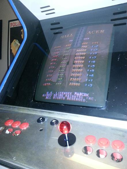

Fix that jumpy monitor picture....
I ordered a cap kit from Syracuse semiconductors on Ebay, I still am nervous as a long tailed cat in a room full of rocking chairs about tackling this but I'll be damned if I'm going to let my fear of failure prevent me from learning arcade Kung Fu.  What's the worse that could happen?  If I mess up the board I can replace it for 100ish bucks....  May the force be with me...
I made myself this...
and it's off to the races....  The discharge was pretty uneventful, before I could brace for a pop the anode cap popped off almost as soon as I put the screwdriver beneath it.  Went ahead and touched the discharge tool to the tube hole just to make sure but the since it's been off for weeks, there wasn't much if any fanfare.
So a few screws removed and I pulled the monitor as you can see here
Now for a closer look under the hood
Looks like we have a few suspicious caps...
Neck board doesn't look too bad but the cardboard backing seems to be separated, perhaps from humidity.
Next step is to get the board separated form the monitor and ask the monitor forum for a crash course...  Do any of you see anything else glaringly wrong?  How do I know if fly-back transformer is good?  Any other tips?
The third task is finishing the coin door but that's still under development.... I am expecting some new coin rejects in the mail soon though.

---fudgesicle--- YEAH!!! DEEZ nuts you WG K7193  :angry:
Turns out it helps if your sync is hooked up to -H instead of +H..... Lesson learned and excuse to buy a molex connector, crimper, and pins, going to need them when I wire up the CP anyway  :cheers: :cheers: :cheers:

As you may recall if you were following my monitor issue thread, at some point the sync was incorrectly hooked up to this monitor.  I went ahead and set off for my molex crimper and molex connectors and I immediately put them to use.
Before the repair
And after

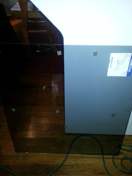

It was ice cold in my garage and I had been storing my monitor out there temporarily while I worked on the Cab.  Once I got the laminate applied I was in a hurry to button things back up and get the components out of the garage and I got in a hurry.
When putting back in the bezel glass I didn't have it set properly, and that coupled with the CP being slightly bent caused an eruption of broken glass.  Thankfully noting was damaged outside of the glass.  I didn't take a picture but it was UGLY and I said many swears.
Thankfully Nep has this same cabinet, and was ever so kind to provide the dimensions of my now devastated bezel glass.  I owe you a beer bro if you're watching.  :cheers:
I was able to source some replacement glass locally for about 27 bucks.
Mounted in the cabinet:
I debated on weather or not to show this, because I still have a lot of work to do, but I did want to give a little mock up to see what things will look like, and I of course have been wanting to play through Raiden II so here's the current mock up.
The button location will change, and the Strikers Marquee is obviously a place holder.  I'm trying to finalize my marquee art so I can order one of those translites that stpcore is offering but I've decided to redo the space portion and lose the Macross jet.  After setting Macross Plus to easy mode, and playing through it in MAME I've decided it's a quarter muncher and so ridiculously hard it's barely fun.  I really want the art to have nods to specific games but not have the plane pictured be easily identifiable as "this" ship from "that" game.  Enough talk here's what she looks like.
