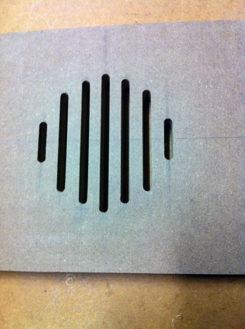

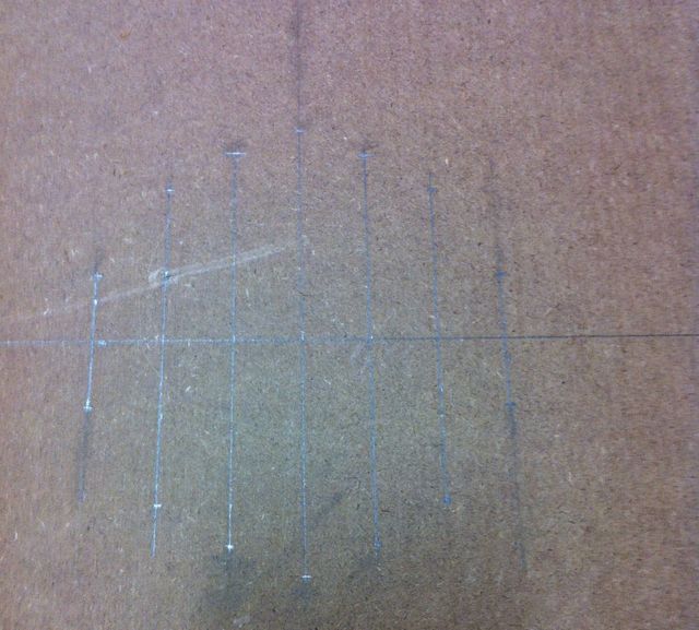

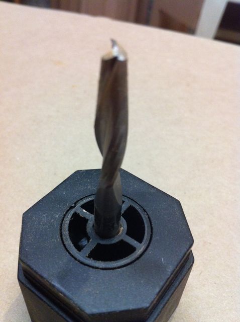

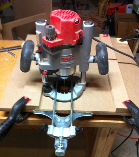

Time for the front speaker panel. This is probably one of the most distinct features of a Nintendo cabinet, a one of the things I wasn't really looking forward to doing. There are a number of ways that one could go about making the cutouts, the easiest probably being to drill holes at the ends and then cut the straights with a jigsaw. Very doable this way, but in my quest to avoid as much sanding as possible, I decided to use the plunge router.
First draw out the dimensions onto the MDF panel. Just need the centerlines and stop marks on both ends (sorry, crappy pic).
The router needs a spiral upcut bit, this one is 1/4" diameter - the same width as the cutouts.
Set-up the plunge router for the first cut. The silver guide attached to the router references the straight edge of the board to keep the cut nice and straight. The wood strips clamped to either end keep the router from going beyond the correct length for the cut-out. The router bit is lowered an additional 1/8" per pass until the cut goes all the way through the board.
Need to reposition the router edge guide and stop blocks for each of the 7 cuts. It takes a bit of doing, but the finished result looked great!
Finally attached the speaker panel to the cabinet with some yellow glue and screws. Finally starting to look like something!

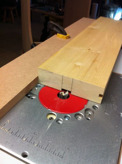

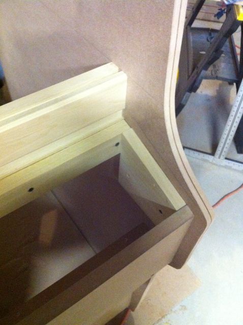

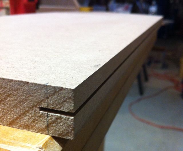

Next, on to the piece that holds the bottom of the bezel and contacts the control panel. Needed some material that is thicker than 3/4" stock for this piece. Thought about laminating two pieces of MDF, but the edge surface would not be very smooth for painting. Could have used a 2x4 or 2x6 but might be susceptible to twisting or warping. Had some extra 1x6 poplar laying around so I decided to use that.

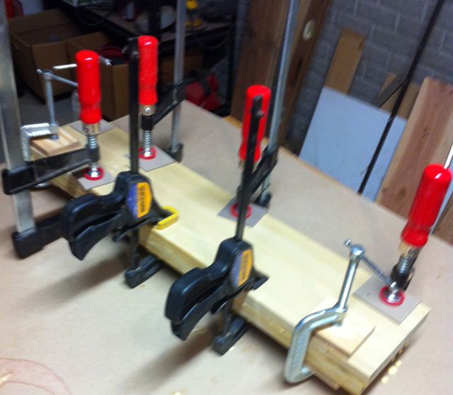

Cut two pieces to rough length and laminate with lots of yellow glue and clamps.
Allowed 24 hours for glue to dry, then ripped both sides on the table saw for a nice smooth edge and crosscut to length. Now on to the router table to cut the dado for the bezel. Used a 1/4" spiral router bit, made multiple passes until it reached a depth of 1/4". The groove needs to be 5/16", so had to offset the fence a bit and take an extra pass to get the required width.

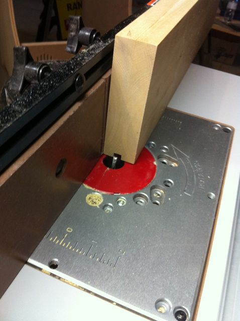

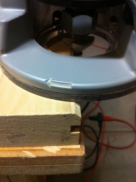

Decided to cut a slot for the control panel, which contacts this piece. This is not really necessary, but I thought that it would look better if the CP slides into a recess for a nice clean fit. Back to the router table, this time using a 3/4" mortising bit. The fence on my router table would not slide back far enough to accommodate the position I needed, so I just clamped a straight-edged board to use as a fence.
Decided to knock off a bit of the front edge, so used the router with a 45 degree chamfer bit. An original DK cabinet does not have this, but thought it would look better.

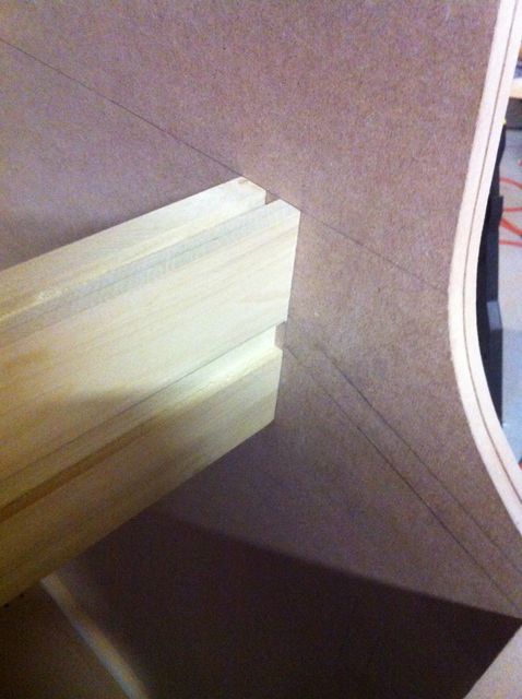

Position the piece in the cabinet, and attach with some dry wall screws through the side panels.

It could be me Paul but the control panel retainer looks to be sitting too high.  Take your mockup bezel and make sure it fits.  But like I said it could be me.  My iPhone tends to bend perspective when I take pictures in low lights.

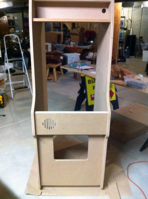

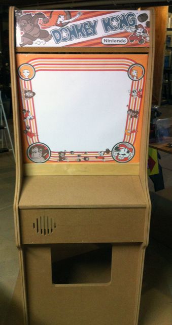

The control panel held in place by some latches on the underside. These latches will attach at the sides. Wanted to make a surface with better holding strength that the MDF side panels, so once again used some scrap 1x6 poplar. Cut an angle on the chop saw to match the slope of the control panel and attached to cabinet sides with some yellow glue and drywall screws. Also added an additional piece below the CP slot to provide some additional contact area for some extra support. Ripped a bevel to to once again match the angle of the CP and attached with drywall screws and yellow glue.
Next cut the piece of MDF for the control panel. Need to cut a bevel on the edge that slides into the groove, did that on the table saw. Also need to cut a slot for the T-molding on the opposite side. Should have done this when I routed the T-slots on the cabinet sides, but forgot about this piece.
Current state of cabinet, with cardboard mockup bezel & marquee.

Re: Donkey Kong scratch build, my first cabinet!
« Reply #89 on: February 27, 2014, 10:18:58 am »
Good eye, the jackobud plans I'm using are off a bit. But I cut a mockup bezel and marquee (on backorder from mikesarcade.com) to known dimensions to be certain everything fits in relationship to these two pieces. So while it's a bit off, it's close enough for me!  :)
