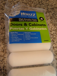

Painting satin black. I guess I'm up for the same fate as red?  6 coats it took for red??!
I traditionally use high density foam but today when I went to pick up the paint the guy said no!!  Use a regular roller fora smooth finish. Huh?
What did you use?

I used small foam rollers meant for cabinets and doors.  Got them at Lowes.

One other note (if you are curious).  The reason you should not use a normal roller is because sometimes the fibers from the roller stick to the paint and dry into them.  They are a pain to sand out.  Foam is the way to go.
