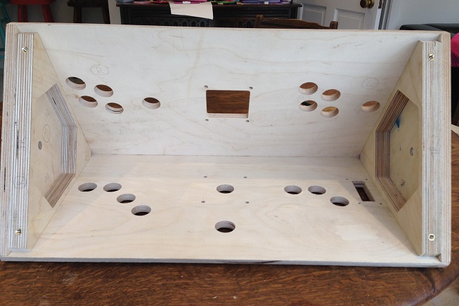

And here she is with the controls in place.  They feel good, plenty of space for arms etc. :)

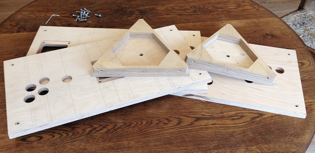

« Reply #91 on: February 22, 2015, 10:40:53 am »

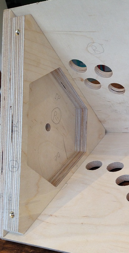

Had another session last night and Ed and I finally managed to get the panels assembled!  She rotates! :D
Firstly, the triangle end panels needed to be glued to their mounting pieces.  I used some extra strong PVA adhesive and clamped with 3 screws, one in each corner.

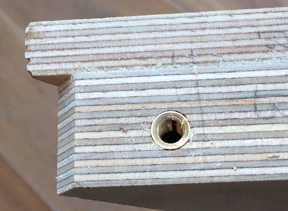

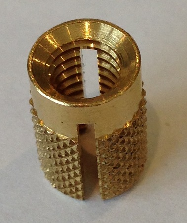

As I'm going to be installing/uninstalling panels a lot during construction, I went for a bolt and insert setup.
The insert is an M6 nickel plated brass one: -

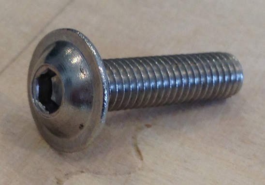

The bolts I used are M6 A2 Stainless Steel Flanged Button Head Bolts (Hex Socket Allen Screws).  These are 25mm in length, which works nicely as it has 12mm ply to go through for the panel, and the brass insert is about 13mm deep.
I went for the flanged ones because I thought they looked nice - but having second thoughts now, perhaps a plain domed one would look nicer.
Installing the inserts was a bit scary... it's one of those "you only get one chance" type things.  Luckily they all went in fine and flush no problems...

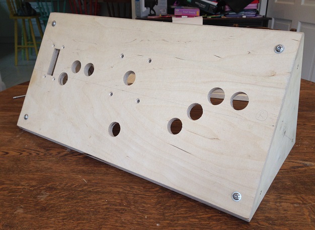

So now we have all the bits ready to assemble! :)
First panel in...
Second panel in...
I'm really chuffed with how it's turned out.  It's quite heavy, and very sturdy, and it's lovely and uniformly proportional (thanks mainly to the CNC machine!). A single panel only takes seconds to take off :).The stainless steel shaft fits beautifully and the free-rotation is great to finally see.
I have a bit of tweaking to the end-plate mounting pieces as some of the controls won't fit as they currently are, but it's minor changes so that's the next job.  Looking forward to wiring up (once artwork installed), doing some welding for the steel frame, and putting some pulleys and a motor on it. :)
Naa, you can (carefully) fill with little wood glue and a dowel rod, then re-drill and try again.   But I totally agree otherwise - its one of those things that you really don't want to try and fix if it goes bad.   :cheers:

OK... steel frame assembly time!
The top of the steel sides needed cutting at a 5 degree angle, ready for another steel mount to be welded onto the top of it for the filler panels either side of the rotating unit.  We used a nice protractor contraption for this. :)  The CP when in place in the cab will be angled at 10 degrees towards the player. The steel frame itself I am mounting at 15 degrees (so the bottom of the frame sits behind the front panel / coin door).  This meant that we actually need to mount the brackets for the filler panels at 5 degrees *away from the player*.  We did this by taking the centre of the bar as the origin of the slant, but after we cut it we realised that this was wrong... doing it this way means we've actually moved the origin of the rotating unit.  We should have rotated the CP unit 5 degrees in place, then scribed and cut from there...   It wasn't a catastrophe though, it means we've actually cut bar at the correct angle but 0.3mm lower than it should be....
Here you can see all the bits cut and ready for welding (the box tubing on the left we'd already welded a couple of evenings before). The original plan was to have one section of box tubing, but we decided on 2 for strength and to aid in dimensional conformity.  The shiny marks you see are where we angle grided in preparation for welding...
Bits you can see are:
  • box tubing for bottom frame, 1 inch square x 2 welded together
  • 2 small brackets to weld onto the sides for connecting the box tubing to
  • 2 filler mounts for welding on the top of the sides at the 5 degree angle
  • the 2 sides with holes drilled for the shaft, pillow block bearings, and mounting holes
Getting the bottom brackets aligned with the box tubing was tricky, but once we got the bracket in place squarely we were able to drill the bolt holes in the box tubing accurately...
Here's one of the bottom corners assembled, after welding the bracket to the side panel (using some very handy magnet clamps to get it perfectly square...
And here's the top filler panel mount, welded on at 5 degrees.  12mm ply filler panel will sit on top of this each side of the rotating CP unit.
And here she is, fully assembled and ready for artwork, controls, and all the complicated stuffs :)

It's pretty tight inside the rotating unit, so we had to make some clearance cuts... good job for the CNC machine!
The top triforce (LHS) needed 5mm clearance for the defender joystick...
...and the bottom one (RHS) needed 20mm for player 2's buttons on the 2P panel...
Guess who forgot to leave clearance for the mounting bolts for one of the joysticks!?  :banghead:
So I got that far, I figured I'd finish assembling all the controls to make sure they all fit...
