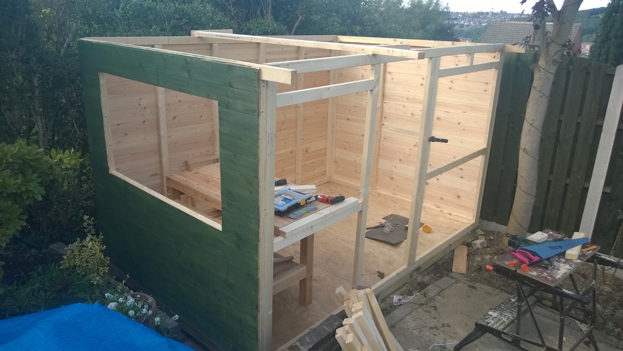

Ok, some progress.
I debated keeping the 'too big' base as is, and putting some damp proof membrane onto it, but in the end decided to correct it. It took me from early morning to 3pm to move the walls, remove the floor, cut the joists, re-level and put everything back. I'm glad I did it though, it would have nagged at me every time I saw it.
We're in the middle of an unusually long dry spell for September here in the UK, so the lack of a roof hasn't been an issue. Unfortunately, I'm back at work after some hols, and shed work is limited to an hour or so a day.
'Moving in' was a milestone. It was going to be easier to get the workbench through the wall space rather than the door, so I did that before continuing:
And I've since started the roof framing (so I could get a tarp up there properly in case of rain) and continued with the final wall.
When the walls and roof are done, I can work inside the shed at my own pace, finishing the windows and doors. Hopefully I'll be able to crack on with that this weekend.

Looking good, nice bench too.  I am still wondering how you are attaching the frame together though.  Are you using 5" screws and screwing it together, or are you toenailing in some screws (or pocket holes)?  (That is another reason to turn all the studs, you can nail or screw them together with standard 2.5" or 3" screws.)
And did you add more framing to that front wall or just plank over what you show in the pic?
I'm starting to get that now...  ;D I'm using long screws and toe-nailing shorter ones where appropriate (I don't like screwing into end-grain)
Just discovered major cock-up #2. I was putting the tongue and groove planks on the back wall and realised that the wall was upside down! It wouldn't matter - but rain will pool in the groove that way.  I'm going to have to turn it around  :banghead:. At least I didn't put the roof on yet.

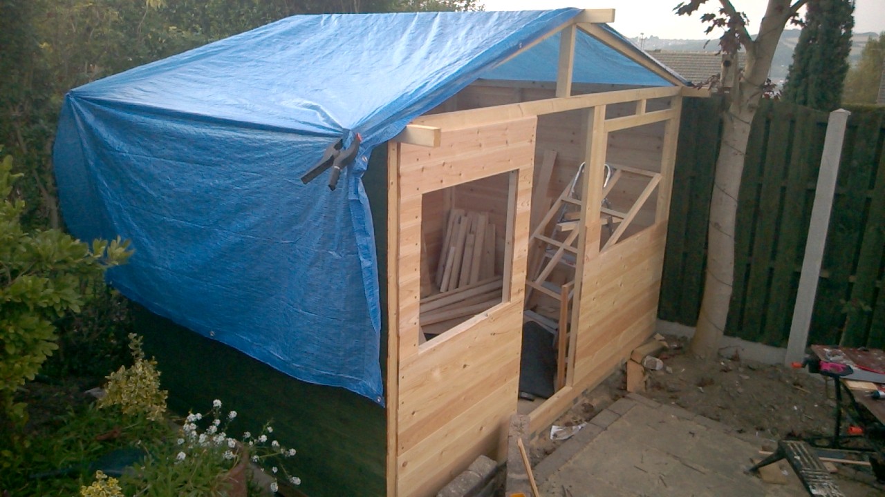

Back wall got flipped back over. It wasn't as hard as I thought it might be thankfully.
So I finished framing the roof out
And then got the roof on top. I have left the top pieces loose for now - I reckon it will help me when I nail the roof felt on - access is tricky as I'm so close to the fence and hedge. It's a tradeoff of having extra floor space... I figured I wont be putting the roof felt on very often, so I can put up with the hassle.
The tarp went back on overnight last night, but this evening I got the felt roofing on - without nails for now. Better than the plastic sheeting, and as long as its not windy (not forecast to be) I'm all nice and watertight now

  That doesn't look strong enough (IMO) to hold a garden roof, It would more than likely sag and water damage over time.... Other than that looks like a fun project. ;D

I agree with that.  As it is the weight of wet sod is going to eventually be an issue.

2x4 roof would be OK if they were 16 inches on center.. but I would be afraid to be up there putting felt or shingles up personally.  As it is, it should support the weight of the plywood, felt, shingles, and maybe even a little snow with no problem, but there is no doubt in my mind that it would start to sag quickly if any real weight was put on it.  asphalt shingles alone are very heavy.
My shed and my "tree fort" (sans tree) are both 2x4 roofs and I have been on both and it is barely squishy, but that is with one every 16 inches.

Yeah, that's the thing with sod.  When it is wet it gets HEAVY.  You have to pretty much plan for it to be 75% water at times.  If you're looking at 5" of soil you'd have to calculate for 3"+ of water weight for the whole surface area + the weight of the produce and soil.

Well, it was always going to be a possible extra in the future. If I decide to go that way, I'll look into more reinforcement I guess. Thanks for the tips/advice.
