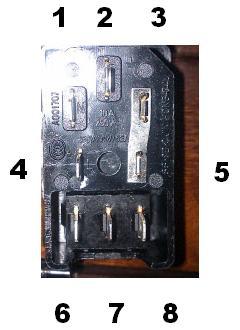

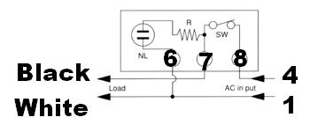

here's a wiring diagram
The only problems with the diagram are:
1. It bypasses the fuse -- change the lower connection of the diagonal black line from the center left (fuse input) to center right (fuse output)
2. It appears to show a simple DPST switch (non-illuminated).
For an illuminated switch with a neon lamp, here are a diagram and schematic that Rablack97 used for his bartop.
- 1, 2, and 3 are the power inputs
- 4 and 5 are the fuse connections
- 6, 7, and 8 are the switch leads
NL is the neon lamp in the switch.  Pin 2 is ground. (not shown)
will a momentary switch be the best way to go for a PC power button?
That's what PCs use. (unless you're using an AT power supply and 20 year old computer)
So would this be the correct way to install? I've got this same switch combo and am trying to figure it out.
  • Posts: 9742
  • Last login:Yesterday at 05:53:30 am
Re: What is the best method to supply power to cab?
« Reply #21 on: December 10, 2013, 02:27:50 pm »
If the switch is a DPST (Double Pole Single Throw) like this, then yes.
I'd give you a definite answer, but my multimeter doesn't work on .JPGs.   :lol
You may need to swap the left side wires for the right side wires and/or swap the top pair of wires/bottom pair of wires. (not sure which side the lamp/LED is on or if it is polarized)
« Last Edit: December 10, 2013, 02:36:27 pm by PL1 »

To test if it is a DPST switch, use this procedure with *no power connected*. (Unless you want to buy a new meter.  :lol)
If you have a multimeter, set it to ohms/continuity and connect the leads to the top right and top left switch terminals.
The meter should show less than 2 ohms (ohms mode) or beep (continuity mode) when the switch is set to on and show between 10 Meg ohms (10 million ohms) and infinite ohms (ohms mode) or not beep (continuity mode) when the switch is set to off.
Repeat with the lower pair of terminals.
If this post doesn't make sense, there are probably some good "how to" multimeter videos on youtube.   :dunno
Just digging up this old thread. I've already been searching but not sure if I am doing this right or not.  I didn't get the lighted switch that everyone seems to be getting. My switch is a douple post single throw (DPST).
Currently I have plans to wire my cab as the diagram shows. It' seems to match the pictures that I've read.  HOWEVER, my problem is with my multi-meter test. I haven't learned enough about how to use a multi-meter except for continuity testing. My problem is when I test the continuity.
When the switch is off none of the tabs are connected as shown by the multi-meter. When I turn it on, tabs A (brass) and C (silver) are connected through the continuity test. Same with tabs B (brass) and D (silver).
From the pictures that I've seen the brass tabs are probably the neutral wires and the silver should be hot. However I am not sure. I thought, with the switch on, I should get a beep when testing tabs A & B as well as tabs C & D. In my testing A connected to C and not B so basically the power from the live wire returns back to the source?
Help!

So you're saying that with your switch:
 - With the switch set to "off", the meter doesn't beep (no continuity) when you connect the leads to A and C or B and D.
 - With the switch set to "on", the meter beeps (continuity) when you connect the leads to A and C or B and D.
BTW, brass is usually hot (black) and silver is usually neutral (white).

Hey PL1,
That is exactly right. Which from what I've read here is backwards. A beeps when connected to C and B beeps connected to D. The switch still works like a switch. It's just different from what I've seen here. So I got to thinking can I just wire terminals A & B to the IEC plug and then C & D to the cab.
I'll just have A be the black (live wire) or should C be the black (live wire). Does it really matter as long as the wires match up on C & D?

  • Posts: 9742
« Reply #30 on: April 23, 2015, 03:43:05 pm »
Different manufacturers use different physical layouts/orientations -- that's why you should always verify electrical connections before hooking them up.
Continuity indicates a direct connection.
Since the meter beeps (continuity) when you connect the leads to A and C on your switch, connect the black wires to A and C and the white wires to B and D. (Or white on A and C and black on B and D  ;D)
As long as you have matching wire colors on the tabs that connect to each other, you'll be fine. (hot to hot, neutral to neutral)
Since you don't have a lamp in your switch, it doesn't matter if you use A or C for the input -- it's not polarized.
Use an outlet tester to avoid the problems that PBJ and Haruman mentioned.   :cheers:
