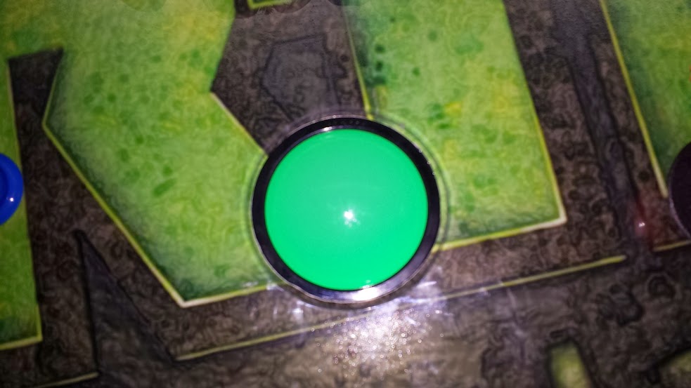

it has been a while since i updated this, but i finally got around to finishing this thing up. I have a little work to do cleaning up some of the internal wiring in the computer area, and i'd like to do something different with the cables running to the TV...but other than that, it is done.  My awesome wife got me a new trackball for Christmas from GroovyGameGear.  this thing is so much nicer than the old wico trackball i had.  it looks really nice when lit up, and rolls so smoothly...you can't beat a happ trackball.
here it is installed in the panel...using the mounting plate made it really easy to swap it out.
it is hard to take a good picture and have the colored light show up properly, it is a very vivid green color.
here is a shot of the completed unit, showing my custom mala layout.
here is a closer pic of the mala layout.
and last but not least, my 3 oldest kids playing some TMNT...
i've really had alot of fun with this project....i really want to clean up my other cabinet now..new paint, new t-molding, new artwork....but that will have to wait until spring.

I got home from work tonight to find that a package arrived... PBJ hooked me up with a set of awesome TMNT dust washers!!! :notworthy:
They were designed for JLFs but they fit the JLW-TM-8 as well.  they are slightly smaller in diameter than the original sanwa washers, and a little thicker.  I think they look great.
other than the conduit running between the TV and the cabinet, i think it is done.

« Reply #75 on: April 09, 2014, 10:02:11 am »
Those came out looking pretty good.  I was tempted to take a drill bit to them, but the plastic seemed brittle.  If I had only needed 2 of the 4, I would have gone for it but I was doubtful of my abilities to get four.
Now we wait to see if my promised replacements ever show up....
