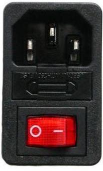

So for my current build, I wanted to buy something like this pictured below and mount it to the back so I could have a removable power cord.
Then I would like to connect a power strip to that on the inside, which has the usual 3 prong power outlet plug. I have been looking for adapters for that but i cant seem to find any Female-to-Female ones, which I think are IEC C14 Female to NEMA 5 Female. This is the closest thing I could find here: http://www.cyberguys.com/product-details/?productid=32922
Has anyone else done this before or have any advice on what I should be looking for or whether I can use the adapter above to make this work? Thanks
Re: Power connector question
« Reply #1 on: May 28, 2013, 02:51:23 pm »
Cut the plug off of a power strip, and solder the wires to the back of that connector.
+1 -- and if you don't have a solder iron you can just strip the 3 wires push each through the holes in the connector and wrap them tightly so they hold in place and then tape them in place ( or use a small piece of shrink wrap tubing on each end and shrink into place after wrapping the wire into place )
Or if you have an old unused PSU sitting around you can pull the connector out of it ( with the old wires already soldered in place ) and then splice those to the powerstrip cord after cutting the connector off of it !
  • Posts: 9734
  • Last login:Today at 03:14:43 pm
« Reply #4 on: May 28, 2013, 03:47:02 pm »
I'd STRONGLY recommend against this.
Any power connection needs to have a strong mechanical connection as well as the electrical connection.
If the mechanical connection eventually becomes a bit loose, it can become a high-resistance joint and cause an electrical fire.
If you don't use solder, you might be able to use .25" Quick Disconnects.

I use these:
Easy to mount, have built in fuse and lighted switch.  I get them from here:
http://www.amazon.com/Amico-IEC320-Module-Switch-Socket/dp/B0050HH70E

I use these:
This is perfect. Thanks for all the information everyone.

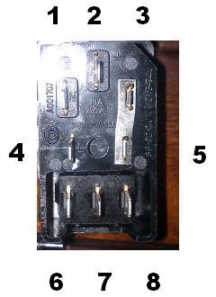

I'm not having any luck wiring this.  Here are some pics.  Is it possible to put the fuse in wrong?
  • Posts: 9734
« Reply #25 on: December 07, 2013, 10:19:31 am »
As long as the fuse is the right physical size/making solid contact at both ends/not already blown, it should be fine -- you can't put it in backwards.

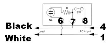

Looks like you have one of these illuminated switches with a neon lamp . . .
. . . that hooks up like this.  NL is the neon lamp in the switch.  Pin 2 is ground (not shown) which looks properly connected in your pics above.
EDIT: On second glance, it looks like you have a different switch module. (The rest of the unit is pretty much standard, but different companies use different switches.)
Is the switch illuminated or plain?
Can you test with a multimeter to see what terminals are connected when the switch is in the off and on positions? (with no power applied and the wires removed)
If you don't mind I'd also like to also include pics/diagram (like above) of your power switch in the wiki for others to follow once we figure it out.   :cheers:

« Reply #26 on: December 07, 2013, 12:11:53 pm »
It's the Amico IEC320 mentioned earlier in the thread.  I wired it like I saw it pictured in the photo someone posted.  Here's a pic from the other side of the inlet.  It is illuminated.
I don't have a multimeter.  Just a cheap voltage tester that lights up if there's voltage.  I'm getting voltage on all the terminals either way the switch is turned.
You can use the photos.  Please excuse my gnarled hackmanship on the hole in the wood.
