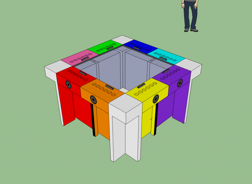

V3.5(May 28, 2013)
Changes to the Corners they've become more of attachment pieces for the entire table and firm roots to the ground as well as a place to hold wheels. For the rear projection ill be using Acrylic and transparent holographic rear projection film and thats that. The cooling system will be on one side (like suggested) along with the PC and the projector. (Couldnt show the fans because they're not in. Im dumb sry!
I need to go back through this and make it look neater....But then again this is just ideas i should make it neat when i actually build it.
V4 NEW!
Idk what i think about this. Thoughts?....
The design is based off the Tank 8 machine i saw a long time ago and i just went crazy with the idea.
A programming buddy of mine saw me working on the first one and got so excited about it that he wanted to work on a big gigantic one and make some games to put on it. So after a lot of crazy ideas i came up with this giant box machine. Its a little over the top for a second go at making arcade machines but hey gotta dream big right?
Tell me what yal think!

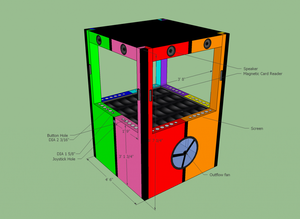

3.Are the button holes the right size? They look a bit big...(Using buttons and joysticks from ultimarc, love them =D)
Button holes should be 1.125" (1-1/8") for standard arcade buttons.
The joystick holes should be the same or smaller, depending on what type of stick you use.
If you do the rear projection thing, you could have an intake fan on the bottom of the cab and build some ducting to guide the air across the projector and computer, with a second fan at the exhaust vent.
Ah my button holes are off by a bit ill have to change them! That's a way better idea then just running air through the box randomly I could actually try and get cold air from the bottom, run the ducts to cool certain spots and then push the hot air out the top maybe.
Considering that the top is all control panel and screen, you may want to use a 45-degree mirror bottom/center so you can put the projector horizontal and centered at the bottom of one side.
This will give you a longer "throw" for the projector (=larger image) and shorter ducting for the vent if you run it out the side between players and just a few inches above the projector.
Griffindodd (now posting as Maximus) plans to use something similar for projected sideart on his Alchemy Pinball build -- the good news is that you don't need to split the reflection to display on two screens.   ;D
I also forgot to point out something else earlier -- EIGHT PLAYERS??!!??  :dizzy:
Please refer to numerous threads concerning building 4-player control panels and double (or square?) the concerns expressed.
Having players on all sides also forces you to put this in the center of the room.
The other thing that I notice is that it looks like the only reason for the canopy is to mount speakers and mag card readers.
Why not just have the mag readers on the CP/leg/front and put the speakers firing out the front panel similar to Nintendo-type cabs?
Photo from Superfrog's build used because it shows the speaker vents beautifully.  :cheers:

How are you going to get this into the room, not to mention the centre of one? And my second concern is getting a screen that's square and that large in this day and age. I'm all for big and crazy, but you've got to be practical about it as well. Considering the price of real estate these days you may want to reconsider the dimensions a little bit.
I wish you luck building it though! A bit ambitious but then aren't we all? Also looking forward to your homebrew games. I'm working on two myself, but haven't done any official announcements yet. I just thought we needed some new "old style" arcade games.
shponglefan
  • Posts: 1600
Re: Custom CAB with Homemade Games
« Reply #9 on: May 25, 2013, 12:40:00 pm »
Wow, this is certainly an ambitious project!  I wish you luck in undertaking this!
The one thing I was wondering about is the physical size of the unit.  If it's over 4 feet square, it's not going to fit through any standard doorway.  So would it be built/assembled in the location it's going to be used in?  Or built in seperate components that can be easily disassembled/reassembled for transport?
AGarv
  • Posts: 225
« Reply #10 on: May 25, 2013, 12:42:42 pm »
It is an interesting start, but the ergonomics probably need some work.  The vertical sides are going to make it hard to sit at, maybe even stand at.  If people are going to be leaning in over the screen, why are the speakers so high above and facing away?  I don't really see the point to the canopy structure, unless you plan to have a second screen that people look up at.
It seems as though you could accomplish this all with a pedestal type set; sort an inverted pyramid design with the screen on top.  Really, even a simple square cocktail design would work.

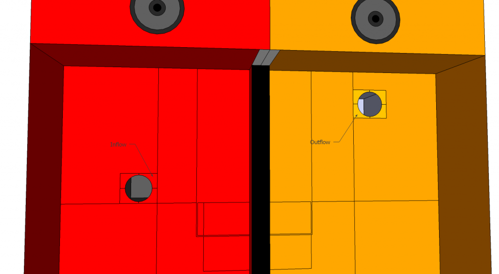

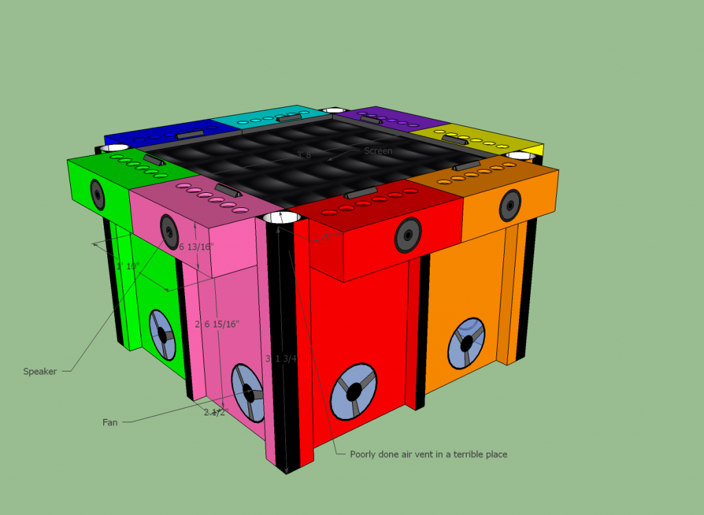

« Reply #12 on: May 25, 2013, 07:53:11 pm »
Based on what everyone said i modified the design take a look guys!
BLARGHHHHHHHHHHHHHHHHHHHHHHHHHHHHHHHHHHHHHHHHHHH
« Reply #13 on: May 25, 2013, 08:06:38 pm »
Duct the outflow so it vents downward from the bottom of the CP on each unit.  Probably need to use an 80mm fan to facilitate the movement.  Turn the "poorly done airvent in terrible place" into cup holder and cut it off about 6 inches down from the top so you don't have that big weird shape in every corner, then just use some quarter round in the CP.  Build each one as a separate pedestal and have them connect internally by CP latches.  The screen is on it's own frame (collapsible) and lays on the top once you hook them all together.  Use an assload of molex connectors to wire it all onto the blue unit which holds the CP.  Why the blue one?  Because it's Saturday.  Round the outside corner of all the CPs so it forms a large circle or at least a rounded square, it will look better.  Go buy some gold leaf and do some applique around the edges.  Google the Sagrada Familia and try to make this monster look like that, only retro.

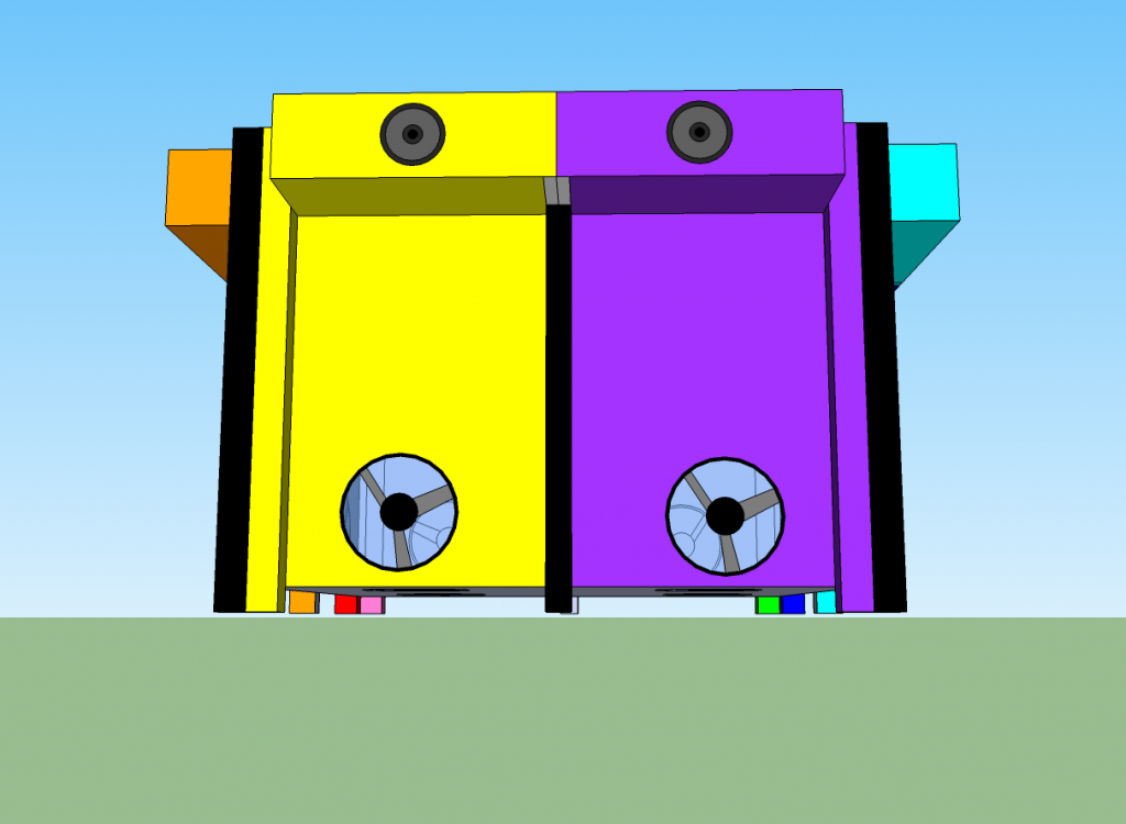

If i understand you right this is wicked creepy I've been drawing half of that already, and i have an 80mm fan that i was looking at in a tab 0.0..Legit did you just probe me?
I was thinking each color panel is modular, everything is in the panel all it needs is to be connected to the center and the whole middle is its own piece and compresses down because the core probably wont be that tall. I was going to use an idea i saw (and i cant remember where or id link) where the guy used rj45 cables to hotswap parts and i was just going to use that to connect up all the cp stuff to the core parts in the middle. I've been sitting here trying to figure out a way to connect it all together securely though cp latches are perfect. Wouldnt it be eaiser to just wire everything to the center so its neater instead of just blue? I didnt even think about the edges i was so focused on just making the concepts work.  I just dont know how ill do all that with the air duct system and where itll go when the whole machine comes apart and if the rear projection idea will fit in with this too.
Oh and wheels on the bottom. EDIT Somehow..
The cup holder though, that's sweet those are totally going to be cup holders. ;D
Googled Sagrada Familia nothing useful came up link me? D=
EDIT: Ok so basically i propped up the machine 2 inches of the ground (It probably needed to be anyway) and vented it all down but with the inflow so low wouldnt the fans get caught up in a cycle of hot air. They're so close together.
The little black things at the bottom are the outflow the sides are in.

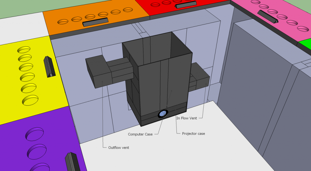

« Reply #15 on: May 25, 2013, 09:43:48 pm »
Why do you have huge intake fans at the front/bottom of every player?
You only need to cool the computer and the projector.
If you put the computer (tan) and the projector (violet) in one side, build the cooling intakes on the bottom and vents into the side since heat rises.
The projector can vent between players and the computer can vent at the corner.
If players don't like the exhaust, they can choose one of the 6 spots on the other sides.   ;D
If you put the computer (tan) and the projector (violet) in one side, you can build all needed cooling intakes and vents into that side.
Two panel latches (black arrows) hold each side to the next.
The support base (white) for the mirror (gray) is locked in to three sides using four more panel latches (black arrows with red stripe).
The 45-degree mirror (gray) pivots on the heavy line and a turnbuckle on the left side (black circle) allows you to adjust the angle -- once the projector and mirror are properly aligned, the yellow side can be connected.
You will probably want to have the wiring plug-in receptacles in the green side.
If you move the cab, the connecting cables from the other three sides can unplug from the green side.
Consider using parallel port cables instead of RJ-45's since each player will need:
8 - 2 joysticks
3 - 3 buttons
1 - Start (?)
12 * 2 players per side = 24 inputs
Add one ground wire and you have 25 conductors.
Also how do the mag strip readers figure into the plan?

Howdy guys new model addition. Im calling it V4. Thoughts please!
  • Posts: 9717
  • Last login:Yesterday at 11:56:03 pm
« Reply #36 on: May 30, 2013, 11:42:02 pm »
Boxy right angles WILL cause airflow problems.
Long duct lengths decrease airflow efficiency.
Current exhaust placement is centered on the orange player instead of between the orange and red players. (See pic)
Separate cooling paths for projector and computer will probably be shorter and more efficient.
Computer can be placed closer to the corner and vented at the corner.
Protip: Specific placement of projector intake and exhaust vents depends on the actual projector model used and where it will be mounted.  It's a waste of time trying to plan for cooling without knowing exactly what projector you will be using and building the 3-D mockup.  Once you have built the mockup, any necessary design changes will be easier to identify.
You are planning to build each corner as a fixed part of one of the adjoining sides -- red + orange + white = one solid assembly, yellow + purple + white = one solid assembly, etc., right? (Sketchup makes it look like 12 assemblies - 8 player assemblies + 4 corner assemblies)
Yeah i know i just hadn't found the round edges plugin yet i found it a bit after i posted that. I was talking to a family friend who works with projectors and saw the design he said the same thing about the cooling that i should wait because he might have a projector for me. I will be splitting the cooling paths though that's a better idea doh so simple wish id thought of it.  :embarassed: And why did i put exhaust between orange players legs that just irritating..I would like hate that. =(
As for the computer and the current design i forgot to include that i wanted to deviate from the picture a bit. I wanted to do each panel as a separate part. It shouldn't really change the picture too much. The Projector does need to be in that same general area though but yeah i really just need more information on what I'm working with which i should get sometime this week. I should still be able to cool from the corner but i was going to use the corner pieces as just support besides that. I also wanted to switch to using DB-25 or HD15 Cables for each panel, 25 is just in case i need to expand but probably just gonna use 15. The problem i run into is that i wanted the computers case and the projector to be detachable and i don't know exactly how to do that.
I didn't really see the benefit of having 4 giant parts if its difficult to get them through doors if its 8 parts the panels are only a foot 10 inches. The Other parts are kinda gigantic.
Having the computer case detachable for transport is very easy with pipe strapping, but not absolutely necessary.
You might want a color coded/labeled patch panel to connect the DB-25/HD-15 cables from the other 6 players to your encoders.
For the projector, drill/route ~1/4" divots for the feet -- gravity does the rest until you want to take it apart for transport.
