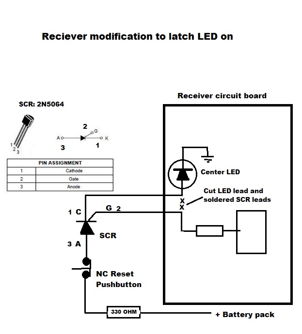

So i took the receiver apart and added an scr in the center led. I also added a Normally Closed button mounted to the top to reset the light when I see that I do have mail.
It works real well, and the mailbox shields from false alarms from wind, rain, snow, whatever.

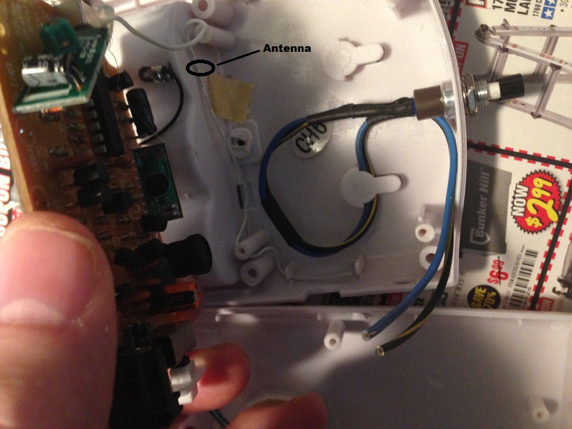

First here is the transmitter, showing the antenna coming out the back and the magnet holder (the magnet stayed stuck to the back of the mailbox when I pulled this out for the pic.)

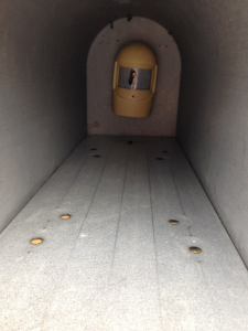

Here is the transmitter stuck to the inside back of the box:

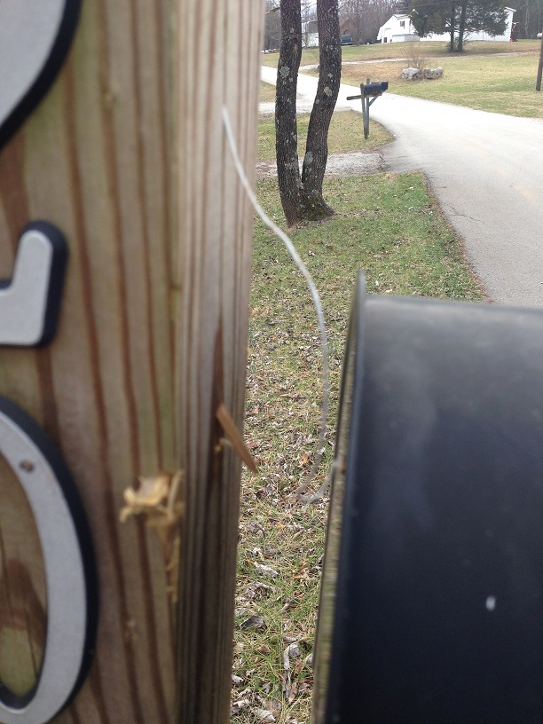

And the antenna coming through the back of the mailbox:

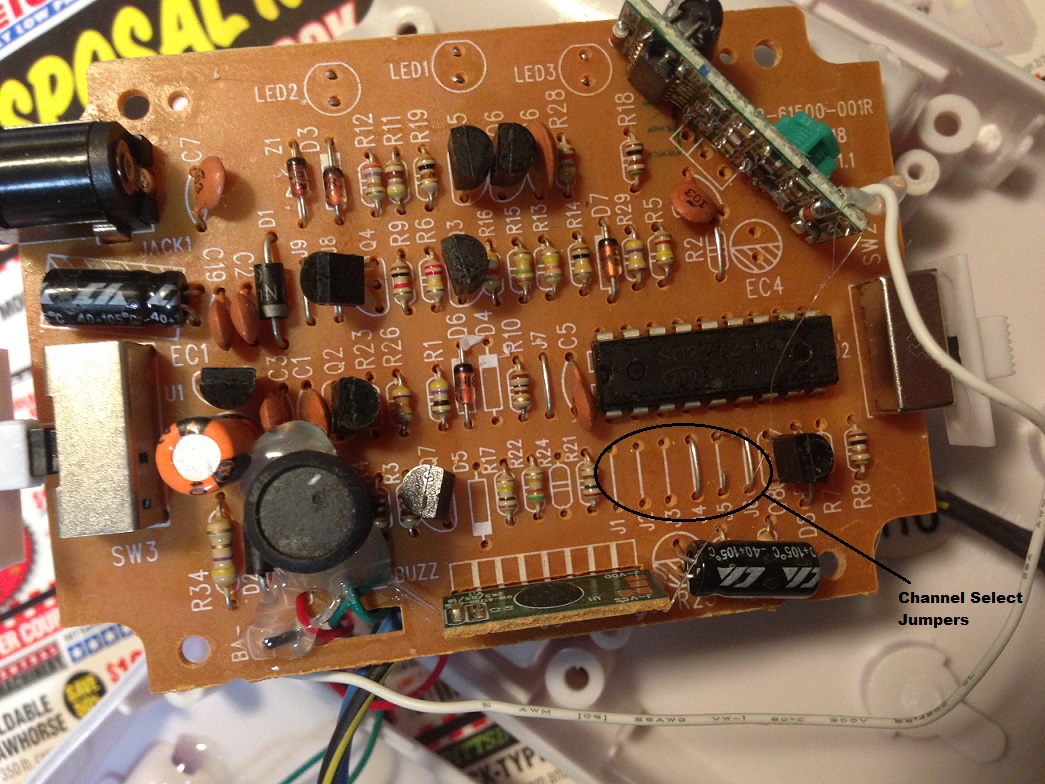

Here is the receiver board removed from the enclosure. I marked the jumpers that are used to set the channel. The transmitter has the same jumper layout, so you can have more
than one of these pairs just by setting the channel jumpers differently on both transmitter and receiver. They both must match the same pattern:

I then soldered a 330 ohm resistor in one of the wires going to the reset switch, and the other end of the resistor to the POS (+) terminal on the battery compartment.

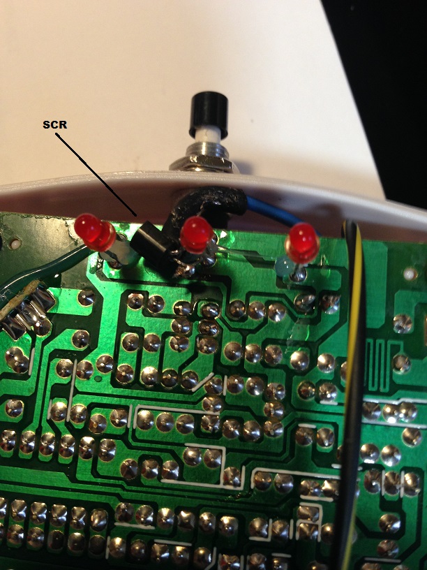

I then cut the POS side of the LED center wire and soldered an SCR into it. (Will attach schematic in a few).
The gate of the SCR soldered to the wire going into the board (was LED lead).
The cathode of the SCR soldered to the lead going to the LED.
The Anode of the SCR solders to the other wire of the reset switch.
Put enclosure halves back together,  installed C cells and tested. Works like a charm!

And here is the quickly drawn schematic:
