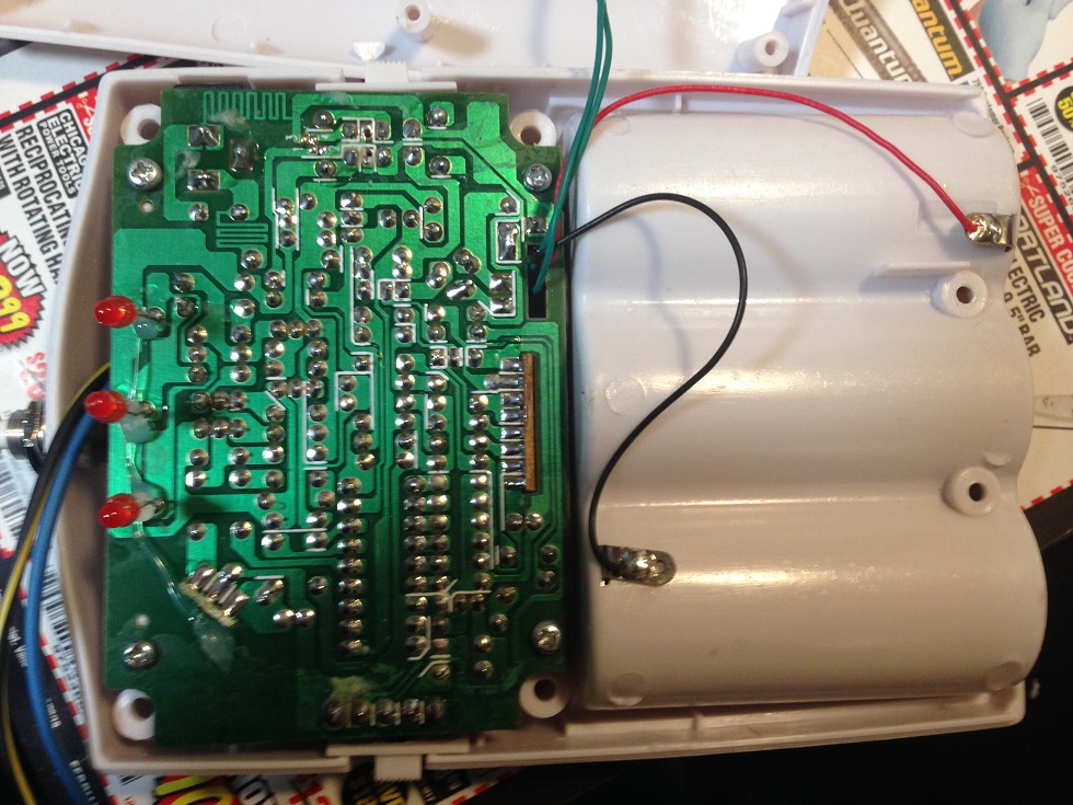

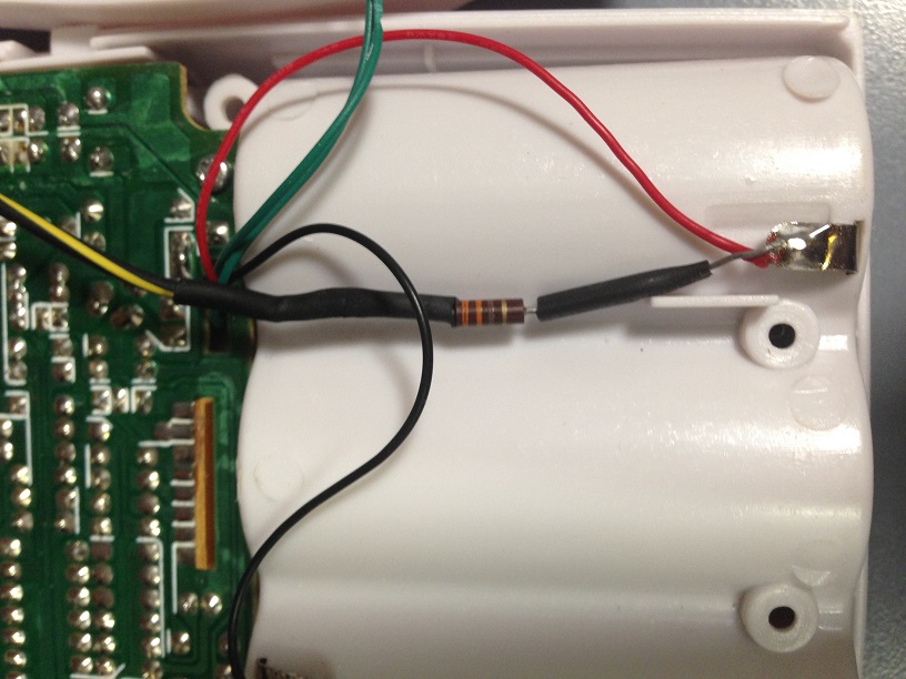

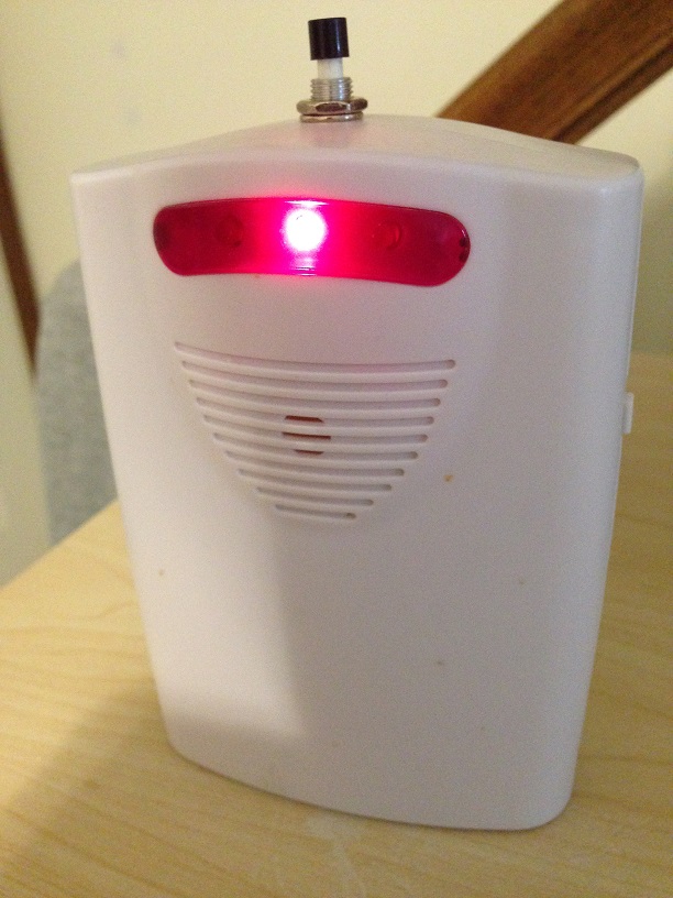

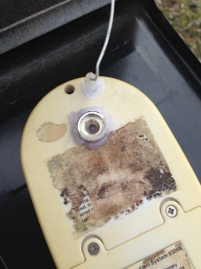

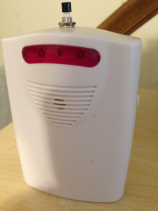

Here is a very handy circuit I made a few years ago. Actually it is a modified wireless doorbell. Using a cheap battery powered door bell, I made an extension to my current doorbell.
I needed it for upstairs because i had a hard time hearing the doorbell (which is downstairs) when I was upstairs working on my projects.
It would have been a nightmare to route a wire from the downstairs chime to an upstairs one.
I could have but you know a lazy man comes up with an easier way to do the job.
Its a pretty simple circuit and works very good, providing that you remember to change the batteries in the chime part.
I removed the small 12 volt battery from the button that came with the wireless door chime. I made a small circuit that rectifies, filters, and regulates the AC from the downstairs door bell solenoid.
Then I taped the button to always be on.
When someone pushes the outside button by the door, the downstairs door bell rings and the wireless button is energized, sending a signal upstairs and ringing that one too.
The zener I used to regulate the power is 8.1 volts, it is what I had in my junk box at the time. It really needs to be 12 volts. The 8.1 volts decreased the distance of the remote chime, but it was ok for where I placed it.
The diagram below really sucks, (I couldnt find my original, this is copied off my blog site), if anyone is really interested in doing this, I will re-draw it better.

First here is the transmitter, showing the antenna coming out the back and the magnet holder (the magnet stayed stuck to the back of the mailbox when I pulled this out for the pic.)

Switch mounted and circuit board put back in place. i ran the switch wires out so i can get to them. Notice the 3 C cell battery compartment.
I then soldered a 330 ohm resistor in one of the wires going to the reset switch, and the other end of the resistor to the POS (+) terminal on the battery compartment.
I then cut the POS side of the LED center wire and soldered an SCR into it. (Will attach schematic in a few).
The gate of the SCR soldered to the wire going into the board (was LED lead).
The cathode of the SCR soldered to the lead going to the LED.
The Anode of the SCR solders to the other wire of the reset switch.

Here is the receiver, standing by patiently for a new signal from the transmitter.
I walked out to the mailbox and opened the door, came back in and this is what I saw:
It's saying, "hey stupid, you got mail!"
Press of the button turns off the led.
