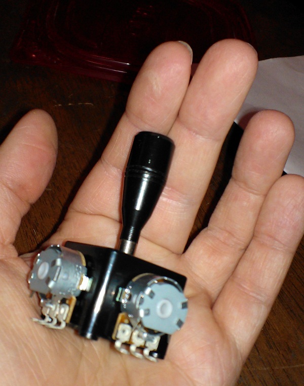

This started out with the idea that an analog joystick would be easy to hack into an xbox 360 controller as long as it had the same value pots as the original thumbstick (10k).  I tested this by hooking up an Alps 2D joysticks ordered off ebay.
It proves the concept, but has some play in it when centered and I'm not sure the xbox360 will have enough deadzone built in to account for it.
I tested the original xbox pots just to make sure that they had no deadzone built into them and they didn't, so it has to be on the software side.
This wouldn't be an issue for emulators since the deadzone can be adjusted, but this will be used on an xbox360 console.
The other issue with the ALPS stick is that it is so small.  I was hoping to fit Sanwa bat tops to them, but they are just too small for this project and I'm not sure if they'd hold up to extended use.  They might not be too bad as a small addition to a standard cab where they would only see occasional use for N64 or Dreamcast emulation.

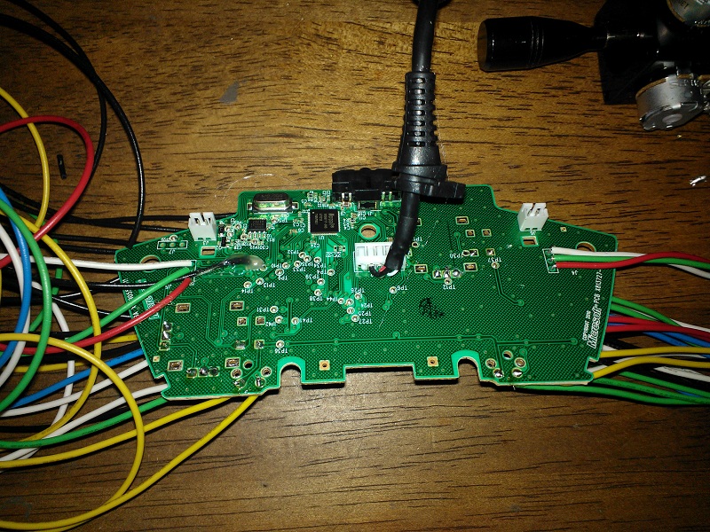

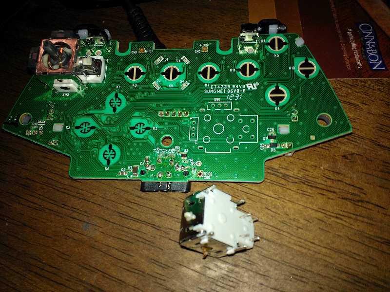

The original thumbstick and switch that is activated when you press down on it are removed as one unit.
All connections to both of them must be unsoldered before it can be removed.
I ran to Radioshack and picked up a $13 desoldering iron that has the vacuum bulb attached.
That thing is well worth the price and made easy work of removing the sticks and trigger pots.
I should have done more research about the hack, but jumped into it after glancing at HaRuMaN's tutorial.
I read that the controller wasn't common ground and ran with that, but it turned out that there are different versions now and this one was in fact common ground.
Really good because one of my ground wires wasn't getting a connection, so I could just jumper it over to the next one.

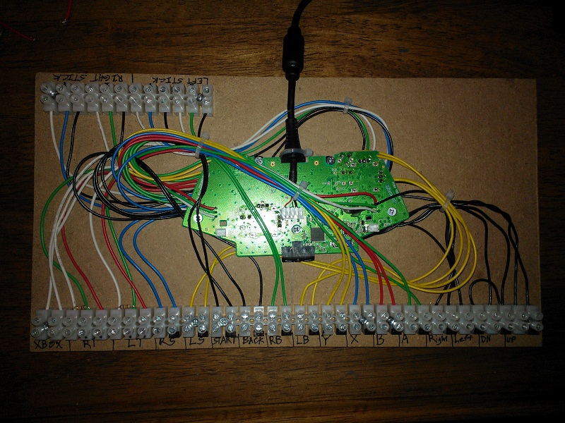

Since I already had all the wires soldered in, I decided to move ahead with the barrier strips as if it weren't common ground.
All the spots marked with black are ground and any of them will work.  As far as I can tell though, they can't be used with the analog inputs.
The controller disconnects and reconnects to windows when I try that.  I went ahead and added 10k resistors to the back side of where the trigger inputs will connect to make them digital.  They can easily be removed though if we wanted to make them analog.
The board is fairly big (6x12"), but it is less than an inch tall and should fit in the bottom of the CP without any problems.  It is 1/4" MDF.
The buttons are ordered right to left in the numerical order they appear in windows controller properties.

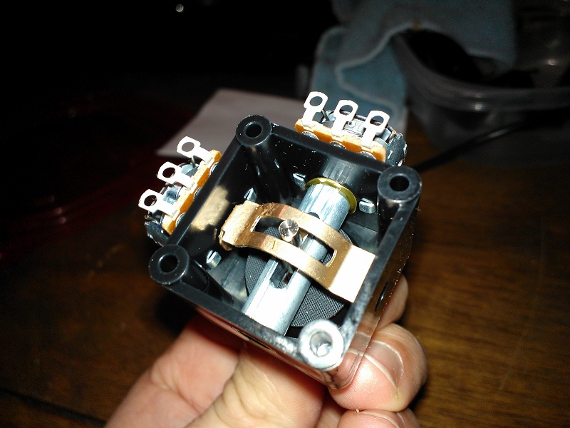

I picked up a pair of used Happ analog triggersticks to experiment with for this project.
I was planning on just swapping in the proper value pots, but they came with this "Pot Amp" 95-0013-00
I came accross this info on KLOV:

The Pot Amp didn't fry the xbox controller, but it didn't seem to accomplish much either.
When displaying raw data in the windows controller calibration, adjusting the pots on the pot amp resulted in miniscule changes.
Either I misunderstood what the pot amp supposed to accomplish, or it doesn't accomplish much.
I tried it with the original 5k pots, a 10k pot, & a 50k pot.
Didn't make any difference in the range of movement on-screen, but it was less jittery with every increase.
I had a spare 10k pot, so I stuck that in the Happ joystick and wired it directly to the xbox controller.  The results were not good.
The range of motion on the Happ joystick is so limited, that the on screen cursor only moves a tiny bit.
The handles of the ALPS joysticks don't move much farther, but the on screen cursor moves accross the full range.
On closer inspection, the pots in the ALPS joysticks are only moving about 60-80 degrees, yet going through their full range.
So now I guess I'm looking for pots that are less than one turn, but I can't seem to find any online.
I found a mention of quarter turn pots here on byoac, but can't find them for sale anywhere.
Anyone know where to source a 60 degree or 90 degree pot?
The pots in the alps don't seem to be good candidates for transplant into the Happ sticks.
I may end up having to use the ALPS joysticks after all, but will need to beef them up or create some kind of ALPS/Sanwa hybrid.
I'd rather find real arcade parts that work because they can take serious abuse and nobody is going to be around that can service it.
Thread needs more pics, so here are some of the Happ Analog disassembly:
Little bit of damage, but I think it is salvageable.  Haven't priced a replacement yet.
Rusted on top.  Thick cruddy lube inside.
Awaiting delivery of lube for reassembly.
One cool thing is it uses a bearing where the joystick shaft rides against the restrictor plate.
It's giving me ideas....I did want to reduce the throw on my JLF........

Absolutely every input on the xbox controller has been wired, including the ones activated by pressing down on the thumb sticks.

I took apart a potentiometer and made the same modifications LeChuck used in his micro star wars cab.
Basically, I took a 50k pot and put conductive paint on the section that goes from 10k to 50k.
This effectively turned the 50k pot into a 10k pot with a very limited range of motion.
It's hard to get it exactly 10k though and I'm not sure how well the cheap $3 radioshack pots I used would hold up.
I'm afraid if the pot is allowed to travel far enough to rub the spot that's been painted, it will wear through one day and throw the joystick centering off.
I'm sticking this solution in the last resort pile with the little ALPS joysticks.

Although I'm still unsure about the durability of the ALPS joysticks, we are moving forward with them rather than paying over $300 for the Happs.
Worst case scenario is they don't last long and crossbreed gives me feedback about everything that needs to be changed on the next CP.
I had a friend make adapters to attach Sanwa bat-tops to the ALPS joysticks.
Unfortunately he broke his tap of the needed size and gave them back to me unfinished.
He sent me a link to a set of taps(taper, plug, bottom) to finish the job and I ordered them,
but I didn't get around to attempting it until last night.
It went surprisingly well.
It drives me nuts that one bat-top appears larger than the other in all the pics.
It should be the same size, but I might move it onto the D-Pad stick just to be sure.
So here are the sticks.  The D-Pad will use a Sanwa JLF with octagon restrictor.
Adapters probably could have been a bit longer, but we'll work with it.

Happ will sell you 5k or 100k ones for around $45 shipped.  ;)
I have ONE new 100k I'll ship to you for $20 if you'd need it.
I bought it to see if the 100k Happ joysticks would work with the xbox hack (they do, but they cost $165 each).
The second half of the plan was to take the numbers from it and order three more elsewhere to use in my dual analog triggerstick CP.
The numbers only led to the manufacture's website where it's listed as "made to order".  :banghead:
The ones in the ALPS sticks aren't near the build quality.  They are mostly plastic, including the shafts.
The shafts aren't normal either.  They are made to snap into yoke inside the ALPS joystick.

Wiring done today.  Not a lot of space to spare inside.  I forgot that the triggers and xbox button don't share a common ground with the rest of the buttons, so ended up with a few extra terminals on my ground chain.
