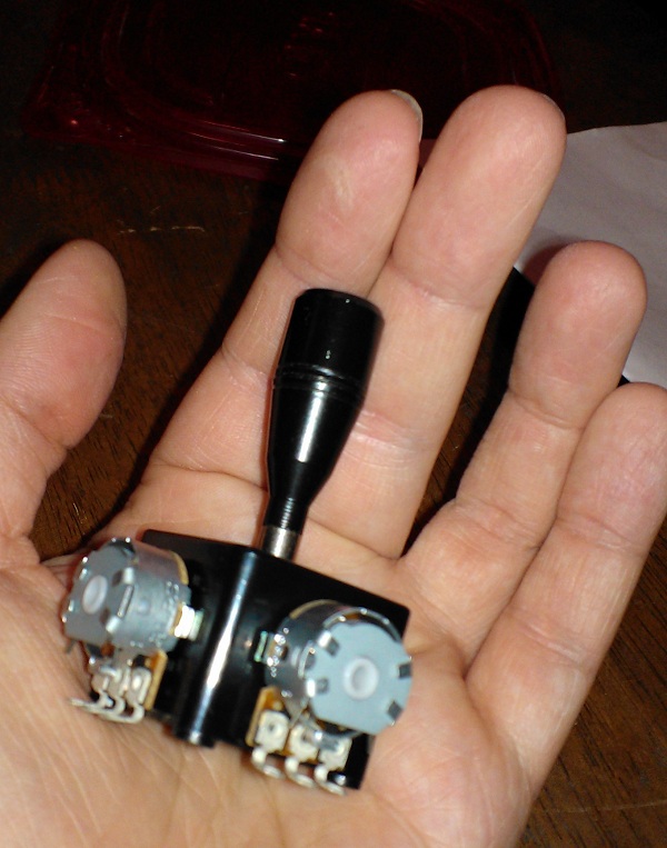

This started out with the idea that an analog joystick would be easy to hack into an xbox 360 controller as long as it had the same value pots as the original thumbstick (10k).  I tested this by hooking up an Alps 2D joysticks ordered off ebay.
It proves the concept, but has some play in it when centered and I'm not sure the xbox360 will have enough deadzone built in to account for it.
I tested the original xbox pots just to make sure that they had no deadzone built into them and they didn't, so it has to be on the software side.
This wouldn't be an issue for emulators since the deadzone can be adjusted, but this will be used on an xbox360 console.
The other issue with the ALPS stick is that it is so small.  I was hoping to fit Sanwa bat tops to them, but they are just too small for this project and I'm not sure if they'd hold up to extended use.  They might not be too bad as a small addition to a standard cab where they would only see occasional use for N64 or Dreamcast emulation.

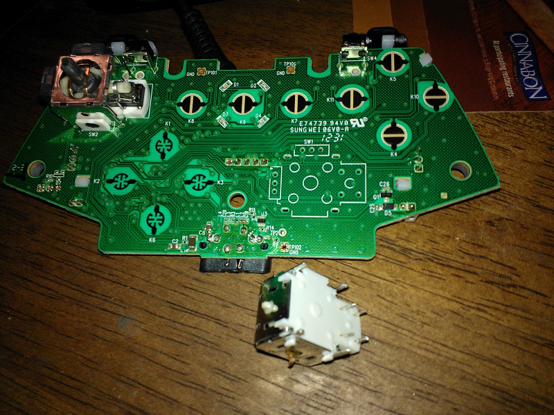

The original thumbstick and switch that is activated when you press down on it are removed as one unit.
All connections to both of them must be unsoldered before it can be removed.
I ran to Radioshack and picked up a $13 desoldering iron that has the vacuum bulb attached.
That thing is well worth the price and made easy work of removing the sticks and trigger pots.

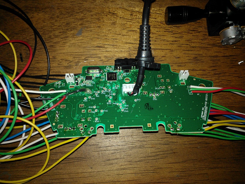

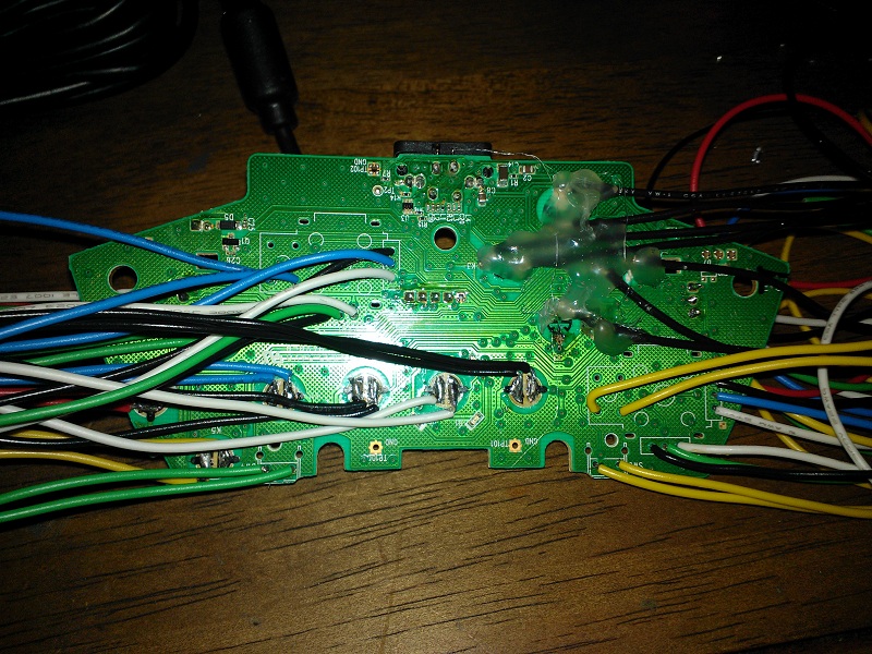

I should have done more research about the hack, but jumped into it after glancing at HaRuMaN's tutorial.
I read that the controller wasn't common ground and ran with that, but it turned out that there are different versions now and this one was in fact common ground.
Really good because one of my ground wires wasn't getting a connection, so I could just jumper it over to the next one.

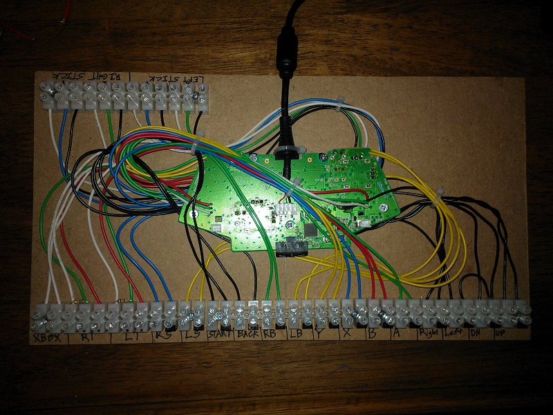

Since I already had all the wires soldered in, I decided to move ahead with the barrier strips as if it weren't common ground.
All the spots marked with black are ground and any of them will work.  As far as I can tell though, they can't be used with the analog inputs.
The controller disconnects and reconnects to windows when I try that.  I went ahead and added 10k resistors to the back side of where the trigger inputs will connect to make them digital.  They can easily be removed though if we wanted to make them analog.
The board is fairly big (6x12"), but it is less than an inch tall and should fit in the bottom of the CP without any problems.  It is 1/4" MDF.
The buttons are ordered right to left in the numerical order they appear in windows controller properties.

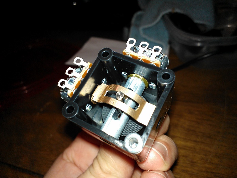

Thread needs more pics, so here are some of the Happ Analog disassembly:
Little bit of damage, but I think it is salvageable.  Haven't priced a replacement yet.
Rusted on top.  Thick cruddy lube inside.
Awaiting delivery of lube for reassembly.
One cool thing is it uses a bearing where the joystick shaft rides against the restrictor plate.
It's giving me ideas....I did want to reduce the throw on my JLF........

This stick should be perfect if we can get a pair.  They are already 10k which is what we need and are built for arcade duty.
They won't be cheap, but should be a lot cheaper than the Happ analogs (which we would still have to swap out the pots in).
I have some Sanwa bat-tops that I plan to put on them.

Absolutely every input on the xbox controller has been wired, including the ones activated by pressing down on the thumb sticks.

It seems the only chance of finding the LS-64s is finding them used in a repair shop in Japan.
I think chances are pretty slim since nobody seems to have ever seen one in real life or know of a game that they were used in.  :-\
I took apart a potentiometer and made the same modifications LeChuck used in his micro star wars cab.
Basically, I took a 50k pot and put conductive paint on the section that goes from 10k to 50k.
This effectively turned the 50k pot into a 10k pot with a very limited range of motion.
It's hard to get it exactly 10k though and I'm not sure how well the cheap $3 radioshack pots I used would hold up.
I'm afraid if the pot is allowed to travel far enough to rub the spot that's been painted, it will wear through one day and throw the joystick centering off.
I'm sticking this solution in the last resort pile with the little ALPS joysticks.
I've been fixated on having a 10k pot because that's what was in the original xbox controller, but in truth the controller is probably working off the voltage (hopefully), not the resistance.  A 10k pot with 5 volts going to it will read 2.5 volts when centered.
A 100k pot will also read 2.5v when centered.  As long as it has the same amount of resistance on each side, the voltage is divided equally.
So the value of the pot isn't as important as finding one with a limited range of motion.
The replacement pots for the Happ joystick say they're "S taper"
From what I've been able to find out about S taper pots online, it sounds like it's a custom taper and might be hard to find a generic match for.
If someone could offer a better explanation of it, I'd be ready to listen.
So I ordered a single 100k pot from Happ to drop into my analog Happ trigger stick.
Since it's made for the range of motion of the joystick, maybe we'll luck out and it will just work.
I only ordered one because they are $31 each.  That should be enough to see if it works.
I don't want crossbred dropping money on the Happ Analogs until it's guaranteed they will work.
We'll see what that does with the hacked pad and if it doesn't work, I guess I'll see if I can get one of the custom industrial joystick companies to sell me one of their 10k pots.
I may also go ahead and mount seimitsu bat tops to the little alps joysticks just to see how they play.
I know this is taking forever, but I'll wrap it up one way or another by the end of next month.

Hrm... that button layout is actually amazing for Xbox games.  The labels make it appear much tighter and organized that I would have thought.  Nice!
Crossbreed900 came up with the layout.  He is going to be tapping them with a pinky knuckle, so the tight grouping was important to allow him to move from one to the other quickly or press combinations.  I like grouping the Japanese buttons so close that the nuts on the back just touch each other.  That way the spacing between buttons is perfect, even if the button holes that were drilled aren't.   :P
I was waiting for someone to click on the thread, look at the pictures, and then blast me for the layout without realizing that it was being built for someone who can't move their fingers.  I'm glad that didn't happen.
Wish I would have seen this earlier. Those pots with limited deflection are harder to find than hens teeth. Awesome build and research so far.
Happ will sell you 5k or 100k ones for around $45 shipped.  ;)
I have ONE new 100k I'll ship to you for $20 if you'd need it.
I bought it to see if the 100k Happ joysticks would work with the xbox hack (they do, but they cost $165 each).
The second half of the plan was to take the numbers from it and order three more elsewhere to use in my dual analog triggerstick CP.
The numbers only led to the manufacture's website where it's listed as "made to order".  :banghead:
The ones in the ALPS sticks aren't near the build quality.  They are mostly plastic, including the shafts.
The shafts aren't normal either.  They are made to snap into yoke inside the ALPS joystick.

Wiring done today.  Not a lot of space to spare inside.  I forgot that the triggers and xbox button don't share a common ground with the rest of the buttons, so ended up with a few extra terminals on my ground chain.
