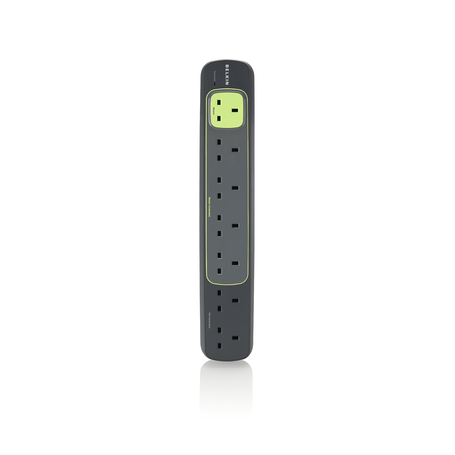

I want to put something like this on the outside of my cabinet:
http://www.amazon.com/IEC-Power-Jack-Chassis-Mount/dp/B0008IW78W/ref=pd_sim_sbs_hi_3
On the inside, everything will be plugged into a smart strip.  I was hoping to find a female to female adapter to connect the two, but I can't.  Any suggestions on the best way to go about this?  All I can think of is either just wire it together or to splice two female power cord ends together.

I'd just cut the male plug off the smart strip, and solder the wires to the terminals of the part you linked to.  Just make sure that you get the wires hooked up to the correct terminals, and heat-shrink the connections to insulate them.

I was thinking that I would want a push-button instead of a switch though, to wire to the PC power button.  You guys are controlling the smart strip with the power switch?

If you want to, I think you can get power strips where turning your PC on/off turns the strip on/off, so you only need one button.

That's the smart strip I was referring to in my original post.  I want to wire that to the inside of the jack mounted on the case.
