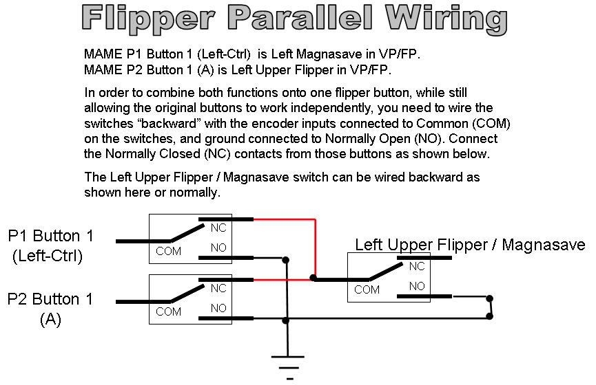

Proposal for aligning Pinball map (Mode 4) with 1 Player Mame map (Mode 1):
Pinball (v2.0)
   Pin | Description    | Key
   A 1 | P1 Coin        | 5
   A 2 | P1 Start       | 1
   A 3 | P1 Right       | <Right Arrow>
   A 4 | P1 Left         | <Left Arrow>
   A 5 | P1 Up           | <Up Arrow>
   A 6 | P1 Down       | <Down Arrow>
   A 7 | L/Magnasave | <L-Ctrl>
   A 8 | R/Magnasave | <R-Ctrl>
   A 9 | Fwd/Nudge    | <Space>
   A10 | L/Flipper       | <L-Shift>
   B 1 | L/Nudge        | Z
   B 2 | R/Flipper       | <R-Shift>
   B 3 | R/Nudge       | /
   B 4 | Test              | T  ***
   B 5 | Exit               | <Esc>
   B 6 | Plunger         | <Enter>
   B 7 | Backglass     | <Tab>
   B 8 | Pause           | <Pause/Break>
   B 9 | L/Up/Flipper | A
   B10| R/Up/Flipper | ‘
Notes:
Red = Change from current pinball keymap.
*** = To everyone: Is there another function/key needed more than this one?
Hardware question: For those who are worried about their cab looking like a Frankenpin, can someone wire the “L/Magnasave” and “L/Up/Flipper” terminals to the same microswitch in order to output both "<L-Ctrl>" and "A" with one button press, or will that cause problems?
EDIT: Yes you can connect two encoder inputs to one button as shown for left upper flipper/Magnasave while still allowing them to operate independently.
