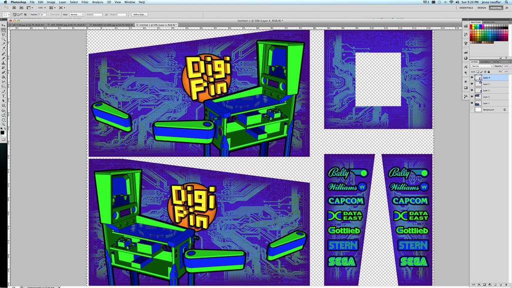

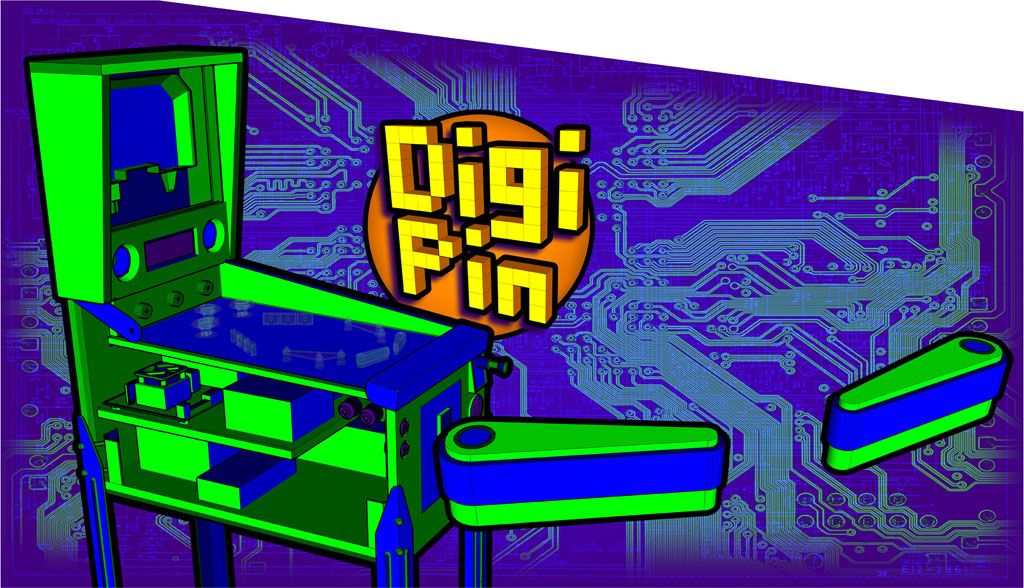

I'm officially scrapping the artwork and possibly theme/name I came up with over a year ago.  It no longer pleases me.
UPDATE TO THE UPDATE:

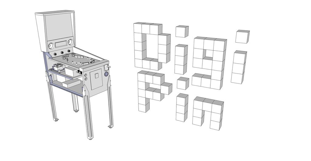

I've had about five people ask me for plans so I uploaded my sketchup file to MediaFire.  You'll need to learn sketchup if you don't already know your way around it... But I hope this helps you guys out!
You can find the file here: DigiPin plans
UPDATE:

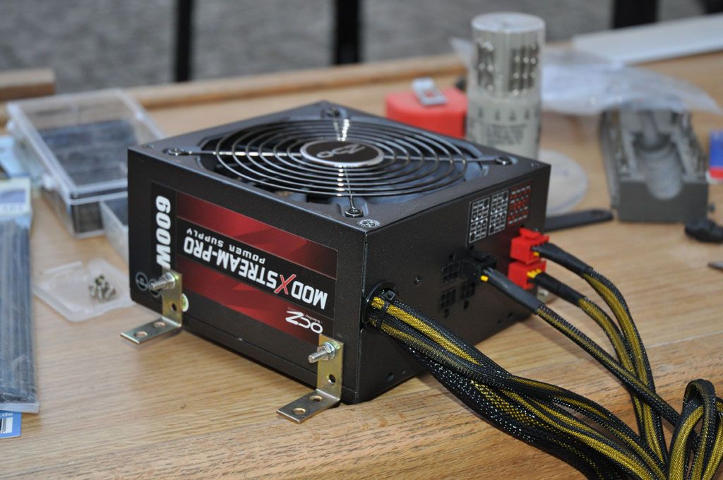

PSU: OCZ ModXStream Pro Power Supply - 600-Watt

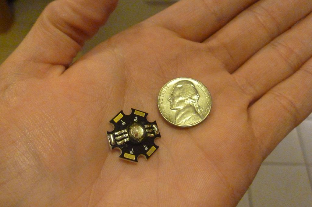

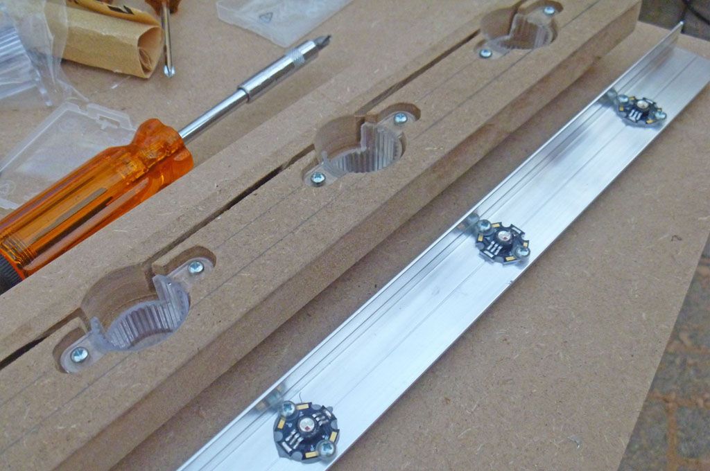

Lights: Vollong 3W RGB High Power LED (superbrightleds.com)

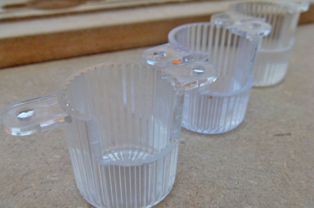

Clear Domes with screw tabs (marcospecialties.com)

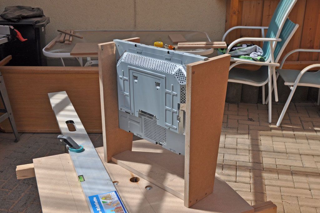

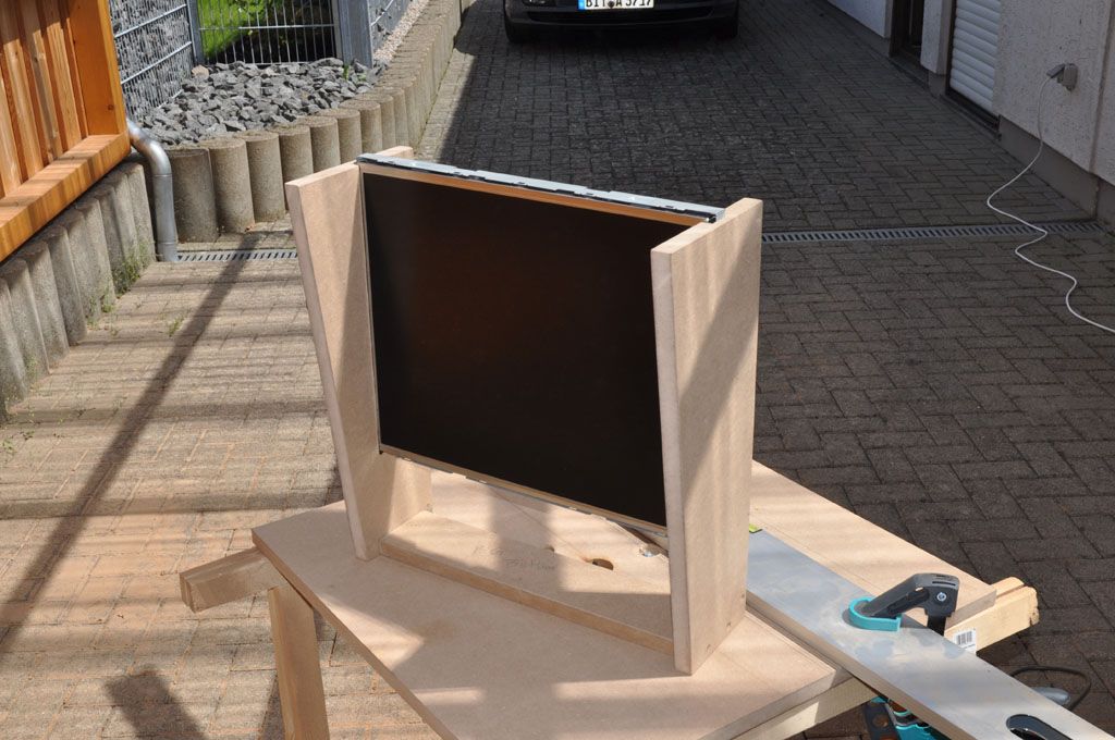

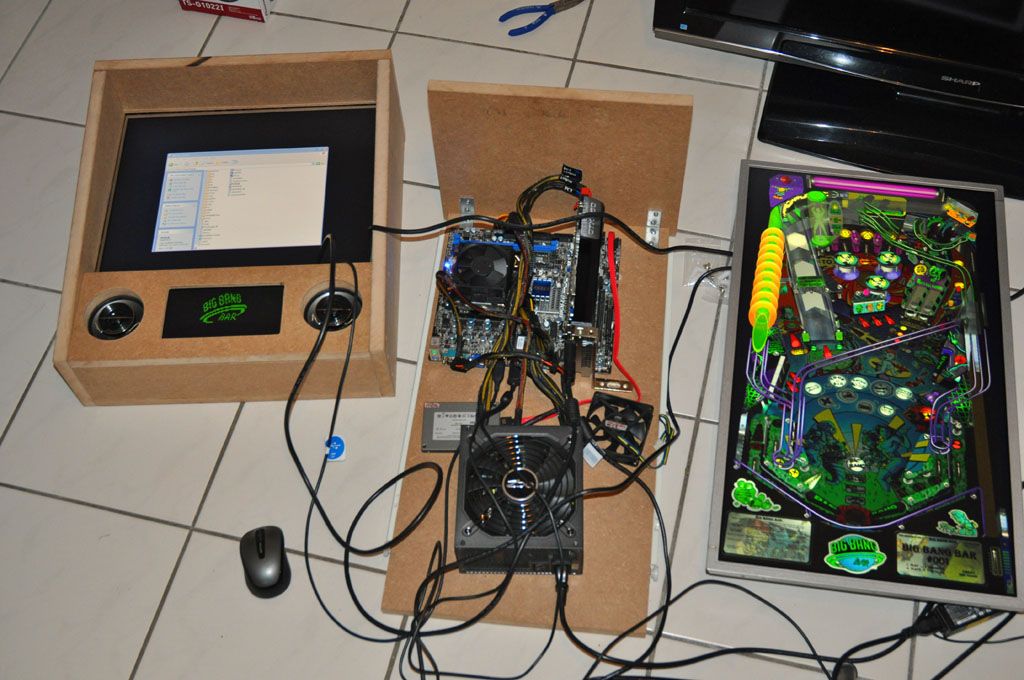

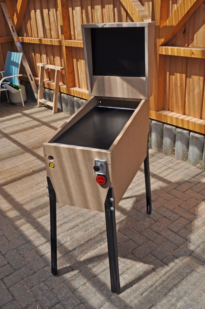

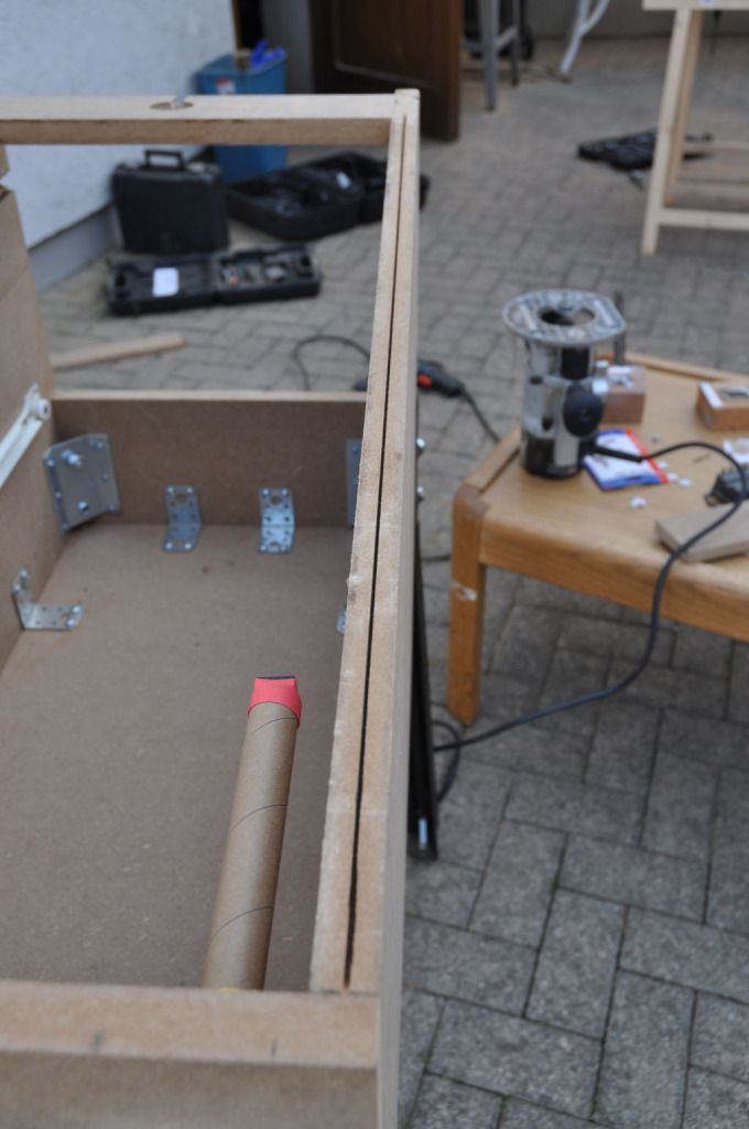

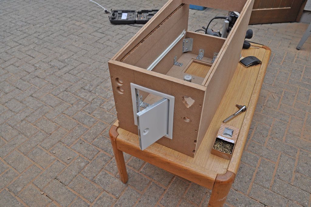

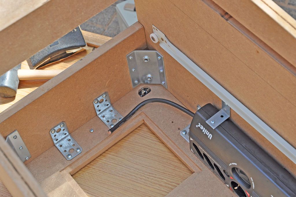

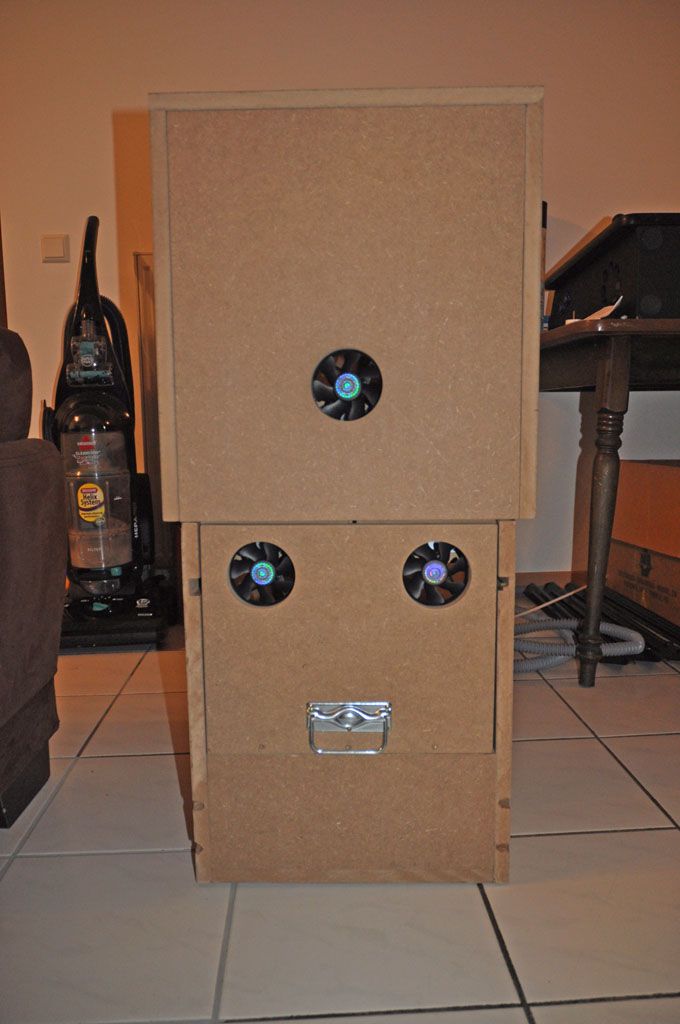

After years of trolling various forums (but mostly this one) I've finally decided to build a cab.  I first had this idea many years ago, but VP didn't support fullscreen tables.  That was back in the V6 days.  I sat back and followed the build threads religiously, and now I've finally bit the bullet.  I can't really call this a mini, but it's definitely not a full... more like 3/4.  One reason I'm not going full size is the fact I'm in the Air Force and stationed in Germany.  I'd rather not have to move a huge cabinet.  Also LCD screens are crazy expensive on the local economy (forget about LED) and USPS won't ship anything too big over here.  Then there's the fact that I don't like the idea of using a full sized monitor for the DMD.  It seems wasteful, but mostly I'd rather have a true backbox that I can fold down without half of a third monitor sticking out somewhere.  So I went the USB monitor route.  I picked up a 7" mimo on ebay for $85.  I was a little worried how it would look, but it's great.

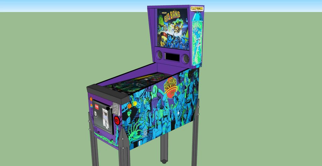

First I had to teach myself sketchup... I wish I had this back when I build my arcade!  Photoshop, pen, and paper don't cut it.  I spent a good deal of time tinkering with this before buying MDF and making the first cut.

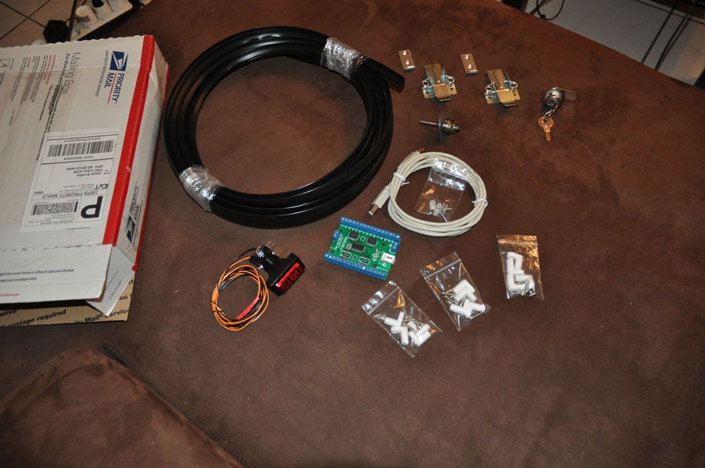

Spent some serious cash at Tigerdirect...
...only to immediately void the warranties.

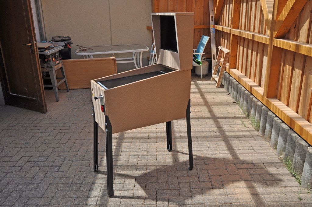

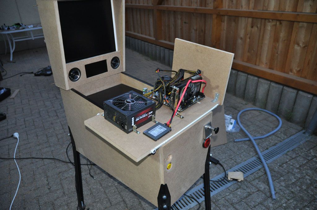

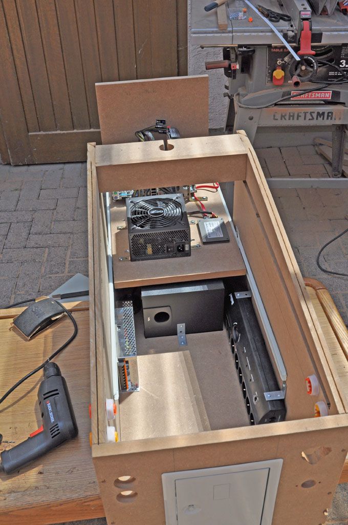

Here's what I accomplished on Saturday.  Too bad I got a late start and Germans aren't very friendly to power tools on Sundays.  Polizei get involved.
While I continue my build I have a few things to sort out:

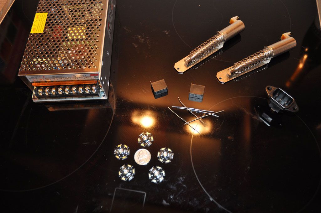

I'm not sure if/when I'll go the flasher/solenoid route.  I think the Cree LEDs might be too bright for the size of my cab.  The top of the backbox will be more eye-level than a normal cab and I understand those things are ridiculously bright.  I'm still kicking around the idea of using groovygamegear's RGB LEDs.  I know they're weaker, but they might fit my medium cab better.  What do you guys think?
I'd definitely like to put some siemens relays in for flipper/bumper/kicker feedback but we'll see.  I do know that I'm not interested in a shaker or motor.
Lockdown bar... The one thing I don't like about non full-sized cabs is the lockdown bar.  I don't want something that looks cheap or unauthentic.  I might have to try my hand at making one from wood and spend the time to sand, paint, sand, paint it to perfection.  I doubt anyone local could make a metal one that would please me.  I may go with one from ArcadesRFun.  Does anyone know how deep their bars are?  I see 3" on their post, but I think they're talking about depth over the glass, not the face of the cab.  I'll need 1 1/2" over the front of my cab.
I'm also undecided on a theme.  If I could get Big Bang Bar art printed to fit my cab, maybe... but I'm still trying to decide if I wanna Photoshop something original up.

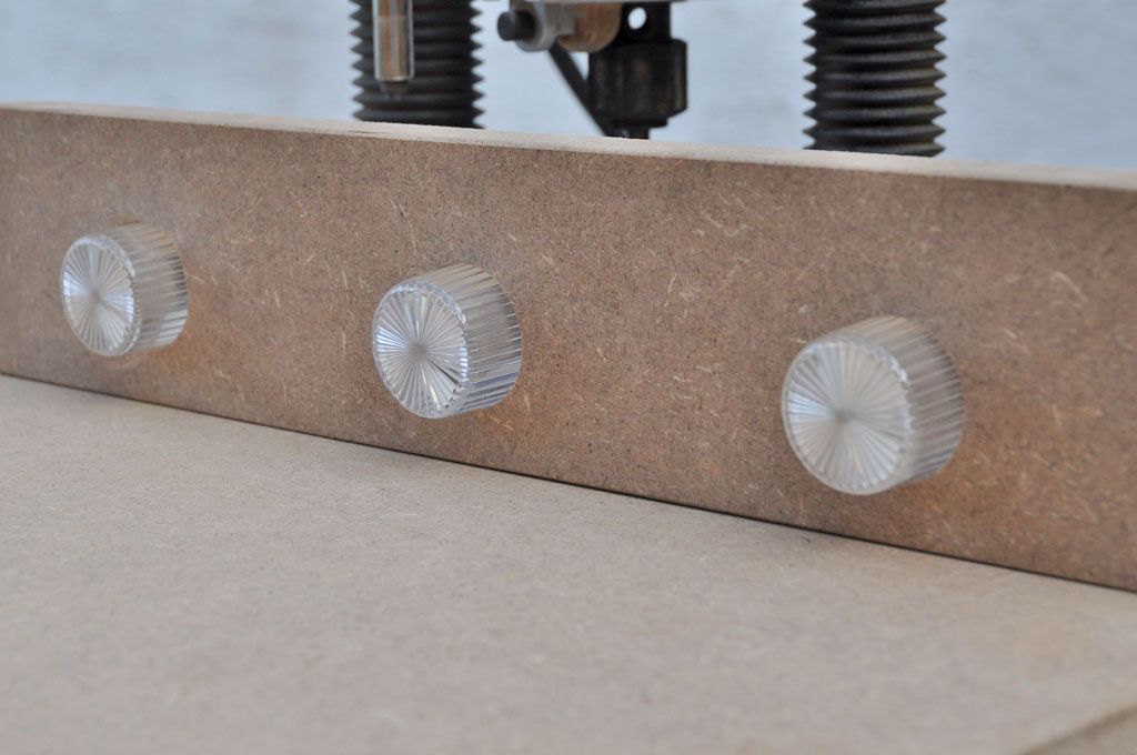

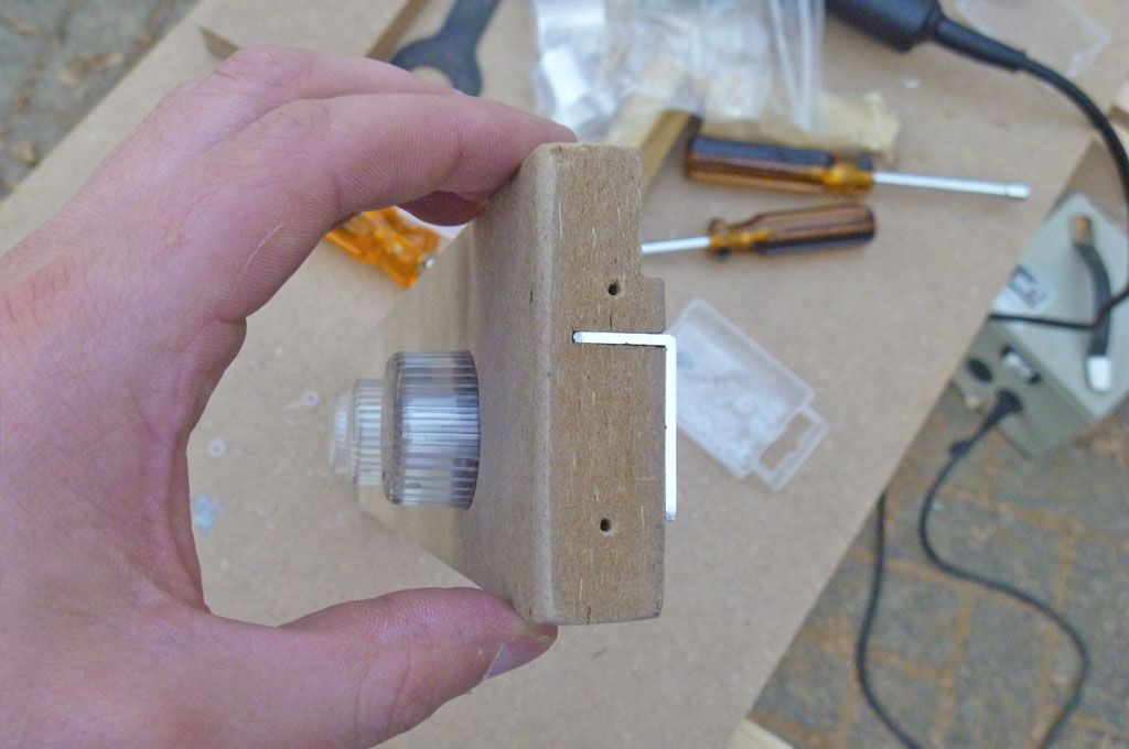

« Reply #6 on: May 16, 2012, 08:28:22 am »

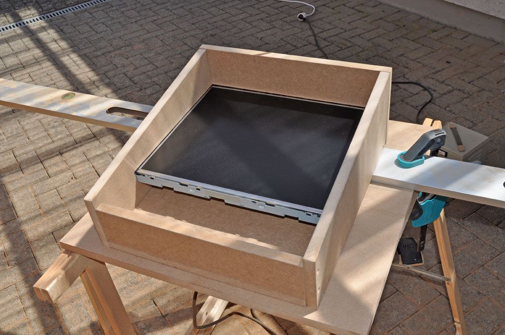

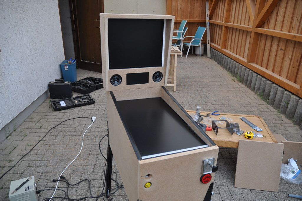

Backbox partially finished.  Still waiting on more buttons.
« Last Edit: August 27, 2013, 01:48:25 pm by swaffar »

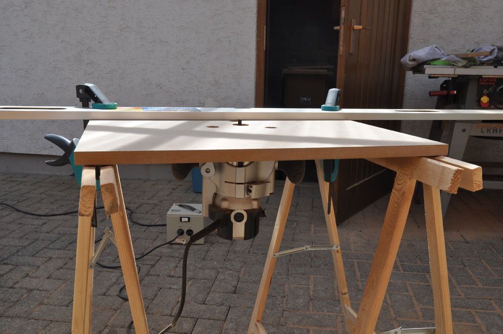

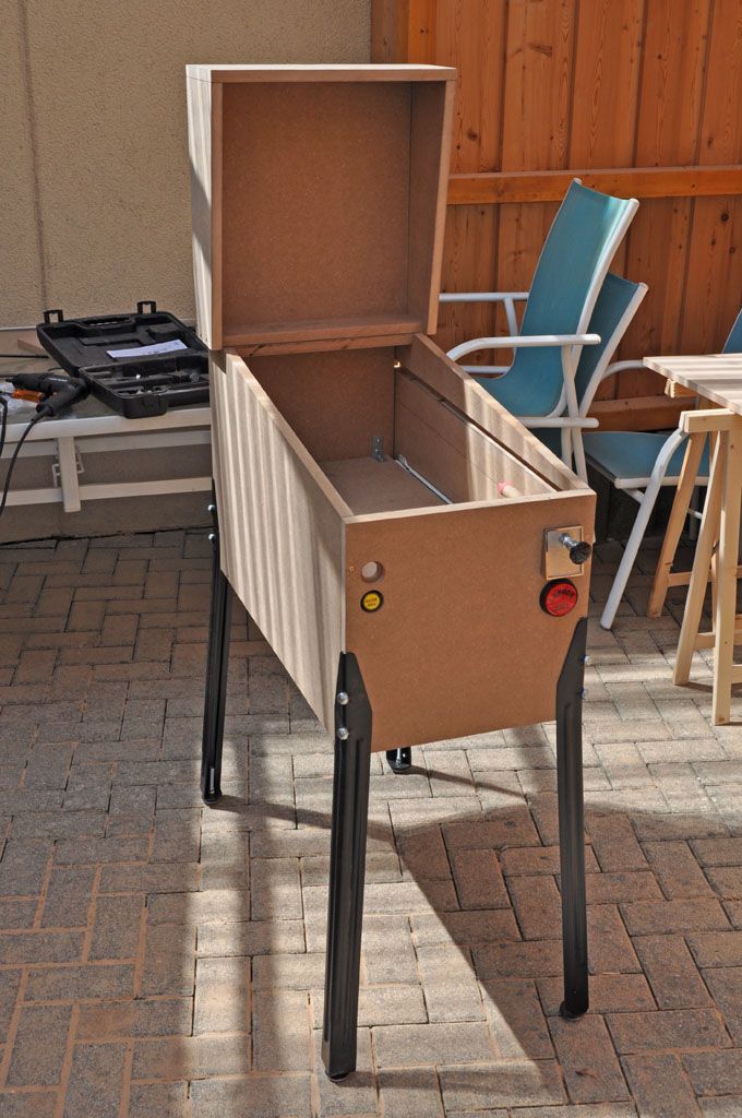

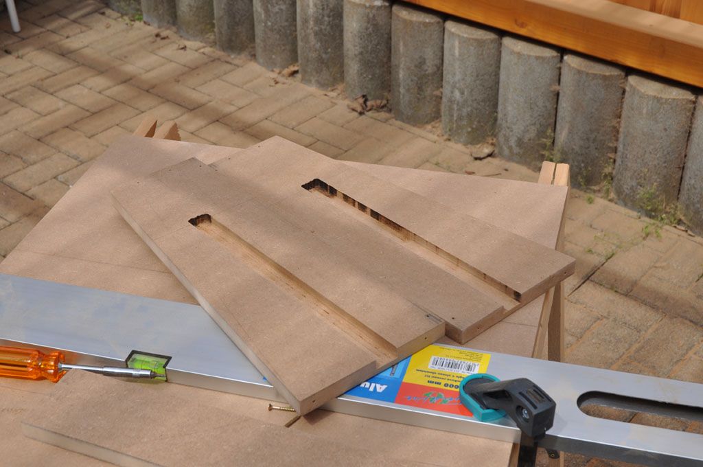

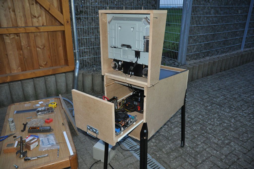

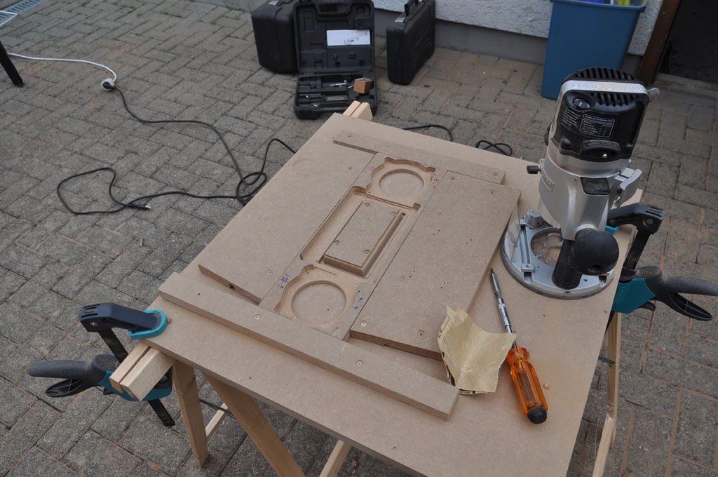

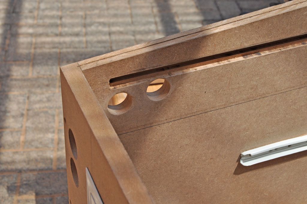

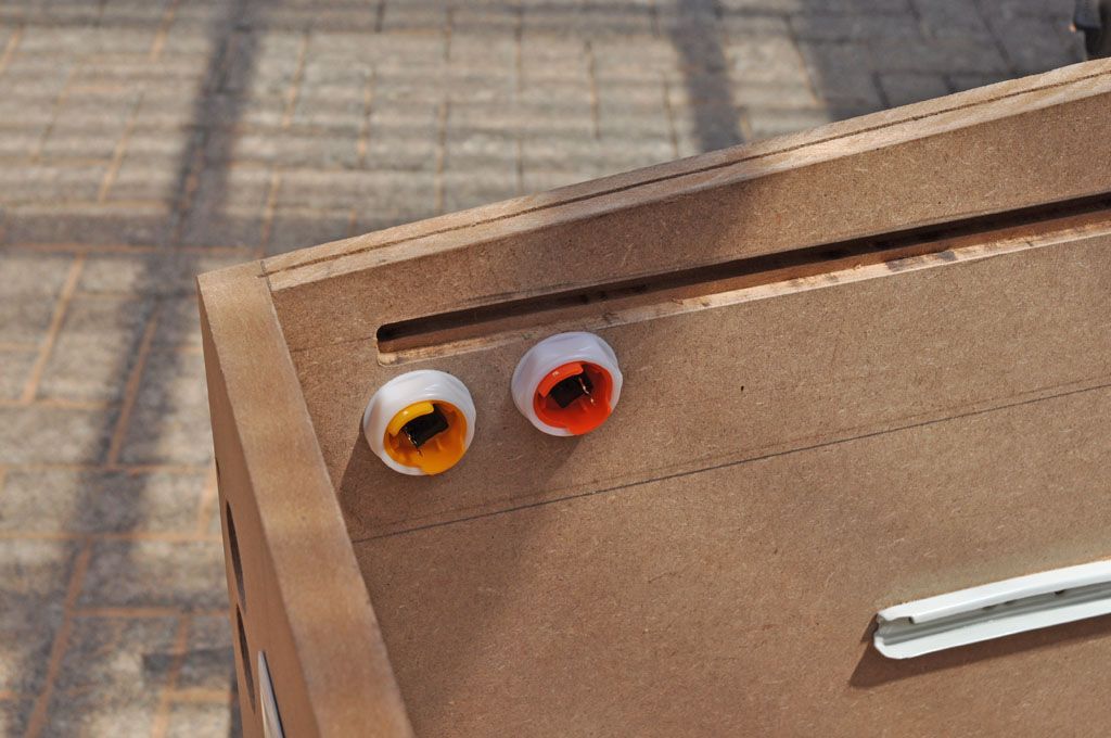

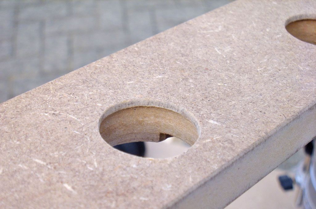

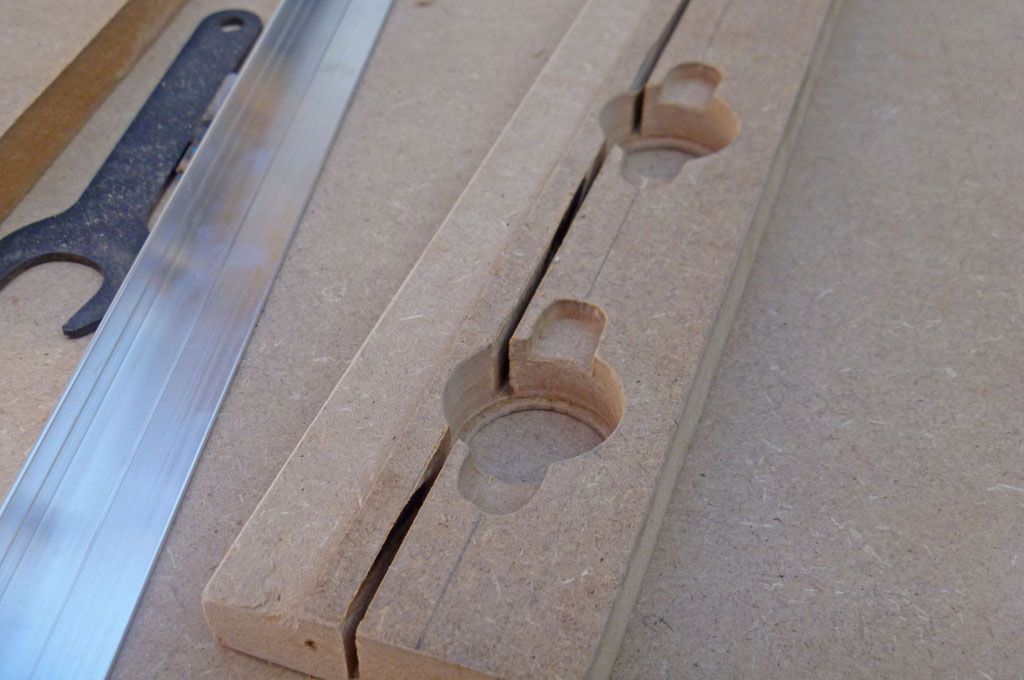

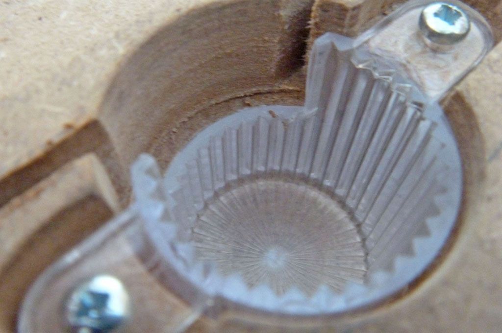

more progress...
Router bit started to smoke towards the end!
« Last Edit: August 27, 2013, 01:49:20 pm by swaffar »

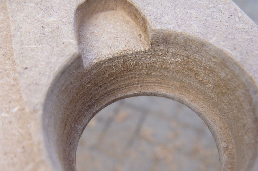

Thanks for the comments.  I'm just glad my routing came out as well as it did.  Measure twice, cut once.

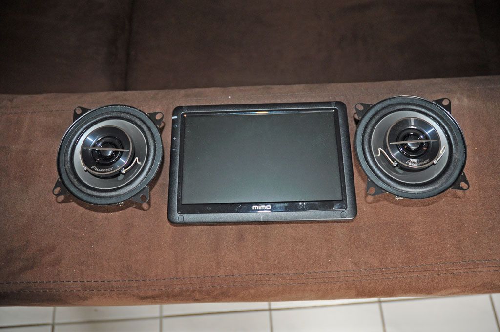

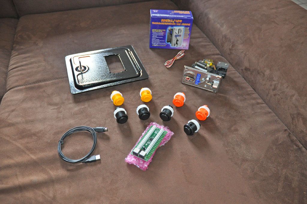

More parts in today!!!
« Last Edit: August 27, 2013, 01:49:41 pm by swaffar »

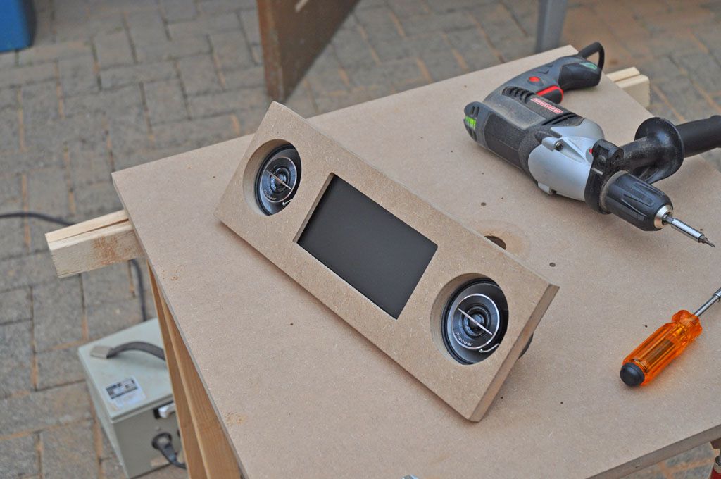

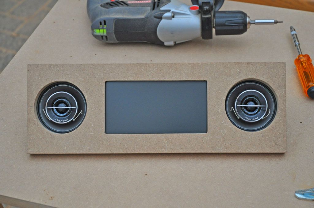

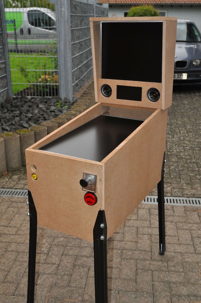

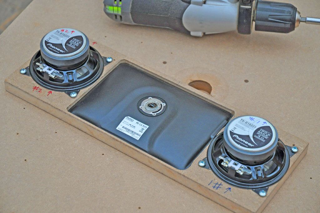

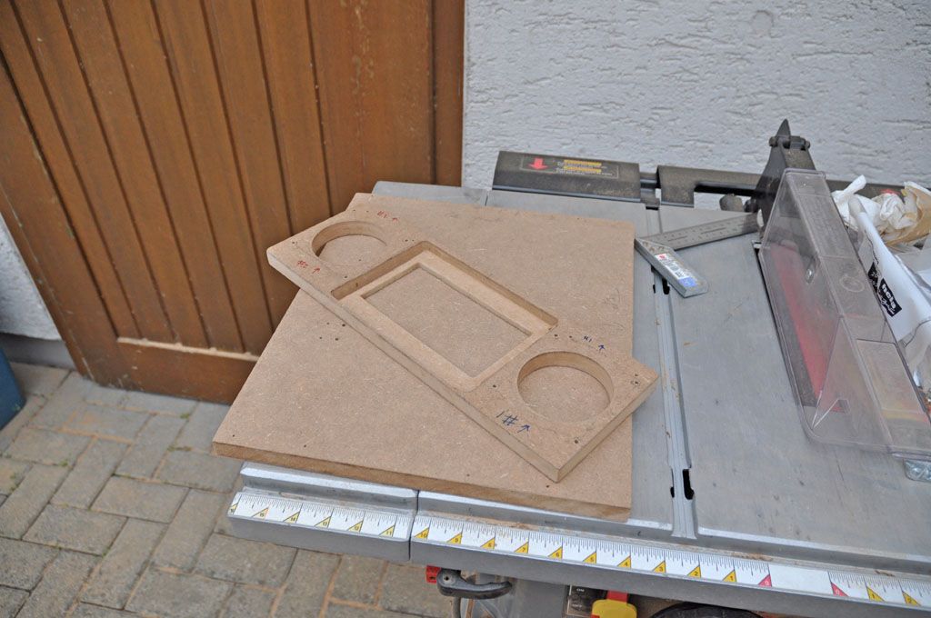

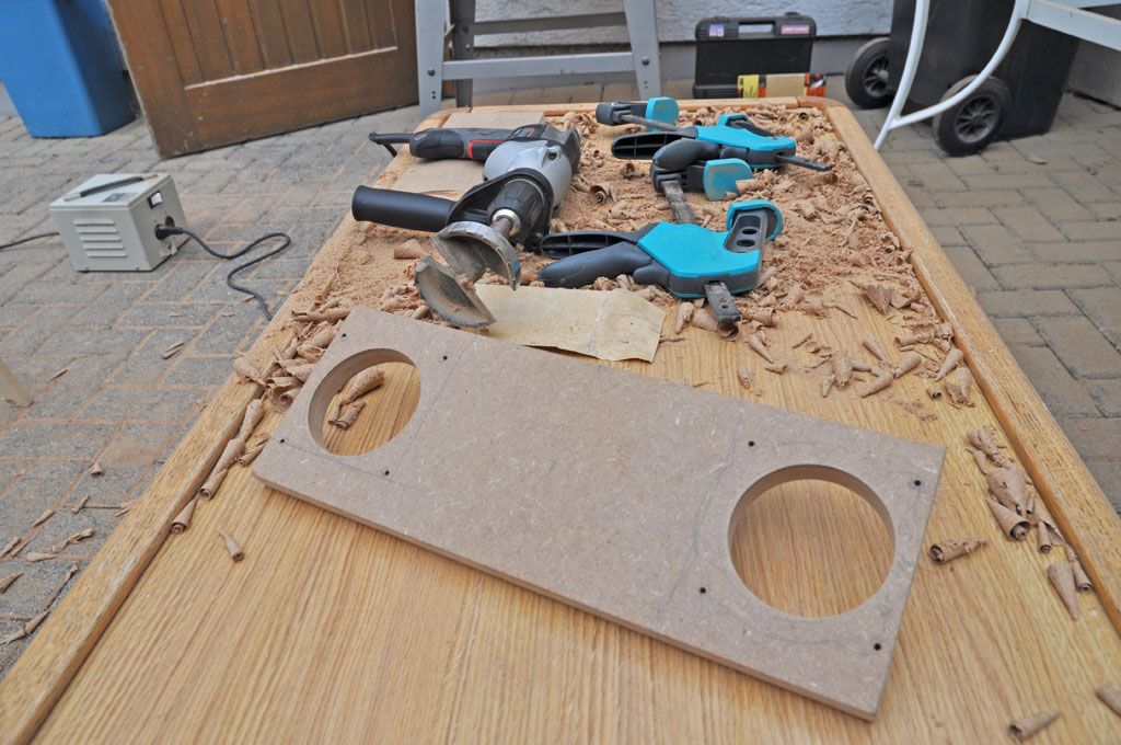

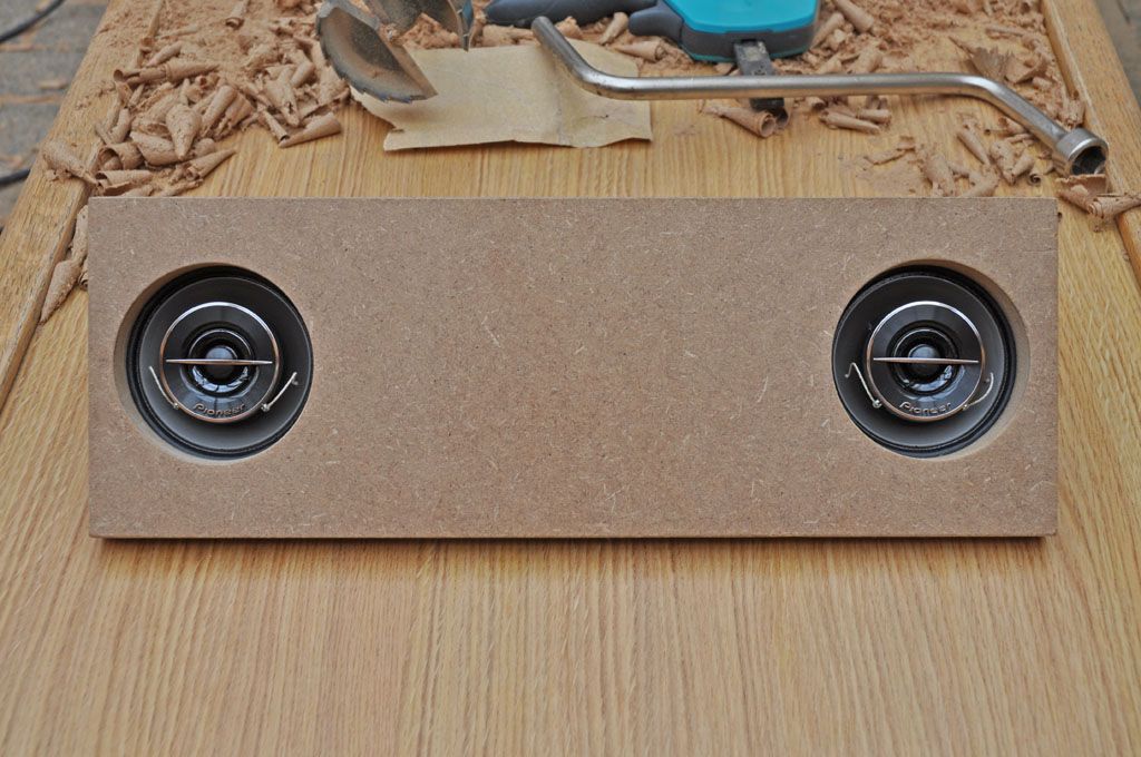

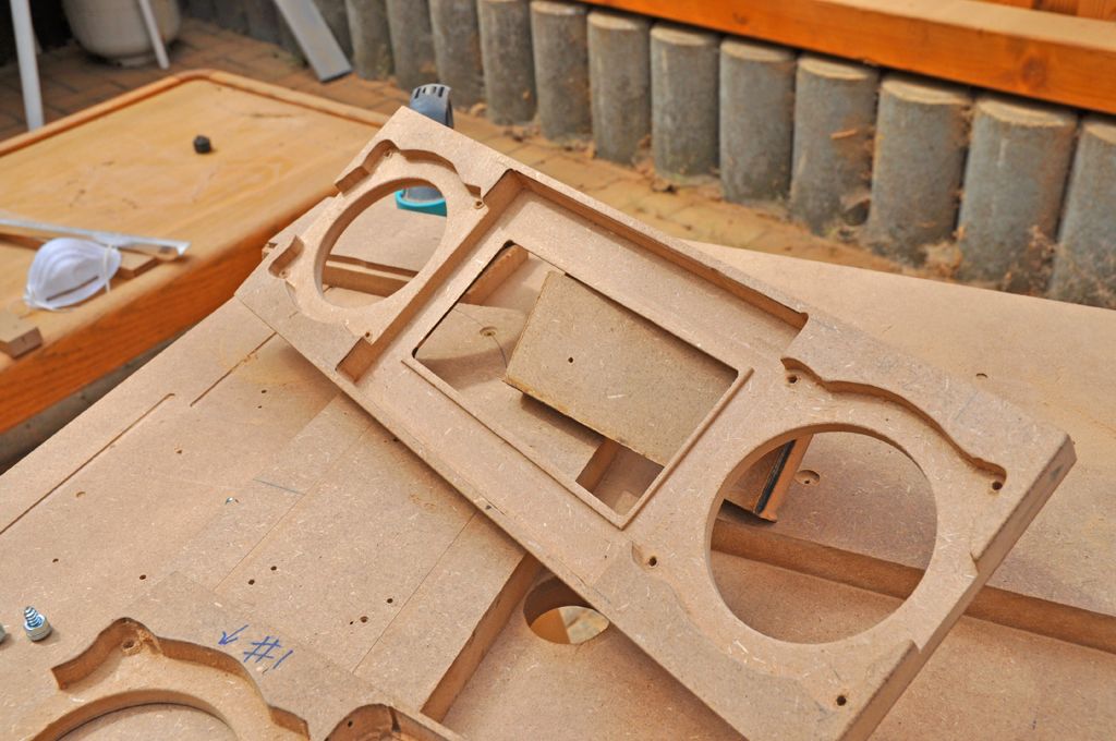

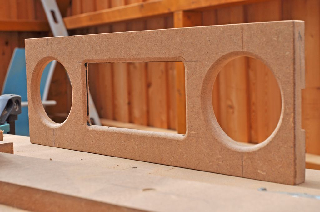

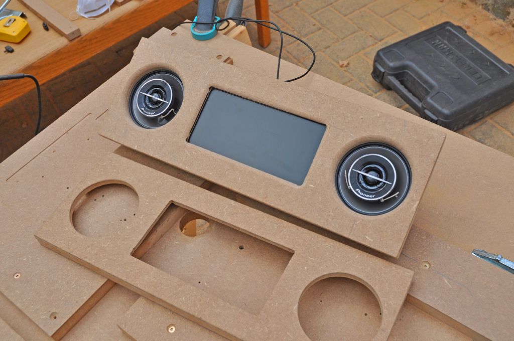

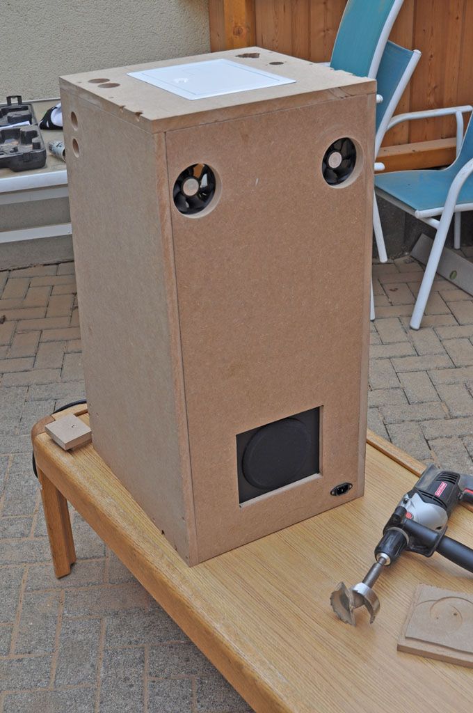

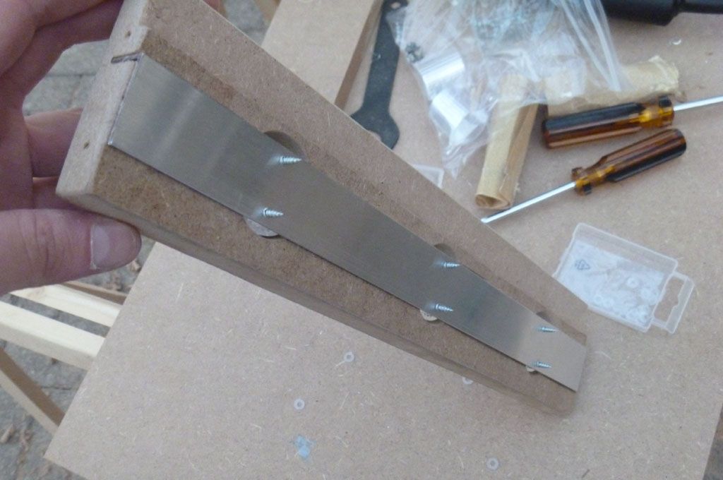

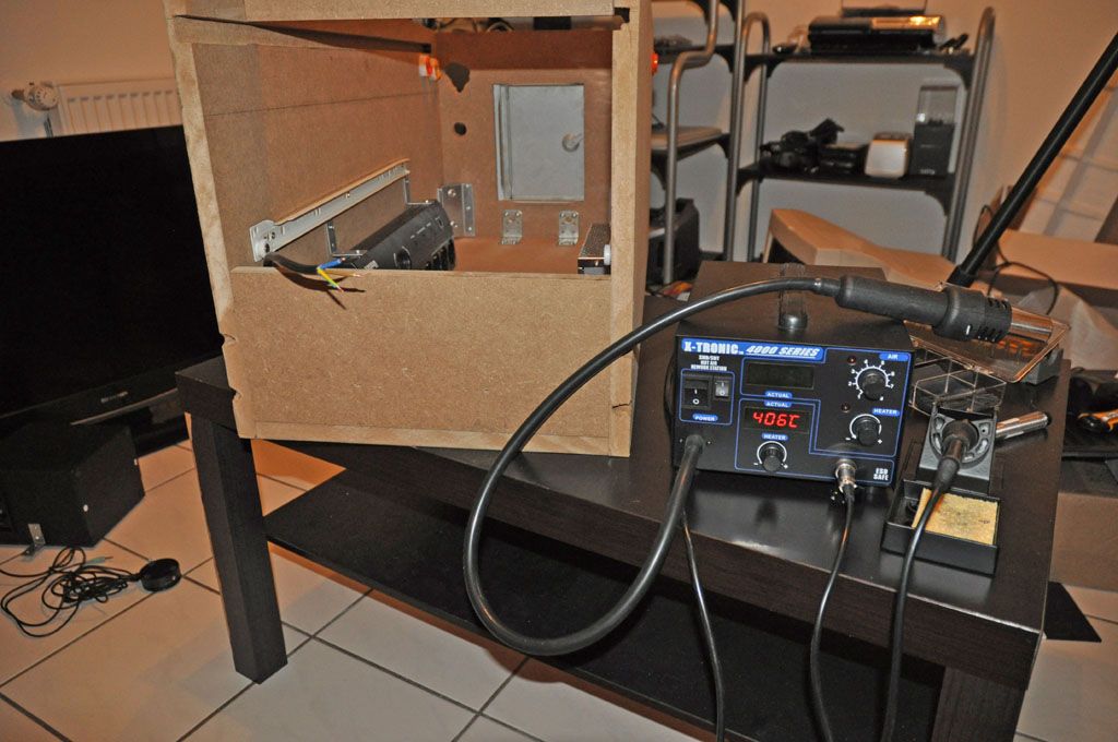

Oh... almost forgot.  Progress:
Good progress today... mostly finished my DMD grill.  Everything fit without a millimeter to spare.  Literally.  The speakers are both flush with the sides of the grill, and the DMD display is flush with both speakers.
I still need to countersink the speakers and bevel the holes in the front, but I'll do that later.  I just needed to make sure everything would fit.  *sight of relief*
« Last Edit: August 27, 2013, 01:50:30 pm by swaffar »

It lives...

how are you feeding the video signal to the little portable lcd screen?
it's a 7" mimo usb monitor.  it's powered and receives video all over USB.  i'm very impressed with it.
This one?
http://www.mimomonitors.com/products/mimo-720-f-flex-screen-mountable-touchscreen-usb-monitor

« Last Edit: August 27, 2013, 01:34:47 pm by swaffar »

Re: Small Pinball cab (27" / 19" / 7")
« Reply #42 on: May 19, 2012, 09:33:13 pm »
Is the plunger just for show, or are you going make it functional?
swaffar
  • Posts: 216
« Reply #43 on: May 19, 2012, 09:43:07 pm »
It's functional.  It's an actual plunger but the shaft is enclosed in a tube with an optical sensor installed in the back.

« Reply #47 on: May 21, 2012, 08:21:47 am »
As always, thanks for all the comments.  I'd properly respond, but I'm about to leave for work.
Sadly, the coin door is a bit larger than the site advertised (I think.)  :banghead:  I should be able to cut a new front panel and move buttons/plunger around just enough to make it fit.
« Last Edit: August 27, 2013, 01:35:05 pm by swaffar »

I got it from ultimarc.com
I just checked the site out and now I see my problem... "COIN DOOR: Finished in black Hammerite. fits an aperture 8.5 inches wide X 7.5 inches tall."
That's the measurement for the hole, not for then entire coin door and frame. :(
I'll just get a new sheet of MDF for the front, move the plunger and start/extra ball buttons further out, and it should squeeze in there.  I started to move things around in sketchup, and I'm pretty sure it'll work, but I might have to route the insides of the side panels so that the plastic nuts for the pushbuttons fit.

« Reply #53 on: May 24, 2012, 07:23:16 pm »
« Last Edit: August 27, 2013, 01:35:57 pm by swaffar »

The smallest bit of progress before work today.
« Last Edit: August 27, 2013, 01:37:38 pm by swaffar »

Re: Small Pinball cab (27" / 19" / 7") ***Now named DigiPin***
« Reply #60 on: May 27, 2012, 04:50:25 pm »

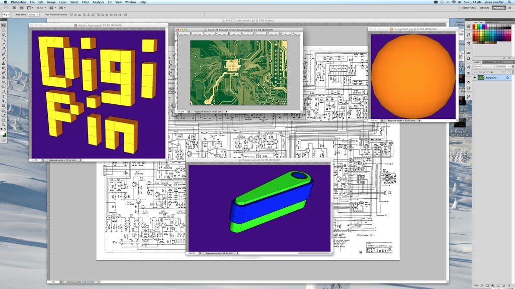

I've been thinking about my theme/artwork and as much as I love the Big Bag Bar artwork, I've put too much effort into this cab to simply copy some else's work.  Here's what I've come up with over the last two days.  It's only my first version, but I'm pretty happy with it.  Let me know what you guys think.
My five pieces of art total 1.27 GB.... It's too bad I don't know Illustrator at all.  Gotta stick to what you know.
« Last Edit: August 27, 2013, 01:37:21 pm by swaffar »

Wow... no responses on the artwork?  :angry: :badmood:
Time to figure out the back of the playfield...  I don't want to mount the LED domes on the front so I'll take the time to make it pretty.
I had to cut this piece twice as I screwed the first one up.  I had to drill almost all the way down using a 35mm forstner, then the last bit with a 30mm, then sand.  Otherwise there was too much of a gap around my domes.
An hour into work I realized I have a problem.  If I ever want to slide the playfield out, I'll need to make disconnects for my LEDs and backbox... This was a major oversight on my part.  The backbox will be easy enough; I'll just get DVI, USB, audio, and Molex extensions for a quick disconnect behind the playfield screen.  For the RGBs I can either wait a week to receive some sub-D connectors from allelectronics or I can simply make them removable...  I'll make them removable.  To keep the RGB LEDs from getting too hot I'll take the advice of some other folk here and use a strip of aluminum.  I cut a slot so the bar could just hold itself in.
But now I also have to trim my domes.
Some thermal grease should keep the LEDs cool, and some plastic washers should keep them from shorting out.
I'm glad I took my time with this piece. :)
I also cut some holes for my fans.  I deviated a bit from my plans as far as the fan placement goes, but only to allow for a few more if need be. What do you guys think? Will these four fans move enough air through my cab? How about my backbox?  I still need to cut exhaust holes along the top of the backbox, but I ran out of daylight.
« Last Edit: August 27, 2013, 01:38:44 pm by swaffar »

I personally love the art, and like the explination of the steps on how you got there.!  :applaud:
What are the three domes for?
Dr Arcade
swaffar
  • Posts: 216
« Reply #63 on: May 28, 2012, 08:19:19 pm »
They house the LEDs.  They'll be scripted to flash in sync with the pinball tables.

Just FYI... the Mimo screen looks great, but the model I got doesn't like to work with Windows 7.  It's a UM-710S I found on ebay for $85.  I had to try several different driver versions til I found one that worked, but then I discovered my tables ran too slow in 7 so I installed XP.  I understand that all the newer models work just fine in win 7.

Very nice job.  As for the artwork, also a good job, but I am not sure about the rendered Pin/Flippers.  To be honest I would have gone with number 6 or number 7.  Probably number 6.   There is something about the angling/positioning of the Pin & Flippers that just looks off to me, it doesn't look flat like the topper art, In fact it looks like it creates an outward bulge.
swaffar
  • Posts: 216
« Reply #67 on: May 29, 2012, 02:59:07 pm »
Well, I originally had the inlanes and slingshots in positioned like they would be, but that didn't leave any space for my DigiPin logo.  Without the flippers it looked too naked.
Probably because there's nothing to criticize. I think it looks great.
Are those goldleaf push buttons I c? I've bought a mess of them, but haven't tried them yet (no cab, & I  don't want to build something temporary to test them out--I suspect I'd never get the cab built after that).
Great work. Keep up the posting! :applaud:
Thanks.  I'll probably come up with a second idea anyway... just to see if I like it.  Maybe "PinHead"?   Son of PinBOT?  PinBOT Jr.
Yeah, they're goldleaf buttons.  They feel right and are pretty quite.  I couldn’t have used microswitch buttons even if I wanted to because they would have intersected with my plunger.

I'm not sure I'm digging the pin on the side showing the inside of the cab. If that were the case, why not put an acrylic window on the side and show the real insides?  :)
swaffar
  • Posts: 216
« Reply #71 on: May 30, 2012, 04:14:58 pm »
I thought about that before I even began the build.  It seemed really cool in my head, but looked too crazy in sketchup.

I was asked for these a few days ago, but got sidetracked.  Hope these can be of some help.
Full size backbox plans
Full size cabinet plans

After waiting six weeks I finally received my Sears.com order and now I can bevel with my router.  I decided to redo my speaker/DMD grill from scratch.  It's only a small update, but I'm still waiting on my custom lockdown bar.  I have to wait on the bar before I can place my glass over the playfield.  After I route the tracks for the glass I can paint, then wire everything up, and I'll be more or less finished.  I still haven't decided on the art.  I'll probably redo that from scratch as well... totally different theme/design.
The hole I cut for the DMD on the first grill was a little too tall.  This one is closer to the DMD size of more current machines.
Nice and beveled.
I moved the speakers in a few millimeters.  Now the speakers hold the DMD monitor in place.  I know it doesn't look like it, but it's very snug.
« Last Edit: August 27, 2013, 01:43:02 pm by swaffar »

Had to get a better heat sink for the CPU... it was running at 60 C.  Now it's in the 45-48 range.
Received my custom lockdown bar!!!  Well worth the $$$  My last name will forever be misspelled.
I still need to cut/paint the coindoor so I can add a coin button and stop pressing 3. :)
I've gone and done it.... Now this thing will never be properly finished!!!
« Last Edit: August 27, 2013, 01:32:58 pm by swaffar »

I Dremel'ed holes for the coin button and lock. Word of advice: If you plan on cutting metal... never, ever buy a battery-powered Dremel.

I'm sure all you pin cab owners out there have already seen/donated to this by now, but there's a Timeshock Pro Pinball kickstarter that's almost up.  They've met their goal and let me just say:  It's nice to see such enthusiasm to include cabinet support!  They've posted a video of real DMD support in action (so I assume they'll also support 3 screens), and they've even sent supporters a 1080p cabinet playfield rendering.  Just amazing.
A little something to whet your whistle...
Here's the rendering sent to supporters.  They explained that the aspect is stretched on the top end to compensate for the viewing angle.
And here's my photoshopped mock-up.
