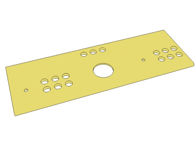

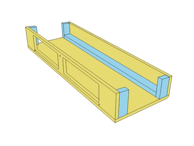

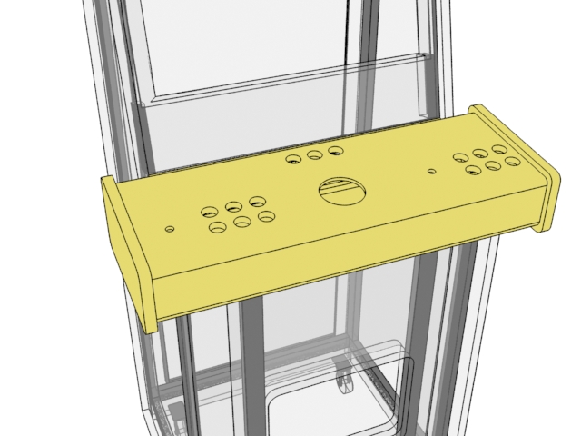

Hey Kman!,  yes I'm quietly beavering away at this conventional cab design up in the sticky section.  Just FYI, X Factor was the album of choice to listen to while I drew up these images.  :)  Who knows, i may just build this myself!
I've been off work sick for a few days and so with a bit of time to progress this design project along.  Before assembling the CP parts the additional front panel should be attached to the cab.  Using two brace pieces matched to the length of the front panel, screw/ glue them on either side of the coin panel cut out.
Attach the decorative panel by driving screws from the outside of the cab through the (remember to countersink the screw holes) panel and the brace pieces.

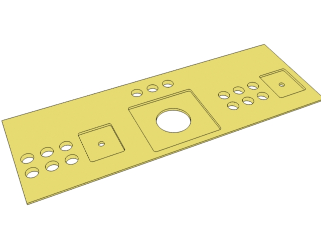

Using the Visio CP cutting and rebating diagram attached at the end of this post, cut out the holes for buttons, joysticks and trackball.  As I've mentioned before, my preferred method is to make a template from thin MDF first.  Some people just print out the template, stick that onto MDF and then drill out each hole. Thin MDF is much easier to work with to get clean edges around button holes etc.  Once you have the template use a flush trim bit and router to cut the actual CP panel out.
Again using the CP rebating guide diagram, route out the rebates for the joysticks and trackball.  These controls will be mounted to the CP from the underside of the panel.  Counter sunk machine screws embedded into the CP panel will hold them in place.
The CP back panel will need two rectangular holes cut out to allow fitting of controls and wiring. Note the three holes for mounting bolts through this panel and through the CP backing plate already fitted to the cab.
Use brace pieces inside the CP along the panel joins as shown.  Glue and screw panels together in the same way we’ve been joining other panels on the cab.  Any counter sunk screws will be filled over prior to vinyl wrapping the CP.
The CP backing plate will also need two rectangular holes cut out to allow wiring to pass through to the CP.
The CP is angled at 5 degrees.  Using a sander or a rasp angle the edges of the CP Back and Front Panels (and the brace pieces) so that the CP top Panel sits flush at a 5 degreed tilt.
EDIT: Guess what I forgot here? Well rhetorical question, I forgot to include marking and drilling the holes for the screws to mount the joysticks & trackball  THEN Glue and screw down the CP Top Panel and the End Panels, making use of the brace pieces to screw into where available.

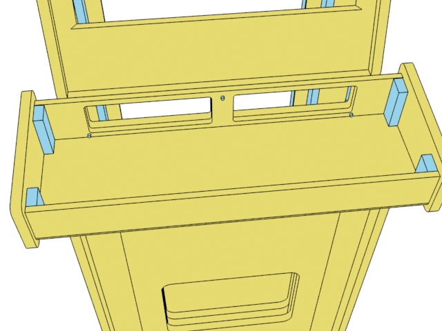

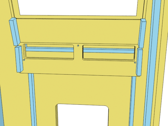

Here I'm showing the CP bolted to the cab using the three bolt holes (with the CP top removed for clarity).
Here is the view of the CP bolted into place from inside the cab.

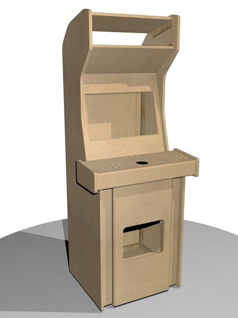

Here's a slightly more realistic render to show what the assembled cab should look like so far.
Next i'll cover the remaining panels around the marquee, slot cutting for T-molding and some filling and finishing techniques prior to painting and vinyl wrapping the surfaces.  Just below is the Visio file for the CP button holes and control rebates.  If anyone prefers this as a CAD file PM me and I'll provide it.
EDIT: Note that the layer 0 in the Visio file can be scaled onto a larger page size for printing, just choose 1:1 scale and it will print out perfectly to full size scale on 2 x A3 sheets, I've tested this myself.  No need for complex measuring just stick down the printout and route the CP panel, easy eh?  ;D

« Reply #149 on: February 20, 2013, 04:41:25 pm »
I was thinking about how to easily gain access to the control panel. I found "Blum Cliptop 110 degree Blumotion Hinge" and think something like this might be a possible solution. Install them on the inside, towards the user. Towards the rear of the control box, you could use a wire stay to hold the panel open at a decent angle, similar to a tailgate on a pickup. You could also install an arcade style lock at the top in a corner of the control board should you choose to.
Hinge video
Just a few quick links I found to show you show you what I'm talking about
http://www.ecscase.com/loadmastertm-rotomold-replacement-wire-stay-hinge-kit
http://www.tchweb.com/tchstore/product/514-2124/c852/Wire-Lid-Stay--Short.html
Lock
http://www.ultimarc.com/JShopServer/section.php?xSec=9&xPage=1
Ond
  • Posts: 2376
Re: Build an OND designed cab 'Metropolis'
« Reply #150 on: February 21, 2013, 03:21:48 am »
@ keilmillerjr - that's a really nice thought about the paypal donate thanks for the suggestion.  I hadn't thought of doing a PDF guide but I'll ponder that further as well.
brihyn did a great job on his version of the cab.
I used these type (or very similar) hinges on my Astro cab CP.  This design however will have vinyl wrap around art over the top and front edge of the CP.  That's not to say you couldn't modify the design and go with the hinges.  It's also why I've made the whole CP detachable using the bolts shown in the diagrams so that access to the CP internals is possible should it be needed once the cab is complete.  For those waiting on further design and build instruction updates on this, I have been spending some time on this, but primarily on the artwork.  I've scratch drawn the New Tower of Babylon for the side art.  The finished art should have a dark night scene, 'Metropolis' look to it i.e. in the style of the poster art.
« Last Edit: February 21, 2013, 03:30:43 am by Ond »

While ya'll wait for OND to find the ever-elusive free time to finish these amazing directions, I finished up my cab using what he's posted to date, so I'm happy to help answer questions that may come up as well.
Hi Brihyn. Good to hear this cab's do-able. Any chance you can post some pics so can see what the assembled cab looks like in real life. Itching to get started on first build, but equally nervous about the final plumping for a cab design!
Ond - this is fantastic! Ordered all components this w/e - and making a start next w/e! My first build so desperately hoping made all good decisions. Dont' know if you and/or others can help with a few q's:
1. I'm wanting to put a spinner on the CP. Will the dimensions of this CP accommodate a spinner unit if I move the central buttons?
2. As for protecting the CP - what's the best way?
         - Artwork then plexiglass (with the curve, will this be too difficult?)
         - Just errr is it Vinyl?? - thought i'd read on one commercial site that use special type so hard wearing?
3. On the panel under the monitor bezel - would this be OK to accommodate buttons? (e.g. home, play, + specials for emulators?)
4. Most confusingly - TFT monitor - 16:9 or 4:3 !!????
Oh, and those metric measurements would be great - never understood why people still use imperial, given the world moved to base 10 decades ago (no offense to anyone!)
Cheers folks
Steve
« Last Edit: March 31, 2013, 09:18:37 am by stigzler »

Ond
  • Posts: 2376
« Reply #157 on: April 10, 2013, 10:44:18 am »
Great to see quite a few folks interested in the Metropolis cab building project now and over 700 downloads of the plans!.  Welcome to Steve and Gern and thanks for the enthusiasm and kind words fellas.   I guess this is my little corner of BYOAC and really is aimed at encouraging new guys to build their own arcade cabinets.
There's a few questions so I'll comment on those in no particular order.  The Metropolis CP as designed, would do without covering with plexi.  The idea is to cover the CP and rolled off edge with printed vinyl.  To get an idea of how nice this can look check out some of Knievel's bartops over in the Projects section.
There's no problem with putting a spinner on the CP but if it were me building it, I'd substitute it for the trackball rather than adding a spinner and a trackball.  I've also seen some cabs with the spinner placed on the front edge of the CP as an alternative.
The cab is specifically designed around a widescreen monitor, simply because these are generally easier to get these days.  The bezel panel could be cut to fit a 4:3 monitor though.  I'd confine any buttons to the CP, but if you wanted to fit some on the bezel under the monitor you'd need to use plastic rather than glass to cover the bezel (the glass runs right down behind the CP).
I haven't forgotten about the metric version of the plans, just at the moment most of my drawing time is taken up on artwork for another members project, but I'll get to it as well as the artwork for this cab.  When complete I'll provide a link to my Dropbox so people can download the hi-res files.
Ond
