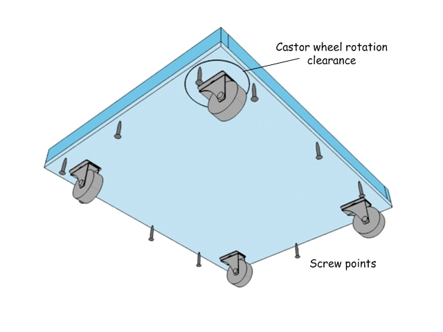

This cab will be sitting on a base fitted with caster wheels, as many builders start by constructing this first, let’s start with that also.
Choose caster wheels which are strong enough to handle the fully loaded cab, each wheel should be rated at least 50-60 kg.  My preference is for casters with smaller wheels if you can find them.  As the diagrams show the base is just constructed by pre-drilling the base panel and brace pieces and then gluing and screwing them together.
When attaching the casters make sure you allow for the turning circle each needs, no part of the caster should protrude over the edge of the base unit as this will be positioned at a set height internal to the cab, all caster frames should have a clear turning circle to allow easy movement in any direction when needed.

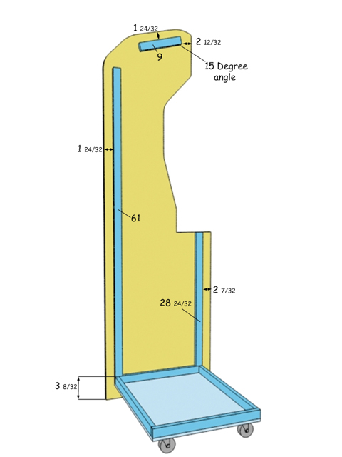

Next position the brace pieces as shown using the guide measurements.  I’d trace with a pencil and then pre-drill the panels for screws points.  Glue and screw  the bracing pieces to each side panel as shown.
Attach one side to the base, butt joining the brace on the base tight up against the brace end on the panel.  The height of the base allows for some clearance of wheels of around 1 ½” radius without having them on display.  If you use caster wheels of a different radius you will need to adjust the height at which the base is attached to allow the wheels to clear the bottom of the cab.
Repeat with the other side panel.

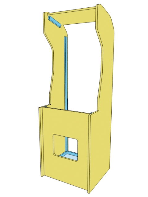

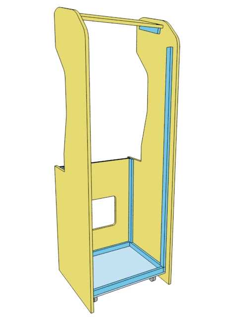

The front and main top panel can now be attached as well to the braces.
Next up – making an access hatch with the back panel.

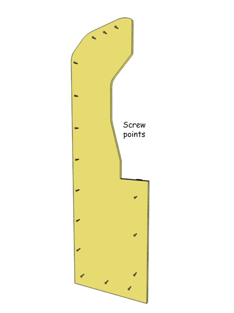

You should make it clearer that you are screwing from the outside through the side panel and into the bracing.
Yeah sorry about the initial post lacking detail, I posted up images and then realised I'd run out of time and had to head off to work.  Fixed now with some description.

Do you suggest two fixed and two turning casters or all four turning? What about locking wheels? Is a rolling cabinet while playing an issue?

These are all good options to consider and depending on what surface your cab will be resting on could vary.  If you use casters with only a small wheel radius and it is going to rest on carpet then all turning casters are OK.  I've confirmed this with other forum members as well.  In this case the cab tends not to wander about as it's being played.  If the cab is going to stand on a hard surface then locking casters or even just a pair of fixed casters at the back of the cab with small matching (in height) legs at the front could be an option.  To move the cab you'd have to tilt it back on it's wheels.  I'd still recommend positioning the base so that the bottoms of the panels clear the floor by an inch or so for a nicer 'hovering ' look.

What is the offset for the top panel?  Is it centered on the support board?

Since each person's wheels will likely vary, can you put a suggested height off the ground for the base of the side panels?  You have 3-8/32 listed from the top of the base frame to the bottom of the side panel, but if someone following your instructions picks the smallest capable wheels, it's possible they could get interference with the ground.
This looks great so far!
Yes the top panel should sit centered on the support brace (same offset either side).

I’d go with no less than an inch of ground clearance from the bottom of the panels to the floor, this should cover most carpeted surfaces and still look good.
Just throwing this out there, for my cabs [both on laminate flooring] what I did was counter-sink a lag bolt in a hockey puck [I'm in Canada!] and then put a sticky felt pad on the bottom. The puck handles the weight of the cab no problem! And the felt pad makes it easy enough to slide around but still heavy enough to not move when playing.
Nice alternative to casters!

The Back Panel and door......
Using the same method we used for the first sheet of 4 x 8 3/4",  cut the Back Panel as per the cutting plan from the second 4 x 8 sheet.
Mark with a pencil the cut-out section shown below using the measurements I've shown.  Then make a cut-out in this panel using a circular saw and a saw fence.
Once the saw cuts are made we will need to finish cutting each inside corner with a Jigsaw.
Next using our straight edge guide and clamps route a rebate along each edge of the cut-out.  Set the router bit to cut 1/2" deep and clamp the guide so that the rebate is 9/32" wide.
This will allow us to fit a door cut from 1/2" MDF.
Pre-drill the back panel and the support braces at the points shown, remember to over drill each screw hole in the back panel (I use a larger drill bit) to  allow for counter sunk screws.  We won't be gluing the Back Panel in just yet, just test fit with screws only.
Cut a door from 1/2" MDF as per the sizing shown. Fit the door to the cut-out with long narrow hinges.

Any reason why you chose to screw from the outside through each panel? Would it not be easier to screw from the inside till 2/3 inside each panel? That would also save you from filling/sanding all those screw holes. I'm asking because I'm still debating this for my own cab.

A fair enough question, well my main reason is that's what I'm used to, filling slightly countersunk screws and sanding flush prior to painting.  If you like the cabinets shape don't let that stop you building it though.  You could instead screw into the panels from the inside wherever you prefer.  My thinking is probably also because I prefer to to drive the screw right through the available thickness of a panel for maximum strength.  Since it's being glued as well this is not that important.  One final reason is the trade off of filling and sanding versus the ease of using a drill to power drive in screws from the outside of the cab.  Screws located close to inside edges can be a pain to access with power tools especially.
Putting a hole in a panel is not a sin!  ;D  In fact here and there I'll be using Bondo methods to fill and refine surfaces prior to painting that can really make a difference in the finished look of the cab.  Some people hesitate to use Bondo as a construction material but honestly after a mild learning curve the stuff is the magic!  To back up my words I'll happily provide a video/tutorial in this project thread of the filling and finish technique I'm suggesting.
