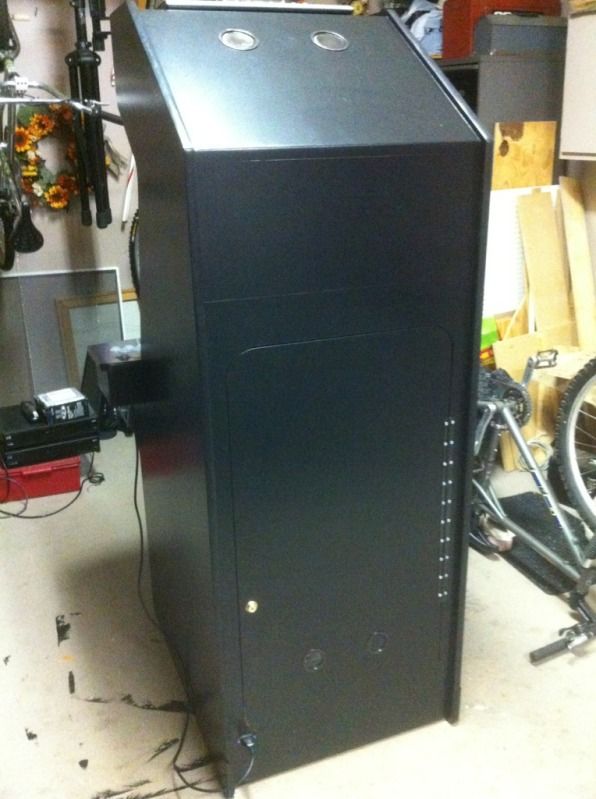

Just a small update...
Finally got the power button installed.  It's a vandal switch from frozencpu.com.  Expensive little sucker, but I love the look.  I originally wanted to put this through the monitor bezel and plexi, but the LED is a little too bright and I think it'd shine right in rugrat eyes, so I located it where moms and runts can both find it....right on the front!  It's cool because you can't see it when the machine is off, but when it's on, there's no mistaking it:
Putting in the switch was nerve wracking and tough.  Basically, I had to first drill a 1 1/4" hole for clearance, but only about 1/2" through the MDF.  Then, I had to drill the hole for the switch in the middle of that.  Because I had to use spade bits, I had to go REALLY slow on the final hole and drill from the front first, then from the back so I wouldn't have any tearout.  I think it came out nice.
While I had it turned around and crawling inside, I re-did all the wire management.  Oh, and I finally took some pictures of the completed back:
Brass lock in back because Lowes didn't have chrome that day.  :badmood:.  Otherwise, it's just a piano hinge in Hammered Black.
Vents are 2" soffett vents on the door and 3" ones on the top....all painted hammered black.  The cab seems to not need a fan with this setup.  I have it in the garage in 90 degree weather and the temp in the cab usually isn't much hotter than ambient, so I'm happy.  Should be even better when I move it to the basement.
Ordered the 3/16" solar grey plexi from Tap yesterday.  Once it's here, this puppy is done.

Just a quick update...a couple things happened over the last week.  First, my plexi arrived from TAP Plastics.  I got the 3/16" solar grey.  When I say this made all the difference, I mean THIS MADE ALL THE DIFFERENCE.  From what it was....a project in my garage....
To something that my neighbors keep thinking is a purchased cabinet, or at the very least, a kit...
For those that have been paying attention...the LCD mount was a knohbody design (it came from his bartop see here: http://forum.arcadecontrols.com/index.php?topic=116253.0)
My idea was to create an entirely modular LCD mount that comes out as one piece, including the glass.  So, I used knohbody's idea of using the 3/4" MDF as the actual bezel, routing the back to accept the monitor almost flush, then mounting the glass to it.  This allows me to pop out the entire monitor mount after just unplugging the VGA and power cable to the LCD.  Look further up the build thread for specifics about the mounting process.
The glass will be held on with 1/4" J-channel found in your local Lowes bathroom section.  (http://www.lowes.com/pd_197443-13437-5042_0__?productId=3019540&Ntt=mirror+channel&pl=1&currentURL=%2Fpl__0__s%3FNtt%3Dmirror%2Bchannel&facetInfo=)It's normally used to hang mirror on a wall.  I got 4 feet for $4.88.  It was cut, then painted with (what else) Rustoleum Hammered Black.
Remember, I installed the mount so that it would exit this way:
So, after I remove the mount, I get a hole (that silver thing on the wall of the cab is a Netgear USB wireless adapter):
And here's the actual mount.
The glass is then simply slipped into the J-channel from the side...
Then, the mount is simply installed back into the machine...
I was going to put 2 buttons through the bezel and plexi....one Pause button and one Esc button, but I decided against it.  Since we've been using it without those buttons and using shifted buttons, the kids are used to the shifted buttons now.  I'm glad because I think the plexi is def.
After getting the monitor brightness and contrast set, here's the end product.
