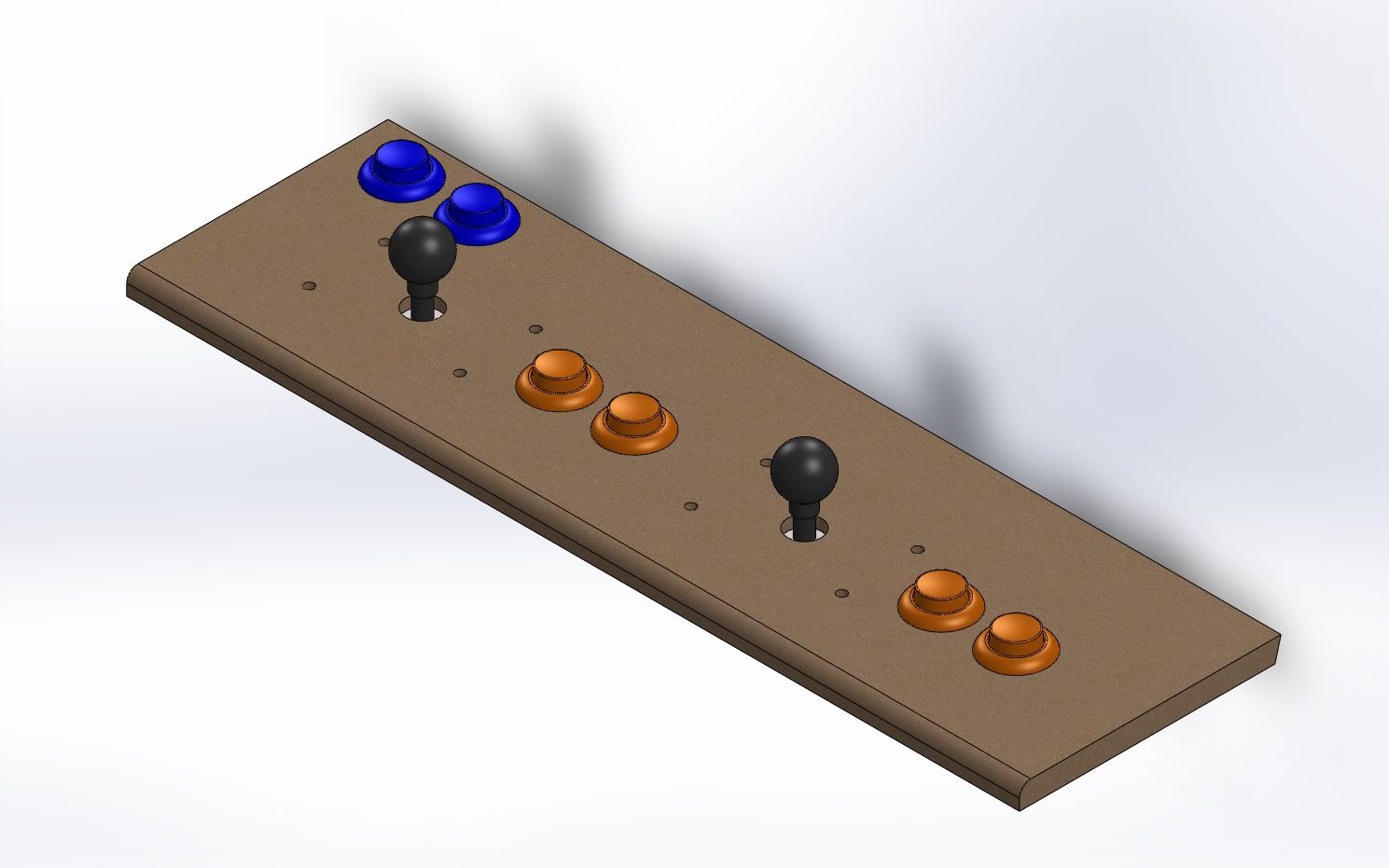

Been working on my control panel design, what you guys think?

Re: Mini Mario Bros Arcade - UPDATED 2-22-12
« Reply #56 on: February 22, 2012, 10:35:19 am »
I'd put p2 start in the upper right, or if there's room I prefer mine in the middle. But that's just personal preference. I'm assuming that's what the blue buttons are. If they are admin, keep them together and out of the way - where they are right now is good.

« Reply #57 on: February 22, 2012, 10:40:24 am »
Thats my player 1 and player 2 start buttons, this is suppose to resemble a mario bros machine at first glance, with the obvious inclusion of the second button per player. I will probably have some admin buttons hidden somewhere, maybe recessed into the top where the kids can't reach them.

« Reply #58 on: February 22, 2012, 12:34:37 pm »
Are these only 4-ways or switchable?
I would recommend squeezing 2 more buttons in per player.  The number of games added when going from 2 to 4 buttons is crazy.

« Reply #59 on: February 22, 2012, 01:42:06 pm »
They are original nintendo 8-way sticks. I didn't have time to fully model them, sorry. I've already went from 1 button to 2 buttons, and its a tight ass squeeze, there is no way i'd get any more on there. I already have a mame cabinet anyways thats way more powerful than this thing will be. This is just suppose to play the simple games. I added that second button cause I wanted to open up play for NES games.

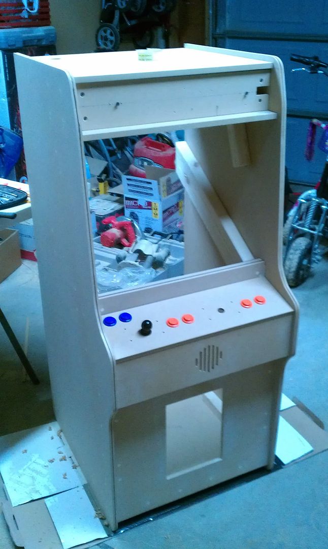

How's the build coming along?
I am nearly finished with the woodwork, I need to do a few touchups here on friday, and I will be ready to fill, sand, prime and paint! I'll post some photos of my progress here this weekend.
I guess I am just a big fan of neo-geo games.

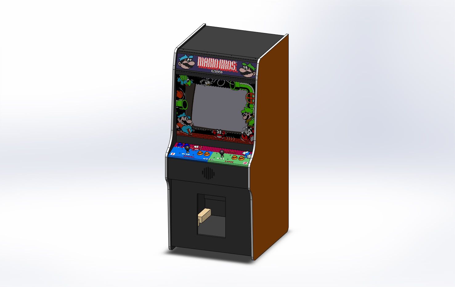

I was working on the artwork last night, decided to throw it into the model to see how its fitting... lookin' GOOD! :cheers:
PROTIP: Right click the image and select "open in new tab" to get the full view.
I don't have a decent set of side art in vector(I have some, but they aren't accurate at all), so that's why it's missing.

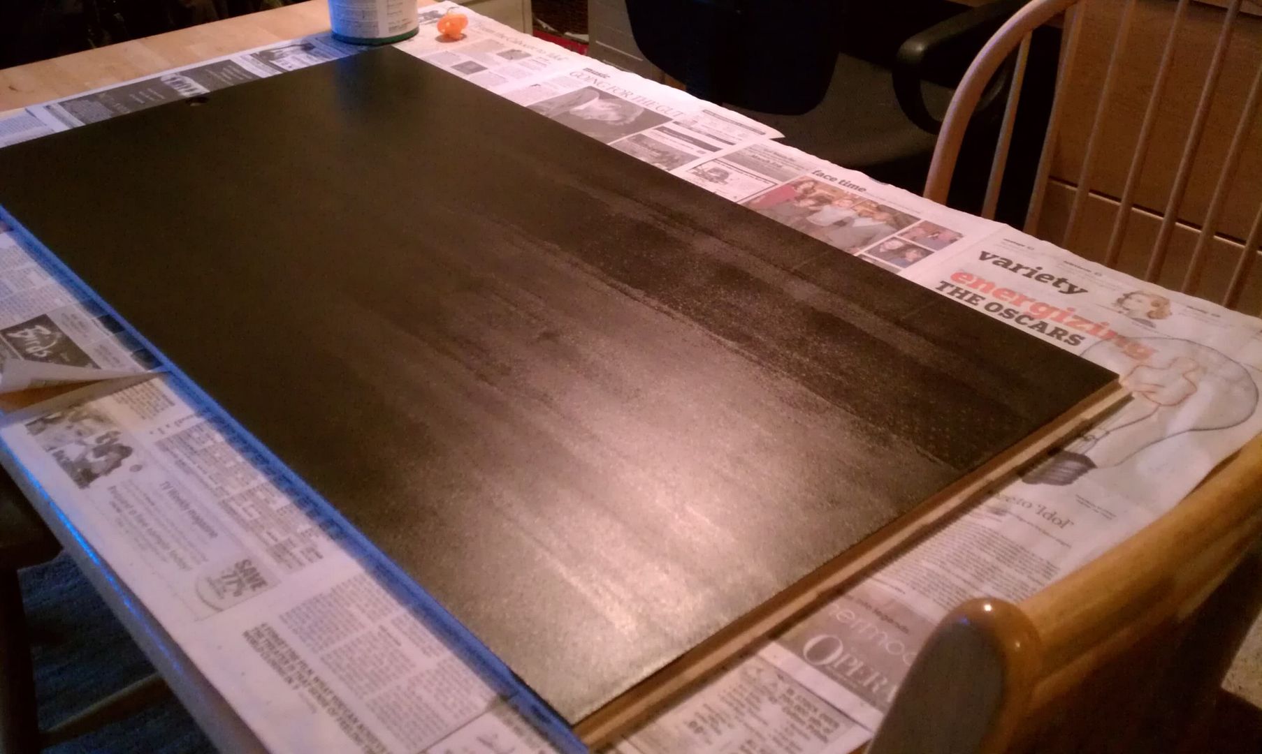

Ok, Here's a progress update, and also a dilemma. I've started my painting, but im getting streaks, and I don't know how to get rid of them. This is the second coat, 2 hours of drying time, no sanding yet. What should I do?
  • Posts: 7931
Re: Mini Mario Bros Arcade - UPDATED 3-4-12
« Reply #71 on: March 04, 2012, 11:24:56 pm »
are you rolling?
Honestly, I could never get a great finish with anything but laminate. I get a decent finish with a foam roller. I am never happy with a brush, regardless of oil or latex paint.

« Reply #72 on: March 05, 2012, 08:18:33 am »
are you rolling?
I'm using a 4" high density foam roller. I think my problem is i'm not using enough paint maybe, i'm rolling it dry? I don't know.
« Reply #73 on: March 05, 2012, 09:21:20 am »
Nice build so far.  I'm not a fan of only two buttons but I get where you're coming from and I think it's a cool concept.
From a paint perspective you've got a few areas to look at:
Paint - Is this a high quality or low quality?  Did you make sure to shake it at the store and then when you got it home did you stir it too before use?
Roller - Is this a high quality or low quality?  Are you putting a lot of pressure on it?
When I see streak lines with a roller I'm doing one of these things:
  • Not using enough paint
  • Pushing too hard
  • Using a super cheap roller or one that I didn't fully clean after the last use
  • Using paint that's sat on the counter and not shaking/stirring before use
Just glob a bunch and then smooth out on the wood.  Don't use pressure and instead just "roll" it.  Let the friction between the wood and roller do the work for you.

I'm using Behr paint, so I'd say that not low quality. Yes, I think I may be using too much pressure when rolling. My roller is probably cheap, but I do clean it thoroughly after each coat. I do stir the paint well before each coat as well. So I think i'll try using more paint, and less pressure. I appreciate the input, thanks guys!
« Reply #75 on: March 05, 2012, 05:12:29 pm »
Actually, Behr is a low quality paint. It's the "affordable" brand that Home Depot carries and promotes as their easy-to-use primer+paint combination. I've found it difficult to get a nice clean layer on whenever I use this paint. I would avoid using Behr and go for something a little higher quality.
Glidden and Sherwin Williams, are the two brands I usually use. Though I think Glidden is a Canadian paint, but I know SW is American and all over the USA.
Be sure to apply your paint in a nice thick coat, but not lumpy. You still want the amount of paint to evenly coat the surface, but have enough on there so that it's not "thin". I tend to glob it on, then use my roller to smooth it out. Using a fine roller is good, but you don't need to apply too much pressure to get coverage.
Also, start your sanding passes on your layers early. I usually start sanding in my primer pass, then every pass after that.    Apply your coat, let dry for a few hours or until the paint is "tacky", then lightly sand using a high-grit sandpaper, then gradually getting higher towards your last pass. You just want to sand the paint surface till it's smooth in each pass.  For me, I put 2 - 3 passes of primer, then 3-5 passes of paint, sanding in each pass.
It's worked out great for me, and I have no complaints of the end results (check out the first page of my Canucks cocktail in my sig, the paint job was done with this method and it looks awesome).

I was able to get some work done on my control panel last night, all the cutting and routing went exactly as planned, thank the wood gods! So this is where i'm sitting now. Its going to be in the high 60's this week, so im ready to prime/paint!
Sorry about how blue it is, that's a cell phone camera for ya...
