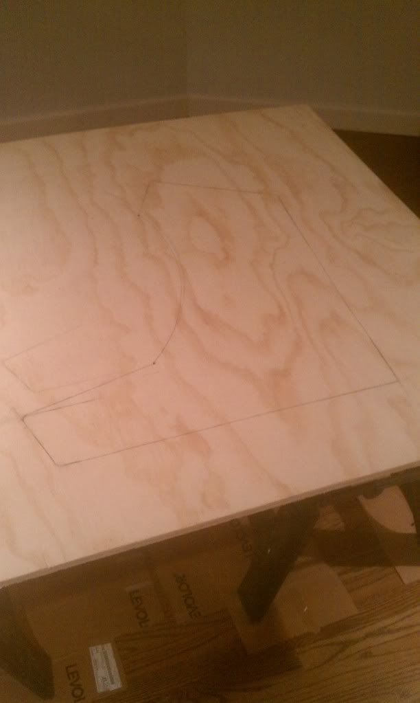

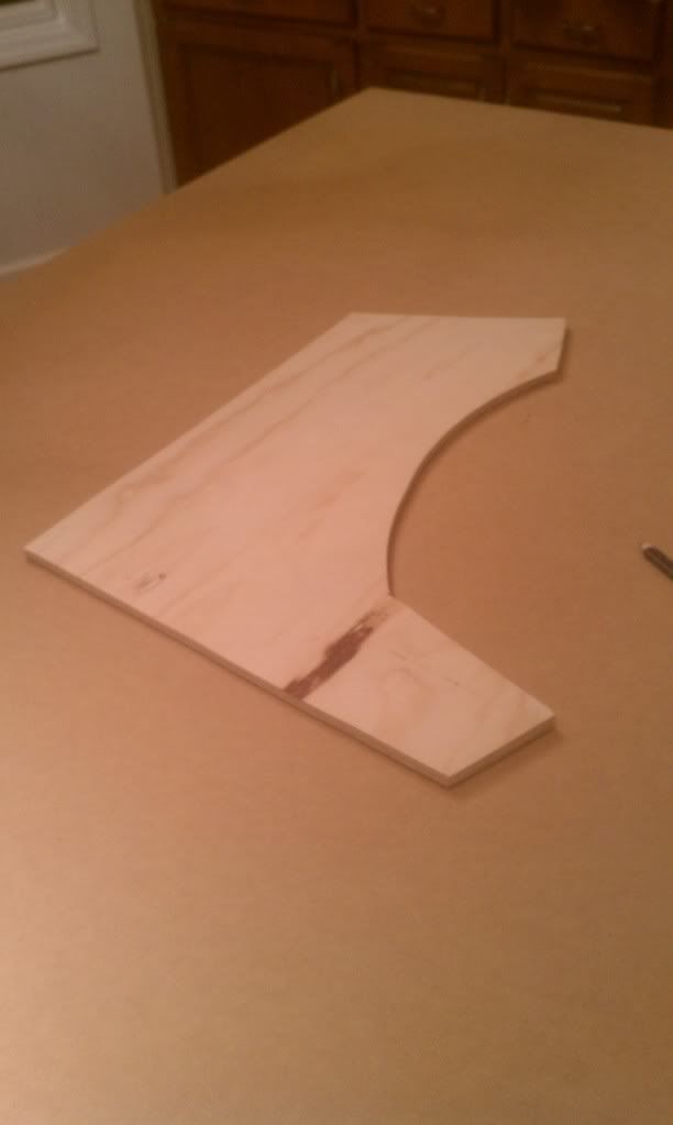

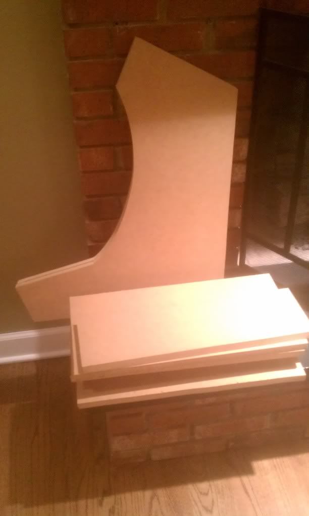

I built it based on the plans for the Weecade.  I had to adjust some measurements to fit a 19" LCD monitor, but everything is pretty close.  First, I made a template for the sides out of plywood:

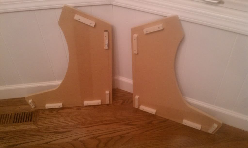

I used 3/4" MDF for the sides:

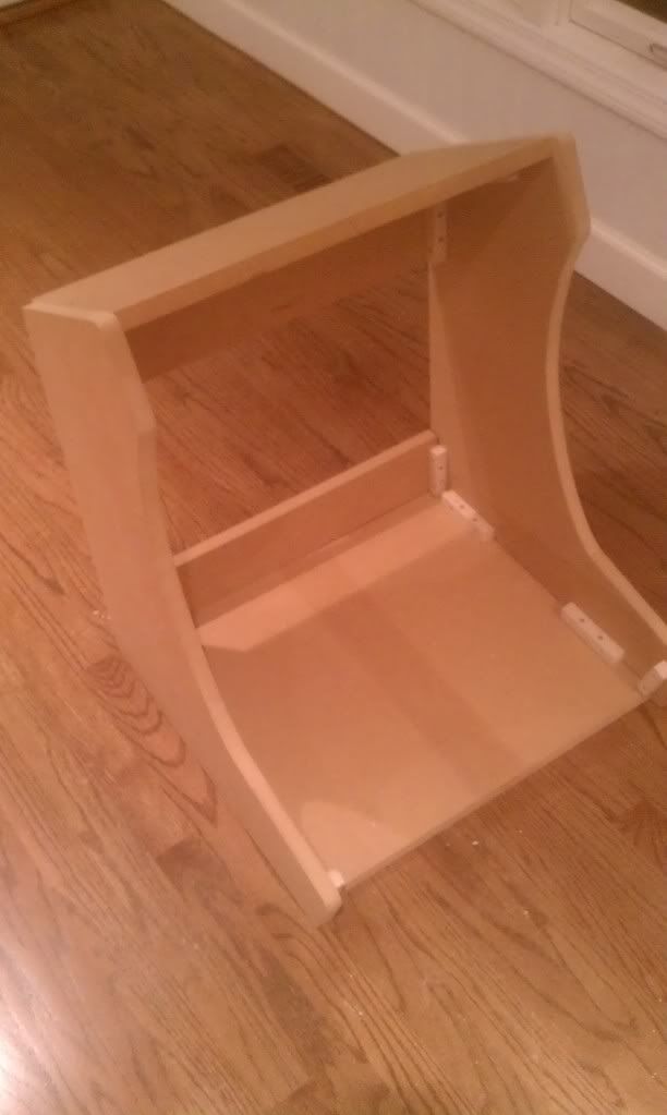

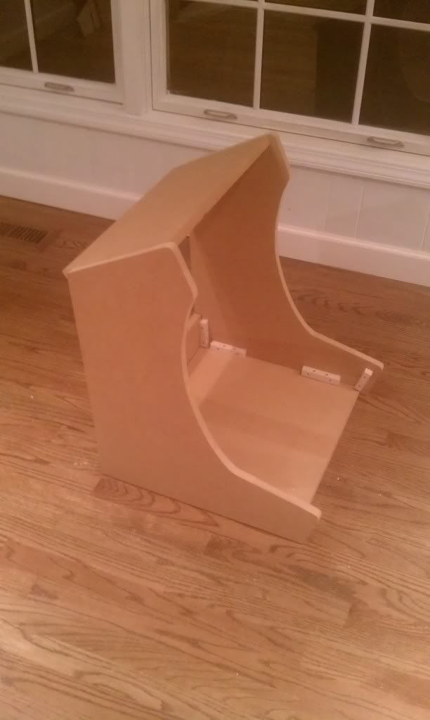

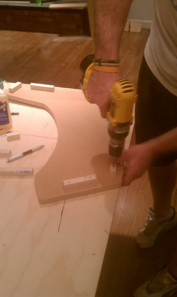

Used 1"X1" pieces to attach everything together (wanted to avoid screw holes on the outside):
End of day 1.  Made some progress.  I had a shell to work with:

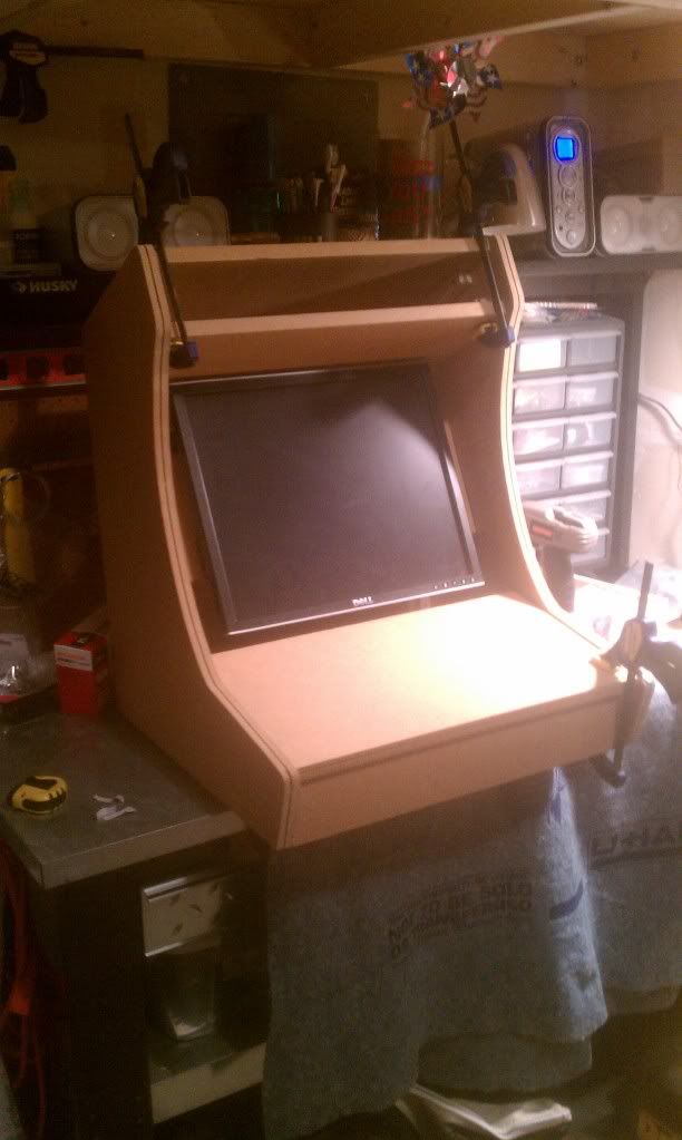

Next I added the monitor to make sure it would fit:

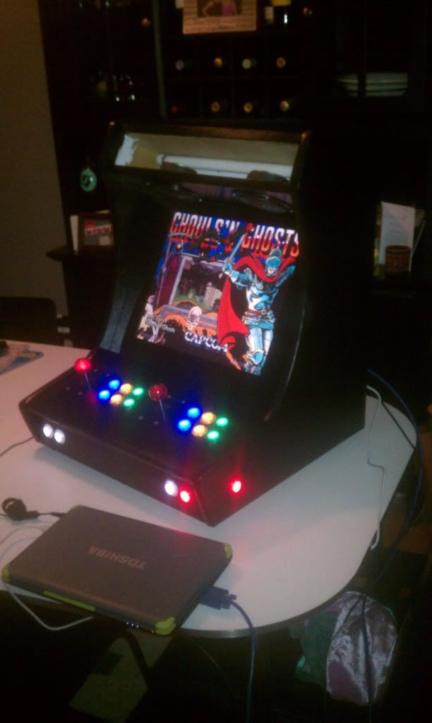

I decided to use LED buttons and LED joysticks from Paradise Arcade.  The main reason was so LEDBlinky would speak the controls at the start of each game and keep them lit so I knew what was what.  In hindsight, it may have been a bit excessive.  But, whatever...

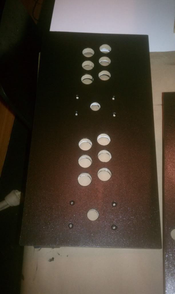

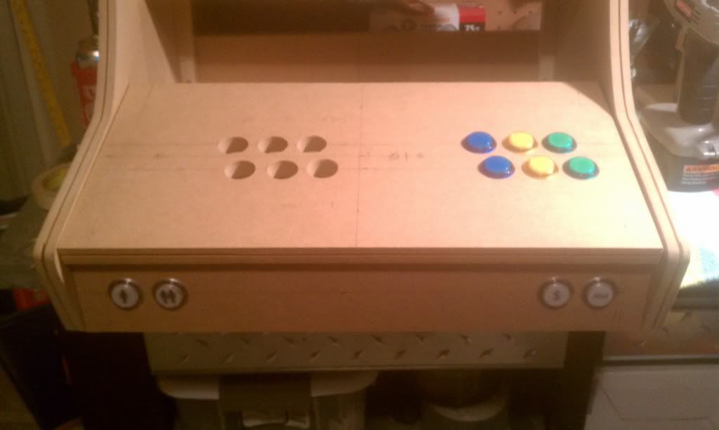

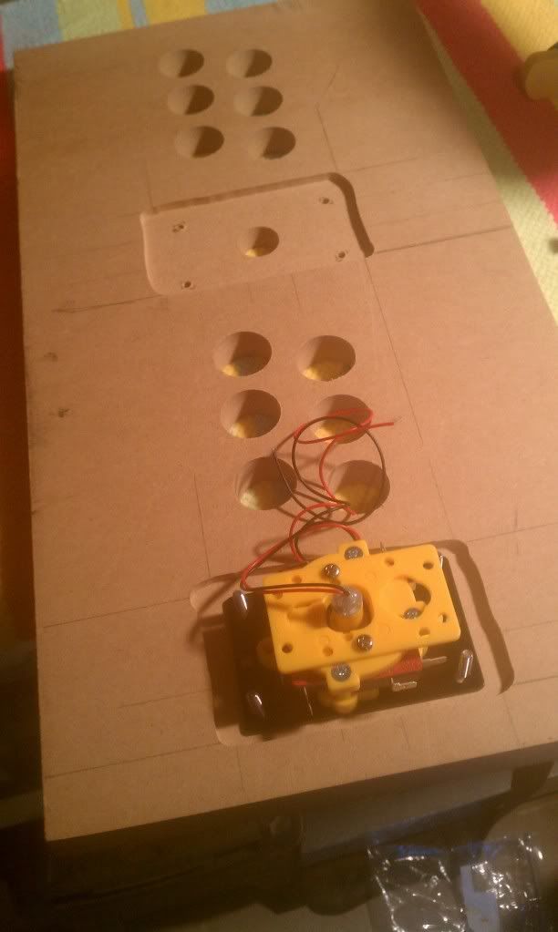

Had to router the bottom of the control panel because the joystick shafts were too short:

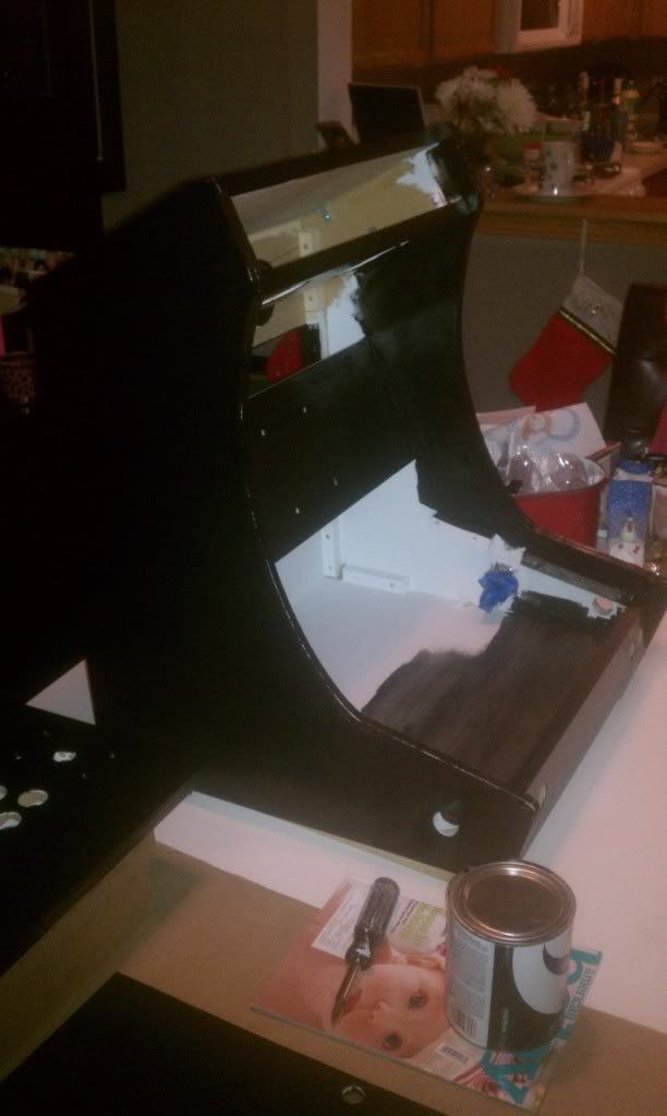

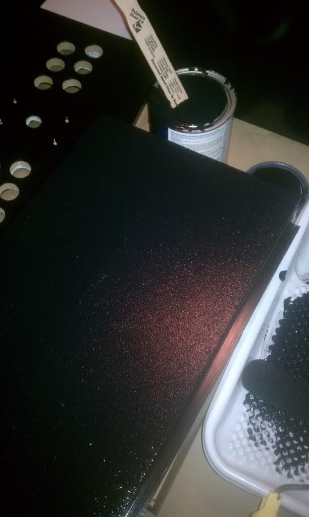

My wife let me take over the kitchen table for priming and painting.  Chicago winters are a bit too cold for painting in an unheated garage.  After 3 coats of primer, the painting began.  I got the glossiest black paint that I could find.  BTW, I still have no idea what I am going to do for a theme.
I put the initial coats down with a brush and sanded after each coat.  The final coat was done with a sponge roller.  It is hard to describe the final texture of the paint.  Definitely not super smooth.  But, I actually love the way it came out:

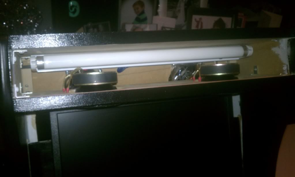

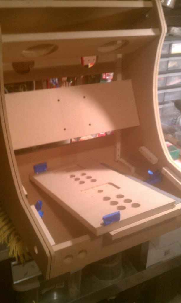

Time to put all the pieces together.  Speakers and marquee light installed:
Exhaust fans in the back as well as an access panel:

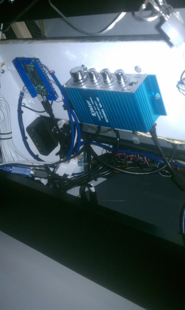

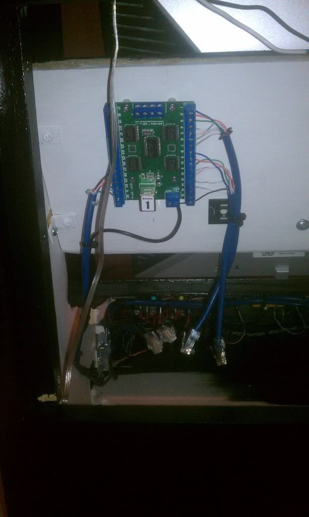

LEDWiz and iPac installed on the back of the LCD mount:
Audio amplifier also installed on the back of the LCD mount:

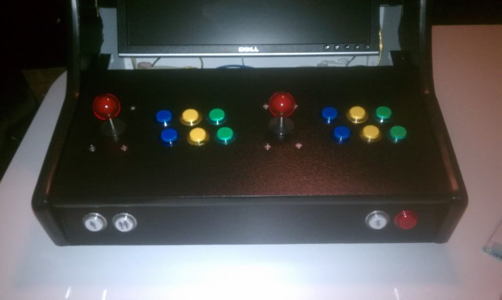

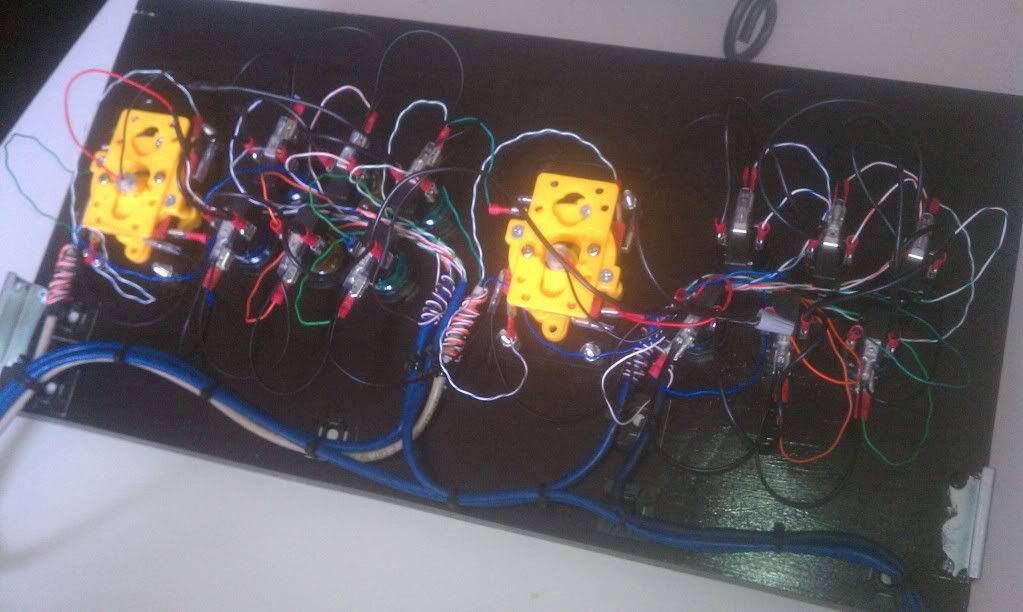

Control panel all wired up:

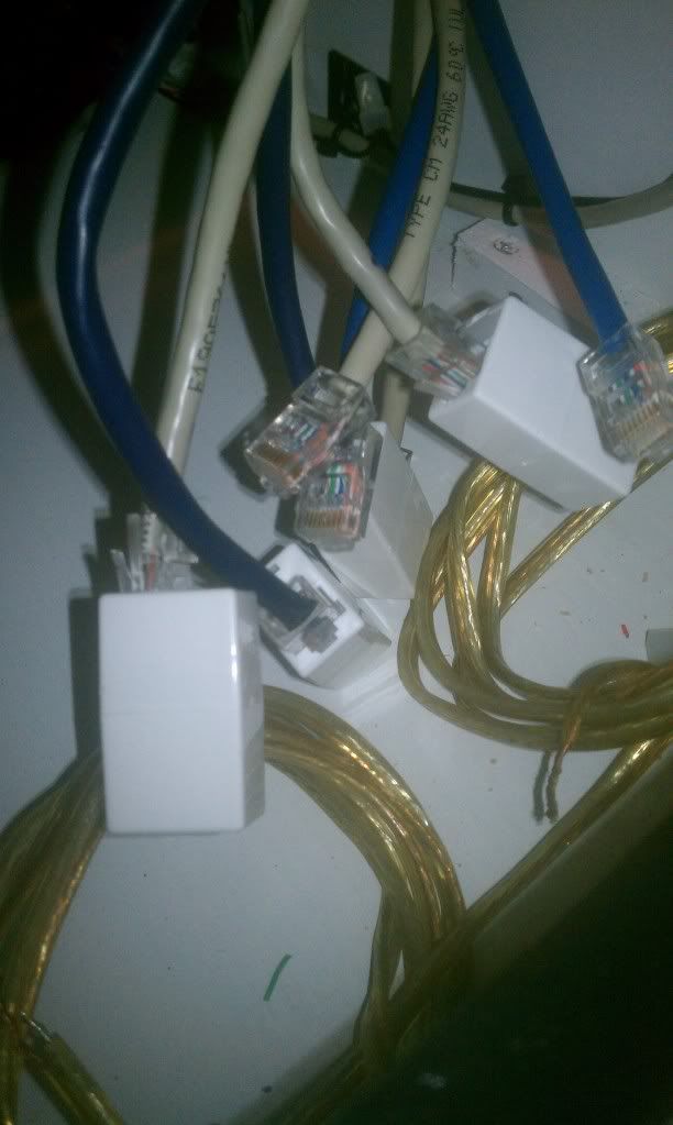

As you can see by the last picture, I used RJ45 (ethernet) connectors so I could easily remove the control panel.  My thinking was that I could eventually build other control panels (trackball, spinner, etc) and easily swap the out.  The control panel is secured with panel clamps.

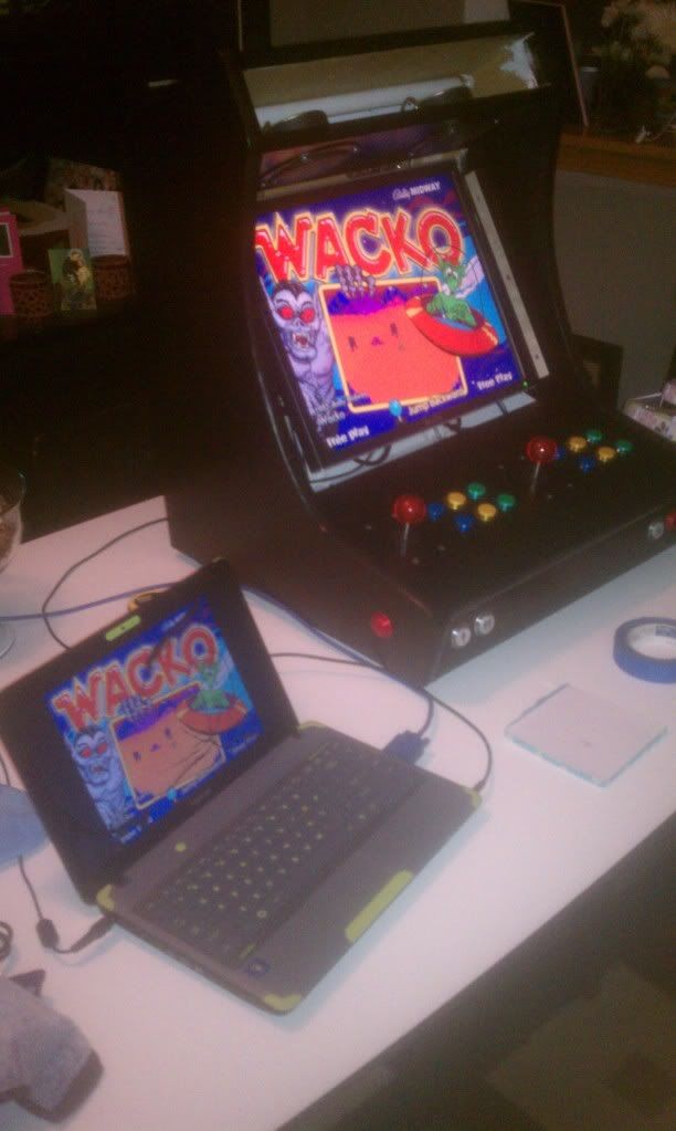

I originally bought a P4 computer off of eBay for the guts of the machine.  However, while I was waiting for the machine to be delivered, my nephew stepped on the LCD screen of his laptop.  The cost to fix the LCD was almost as much as the machine itself.  It is a dual core with 2 gigs of Ram.  I made a deal with him.  He gives me the laptop and I'll take him to Gamestop to buy an Xbox game.  Seems like a win-win to me.  Here is a few pics of the laptop outside of the machine (still have to figure out a way to get it inside the cab (alot less room than I had anticipated).
(The Wacko game on the screen is fitting since that is what my wife says I am for building one of these)

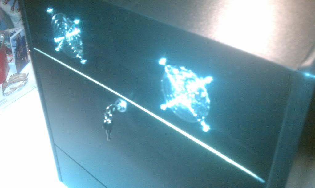

Here is a pic of the buttons lit up:
4. install volume control
I like what you've done, currently working on a similar project. How are you providing power to the DC amp? I'm assuming your laptop has a dedicated AC/DC power adapter.
CharlesDeMar
  • Posts: 32
  • Last login:October 11, 2017, 11:46:41 am
Re: First Build. Starting off with a Bartop.
« Reply #8 on: January 31, 2012, 06:47:19 pm »
Thanks for the comments.  I purchased a seperate AC/DC power adapter off of Amazon to power the amplifier.  I bought the amp off of eBay.  I was a bit surprised when the amp showed up without a power supply (I guess it was meant for inside a car and wouldn't need a power converter).  I found a power supply that was meant for an LCD monitor that had the same specs.  It was a pain in the ass to match the plug, but in the end it works flawlessly.

1) What kind/size screws do you use to screw the 1x1 to the MDF?
2) Once you mounted the LCD to the horizontal piece of wood, how do you secure the bezel and plexi to the monitor or cabinet?
