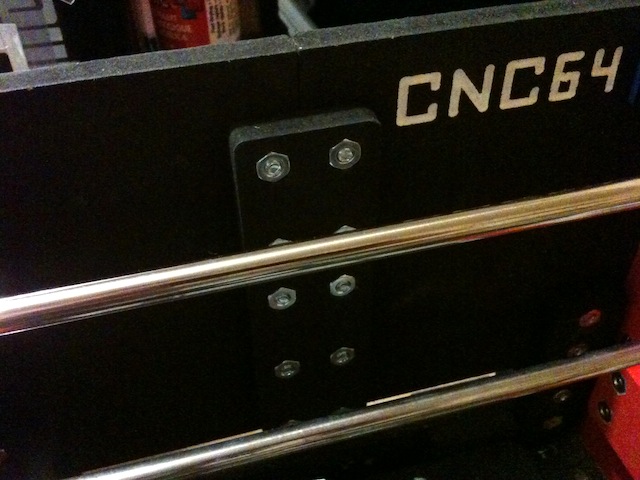

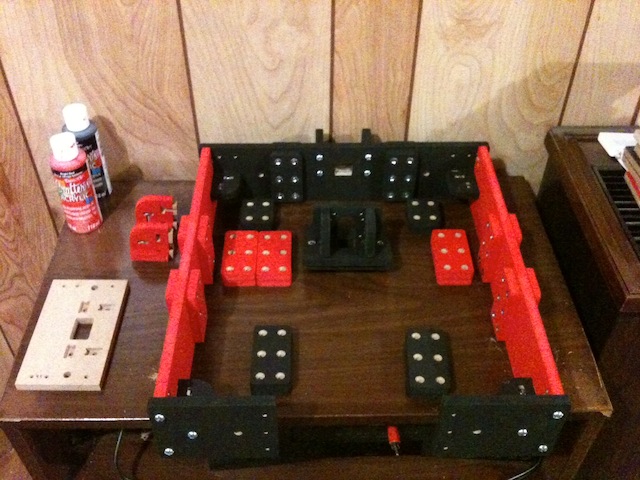

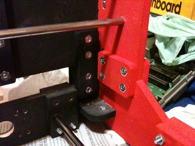

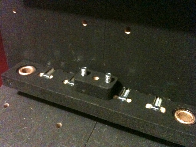

CNC64 - Bronze bushings, assembly plates, threaded rods, surprise (2013-10-18)
« Reply #176 on: October 18, 2013, 06:33:56 pm »
Bronze bushings
The bronze bushings from TechPaladin.com arrived yesterday. I now understand the "self-aligning" feature of those parts. They glide so smoothly on the printer/scanner rods that the LM8UU linear ball bearings seem really inferior by comparison.
New assembly plates
I was really tired of having bolts and nuts sticking out everywhere inside and outside the machine that I'm replacing the assembly plates with new ones that feature custom-cut countersunk holes for the bolt heads and the nuts. Yes, hexagonal holes.  :D
Threaded rod drive
Previously I talked about threaded rod drive versus belt drive, I tried making CNC64 bigger to be able to at least cut the control panel for MVS-99-6, etc. The problem is, the base of CNC64 is too low-profile to convert it into a belt drive CNC but I also didn't want it to go to waste. So I tested with a #6-32 threaded rod and nylon nuts and the result is nothing short of amazing. Using a nut on both sides of the moving platform, I can't feel any play and it turns extremely smooth (plastic on metal). I had to make tiny plates to hold the nylon nuts, using the same countersunk hole method as the new assembly plates.
So the goal is to complete CNC64 using this new method, along with its first copy. Oh, didn't I mention this already? There's another CNC64 machine that's nearly complete. It's not a clone since it was cut by the MDX-3, but it's a trade between me and my friend for the stepper driver board I mentioned in an earlier post.
A surprise
If the second CNC64 machine is not a surprise, then what is it, you ask? The surprise is what I currently call CNC86: a bigger CNC machine similar in design but with a belt drive instead of threaded rod. It's also bigger, big enough to cut all but five of the MVS-99-6 panels (sides, bottom, back, top). And those will be able to be cut in two passes, with the side panels being cut in bottom/top parts, assembled later. The cutting area is a bit bigger than 8x6 inches but I had to round down since "CNC 8.74016 6.37795" doesn't sound as catchy. I'm using inches for the names since otherwise it would be called "CNC222162" which is just plain bad (222x162mm cutting area, for those wondering).
Edit: how about CNC2016? (20x16 cm) But then I would need to rename CNC64 and call it CNC1510 instead...
There's one thing that I need to mention again: I hate painting.  :cry:

CNC64 - Bronze bushings and Lucite plates (2013-10-28)
« Reply #179 on: October 28, 2013, 04:03:02 pm »
Okay, so those bronze bushings really are precise. More precise than my MDX-3 is at aligning two holes, apparently.  The LM8UU didn't seem to complain about my rods alignment but the bronze bushings always seem to jam near the end points near the plates supporting them. I have checked my measurements three times and made a series of four test plates. Nothing seems to help.  :cry:
So I'm modifying my approach to have bronze bushings on one rod and Lucite plates with elongated holes on the other rod. After re-checking my old Roland MDX-3, it seems all its axes are build this way, bronze bushings on one rod and a simple two-pins plastic "fork" riding on the other rod. To avoid bending/torsion, the force is applied on the side with the bronze bushings. Most printers and scanners are also built this way, two bronze bushings on the belt side and the other side just rides directly on a little wheel or on plastic.
Since Lucite is an extremely hard plastic, it takes around 4 hours and 45 minutes for the MDX-3 to cut a single plate. It's going to take six of those plate. One down, five to go...

CNC64 - MDX-3 upgrade: dumbgineering (2014-05-04)
« Reply #192 on: May 04, 2014, 10:31:00 am »
I made a serious mistake with the new Z-axis assembly. I guess I was tired when I did the mistake, because it's really dumb.
Here's how I designed the assembly in Sketchup:
But since I wanted to have flush bolt heads:
I had to countersink the bolt holes:
However, since the design required a slot for a part on the back:
I had to do the countersink on the other side:
But I had to do that countersink, manually, with a drill bit on the other side:
And what had to happen, happened. The thin wall of expanded PVC broke, the bolt could no longer hold the part on the other side, the RTX mount wasn't tied to the Z-axis assembly anymore, the RTX became randomly offset with the programmed pattern and the end mill bit just continued cutting anyway:
Ouch.
I learned two things from this mistake:
  • the RTX is powerful enough to cut at least 1/4 of the thickness of the MDF at a time, so I'll program deeper cuts next time, maybe 1/16" just to be on the safe side. With 3/8" thick MDF, this means only 6 passes to cut through, compared to my usual... 70 or so.
  • The RTX is powerful enough to actually burn the end mill bit, that means I don't have to worry about the power of my spindle anymore, which is a good thing for future cuts with my modified "Roland RTX-3", for CNC64 and for CNC86.
I'll patch the broken part with a big washer, offset the bolt head thickness with washers, cut new Z-axis assembly parts again (maybe in double, to have a backup), order more Dremel #650 end mill bits (with a few spares as backup this time) and continue forward.  :laugh:
« Last Edit: May 04, 2014, 10:56:09 am by Yvan256 »

« Reply #193 on: May 10, 2014, 04:41:33 pm »
I had problems with the new Z-axis assembly, I think there was too much friction on the Z-axis rods because the cutting depth wasn't as constant as it should have been from hole to hole. So, I had install the original spindle back on. Again.  :-[
I've made the motor pivot stronger, so it should last for quite a while now.
In the meantime, my friend ordered two more Dremel #650 end mills this week and received them two days later. Considering how remote our small town is, it's amazingly fast. Kudos to Amazon.ca for the delivery speed.
The MDX-3 is cutting a NEMA23 mounting plate for CNC64/CNC86.
Edit: plate is cut, perfect fit with the motor. I have two GT2 pulleys for the NEMA23 motors of the X and Y axis.
« Last Edit: May 10, 2014, 06:16:30 pm by Yvan256 »

CNC64 - NEMA23 assembly ready (2014-05-12)
« Reply #196 on: May 12, 2014, 08:48:13 pm »
All the parts for the NEMA 23 stepper motor assembly are ready, except for two coats of paint. All that's needed to upgrade the Y axis to belt drive is the plate for the other side where the idler pulley will be installed.

« Reply #198 on: May 20, 2014, 06:54:39 pm »
Since I need to cut new plates for the Y-axis for the belt drive, I've decided to try to fix the bushings alignment problem.
Lucky me, the new design for the part "Y1" fits four times on one plate.
The new Y-axis assembly design has seven distinct parts, with four plates having one bushing each. Two top plates will then join the front and back plates+bushings and the left and right side will be joined together with a plate with slotted holes. The end result is something that can be easily aligned after assembly.
Here's an exaggeration of the "sliding" design that should allow perfect alignment with the Y-axis rods. We're talking about plus or minus a fraction of a millimetre here. Alignment has to be perfect, as I learned the first time around. Those bushings are extremely precise.
And here's the four Y1 plates with their bronze bushings.
Belt attachment design and three more plates to go.
« Last Edit: May 20, 2014, 07:02:42 pm by Yvan256 »
